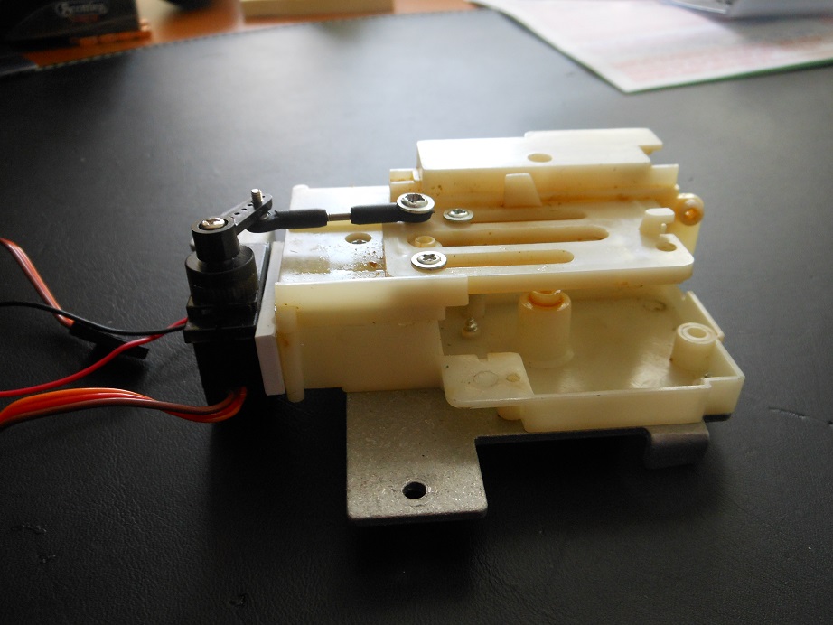

tao wrote:Michael,
What do you like about the Taigen recoil as opposed to others?
tao, I am on Clark mostly which does not allow any adjustment on the recoil time like IBUs. I have also never used a Tamiya recoil which I have seen and quite like as well. I personally preferred a different slower return speed (i.e. the barrel returning back to its normal after the recoil) and I think Taigen's unit simulates that better than Clark which has the same speed on the servo. I have also done the following mod as well but I think I should have keep the spring to slow down the return speed on the servo.......
tao
Posts: 795
Re: Anybody have Taigen Metal Panther F or G?
Post by tao »
Nice..I only have Taigen recoil and it is pretty slow on return! I slowed down my a tad more using a a few diodes
on the negative wire leading to the turret. Also have another where I have an adjustable pot there but diodes work fine.
