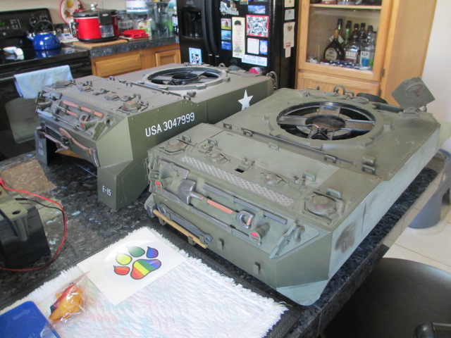

Done for the day.  I think I will start with the lower since it requires some of the most work and expense.

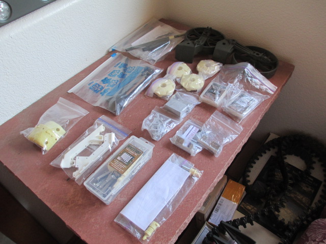

A sample of the collected and gifted parts waiting for this build to begin

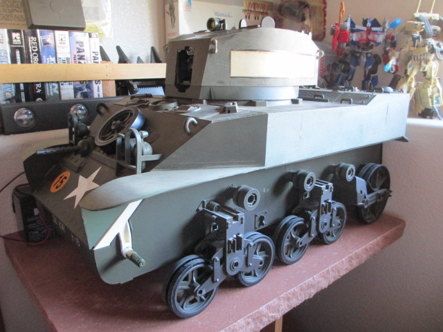

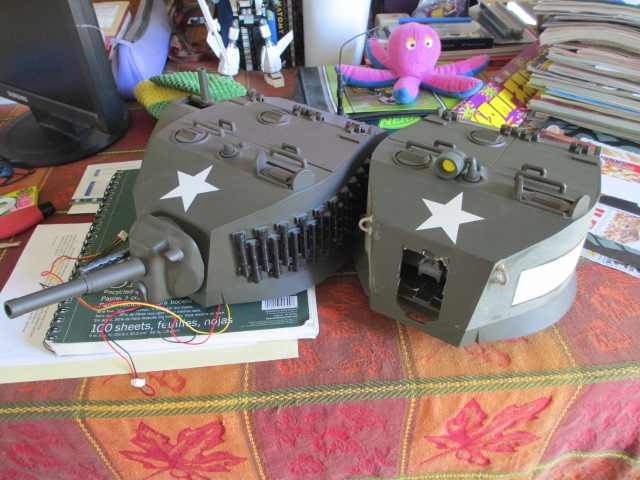

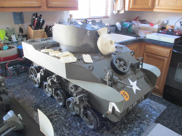

Deck and turret dry fitted alongside some more of the resin pieces from Mike.
Mikes turret next to the stock one.  Molded on grousers have been removed, again days of work saved.  Thanks, Mike!!
A view of the work done to remove the skirts and cut out the correct fender stubs.

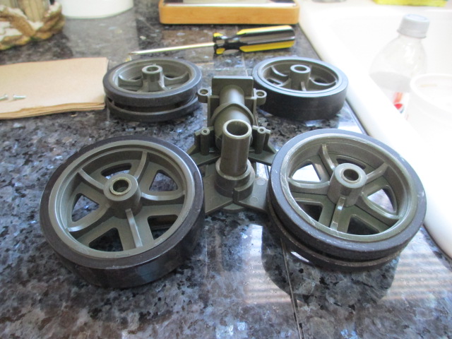

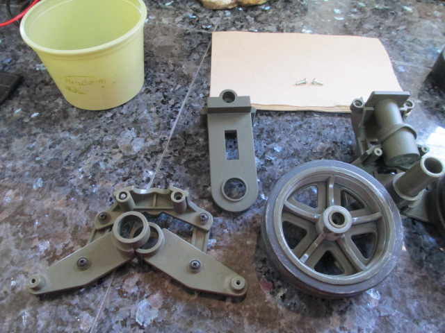

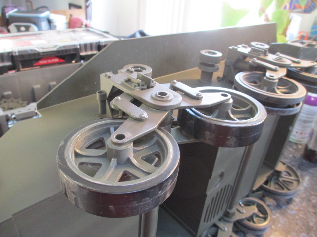

Spent a little time today taking apart and thinking over the Stuart's Bogie assembly. It is exactly the same as the one on the static version so the solid road wheel is a direct swap over. My thoughts on the bogies go in two directions. There are some beautiful resin sets which match the originals minus the working springs. With some work with wound brass strips, springs could be made to to match and work on these resin bogies. However, the site specifically states that their upgrades and add-ons are for static models, not RC. This leads to worries about breakages going over stones, etc. On the other hand, the stock bogies somewhat resemble the real pieces and are complex yet stout little pieces of kit with a working central coil spring. Also, resin detail kits exist made just to dress up the Stuart bogies and idlers and make them more realistic. With detail added and some basic brass collets made up and a lube job, those bogies would look great and function beautifully. So that's where I'm at today, considering the next steps taken for running gear. Also, I joined a 1/6 scale forum ( 6th Army Group ) to pick their brains and gain some insight on the Stuart and what the build requires that I might not see. Pics:
P.S. I have two folks who are interested in a set of the hull braces. If I can get a couple more, I'll ping Woz and see what it would cost to scan and run off 4-6 sets. I'll also have to find the original maker and ensure that it's OK to do so. If anyone one else wants a set, PM me please.
Sat back in place.  I'll go visit the hobby shop to find the thin brass tubing required this week.

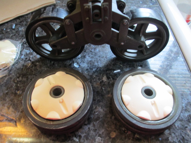

Solid wheel covers with grease zerks.  A little sanding is required to have these fit correctly.
Solid wheels are direct fit.  There is little plastic to plastic play nor wear yet brass would still benefit the road wheel mounts.
Complex yet strong.  The spring is in the cup on the center support.

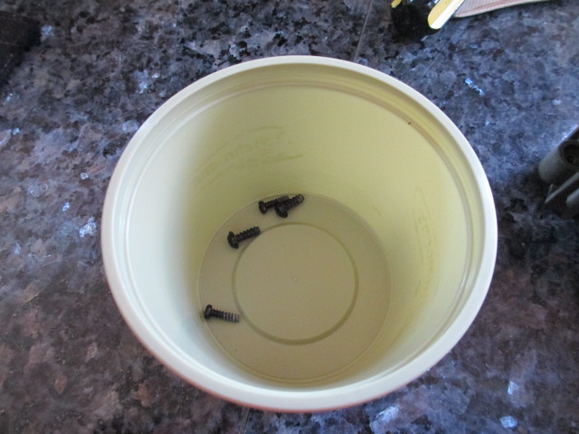

Four screws hold the bogie in place on the lower hull

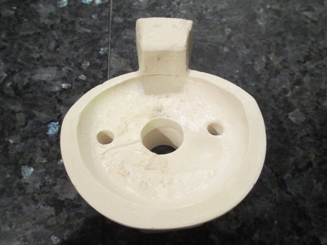

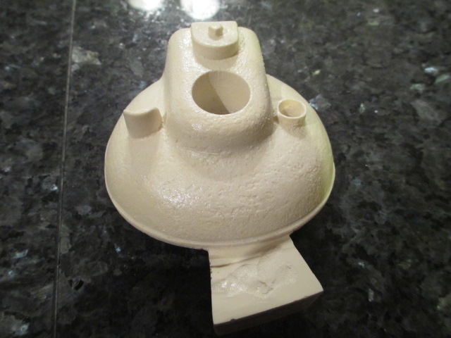

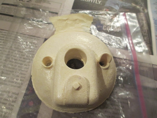

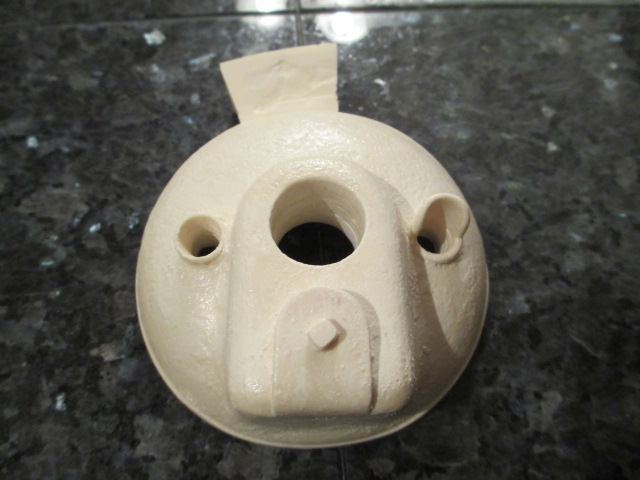

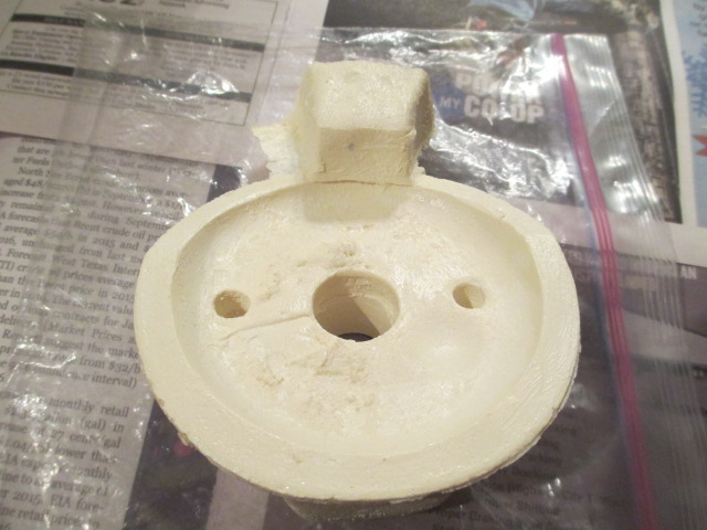

Still awaiting resin parts to detail and complete the bogie assemblies and outer lower hull. It's a perfect time after the Thanksgiving furor to turn back to the Stuart and get a little peace of mind. I need to make a silicone mold and do a resin pour to make a replacement early\mid production M5 mantlet. That requires some clean up of the 'master' to begin with. Pictures:
An hours worth of work produced a much cleaner piece to use.
An hours worth of work produced a much cleaner piece to use..JPG (94.89 KiB) Viewed 6107 times
Before I do a pour, I'll get out the Dremel and carefully clean up the back some more
Before I do a pour, I'll get out the dremel and carefully clean up the back some more.JPG (92.99 KiB) Viewed 6107 times
The resin was easy to work with a medium flat file and some detail files.
The resin was easy to work with a medium flat file and some detail files..JPG (90.28 KiB) Viewed 6107 times
it just needed cleanup before it could be used either on the tank or as a master to make another one.
Good quality resin and not a bad looking piece at all...
Good quality resin and not a bad looking piece at all....JPG (96.92 KiB) Viewed 6107 times
