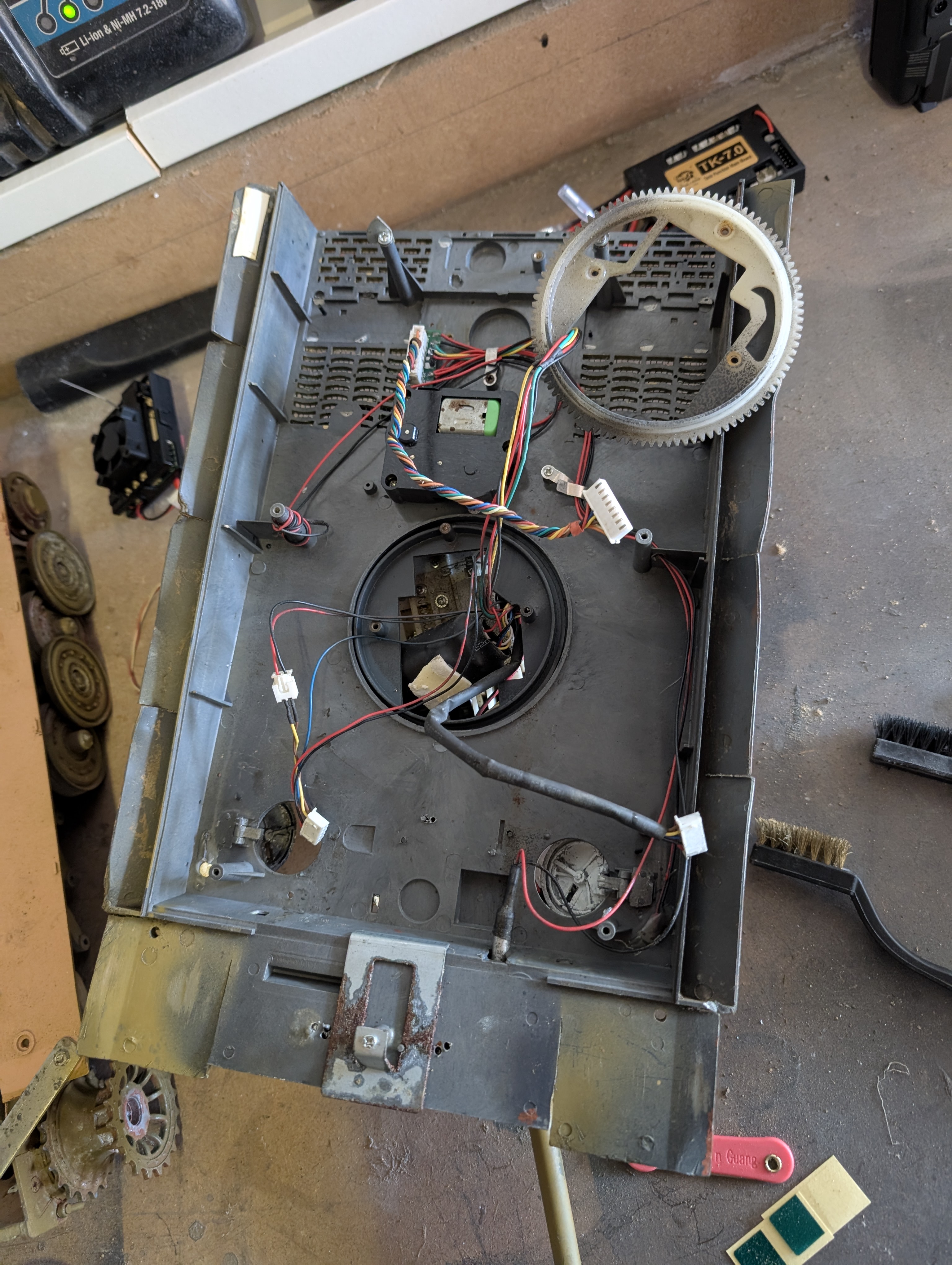

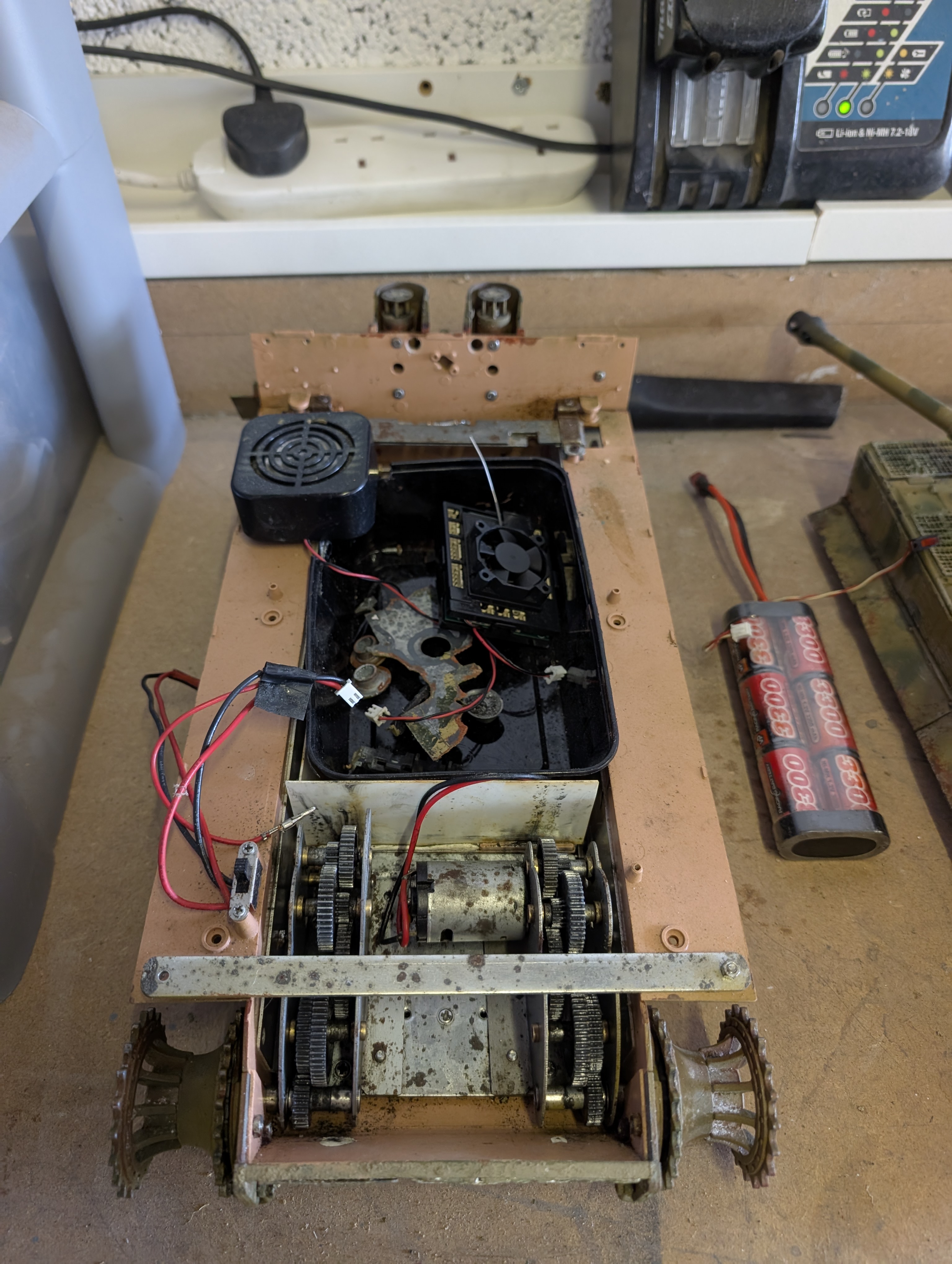

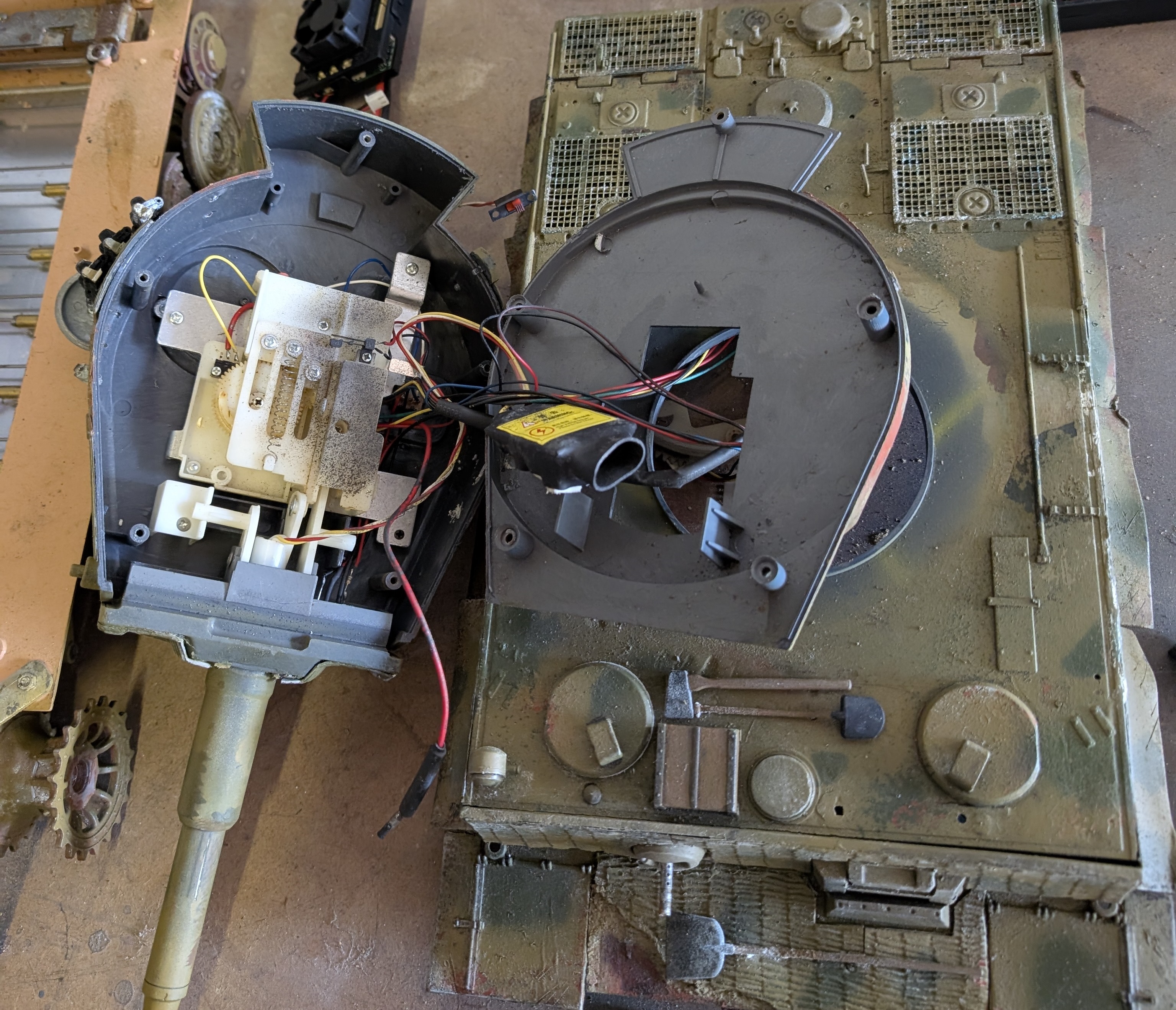

Small progress on the Tiger, managed to get the tank disassembled. And uncovered a load of surface rust on some of the interior components, so have started to clean that off.

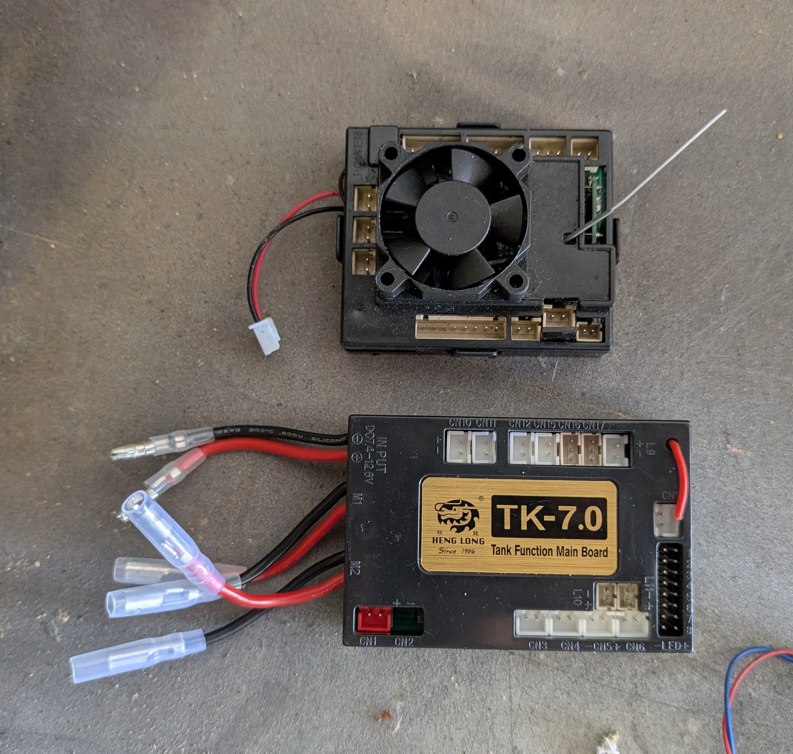

It also appears the Taigen - HengLong 7.0 swap will be a little more involved. None of the upper body wires will fit into the 7.0 rx.
Step 1 is getting the wheels rolling, and the sound booming, then I'll tackle each component as they come. It appears the old smoker is not compatible as well.
All advice welcome, I do note the 7.1 board would have been a better choice, but I have a 7.0 now. Same with the motors! Gearboxes are running smoothly, so no worries there!
