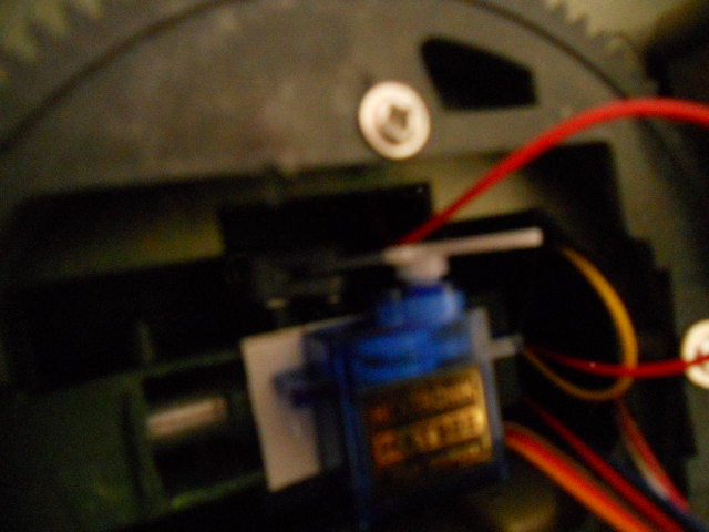

Having now pulled apart the turret and hacked the recoil unit in order to fit a servo recoil, I realise that the tank is actually a standard HL Panther colour scheme that has had a coat of dark satin lacquer applied to it. The effect is actually very good, but what they have done is simply sprayed a pre-assembled tank. The underside of the barrel, the upper hull under the turret, and the parts behind the mantlet are still the original colours.

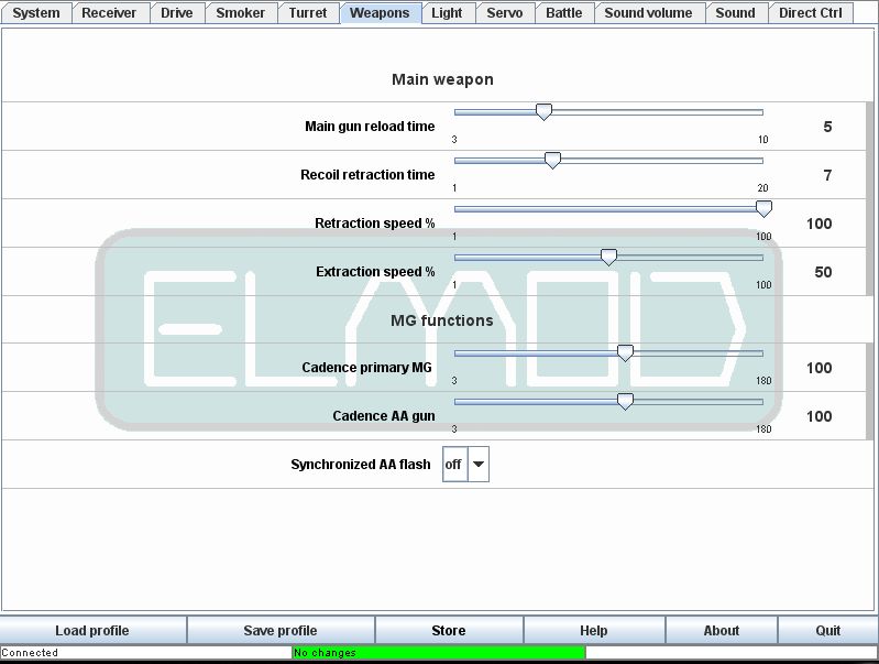

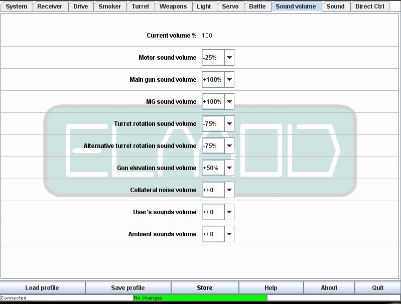

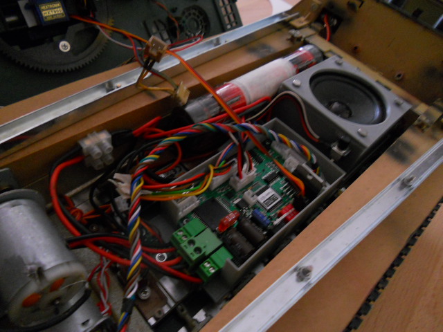

Programmed the Elmod, the sound for each channel can be adjusted on a slider bar on my pc, whilst plugged in via a usb. By sliding the bars and running the tank from the screen, I have been able to change the set up so that the engine sounds are a lot quieter but the main gun and mg are nice and loud. Amazing flexibility on these boards, I can change the sound amplification from -100% to +100%, and anywhere in between in 25% steps. This means no more headaches in the scout hut. lol. I can even click on which gun sound etc I want from a menu and play them before I select the one that I want to upload into the tank. Changed the turret rotation too so it starts off slow, but can then be accelerated up to a good speed when I need to hit those pesky Shermans.

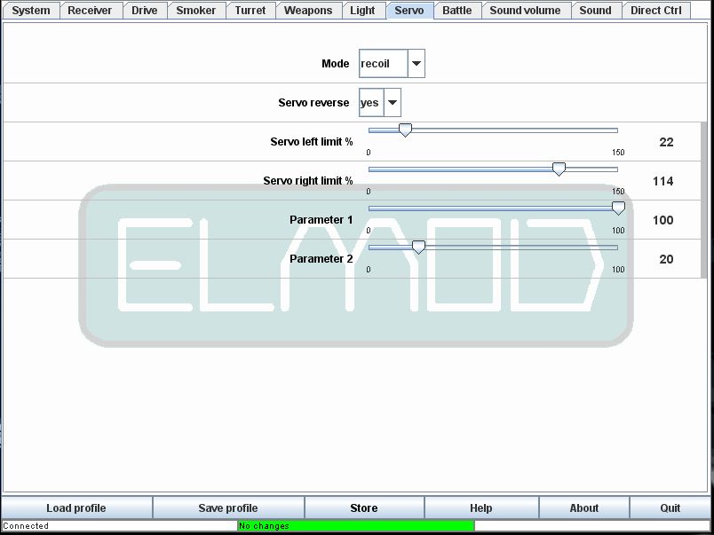

The servo recoil movement on the HL units is quite short, and a servo throw is too much, not a problem, I can just slide a couple of bars around on the screen and watch the servo being moved to where I want it to start, where to stop, how fast to move back, how fast to move forwards etc.

I used the recoil unit on the IR version that I have. There is a slot in the side with a tab that sticks out, the spring is normally attached there. I took the unit apart, stripped out the motor and gears and cut the bottom off. Screwed what was left back together. I then mounted a link between the servo arm and the tab.
The Elmod board has a usb port. I just plug the cable into the board, and click to run the configuration software. This is a multi screen system that allows you to adjust anything and everything that the tank does. So, I click on the servo tab, I then select recoil from none, recoil, or steering. Start the tank on the tx. Fire the gun, see where the recoil starts and stops. Move the sliders on the screen so that the servo will start with the tab at one of the slot, and only travel as far as the other end of the slot. Hit Save, and job done.
If you had a Tamiya with recoil there is another screen where you can do the same with that, as well as adjust the speed of the recoil and rebound etc.

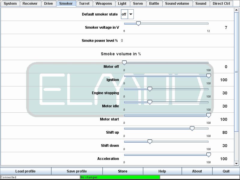

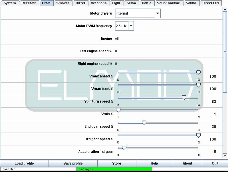

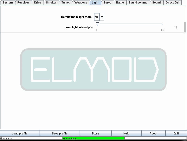

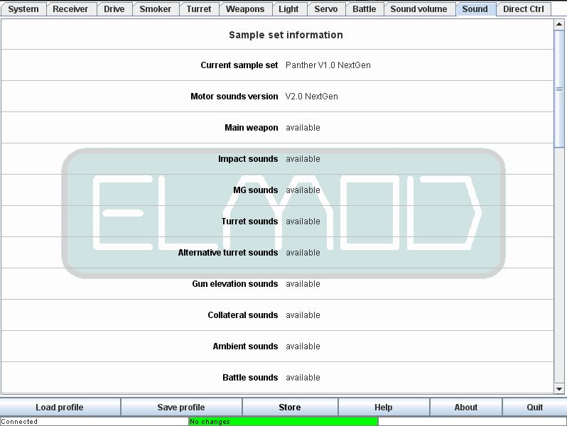

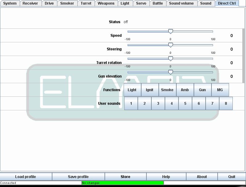

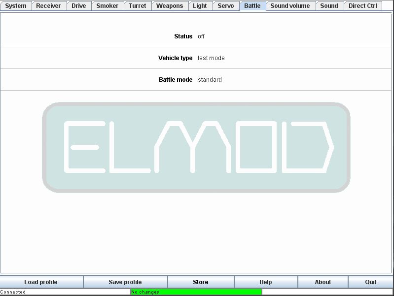

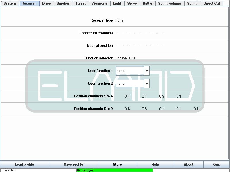

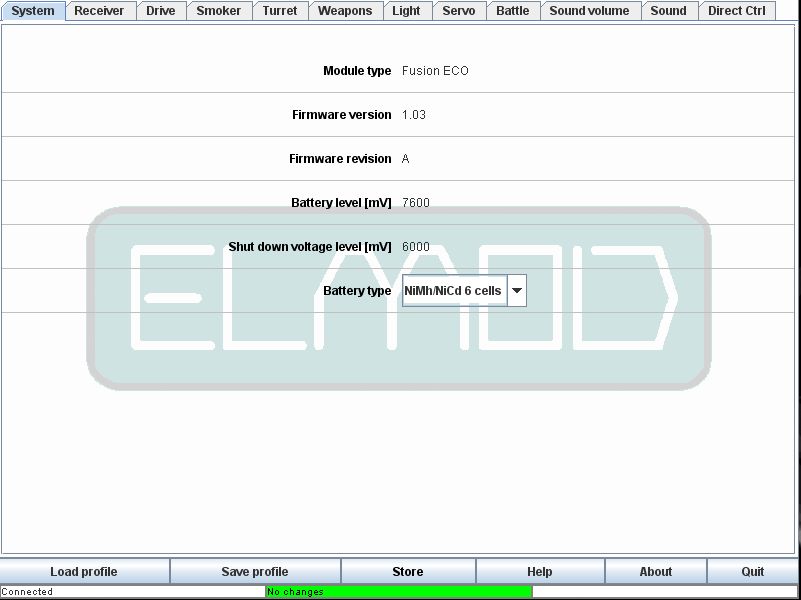

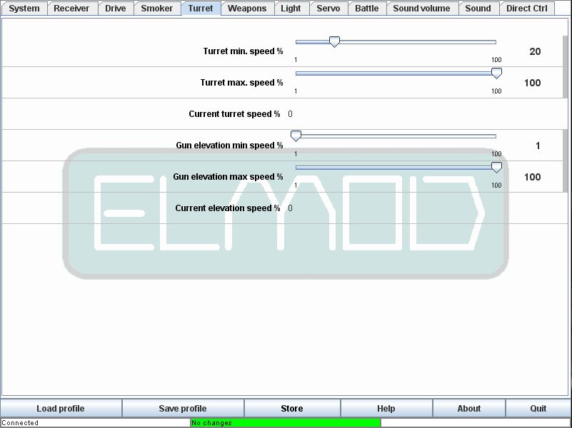

Video is uploading but here are screenshots from the configuration software. There is another program that is used to handle the sounds on the SD Card.
- receiver.JPG (60.34 KiB) Viewed 5761 times

- turret.JPG (59.11 KiB) Viewed 5761 times

- battle.JPG (47.24 KiB) Viewed 5761 times
- sound.JPG (71.49 KiB) Viewed 5761 times
- sounds1.JPG (69.54 KiB) Viewed 5761 times
- direct.JPG (64.12 KiB) Viewed 5761 times

- System.JPG (57.19 KiB) Viewed 5761 times
