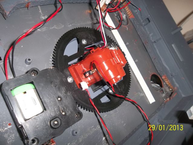

it the 2 wires at the back of gun

Its not the flash but the micro switch for triggering the track recoil I believe. Is your tank a Airsoft BB ? Did the tank rock when you fire the Airsoft/BB before ? It should still go into CN3 but to the track recoil and not the flash. So it is either PIN 3/4 or 4/5. I have to look again.

yes tank rocks back when i fire
Re: RX 18 wiring??
Okay, I think all you need to do is plug it into the last two (Right 2 pins of the 5) pins on CN3. Since it is just a contact it really doesn't matter which ones goes where. If you want to make it more permanent, you can do the cutting the notch thing on the 2 pin plug, but in this case since you are plugging it into the right side, you will need to cut the left down arrow notch when you looking at the notches. Just jam it into the right two pin first to make sure everything is working before anything else.

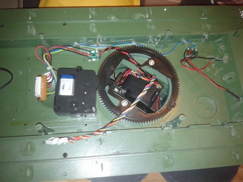

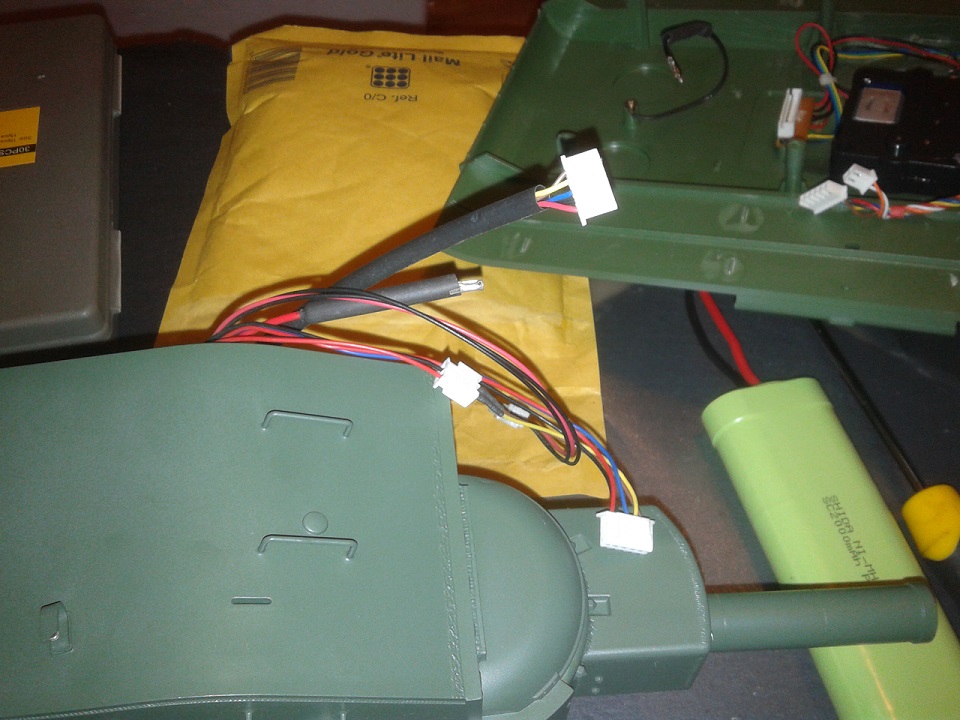

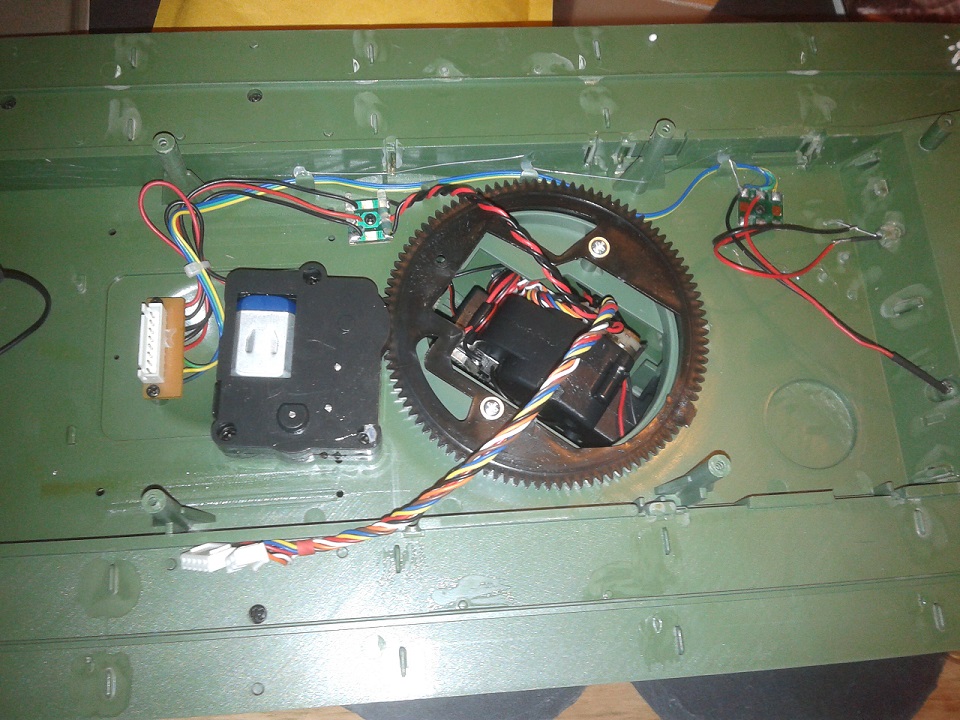

I'm trying to figure the wiring out for a KV so I can swap the turret to a KV2. I think I can trace the wiring from this http://battlearmorrc.weebly.com/uploads ... 7_orig.jpg to figure out what pin does what (the main problem is the connector to top left of centre). This includes putting connectors in place of the soldered joint. So hopefully can't blow the RX board up.
However, is there an easy way to ID which of the 5 pin plugs is related to the two sockets on the board?
I will be using a Multimeter.....
Once it all works I've got a recoil limiter board to fit..... If I get one of these sets http://www.ebay.co.uk/itm/2x-JST-XH-con ... 35bb705e62 can I put female on both ends of the slip wires and use the male one to connect the turret female plug to the slip ring female plug?

Hi rob,
5 pin with heat shrink on wires is for IR
5 pin with a small 2 pin plug goes into flash
3 pin needs to go to the small square pcb on the lid near the 8 way socket.
Thick wire to battery negative.
And in the turret there is a switch which turns recoil off, so make sure it's on so it all works when wired up.
Ian

Thanks. I thought the thick wire was for the aerial as it's the same connector as the one in the hull? There isn't one in the KV1 turret.
What does the 3-pin do? Any idea how to ID which black wires to pair up?
Re: RX 18 wiring??
The thick wire does use same plug as the aerial and then to confuse people more their use red wire. To connect to the negative!
The 3 pin is for recoil, elevation, common positive, your tank lid has these three wires on the small square PCB. Unfortunately tanks I’ve had have never followed a set colour means X, so you’ll have to trace the wires back to the plug and work out from diagrams.

Just to confirm - these are the connectors for the RX board etc? Any recommendations for crimp tools, or are pliers OK?
