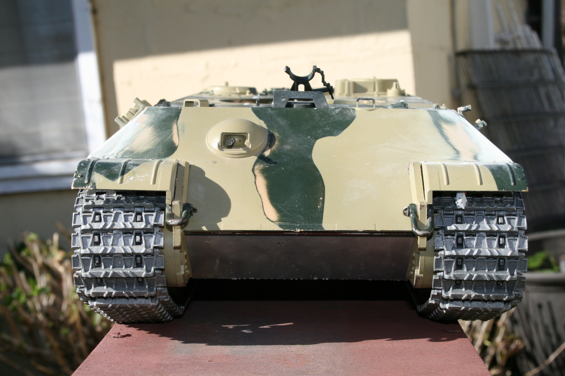

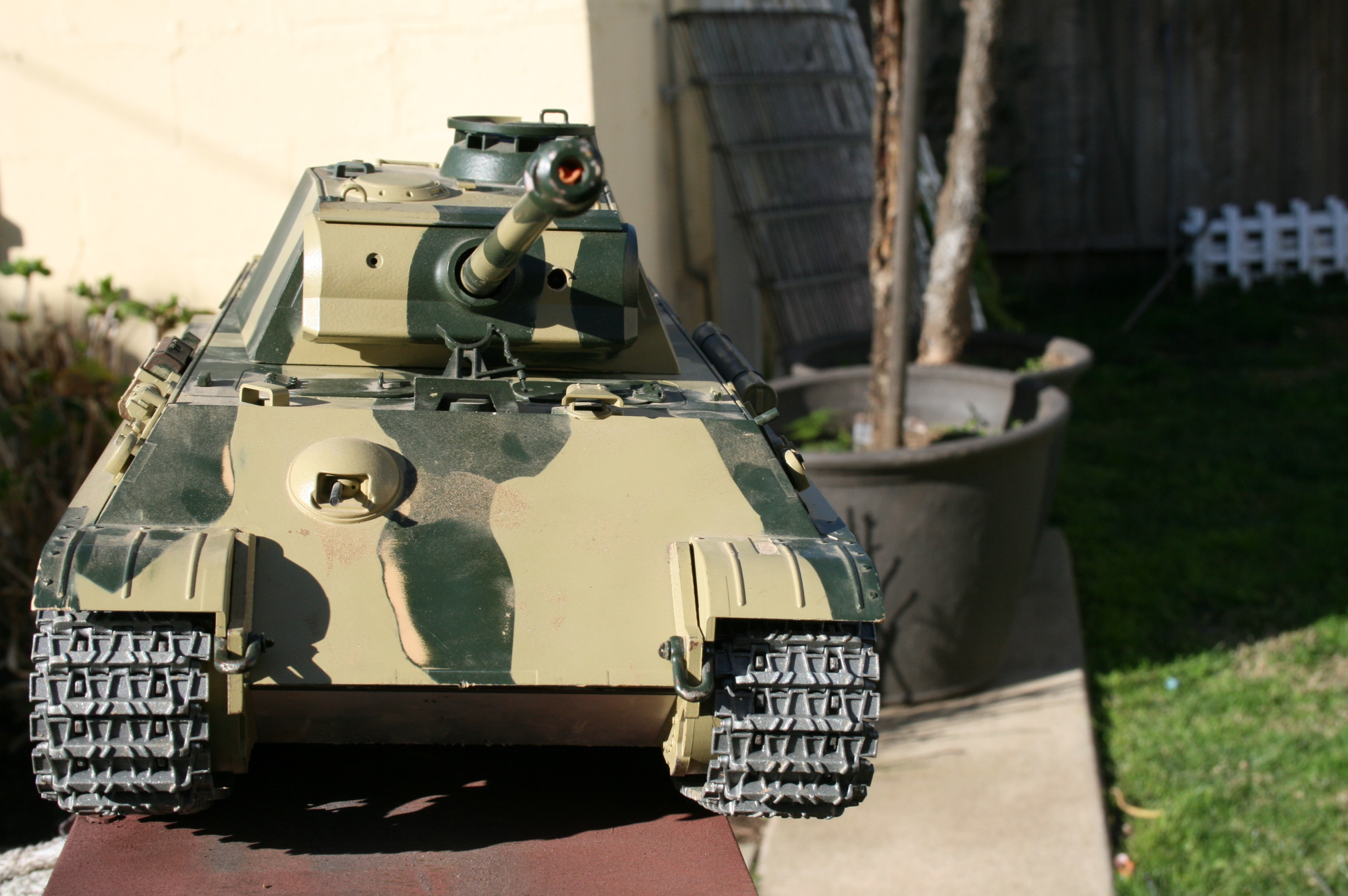

Sorry to hear that, but you made a great recovery. That was the first thing I did. I told myself if I can get the right slopes I will continue. And after several hours of cutting, piecing and gluing. Walla success. Here a before and after pic of the front.
You have nothing to fear, but fear its self. Or maybe a KT too!

I noticed from one of your earlier pics Richard that you had filled and sanded the front hull corners. I vaguely wondered at the time why you had done that - duhhh!  :/
Great work Richard. Can't wait to see what you've done next on your 'D' (after the parts arrive that is - Tankzone are not noted for their fast turnaround!)
Never mind, I'm nearly back on track again and - like all these things - I find I do things better the second time around! At least the turret fits better than it did before.
