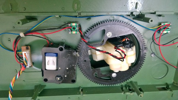

O.K. You will need to take the hull top off . There are 8 crosshead screws to remove - 6 on the bottom , 3 along each edge . Then 2 on the sides , one each side near the top front of the sprockets . The upper hull will now lift off :thumbup: Be careful not to lift it too far as there are wires between the two . Unplug the 8 wire connector , also the single black aerial wire ( this connector is covered in heat shrink plastic ) As your KV is an RX 18 type you will see a small square circuit board with 6 wires on it connecting the turret to the hull loom . You can check the motors here - the red is positive , the black negative . You can use a battery here to test if the gun/elevator motors are working .

Panzerhun
Posts: 88
Joined: Wed Mar 18, 2015 11:28 am
Location: Bradford
Re: KV-1 1941
Post by Panzerhun »
Inside.
