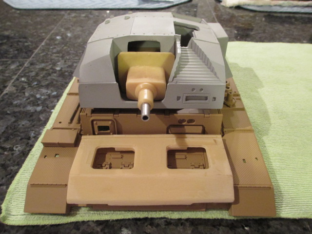

Forgebear is back in town and the much anticipated Tauchpanzer upper is on the way. I wasn't sure why this was required to do this build other than that the rear engine deck is a solid match for the early StuG. Looking at the resin kit and the 1/35 scale Tamiya and at the fenders on Panzer IIIs, it became clear. A good part of the panzer upper needs to be removed for the resin casemate to sit down into the body. It works on a Panzer III since the body does not impinge on the fenders unlike the HL and Taigen StuG 'F'. Time to hit the books again. Thanks to Sassgrunt, I can. ;o)

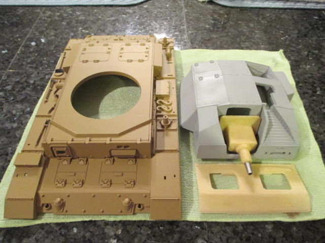

The Panzer III upper that Forgebear has located for me came in last night. It had been a while due to weeks of very bad weather back East so I was very happy to see the box arrive. Now, I can do some actual work on this thing. With the upper deck's arrival, I need to get off the pot and decide if I am going to use a high end Taigen IR Stug for the lower and recoil mechanism\electronics or a HL type Stug with the different type of IR gear or just piece things together and buy the Taigen components I actually need. Decisions to come, Pics now:
A very close fit.  Exactly as it should be.
I can see that some work will be needed to carefully remove some of the tools and mounts but not as bad as if I used a  late Stug III upper deck.
