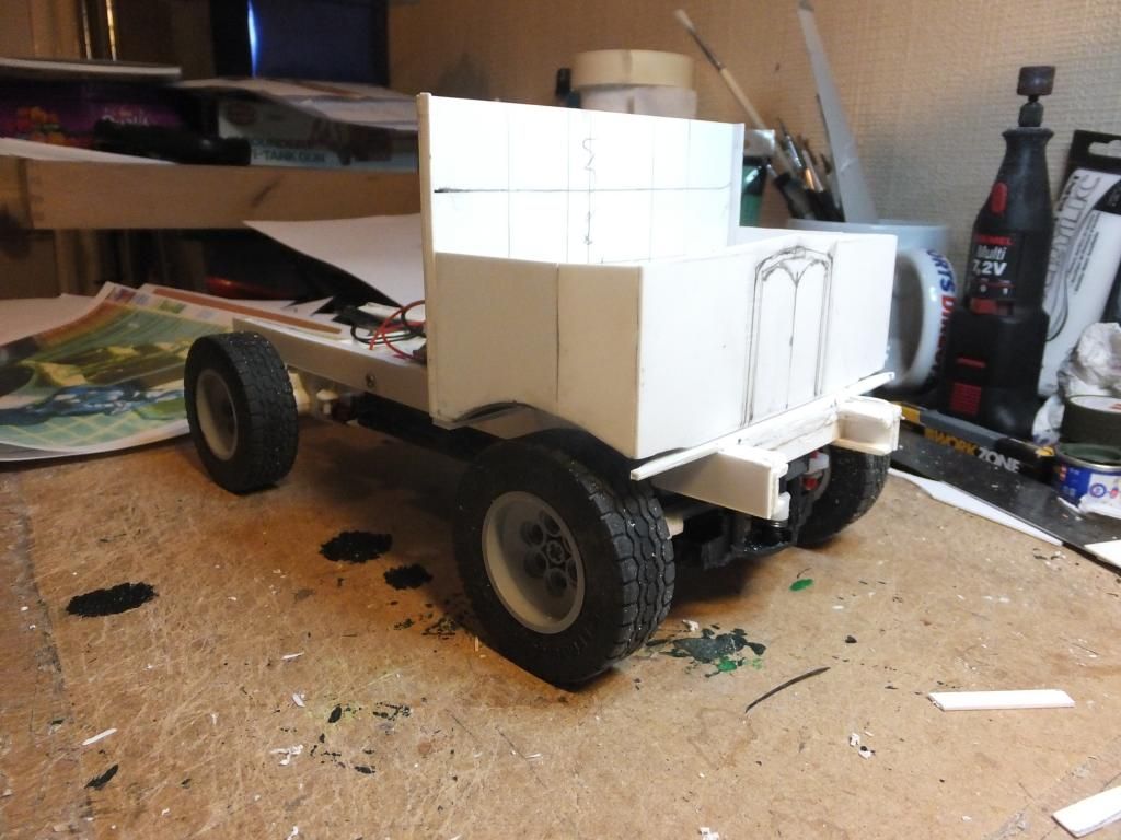

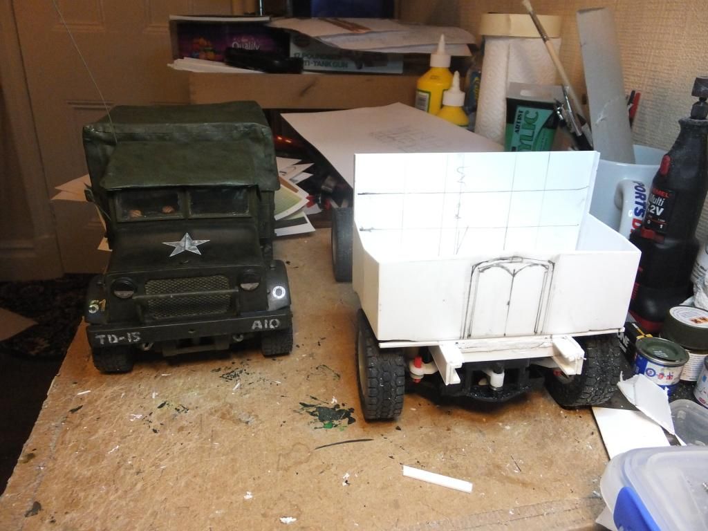

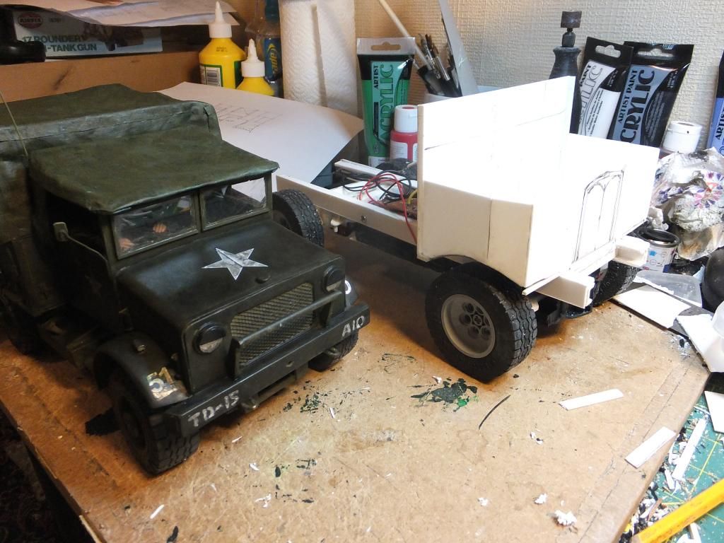

Things progress despite the pc board and the cab is started. I didn't appreciate until I did some research yesterday that the matadors engine was mounted slightly off-centre and the drivers position is very close to the centre of the vehicle! I wonder if this was to give the driver a better view or because of all the fancy knobs and levers in the cab? Anyway here it is, I've put the bedford in for comparative scale.
Before working on the cab detailing I think I'll get the load bed structure put together so I can see the approximate proportions and see the overall effect/size.

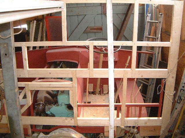

Hi Herman, I'm not sure, but here is one of the pictures I'm using as guide to the build. Maybe the transfer box was off center?
Anyway it all makes for an interesting build. Some of the images from google have been really useful in getting detail for the cab.

Re: AEC Matador gun tractor 1/16 scratch build
Owned an RL bedford army truck once.............similar set up. The pic you have seems to not have the pronounced slanted engine block like the '70s vans or my RL, but the transfer linkages and other hardware seem to be consistent with that style of utility engine/running gear. Off set steering because of angled engine.
One thing you wont have trouble with Im sure is keeping brakes up to the damn things
