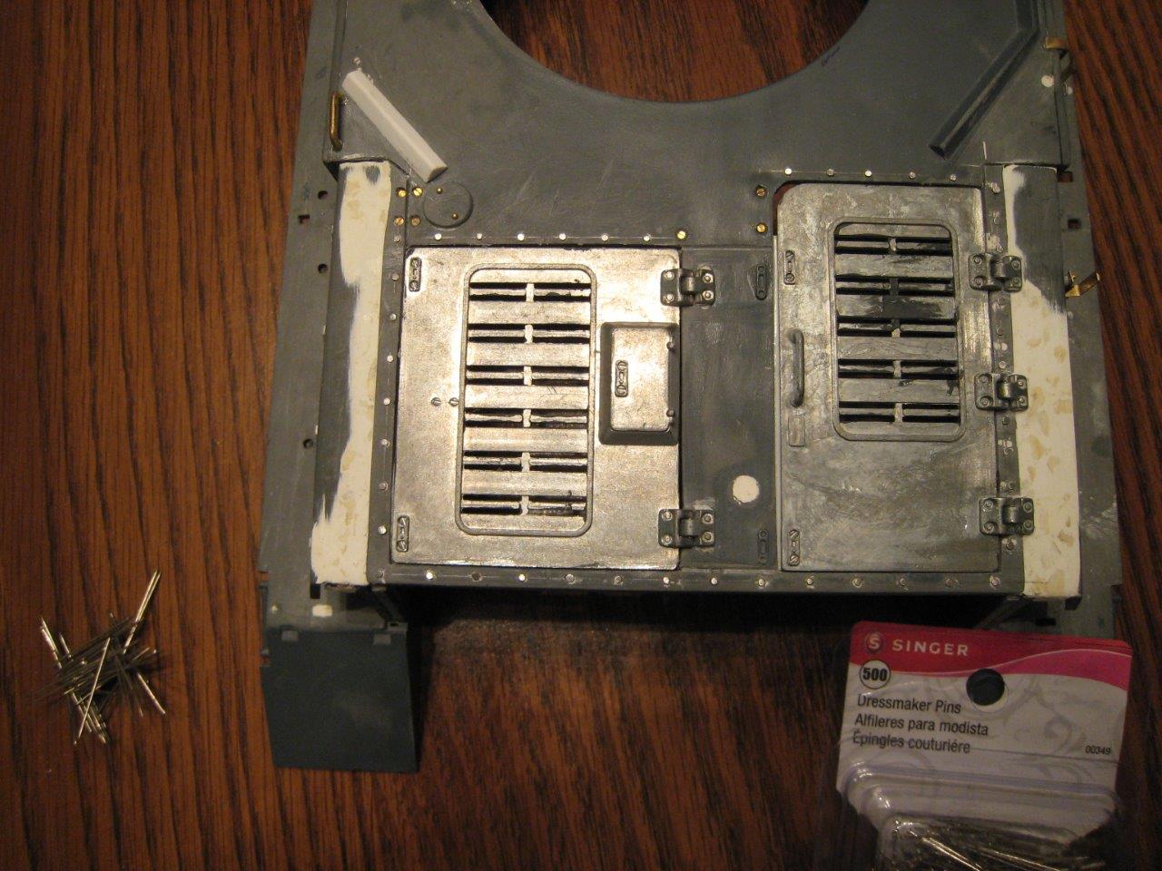

Did a little more work on the rear deck.

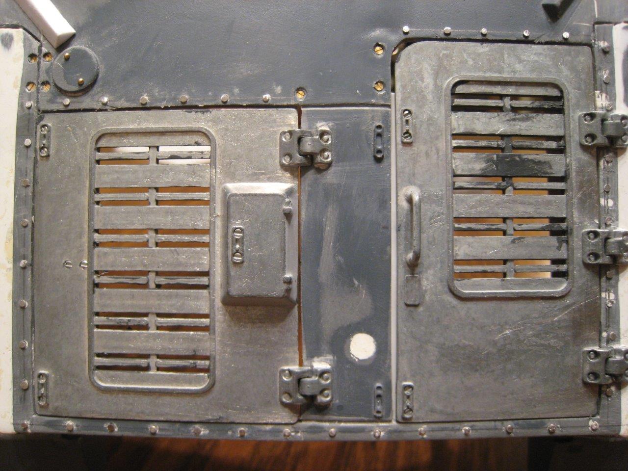

Rear deck bolts: the holes in the rear deck around the engine hatches were bugging me. I had already replaced the upper hull’s other bolts. So, something had to be done with this. The few clear photos of the rear deck that I could find showed a smooth surface as if whatever bolts were there were later replaced with welds. However, I found a couple of photos of a H and a J that showed smooth, flat bolt heads that were just above the surface. I used some sewing pins (aka dressmaker pins) to replicate these bolts. After gluing the pin heads in place, I filed them so that they looked flatter and thinner. That looks much better.
Fuel Cap: So, in doing the other work, I flattened out the small knobs on the fuel cap. (At least, I think it is the fuel cap.) So, I replaced them with 1.2-mm rivets.

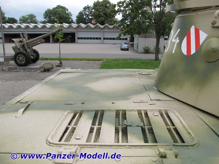

One question for you out there: I put in bolt heads across the top of the right engine hatch. HL didn’t put any divets there and I can tell in the photos if they should be there or not. I did it for symmetry. Does anyone if they should or shouldn’t be there?

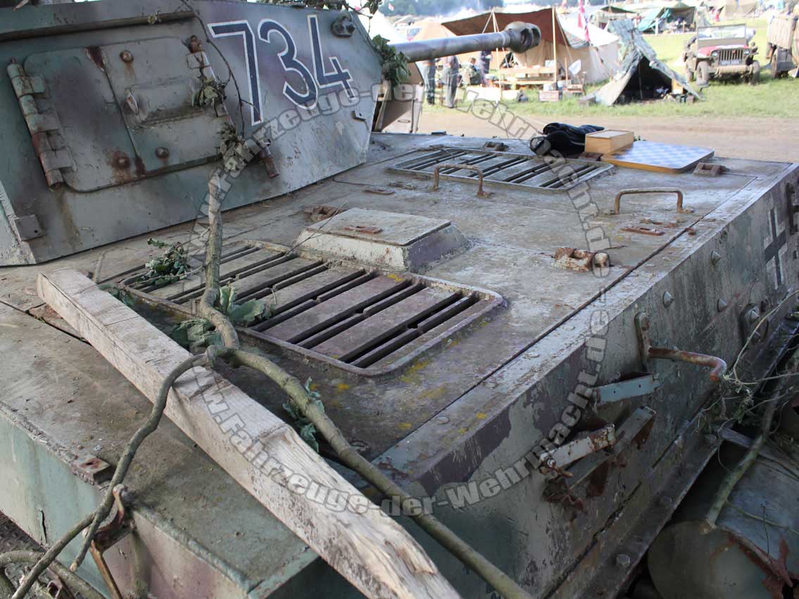

Philipat Hi, I wonder did you have to spend time on the Engine hatch hinges because it seemed like forever before I had freed them enough that the hatches swung open freely, and I notice the photograph of "734" taken across the engine bay shows two handles,the one nearest the back of the Tank was probably added after the Tank was captured, simply because the German Tank crews learnt very early on that Russian soldiers needed little in the way of invitation to climb on and pour gasoline(petrol)through every opening they found then set it afire.I cannot help you with the detail around the engine hatches there is very little in the way of detailed pictures of that part of serving PZ4s, loving this build.

I've seen several photos of the second handle on the right hatch. Even a few with a handle on left hatch. Both appear to have been field mods done later in the war. I still might do one on the left hatch just to make it easy to open because I plan to put switches and all under those hatches. Before I installed the hatches, I filed the hinges quite a bit to round them out. The open freely now, but probably wouldn't have if I hadn't done that.
