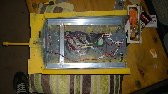

braced the top hull tonight by epoxying some aluminium L shaped strips in, its made the top hull considerably stiffer and my top/bottom hull fitment issues are nearly gone!
had to remove the plastic bracing and un used mounting posts with a sanding wheel, also smoothed flat any underside protrusions from the tool mounting holes etc.
just going to duct tape the cables to the top hull now to keep them out the way, may and a smaller flat brace to the glasis and bow plate at a later date but am happy with it for now!

Didn't realize how much more stress that metal turret puts on the hull...Thanks for posting the tips Sponge :thumbup:

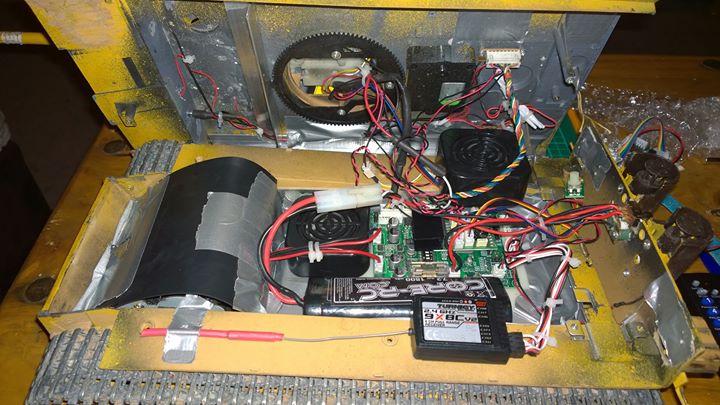

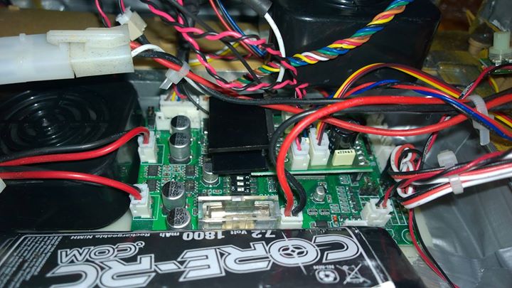

Fitted a TPA tonight so can now use 2 speakers at 6w each, although its becoming a wiring jungle in there now can set levels of engine/sound effects separately and It sounds sweet! Also fitted gearbox shield using some plasticard a I thermoformed, put some finish line wet lube on gears running alot smoother and quieter now! Also shield stops lube going everywhere!
TPA close up, its in there somewhere!
Plan on future speaker upgraded (taigen improved at min)
Any suggestions what will fit? As am gonna need 2!

:haha: :haha: Isn't electrical work fun? :haha: :haha: :haha:

Its fun when it works! Unless you end up wiring it up, rewiring, then realising you were right first time! Just wish it was a tidier setup like everyone else! And no room for a smoker now unless I reposition the second speaker on the upper hull superstructure, may do in future!
