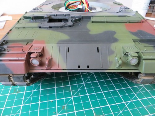

So this is a problem:
I don't really want to file down the metal rods inside as I fear it will warp the top deck. The gap is exactly 1mm, so I've ordered some 1mm plastic card to fill the gap.

Re: billpe Leo 2A6 build
Hi billpe
When you made up the shim for the turret did the shim go between the turret ring and hull or turret and ring??
.I'm at the stage where I will be fitting the turret/ring to. On the color chart the gap below the rear of the turret is rather a large gap. Any info would be great.
Best Regards, Brian...
I've not completely decided yet, but probably between the hull and the "turret base" part. Putting it else where could interfere with the turret rotation motor gear getting full contact with the ring. The problem isn't so much the back of the turret but the front hitting a grazing of parts and the two oil coolers when its 180 degrees around.
Since I've ordered some 1mm sheets, try and make a complete disc to sit inside of the recess between the hull and the turret base and see how it works out. I won't finish it until I've filled that gap between the two hull parts so will give me some time to think.
Hi Bill
Spot on with the shim for the turret made one today 2mm fitted to the recess on the hull. You have to make two small cut outs at the front of the shim so it sits down.Turret spins like a roundabout now
+ the 1mm shim at the front
All the best, Brian...
