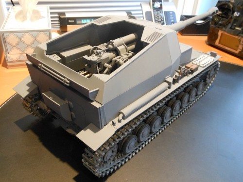

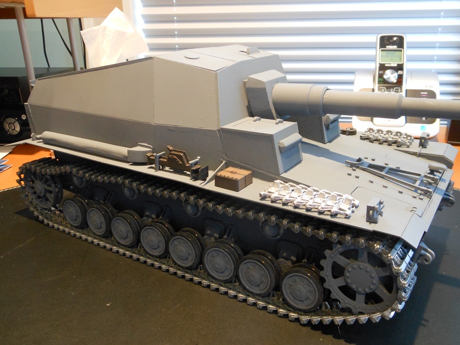

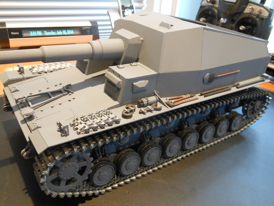

Latest update...... Done for the time being. Metal pioneer tools, jack and block added as well as barrel cleaning sticks. Everything is working. Just need to figure out how to make it IR battle ready or might not bother. Also include a new clip of the open cab recoil.
