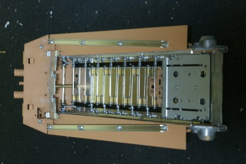

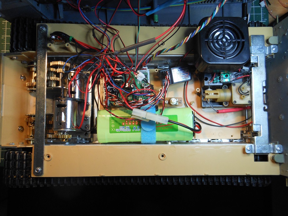

I think Alpha is right, the metal/aluminum base flexes, and because there is no plastic side braces like in a regular plastic hull to hold the side hull as it is just attached to the metal base and there is all kinds of twisting happening. As you can see in the picture, the front brace helps with the warping, and the back end latch actually also acts as a brace to pull the sides together.
My gap in the middle is not that bad and it just a little below the upper hull but I am very tempted to add in my own middle brace just to hold everything together nice and tight.

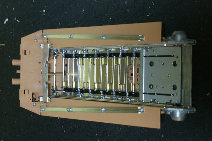

BTW, the Taigen Panther hull was even worse in terms of warping but they use a different way of strengthening the lower hull by adding a strip down both side....... I have to ask what the bars are for when I first got the hull from Dom @ rctank.de. In hindsight I think the Tiger I way might be better.

Well, if the flat section over the tracks are sagging in the middle then the Panther hull brace would work since it pulls the middle up with the front and the back. If however the sagging is everywhere (i.e front to back not just in the middle) then you would need the cross brace like the ones in the Tiger, probably one front, one middle and one back if you don't have a latch mechanism at the back for locking the upper hull. That should fix it.
