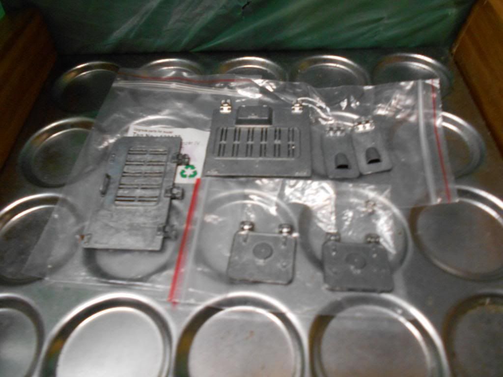

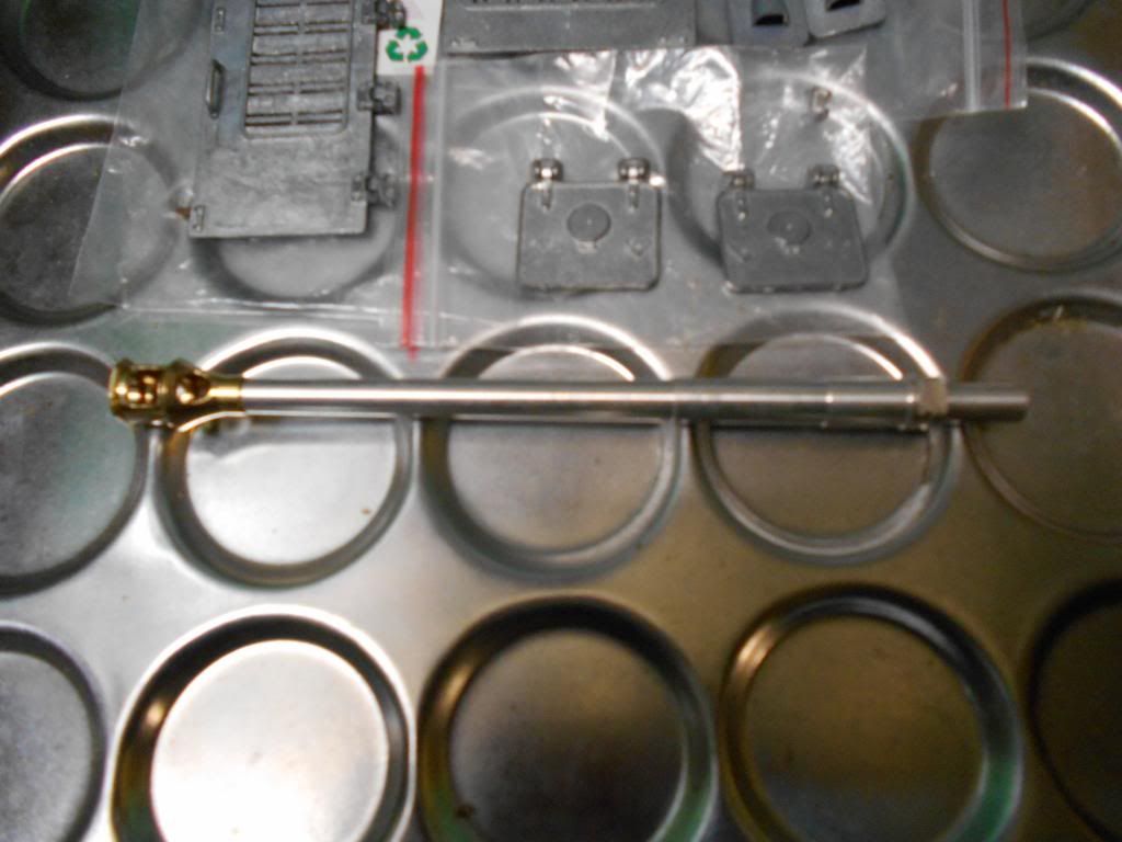

Some parts came in yesterday...
I should have got these from Forgebear.... I assume they are Taigen...problem...unlike the Mato hatches Forgebear sells... there are no hold down bolts on the hinges ... they have to be glued...I am really questioning the quality of Taigen... they may have metal parts on their Tanks...but if they are glued on... they can be broken off :thumbdown: ...not sure if it will be worth the effort to use these... lesson learned
Very nice barrel..well made... will not use this for the Panzer IV as it is meant for IR...will probably use to replace the barrel on my Stug :D
Panzer Vor!!!!!!!!!!!!!!!!!!!!!!!!!!!!!Image
Posts: 7858
Re: PANZER IV F2 Girls und Panzer reVAMP
Good Afternoon,
I went to the IMEX\Taigen site and compared their set with what you have here and this set has more detail than the Taigen offering I found there. There is no handle on that large hatch and on the other large hatch, the grill is solid, not cut out and the hatch edges are rounded on one corner... I'm not sure what this means but when I receive metal that I am expected to glue on, I drill a hole and pin it so that I can drill a hole in the surface it goes on and have a pin to glue it in place with. The barrel looks nice at least.
Hey there Painless... they are taigen.. Welsh dragon carries the same ones under AsiaTam and Taigen
The difference is Asiatam is ala carte you have to buy two sets
http://www.welshdragonmodels.co.uk/asia ... -967-p.asp
http://www.welshdragonmodels.co.uk/asia ... -389-p.asp
The Taigen
http://www.welshdragonmodels.co.uk/taig ... 1939-p.asp
From IMEX
http://www.imex-model.com/product/TAG12 ... tml?cid=90
Anyway Painless..I made a mistake... Dave carries the same set... apparently it's the only set on the Market if I can think of a viable "strong" way to use them.. I might.. thing is... and this is an advisory to others as well... the Hatches molded on the Heng Long actually look better :thumbup: ...think hard about these...they aren't that great IMO... Money burned... Lesson Learned ;)
Thanks Painless

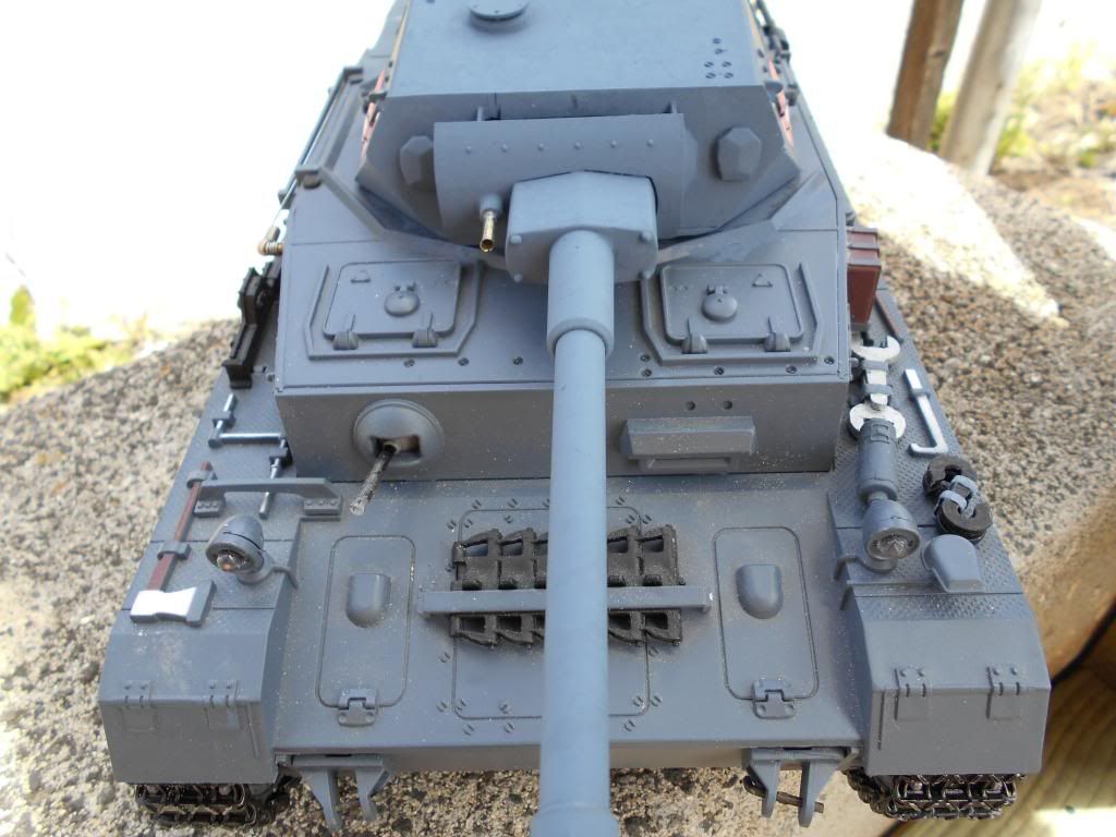

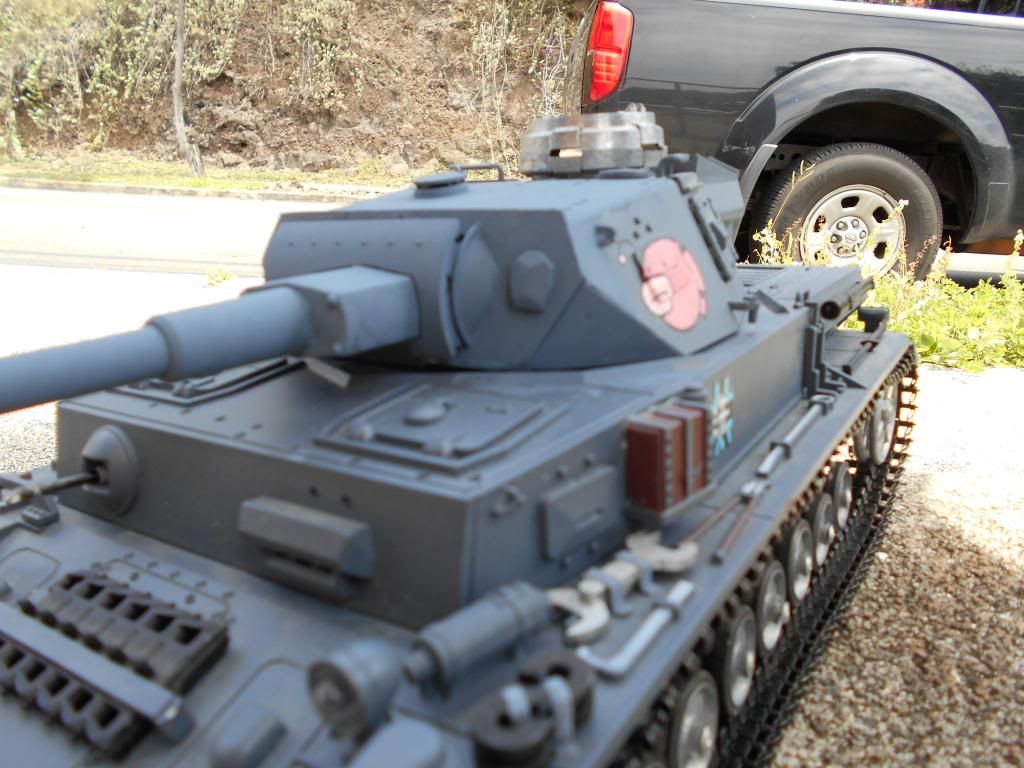

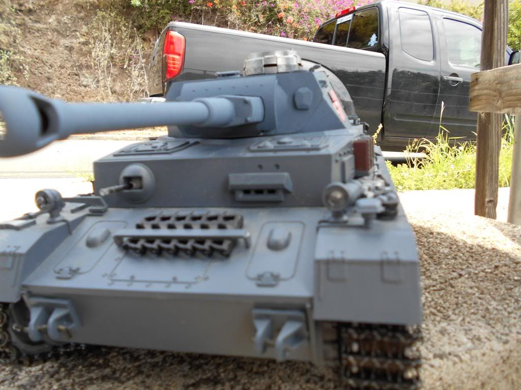

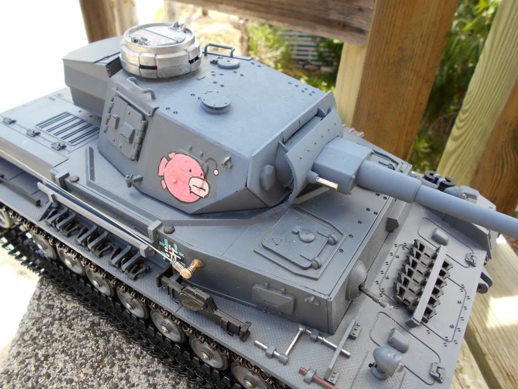

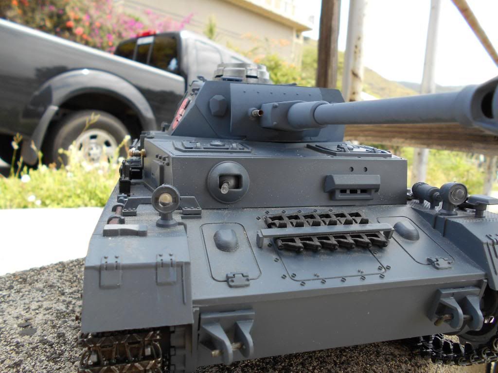

18 Hrs ... And now my Panzer IV is a Panzer IV :crazy: Something always bothered me about this Panzer IV ... it's a nice tank straight out of the box...but there was something about it..... Since I've done more research on the tank... I found out what it was...It's the turret... Heng Long put a Panzer III turret on a Panzer IV chassis... along with a longer different barrel :O
Anyway ... this is the result... lengthened the turret little under 1/4 inch around the armor plate....redid the mantlet
Also mixed up a batch of paint... what do you all think ?

Apologies for not having pictures of the process when I did the mod to the turret... It was quite extensive... and pretty much a spur of the moment decision to make the change... as initially I had thought I would just mod the mantlet
These are some before pictures from my Hazardous material thread...
This is one of the photos that prompted the change
There was a lot of work done... the machine gun was moved the left vision port.. the armor plate had to be adjusted in four different ways... locking pins relocated to mimic the stock mountings...all to get the side covers closer to the mantlet as well as close the gap that exposed the firing mechanism
You can see the extension by comparing the distance of the screws on the top of the turret
