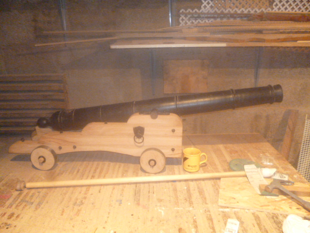

whilst you are on about guns,and the accuracy of certain weapons as opposed to others....i prefer this myself....i made it out of a big chunk of seasoned English oak,..the barrel measures 40in ...and it is made of oak...with a 49.5mm steel scaffold tube down the centre, the bore is 41.5mm ..which is just perfect for the bucket load of 41mm golf balls that i,ve got....the propellant..can only be purchased around guy fawkes night or christmas
..the limber is also made of oak, and the wheels have steel bands ..just like a real one....the coffee mug...shows you how big this is....it would make a great signal cannon....maybe i should advertise it on here..for a swap...

Earwig, that's a mighty fine cannon.
I know almost nothing about ships' guns of that period so tell us if it's based on the real thing (and what it is).
My dad (who is now in his 80s) built a much smaller gun like this when he was a lad. Still has it. It has the ramrod and everything. The barrel was turned on a lathe and it was made to fire ball bearings (the REAL bb's).
When my brother and I were young he tried to get some gun powder to fire it for us. It was the 70's and the IRA bombings were at their height in and around London. It was not a good time to walk into a gun shop (in Guildford!) and ask for shot gun cartridges without a licence...

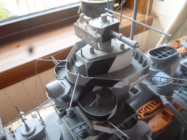

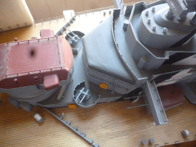

thankyou for the links,..I too have this great love affair of German Warships,..which for me were the best of their time,...this one that i have,..is a very good looking model,..however it is not what i would call a Purists model,...it has some faults,...but..i am not a Purist,and i will lve with the way it looks,....when this model is 20ft from the shore,..it loooks the biz and sails very well,....I will post pics of her when I next take her to the pond,...my other big ship is the Scharnhorst,..same scale,...and she too sails very well,....
now to the cannon,..this particular model is styled on a Culverin...which was a 16/17th century long barreled, small bore cannon,...designed for long range,....i got the idea of making a working wooden cannon,after stumbling upon a site in Texas that makes ornamental wooden cannons,..full sze one,s, ..that are very expensive,but..they don,t fire,...I wanted one that could fire,...the barrel of the one above, started out as a 40in x 6in square piece of seasoned oak,..which was then cut length wise in half,..then both sawn surfaces were planed ..then a router was used to remove a 2in x 1in channel in the middle of both halves,..then a 49.5mm scaffold tube that had been plugged at one end was inserted in the channel, and both halves were glued together,using polyurethane glue,...then afterwards the wood was turned on a 52in lathe,....the carriage,was also made of oak, to a plan that was downloaded from the net,....afterwards,...and it was by chance,i discovered that, an old measure golf ball, was a perfect fit for the scaffold tube,...the internal dia of the tube is 41.5mm ..making the outside thickness 4mm all round,...the golf ball has a dia of 41mm...which made it a perfect fit,

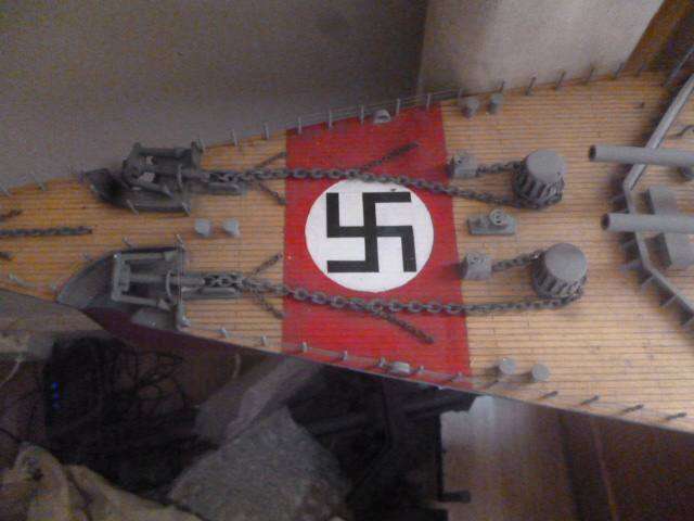

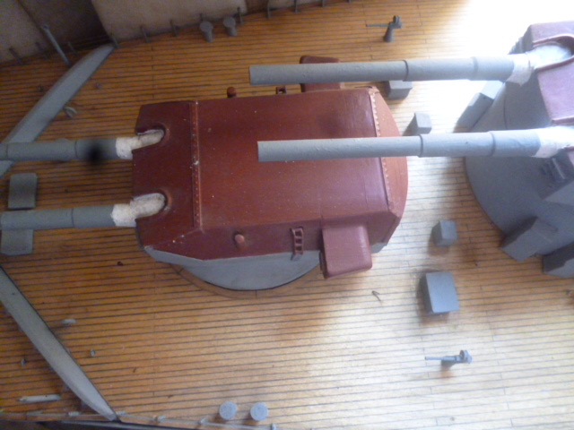

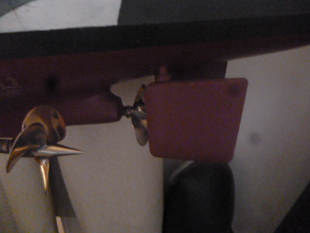

more pics
