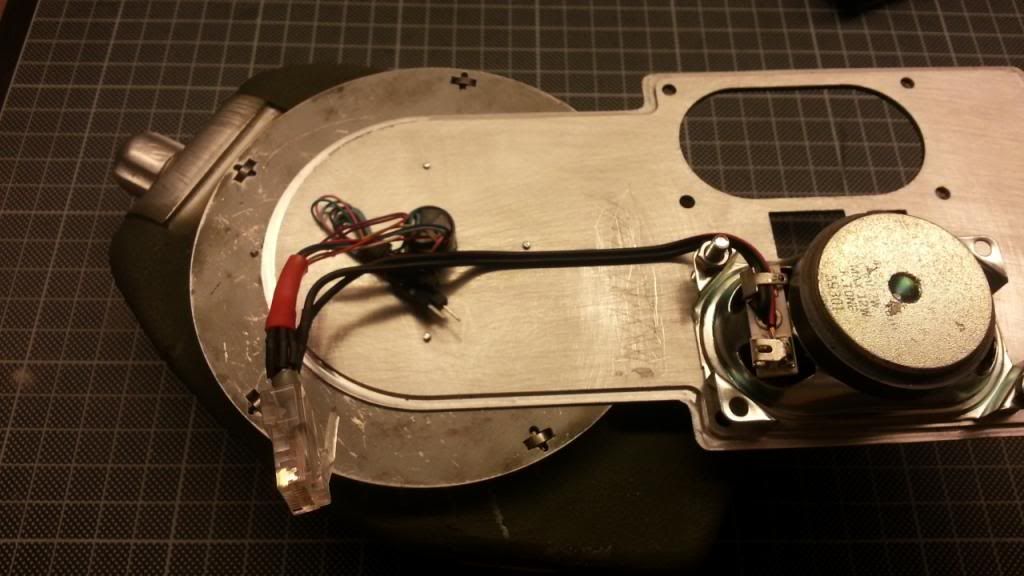

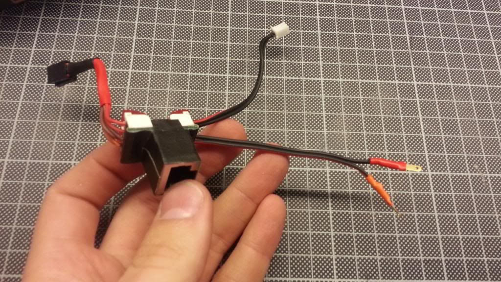

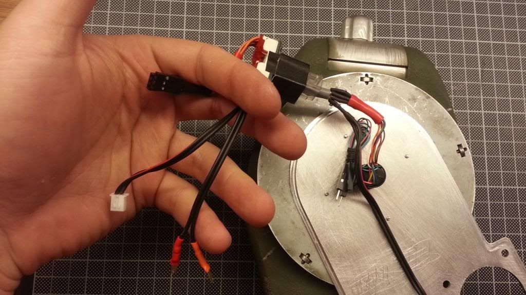

I got a bit annoyed with neverending plugging in and unplugging all the calbles between hull and turret. So finally I decided to simplify this procedure a little and I made a connector - basing on the normal RJ-45 standard :) It has 8 wires so I got all I need - speaker, two sevos and one motor. Plus there is a slip ring between turret and deck which allows unlimited operation.

Slip ring can handle 2 Amps. RJ - I don't know :) But it seems to work.
