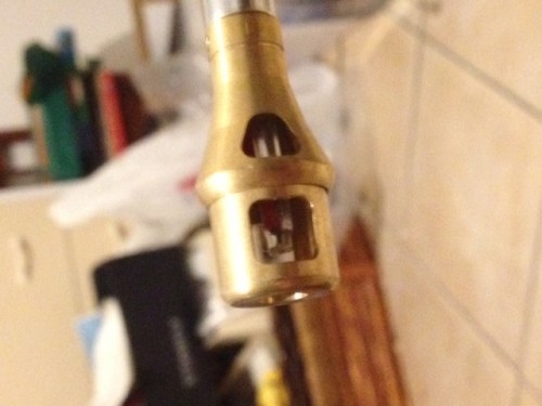

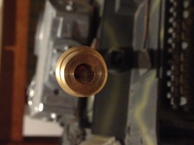

MichaelC wrote:Okay at least we are heading in the right direction. I think the Taigen turret comes with a high intensity flash, right ? When you look down the barrel do you see an LED or do you see a plastic tube ? I still think there is a reverse of polarity in the plug that you unplugged but I want to make sure that it is the case before we try it.
another view
another view
this is what I see in the gun, It seems a plastic transparent tube. It doesn't seem a normal led

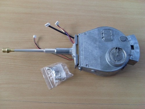

This is the turret.  The recoil unit in the turret  is very similar to the asiatam recoil system with a high intensity flash

dane61
Posts: 118
Joined: Sat May 26, 2012 7:30 pm
Location: Denmark
Re: New taigen recoil turret
Post by dane61 »
Hi
When I ( with help from Michael ) connected mine, I had the same problem. Stuck in track recoil/firing mode. It was the barrel that was delivered fully recoiled, thus triggering the track recoil/firing switch. Pulled the connector like you did, and the barrel returned to full length. Refitted the connector and everything worked.
