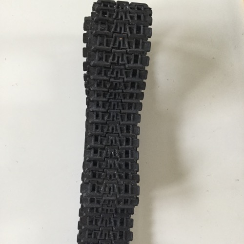

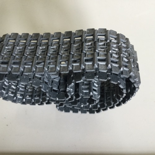

Re: Bluing Metal Tracks
I've just used the same bluing fluid as everyone else but my technique was slightly different.
After washing the tracks I put enough fluid in a bowl to cover the tracks (the bowl was tilted slightly to reduce the amount needed).i then just dragged the tracks through the fluid and hey presto.
I didn't use any kind of brushing and it took less time to do than typing this post.

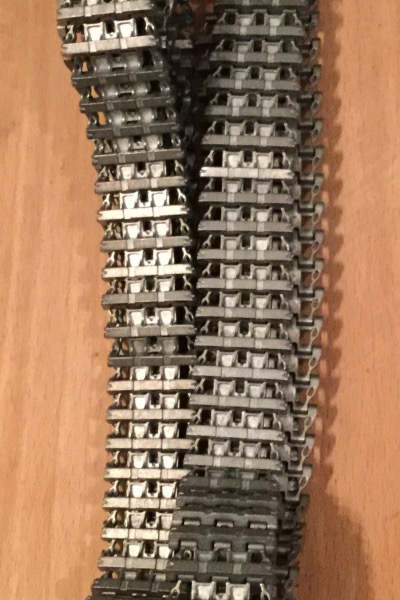

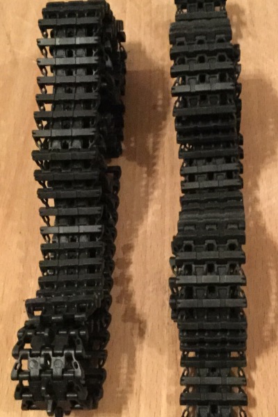

In my previous post I used the birchwood casey super blue ordered from the Internet.90ml for 7 ish quid plus postage.
I needed to do some kv1 tracks but didn't want to wait for postage so ent to my local gun shop.He sold a different cold blue solution for £10.55 for 250 ml.
In use it performs the same as the birchwood casey but takes slightly longer to change colour going sort of bronze looking through to black,I liked having a bit more control tbh and the better value.
The real bonus being I can nip found the corner when I need some.
