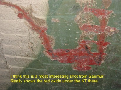

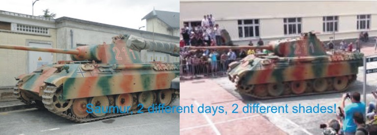

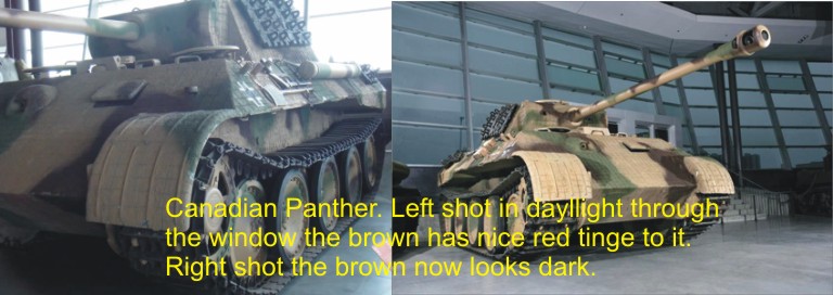

Hey Easternfront,
This is going to be fun! First we shouldn't hijack this thread so I will make one more post on colour and leave it at that.
I think a company that is world reknown for thier accurate scale models in hundreds of kits would make every effort to be as accurate as possible on the colours they choose to represent thier brand. Of course anyone can make errors but spectrum analysis of the RGB from original chips and conversion to formulas is a pretty good way to make sure you are as close to accurate as possible and that is what I heard they did.
Museums.... humm.... really? LOL! I will tell you this a lot of museums have botched the repaint so be careful which ones you base your opinions on! also a lot of guys take pics under inadequate lighting in museums. If you use a computer, monitors are all over the board on colours. And don't get me started on "scale" colour interpetation! LOL!

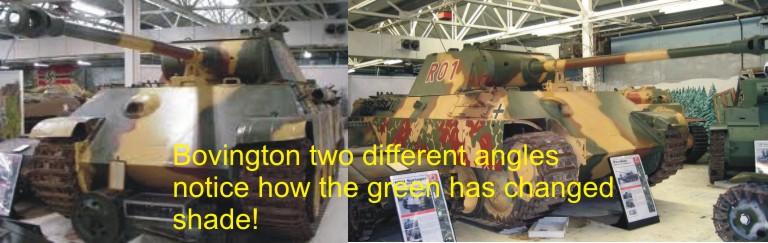

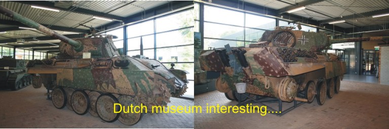

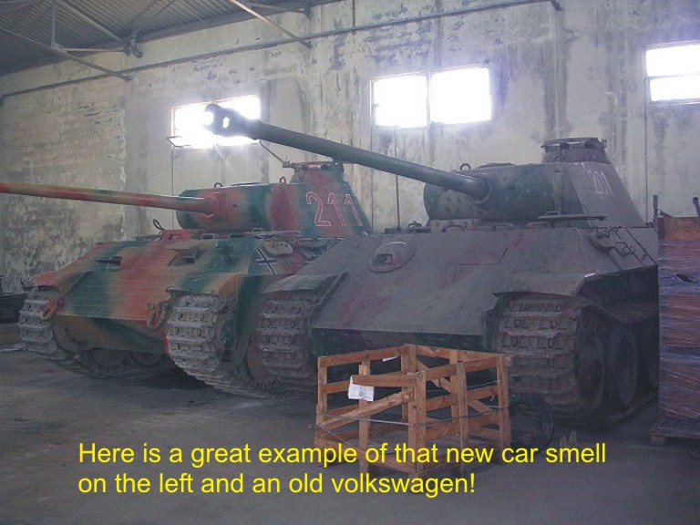

For your viewing pleasure here are some side by side museum shots to illustrate how the historians interpet colour. I agree, jbuckley will be fine. anybody that can do this detail work will have no issues with being patient with an airbrush. Can't wait to see it!

Thanks dgsselkirk. I've seen 3 panthers in the flesh, including the Bovington and Saumur examples and you are absolutely right. I particularly find the greens way too garish on both tanks. Well, the only Answer is to adopt the colour scheme in your last photo!! I'm struggling to match the pink, does anyone have a Tamiya pink they can recommend ..... OK, I guess we've done colour to death now. Interesting topic though. Thanks for all the input.

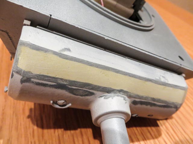

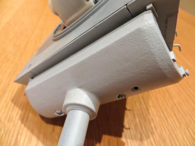

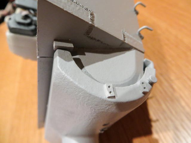

A decided to shave my chin!!
Got home at the weekend, was about to start the camo and .... spotted another little job needing to be done. I see what you guys mean about never being quite able to stop.
Well tomorrow I will start pre-shading and base coat - honest
