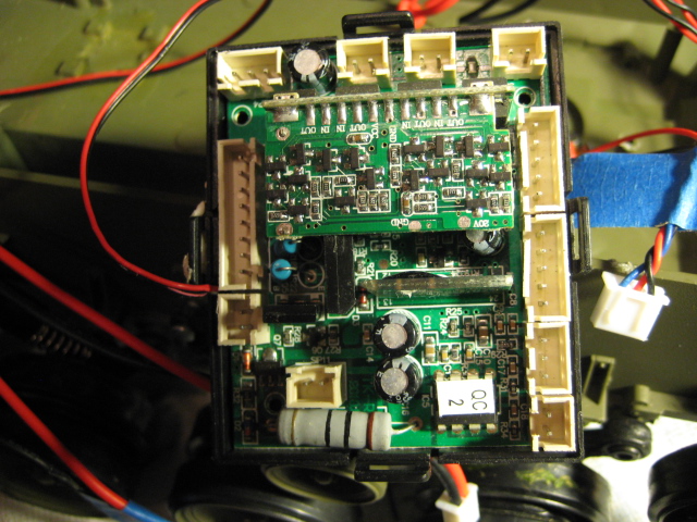

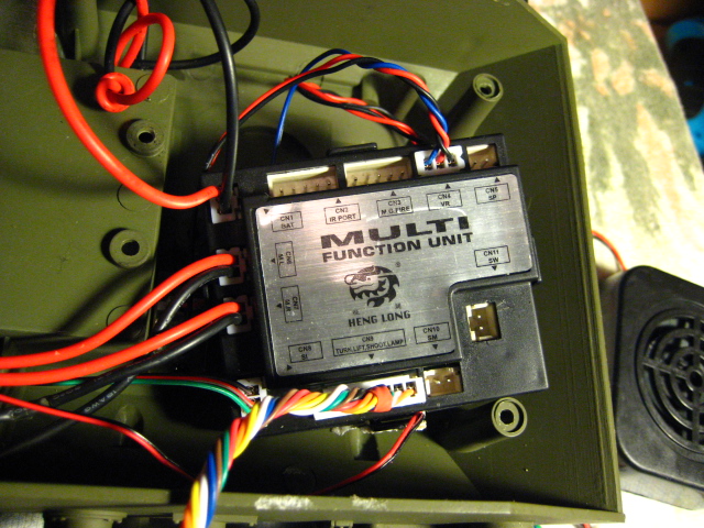

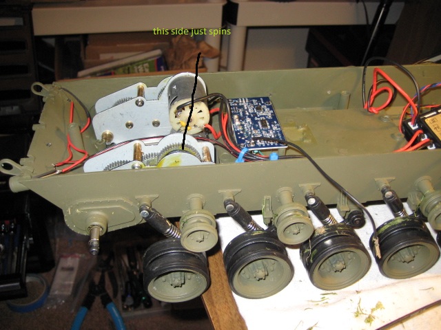

Here's photo of the Brain unit. Not sure witch one it is - The other photo shows what side just spins when power is applied

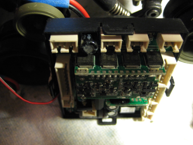

Darren, not certian what the problem is. But from you picture of the control unit I can tell you that is a RX18, which is usually quite robust. All I can think is maybe a ESC become damaged. If you take the lid off the RX18 near to the motor sockets you see four black transistors (and there is another four behind them) and see if there is any visable heat damage or something on them.

Opened up the X18. Nothing smells burnt. This is a leap or me...Just a unit that went bad? If so, can someone tell me where to get a one-stop-shop for a new 2.4ghz complete system on the cheap - er - cheap as can be with a bit of simplicity?????

Well, you can try switching the motor plug to see if the same thing happen to the left side (i.e. it keeps running). Next I would unplug both motors and fire the baby up and see if everything else works. With the HL electronics, if one thing is stuck (i.e. right track) nothing else will work. See if the firing stop when you unplug the motors and fire it up.

Swapped right for left..Left side turned..Think this x18 is toast. Nothing else worked also., sound etc..startup noise...nada. Will buy another X18 or X20...See what happens...Give me a week..Local hobby stores don't carry any of this stuff...Night all.
