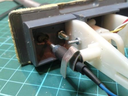

Installing a working MG mount in the turret coaxial position

I already have flash and working recoil on my tank's main gun. Plus a flashing hull MG. So why not allow the coaxial MG to join the party?
In theory there's no reason against it. I have a 'ready made' Taigen Tiger that flashes in both MG positions and, although I haven't investigated the wiring, I assume this is because both are tapped into the same circuit that comes from the hull board. Of course this means that both guns fire in unison, but unless you are looking head-on at both at the same time, this isn't really a problem. The co-ax is also important because it was often used as a gun-laying tool: once the turret MG was seen to hit the target the 88 would surely follow.
I had a couple of spare Tank Modelbau MG 34s hanging around anyway, one of which was originally on this Tiger, so this proved a cheap and easy mod - although I have yet to wire it up.
The original Heng Long mantlet on my Tiger has been replaced with the Tamiya equivalent, but both have a reasonable representation of the aperture/hole along with the slightly protruding MG muzzle. The wonderfully gifted Sov has already replaced his with the end of a Perfect Hobby MG - see viewtopic.php?f=22&t=10204&start=240 - but since all that can be seen is the very tip of the machine gun I figured that the Tank Modelbau equivalent (which is otherwise rather crude by comparison) would serve my purpose.

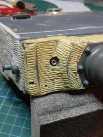

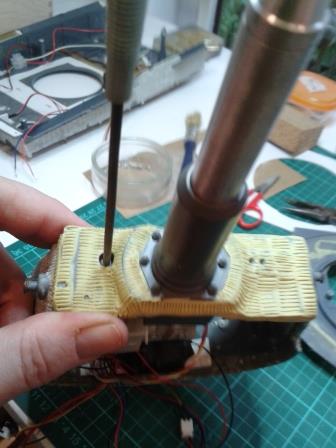

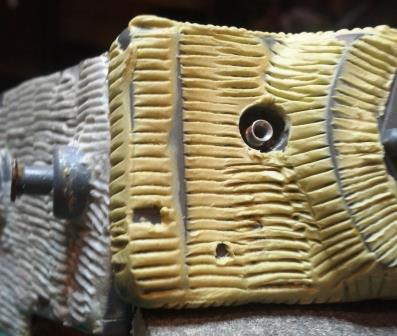

First I drilled out the aperture from the front and all the way to the rear of the mantlet. I then enlarged the hole with a needle file.
The MG aperture was first drilled out and then enlarged with a needle file.jpg

However, when I inserted the Tank Modelbau MG from the rear I discovered that it was fouled by the resin peg from the Taigen recoil unit. Now this would never have happened if I hadn't shifted the recoil mounts over to accommodate the correct Tamiya mantlet (see above) because, in the process, I had moved the main gun towards the loader's side of the turret.

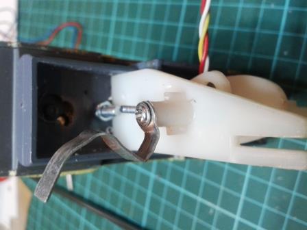

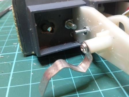

But necessity is the mother of invention, right? So I simply cut down the peg and used it to anchor the MG!
And from here I will let the pictures do the talking...
The Taigen mount was then cut down and an old cable clip screwed into the end.jpg
The Taigen mount was then cut down and an old cable clip screwed into the end.jpg (25.41 KiB) Viewed 4681 times
Here you can see the cut-down mount, the cable clip and the drilled-out aperture in the mantlet.jpg
Here you can see the cut-down mount, the cable clip and the drilled-out aperture in the mantlet.jpg (26.74 KiB) Viewed 4681 times
The cable clip was then pinched with pliers and folded back onto itself to keep the MG in place.jpg
The cable clip was then pinched with pliers and folded back onto itself to keep the MG in place.jpg (27.6 KiB) Viewed 4681 times

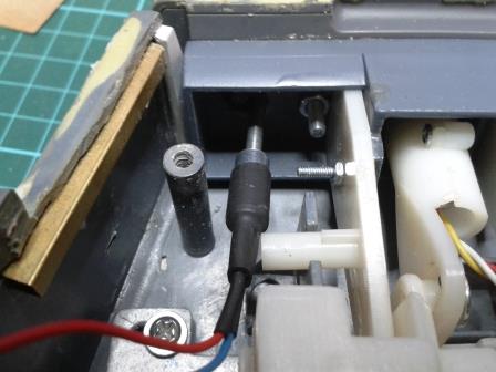

And here it is back in the turret.jpg (23.91 KiB) Viewed 4681 times
The view from the other side is more convincng than the original Tamiya (or Heng Long) MG - and better still if it works!.jpg
The view from the other side is more convincng than the original Tamiya (or Heng Long) MG - and better still if it works!.jpg (32.71 KiB) Viewed 4681 times
