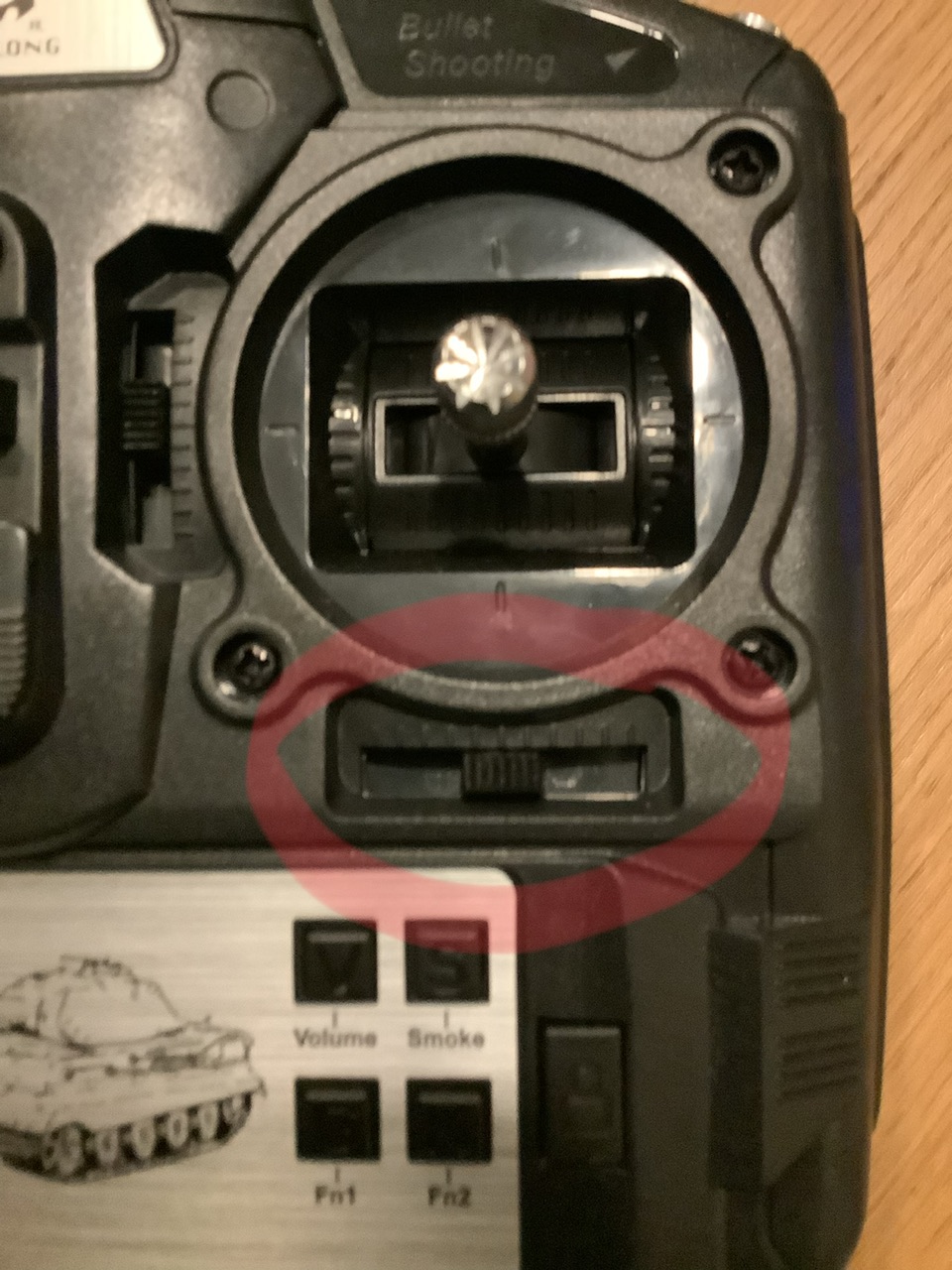

......I am assuming that the only problem with using the HL 7.1 system is that it will have no channel available for the Centurions cupola turning feature?

zooma wrote: Thu Nov 21, 2024 3:42 pm .....I am assuming that the only problem with using the HL 7.1 system is that it will have no channel available for the Centurions cupola turning feature?
The HL7.1 has a slider which should work the copola. They really are a good simple unit. The only problem is you can not program the sound. Dave states on his web page that the ones he supplies do not have the slider for this option.

Yes, you need the proper 7.1 transmitter to use the extra servo. :wave:

Meter rat wrote: Thu Nov 21, 2024 7:54 pm
I will start looking for adverts for a 7.1 combo that includes this slider.
Where is this slider positioned on the tx - is it on top? (I just need to know where to look for it).

zooma wrote: Fri Nov 22, 2024 10:56 am I will start looking for adverts for a 7.1 combo that includes this slider.
Under the right hand stick.

You will have to make sure its a 7.1 transmitter, the 7.0 looks the same but on the back of transmitter it needs be badged as a 7.1
The front of the 7.0 transmitter looks the same but the slider is fixed and doesnt move. :wave:

Ludwig von wigbearer wrote: Fri Nov 22, 2024 8:03 pm You will have to make sure its a 7.1 transmitter, the 7.0 looks the same but on the back of transmitter it needs be badged as a 7.1
There are some 7.1 transmitters that aren't marked like the one that came with my RC Kootai M1128 MGS.
