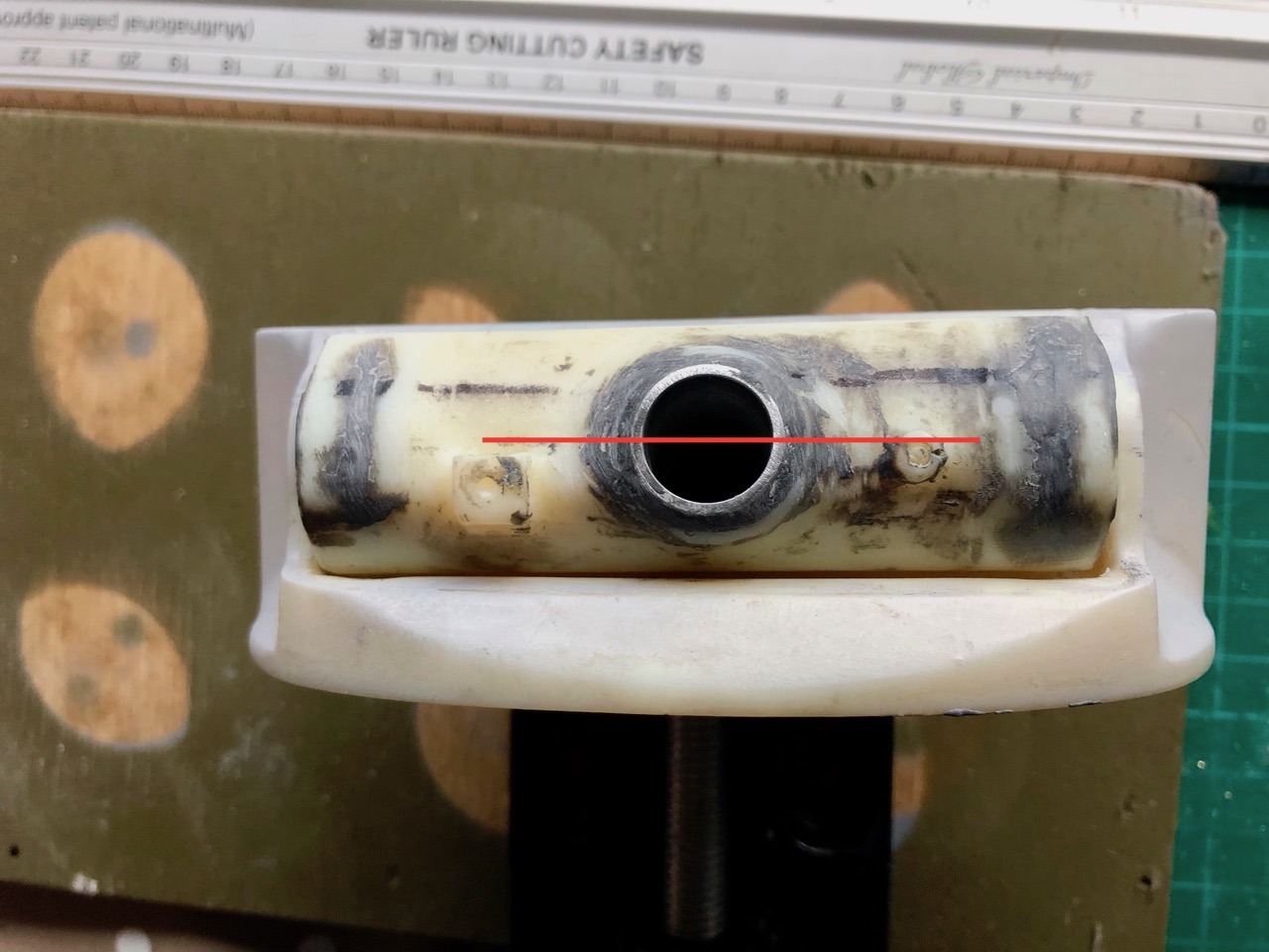

>:< I've spent many hours trying to do something that, on the face of it, would seem simple: to make a pivoting visor. I'll explain why it has been a regular pain in the rectum.
1. As it stands, the static part of the mantlet, and the movable (gun-toting) part that pivots from it, don't describe a regular arc (i.e. segment of a circle). Thus, fitting the visor is like finding the perfect pivot point on another irregular arc: a motorcycle helmet shell, for example. Finding the perfect pivot points/axes that allow a swivel without unwanted contact, is really tricky. >:< A conundrum I'd not foreseen. :problem:
2. Added to this, where resin touches resin, there's a lot of friction. This causes snagging, and this could, in turn, give a servo a meltdown moment. :thumbdown: Bummer..
3. Staring at Christian's resin mantlet, I just noticed something I should have seen before. 8O The MG and Optical sights are in the wrong place. :O
Have a look. the MG mounting should be above the centre line of the barrel, and the optic just on, or above as seen on the real beastie:
Comet mantlet- MG position
Comet Mantlet configuration
Click to ENLARGE smaller pics.
If I turned the gun totin' section upside down, the optic sight and the MG mounting would be in about the correct position, relative to the gun centre line. But then, they'd be on the wrong side of the Gun. :thumbdown:
Just goes to show how even a talented model designer can have an off day. :think: :D Well, that a problem to sort out when I've sorted out the main one: mounting the mantlet.

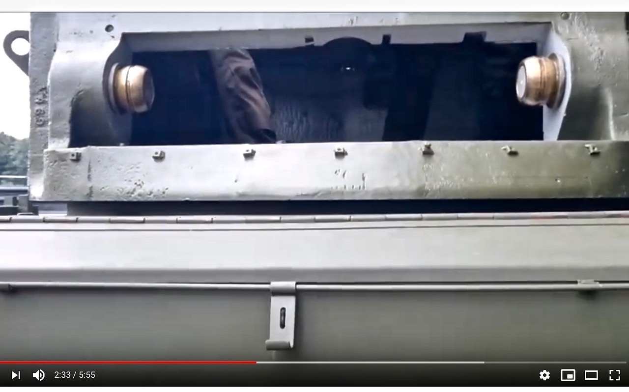

But the actual mount containing the pivoting trunnions looks like this:
Fitting mantlet to full-size Comet
View of actual Comet mounting pivots-or trunnions
It looks like the best way to proceed, then, is to cut out the grippy, awkwardly curved section. Another advantage of excising the problematic section, would be that it would make it possible now to fit a 'working' (flashing) MG to the movable mantlet. With the existing design, that would not be practical. Indeed, it would be impossible, without yet another vertical slot being cut for it. :problem:
Never having seen Chris' Mantlet being fitted, and kitted out, before, this will really be an abolute first, as far as can tell. Breaking new ground- but hopefully, not the Mantlet :problem: :D

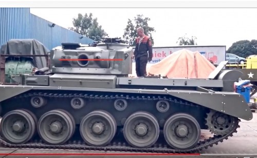

Fun little detail, that is me in the commanders cupola :D

biertje wrote:Hey 43rdRecceReg
