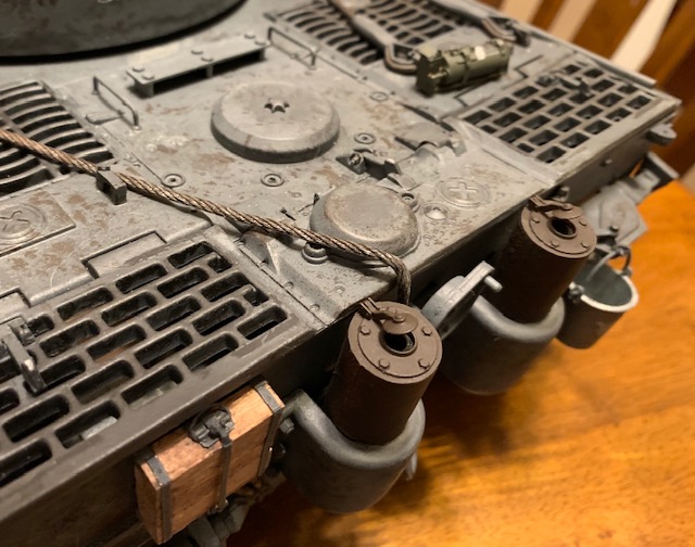

I installed muffler flappers from Shapeways. These are great parts and very clean and detailed. While I was at it tonight I realized I had the engine cover on backwards so I turned it around. I also filled in the holes where the jack block used to be and I filled the holes on the left side of the hull where the track cable clamps went. Looks much better now. Thanks for checking in.

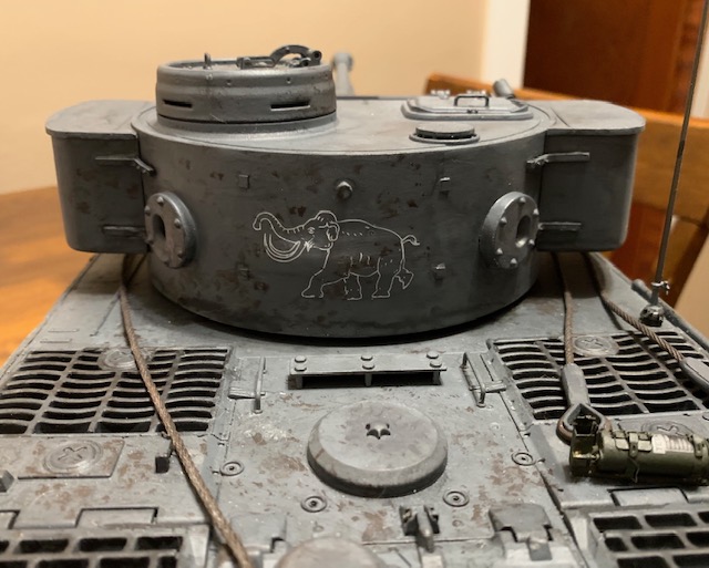

Today I received the Mato metal pistol port and installed it on the right side of the turret. It’s another one of those details that really identifies this as a very early initial production Tiger. I also added the wiring conduit and brackets for the headlights and for the smoke launchers. I still need to add wires to the rear of the smoke launchers.
