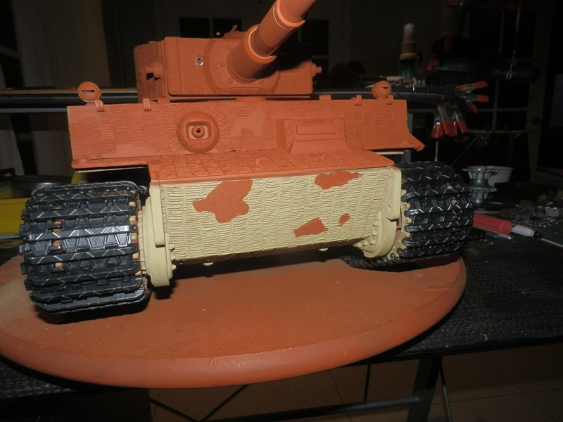

Raminator wrote:The Panzer Putty is for masking; you can see it in the second and third pictures covering up the holes in the front glacis' zimmerit.
Got it...thanks!

The Panzer putty is a mask as Mr Ram says. I have had it for 2 years but never needed it.
Thats an oversight on my behalf...........................it is without doubt the easiest and most reliable & versatile mask I have ever used.
And yes, the number of damage patches of Zimmerit I have on this thing, I'm lucky I have it :haha:
In fact, part of my confidence to place so many damaged areas was just because I knew I had this stuff.

Raminator wrote:The Panzer Putty is for masking; you can see it in the second and third pictures covering up the holes in the front glacis' zimmerit. Herman did the zimmerit by melting the plastic with a heated screwdriver.

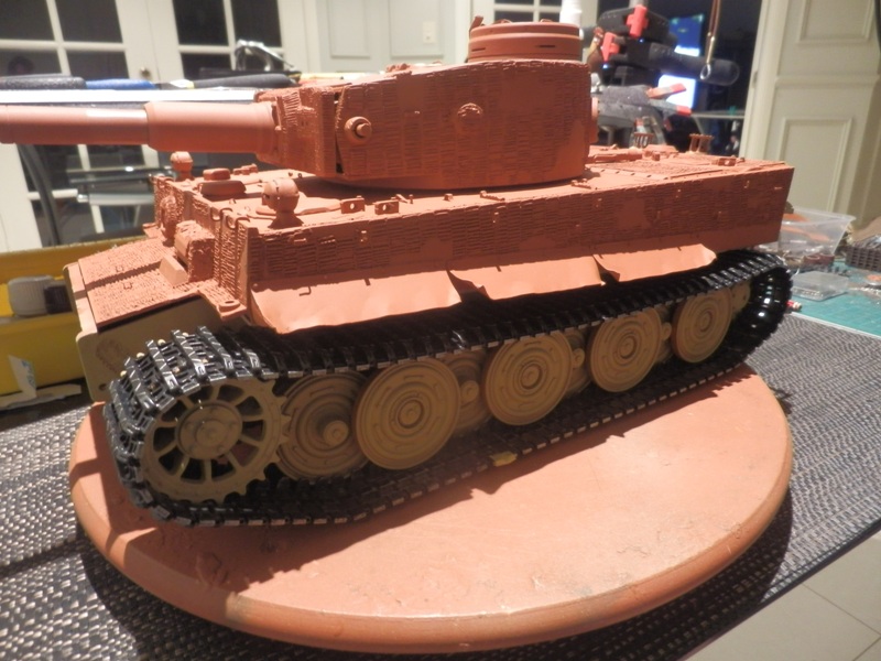

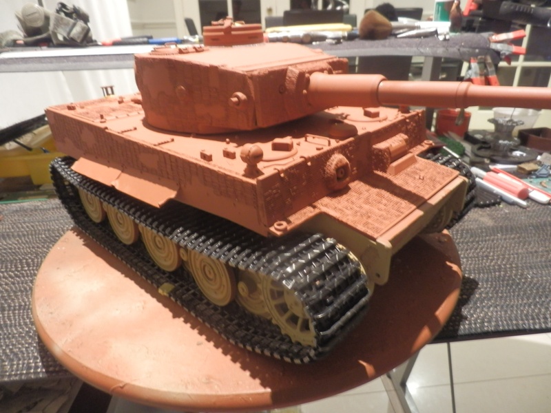

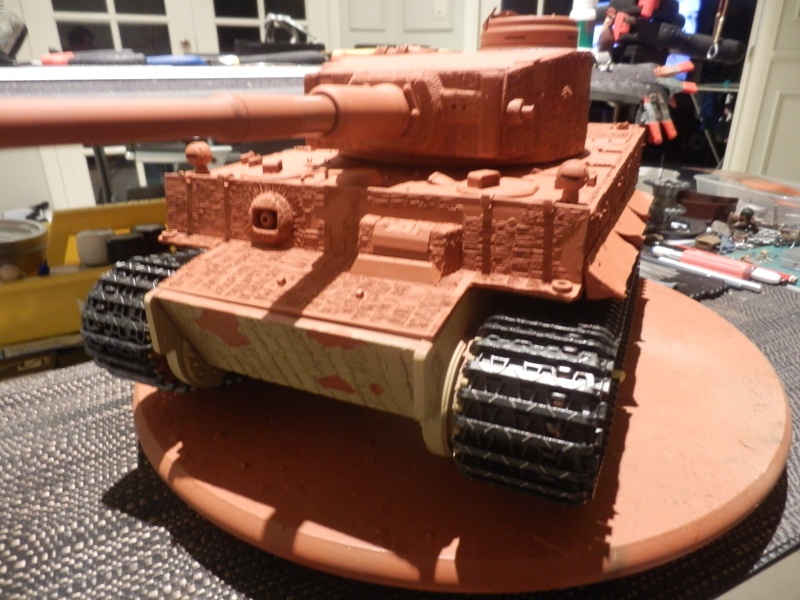

Got the damn wheels on the damn lower hull finally :/
I bunged the tracks on it just to inspire and motivate.
He looks ok.........
Its got nothing secured yet, the upper hull is loose to the lower, and the turret is floating on the deck.
Things seem to sit right though.
The suspension and converted roadwheels are far from perfect, but will do.
Electrics may be an IBU2 board from my Jagtiger which will be swapped with the set I got from Mr Ram which has an amp & dual speakers.
OR, a Taigen V2 set if they ever arrive here :/
