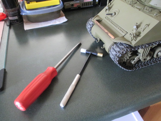

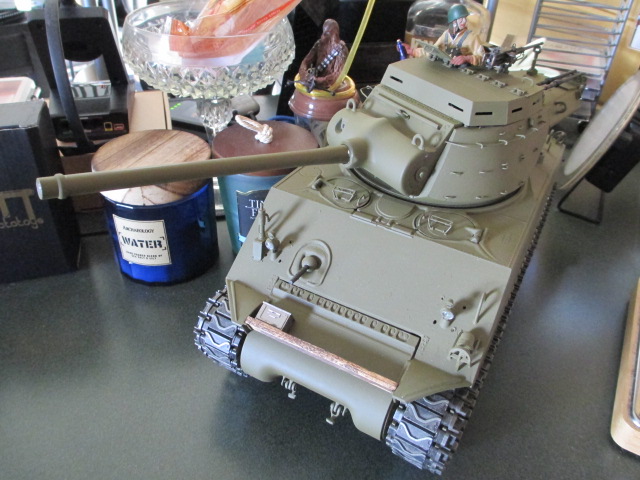

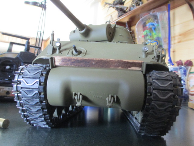

A quiet Memorial Day morning so before all the cooking madness began, I took time to put the tracks back on the M36B1. I anticipated having to add a link to each side but as it turned out, the idler adjustment I had made earlier did the trick nicely. Pics:
We're just a few steps away from being done.

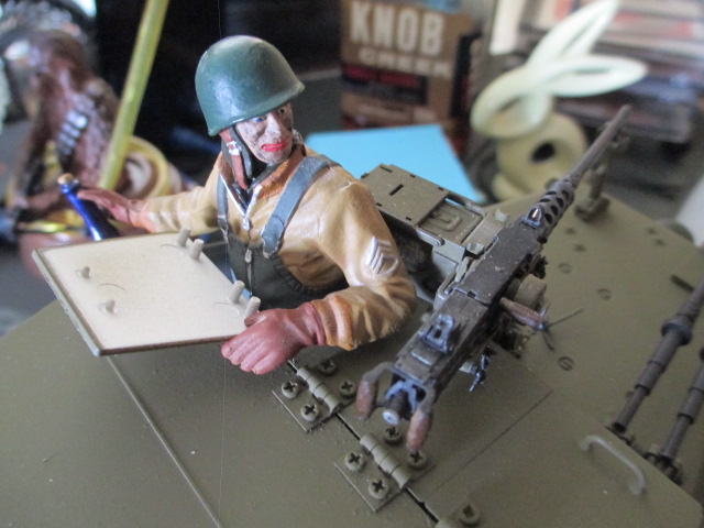

It's a machine gun , Joe....
I think he is happy, hard to tell....
I think he is happy, hard to tell.....JPG (76.95 KiB) Viewed 3173 times
Crazy Joe showed up to have a belt and inspect the work.
Really looking better with the tracks back on.
Real tools are needed to work with these heavy duty track runs.

The tracks should have fit perfect when you got it, one of the few things I liked about the tank! In fact I got another set of those tracks for my Firefly build IF I can ever get to it.
Posts: 7782
Re: 1944 M36 B1 Tank Destroyer
Terry,
I _really_ love those tracks. The idler adjusters work great as well. A little time with a piece of flat stock and it's easy to get both idlers on the same notch in the hub backing. I loosened up the tracks a little bit so they have extra room to move with the roadwheels. It's a tip I got from Sass and it has worked great on 'Maxene' and 'In The Mood' ( on those tanks, I had to add a link. There wasn't those snazzy adjustable idlers back then ;o)

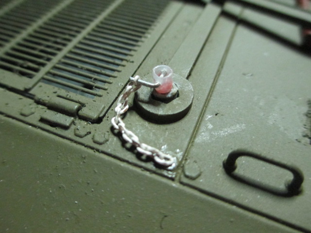

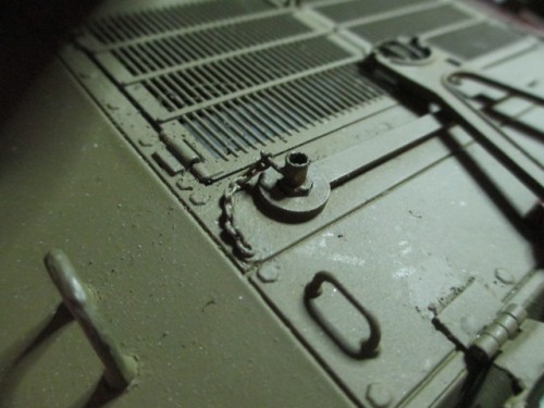

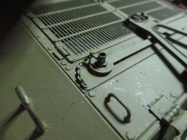

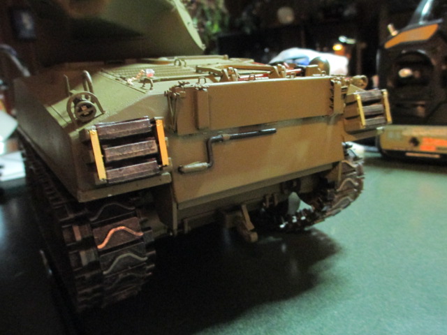

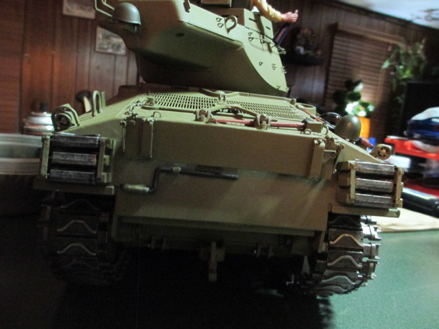

Not a lot of time today as the evening seemed to pass by in a blur of sound and fury. ( not the famous tank, sadly ) I managed to do a couple of minor pieces of detailing around the rear deck. I painted that and called it an evening. More soon. Pics:
Painted detail adds extra interest to a prosaic section of the TDs upper hull.
Some left over brass stripping and nuts produced the end retainers for the spare track racks.  I had to custom cut some pins to hold the blocks in place.
...which looked much better under paint.  The tube was so small that I had to use a piece of toothpick fitted into the underside of it to hold the tube and pin in place.
Minute work with a plastic tube and a paper clip and fiddly chain produced this...
Minute work with a plastic tube and a paper clip and fiddly chain produced this....JPG (99.42 KiB) Viewed 3142 times

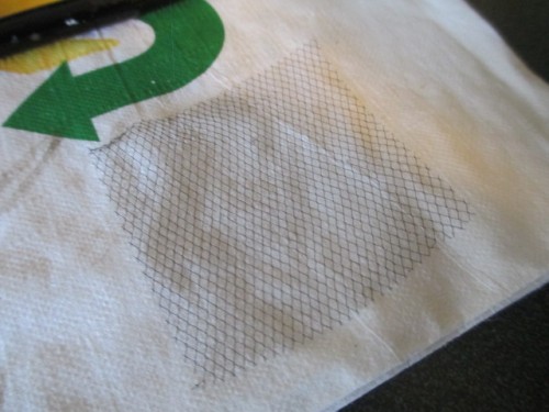

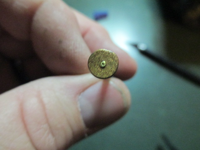

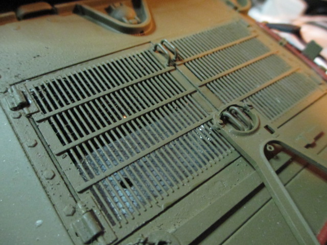

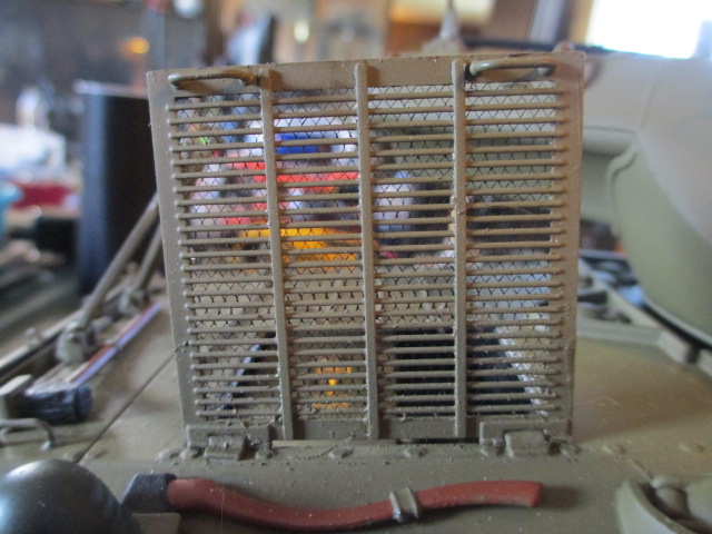

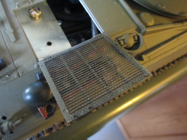

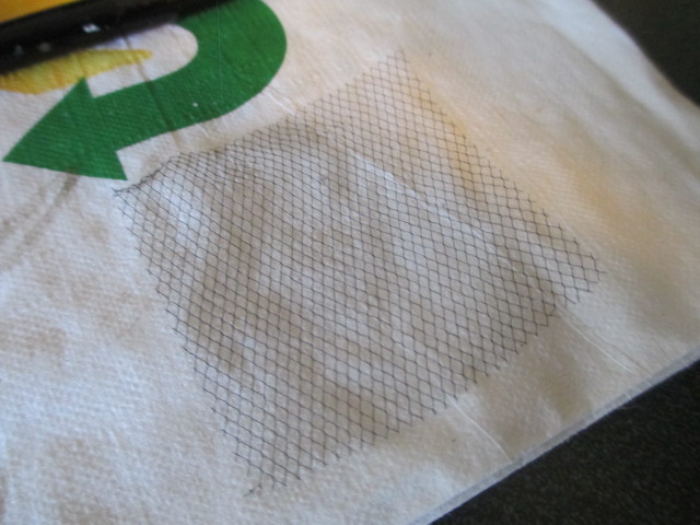

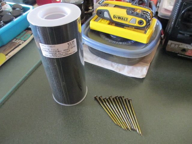

I took some time this afternoon to stop by a local Hobby Lobby to pick up some black foam or fabric to sort out the engine deck hatches. I found some very flimsy black material that looked the goods. Home later, I found that this material was so flimsy that an Exacto blade would just drag it and scissors were almost useless. I figured it out and it worked out well. I made a start on the shell bases for the ready rack in the turret but they are going to require the Dremel and a metal cutting disc so that can wait until tomorrow after their paint job cures. Pics:
Beginning with the nails required a tiny brass washer to give them a primer circle.  After that was a coat of brass paint that is curing overnight.
Beginning with the nails required a tiny brass washer to give them a primer circle. After that was a coat of brass paint that is curing overnight..JPG (78.21 KiB) Viewed 3118 times
Both hatches complete!
Looking at it from the other side of the hatch.
Here is a square of the painted material mounted in place.

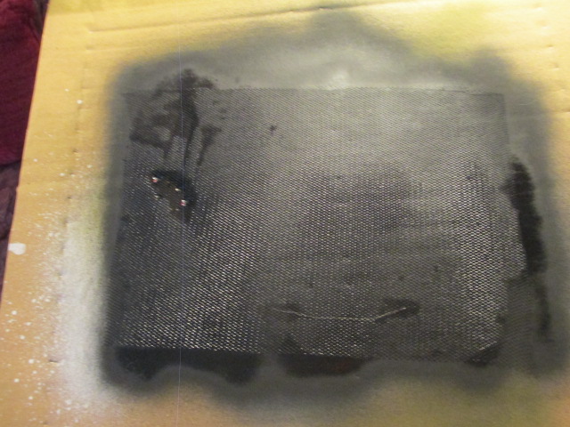

I resolved this issue by spraying a piece of the material with flat black.  Once this dried, it was much easier to measure and cut.
It took several attempts to get this square cut out.
Starting out with some steel nails with the right diameter head and that black Tulle material.
