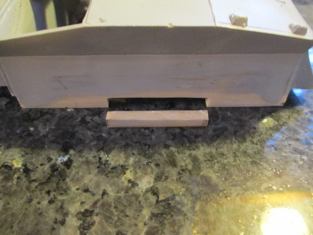

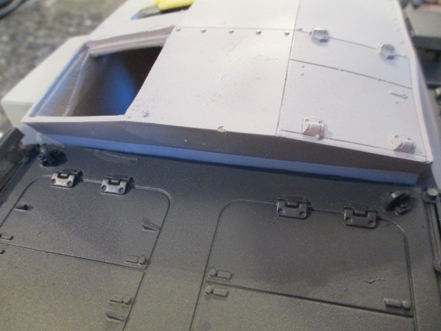

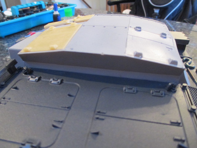

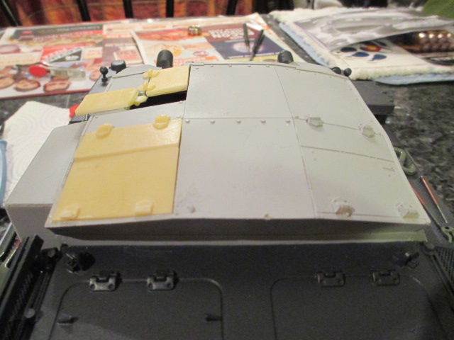

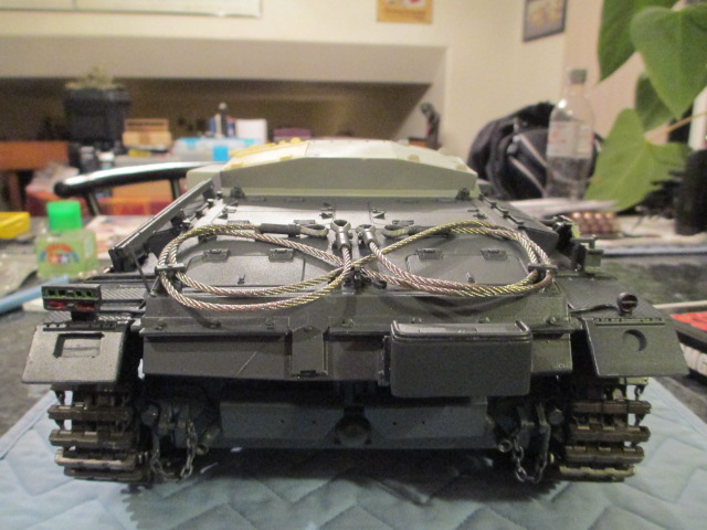

Alpha, an M1 Abrams will probably be a next year thing. The StuG is taking up all of my free time and next up is the 1/6 Stuart. This Winter, I hope to RC that 251 Halftrack. Depends on if I get the time. So, nothing in the Post today. Taking up the StuG, I'm pleased with the lower hull and deck. The Casemate was sitting up a little high in the rear and upon investigation, the fan mount for the Taigen MFU was the culprit. I could have removed it but this is going to be a weighty little tracked gun so I wanted to leave the fan in place. I did a cut out and clean up so that nothing touches the fan housing now. Pictures:
Looking like an Assault Gun!
Casemate is underway.
Casemate is underway..JPG (95.34 KiB) Viewed 3061 times

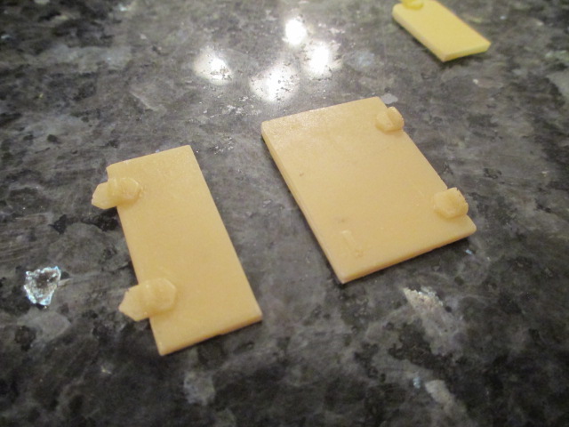

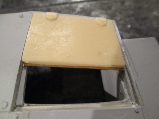

Rear hinge barrels sanded off but the Hatch is a good fit.  Will pick it up and hinge and detail this coming weekend.
Rear hinge barrels sanded off but the Hatch is a good fit. Will pick it up and hinge and detail this coming weekend..JPG (74.43 KiB) Viewed 3061 times

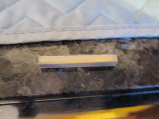

Brass lip cut and added to the back of the Hatch
Brass lip cut and added to the back of the Hatch.JPG (76.3 KiB) Viewed 3061 times

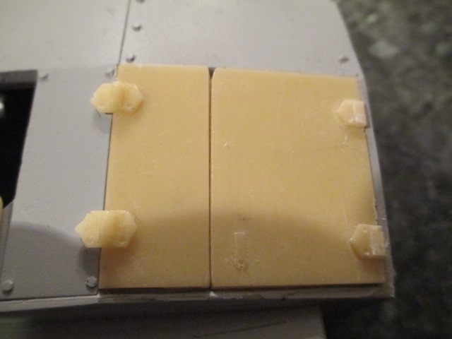

Commander's Hatch came next.  Neatly bisected with an Exacto.
A closer look at the thick chunk of resin that I had to remove
A closer look at the thick chunk of resin that I had to remove.JPG (86.26 KiB) Viewed 3061 times
The fix involved a Dremel and a big file
The fix involved a Dremel and a big file.JPG (97.27 KiB) Viewed 3061 times
Just right (well, as right as this resin kit gets)
Just right (well, as right as this resin kit gets).JPG (91.42 KiB) Viewed 3061 times
Too high
Too high
Too high.JPG (93.09 KiB) Viewed 3061 times

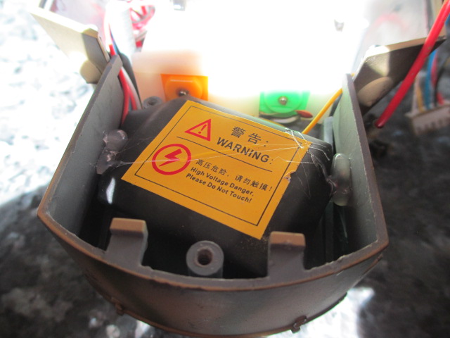

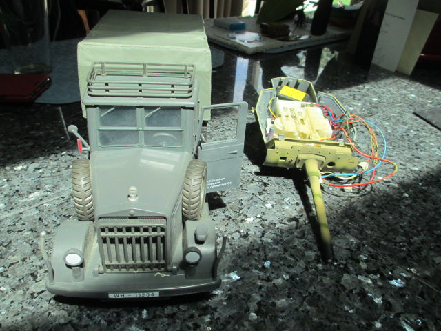

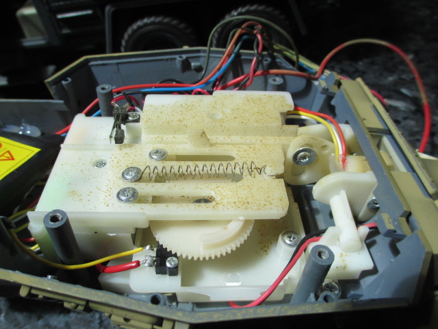

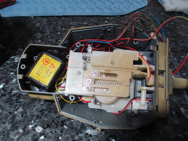

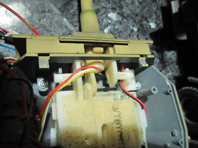

Nothing in the Post yet today. It's still early. I got around to ordering the actual hatch hinges from Asiatam today along with the Commander figure that I've had my eye on. I'll see to some extra fiber optic filament, the new LED and wiring and those radio parts I was mentioning, later this afternoon. That should cover every thought so far as long I do not mung up the main gun mount and IR. Speaking of that, a maint. crew equipped with heavy transport located a workable trunnion + gun and salvaged the Pz III turret from a wreck they had been scouting for parts. Pictures:
View of complete unit
Screwed into place so removal should go easier...
Complete trunnion and mechanism + bulb
Working xenon flash
Working xenon flash
Working xenon flash.JPG (93.63 KiB) Viewed 3045 times
Maint. Crews' Transport and prize

That gun unit looks pretty sweet...you shouldn't have too much trouble with space ;)
