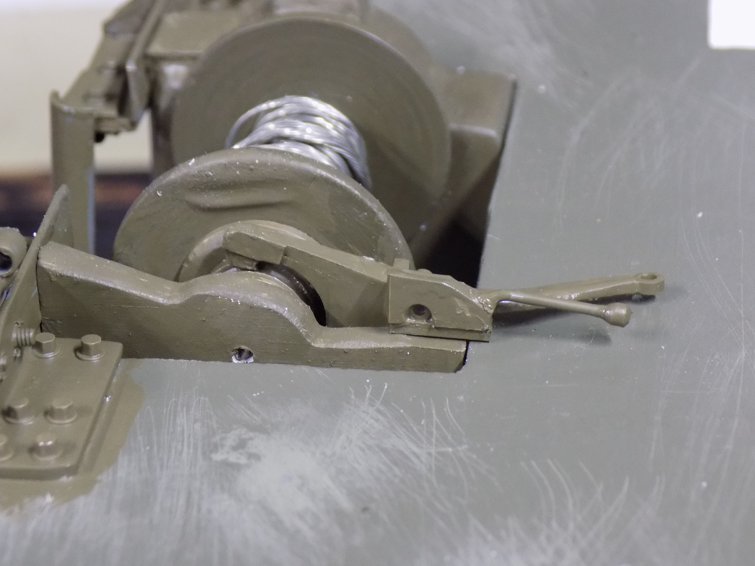

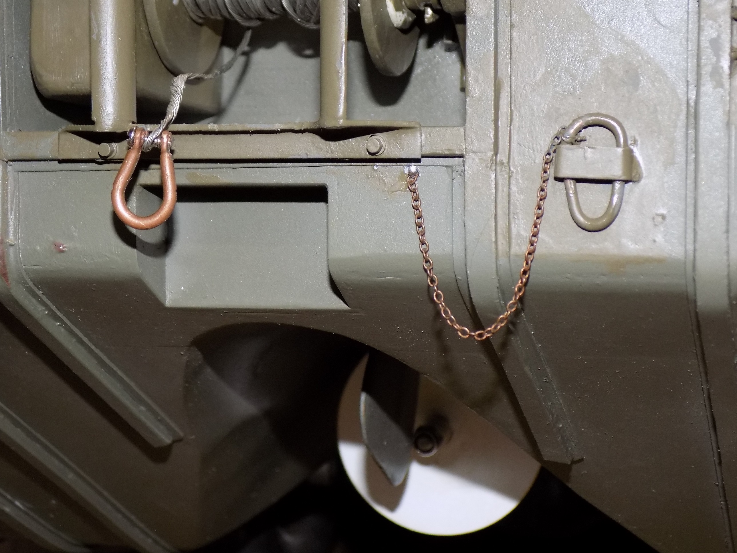

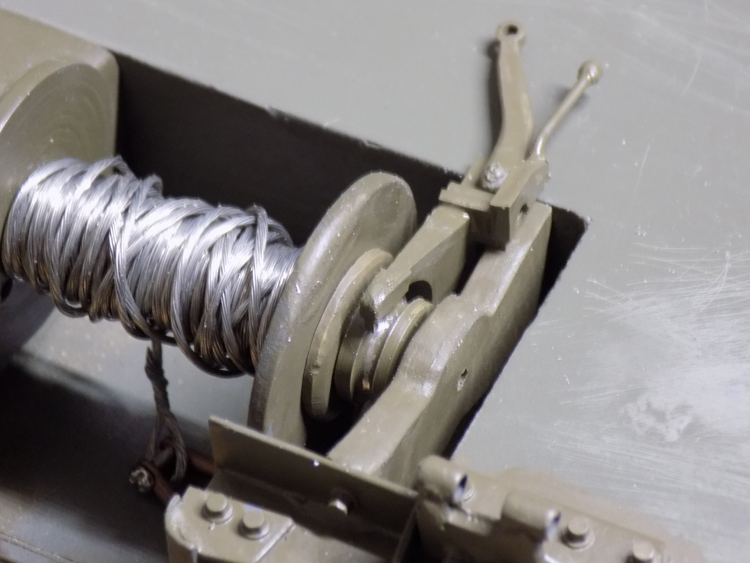

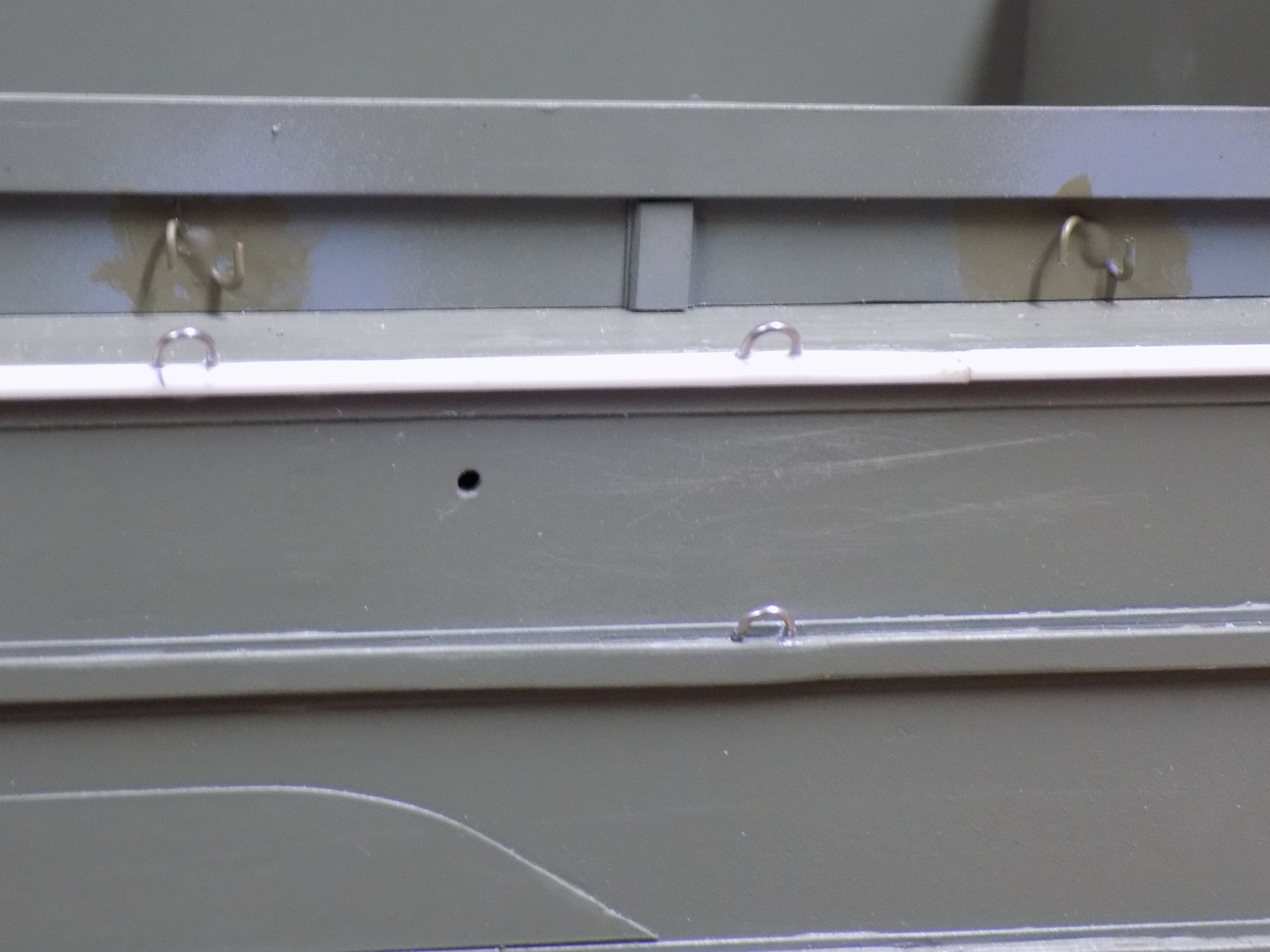

This coax ended up being a copper clad steel wire, I'm sure some of it is copper. But frankly the steel will hold up better than the soft copper could.
Got most of the hooks and hoops installed. There are two winch guides to go and three on the very front of the hull, but I will wait until I build the front winch hawse till I do those. Winch received the last of the details it will get. Drum clutch lever and fork (to free spool cable out) and the drum brake. And finally the towing hoop (pintle hitch to chain/clevis/hook...).
