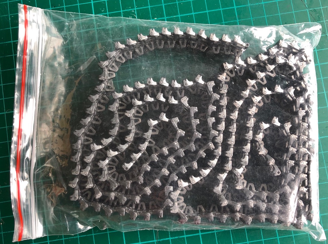

Meantime, these Taigen Pz IV tracks have just arrived from rctank.de. Dominique was the only vendor with standard metal tracks in stock, at the time I ordered them. Finding time to fit them, is another matter.

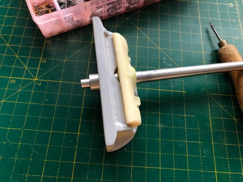

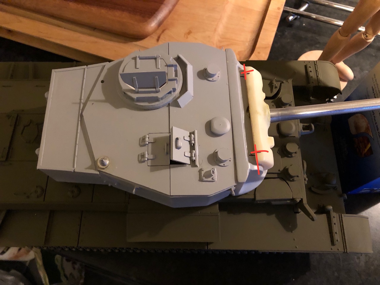

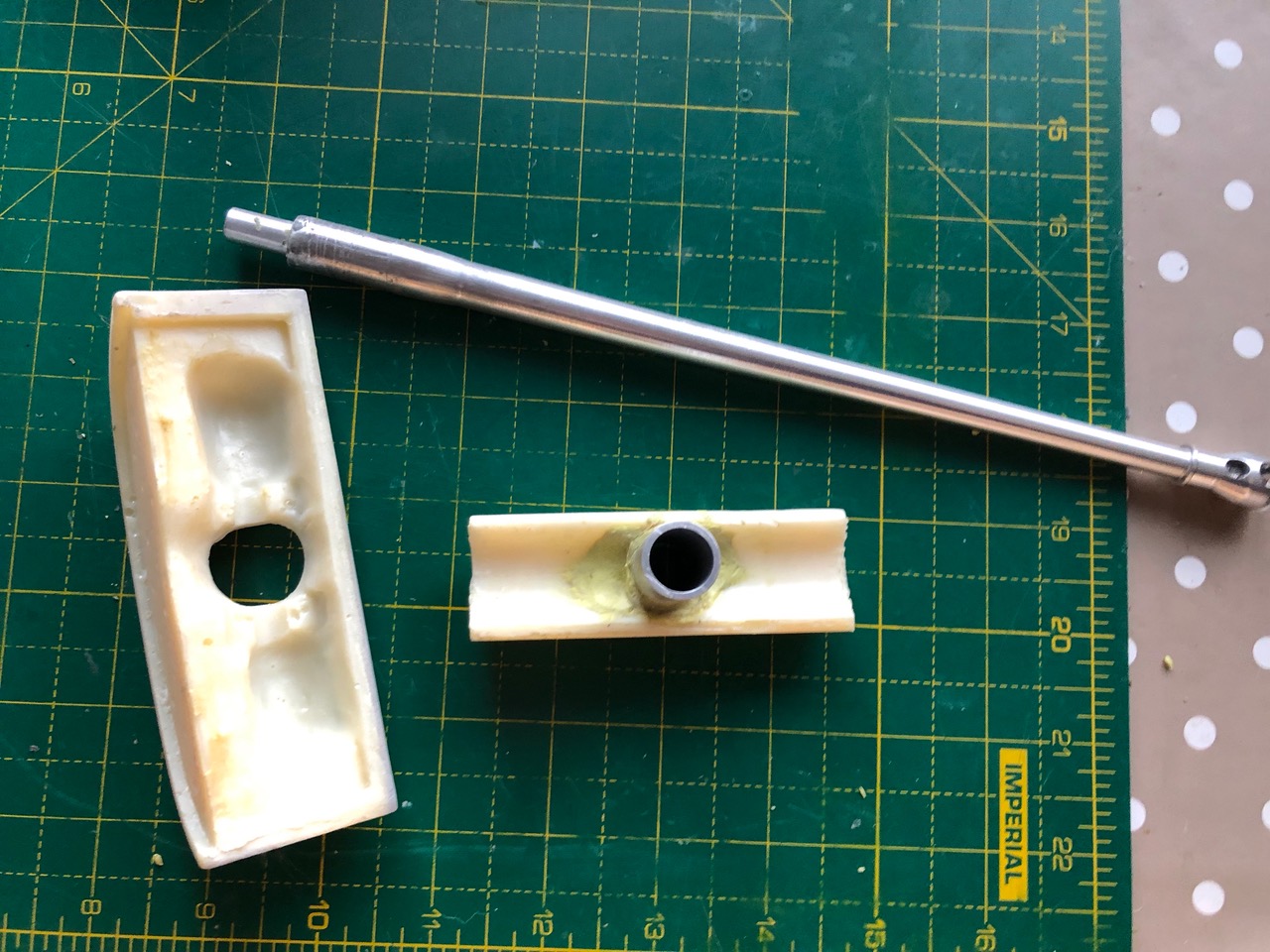

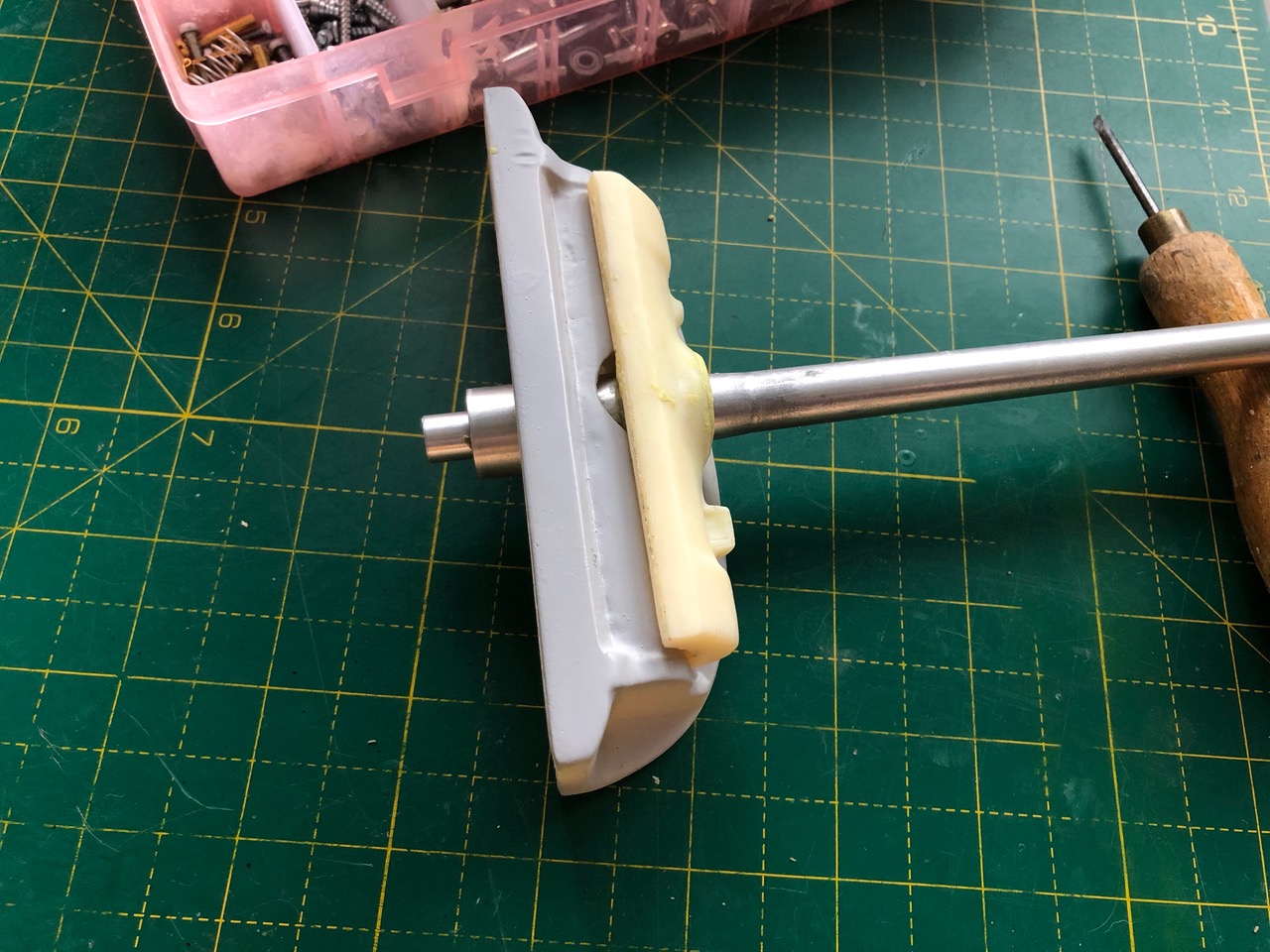

Managed a few minutes away from the demanding Westie puppy, and cut a piece of alloy tubing to make the gun tube for the Mantlet.

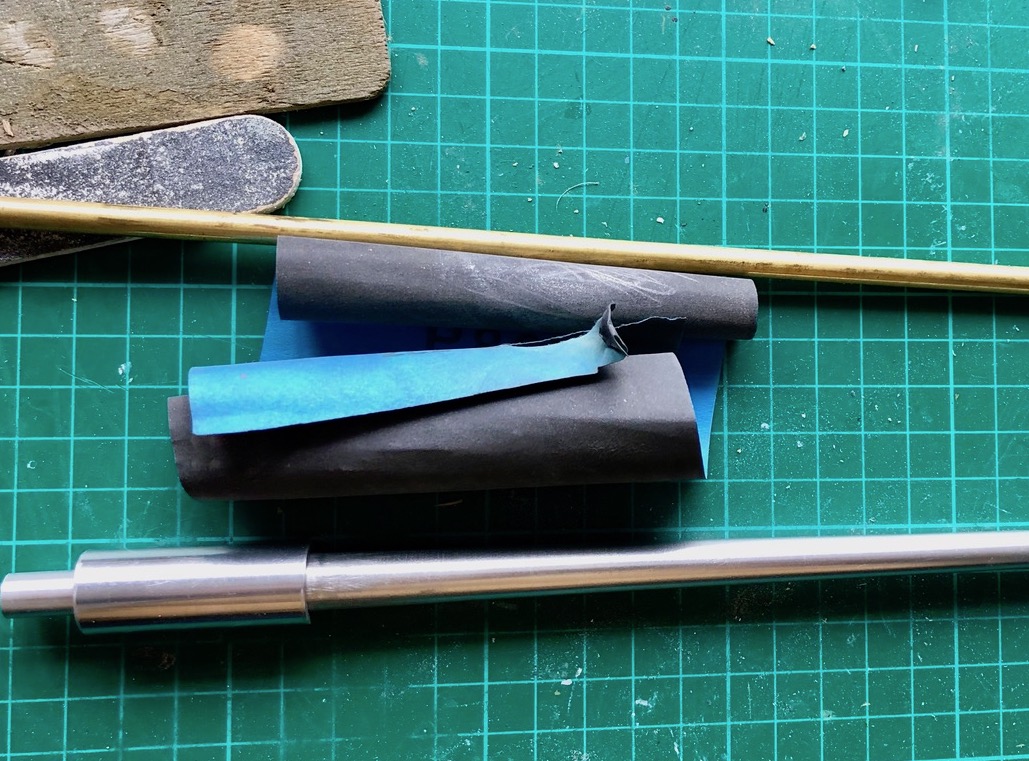

Here's the tube I ordered. It's almost perfect for the Comet gun. There's just a bit of relieving needed, with emery paper. Part of the conundrum here for the builder, however, is working out how long the gun tube should be.
The tube has to be long enough to support the barrel throughout the recoil motion, without inducing drop or wobble. I'm guessing that the typical recoil travel length, at 1/16, will be between 10-16mm. depending on the model and the recoil unit used. Any additional info would be welcomed here, by the way.
Anyway, I cut it to this length. Only time will tell whether it will work, or even fit, properly.

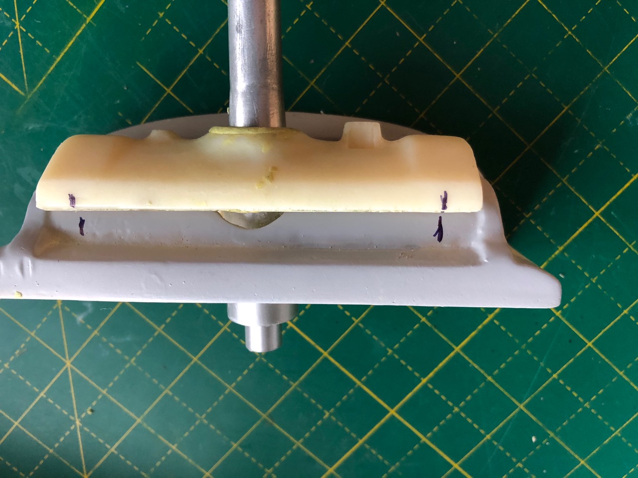

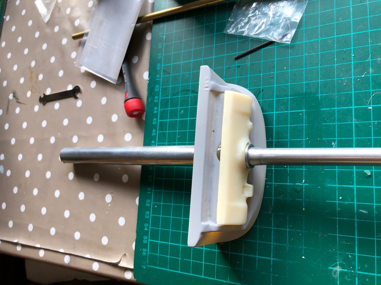

The next stage is to fix the tube in place, keeping orientation (0 deg azimuth and elevation alignment) in mind. I used Milliput Regular to bond it into the Mantlet.
As usual, clicking on the pics will ENLARGE them.
Final adjustments were made using the barrel for guidance, when holding the movable section of the mantlet against the fixed body.

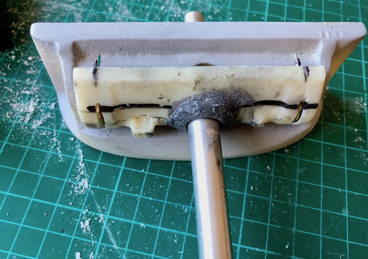

The black marks on the Mantlet parts indicate where pivot arms will be fitted to the mobile mantlet. The arms will pass through slots cut into the fixed body, and will be pinned from the side with brass tubing for pivot pins. This will echo the arrangement in the actual Comet.

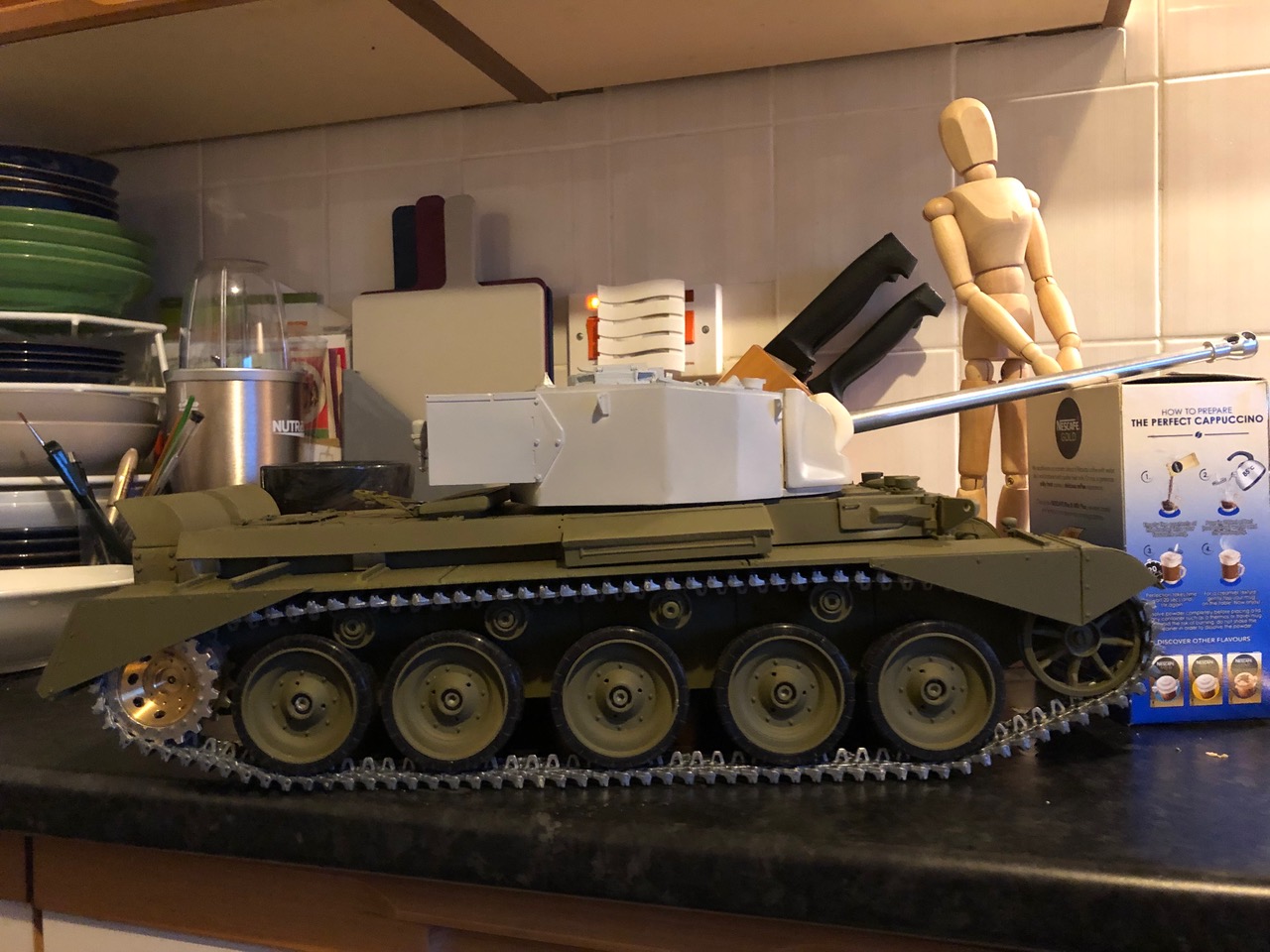

The other day, when all was quiet in the Doghouse (three here currently), I managed to fit the tracks. These are Pz 111 metal tracks, which will also fit the Pz IV and the Comet/Cromwell when extra links added.
For the Comet, I added 9 extra links per side. They look about right for now. One problem, is that the weight of the motors at the rear is causing the suspension to sag a wee bit there. I did think that the springs were a tad on the weak side.
  Well, we'll see.

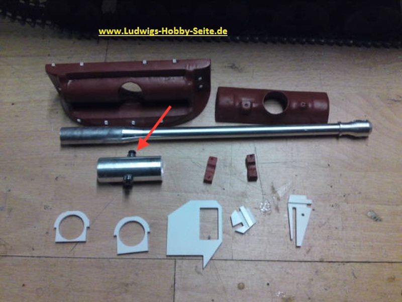

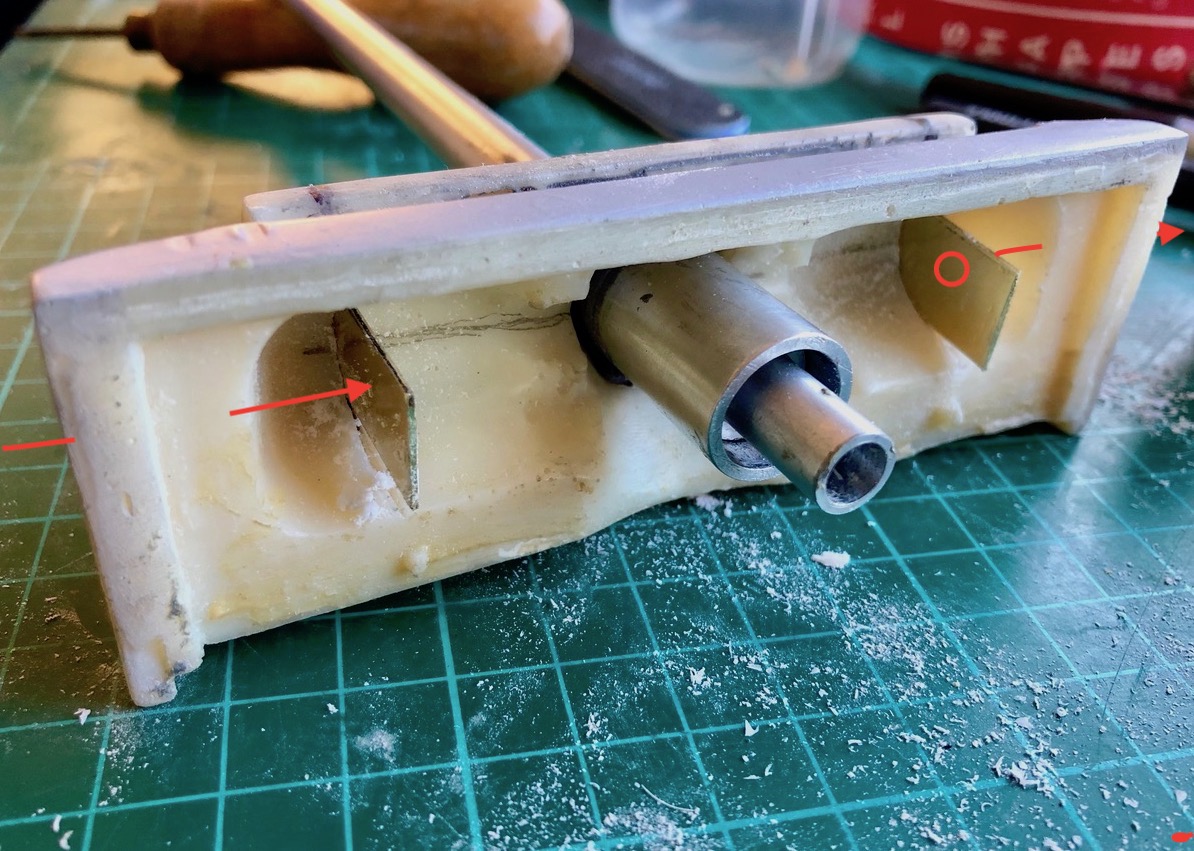

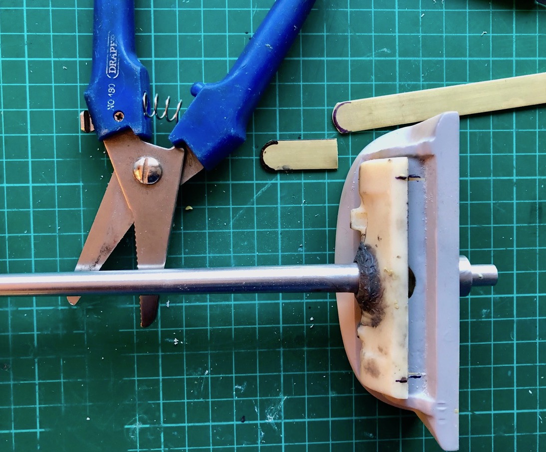

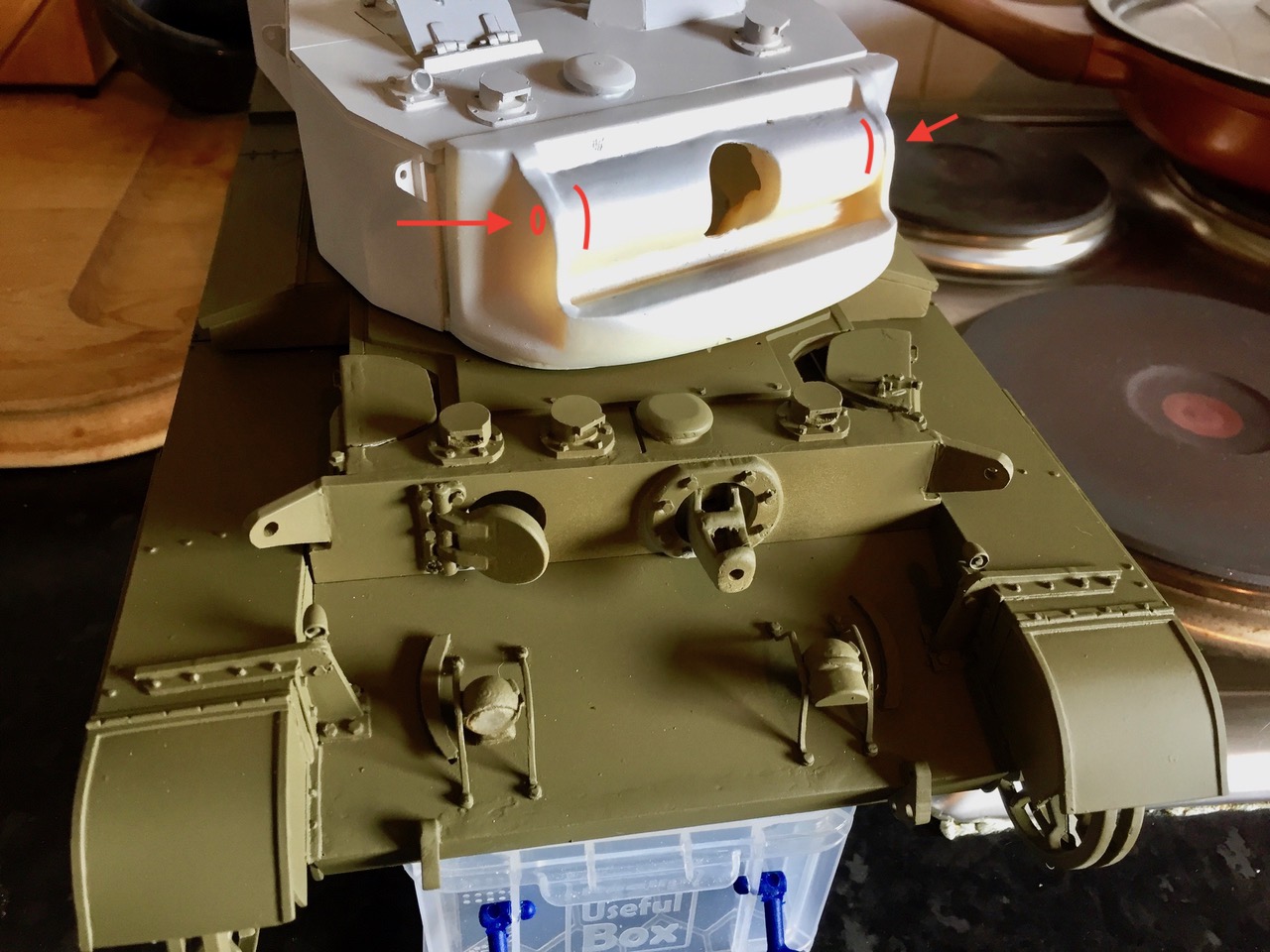

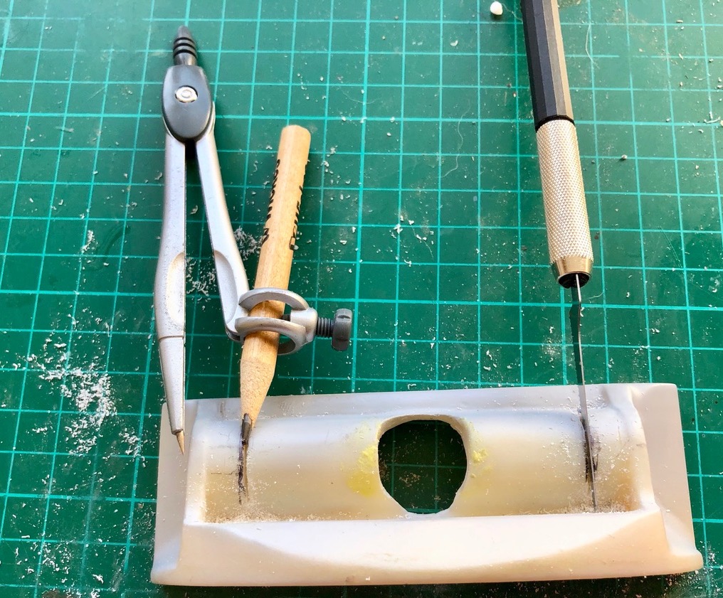

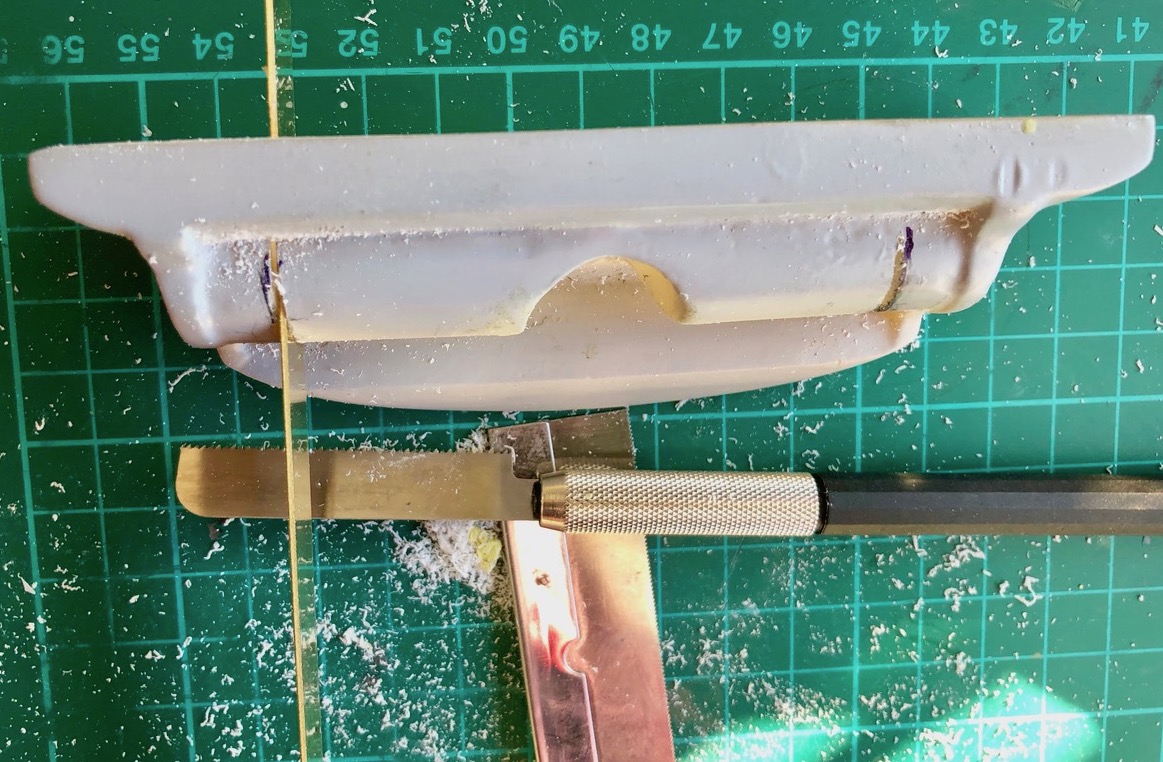

...just a little update to the Mantlet solution. Finally, I've found a few spare minutes to cut the slots for the elevation arms. These will allow the moving mantlet (that now holds the gun and gun tube) to pivot around the static part of the Mantlet housing.
The thing I didn't like about Christian's design, is that the pivots are attached to the gun tube, and retained on the inisde of the fixed section by two semi-circular shaped resin lugs.In any event, the alloy guntube
doesn't seem to be an option with him these days. At least with mine, (if it works
 ), the trunnions/pivots will be, in principle, the same as those on the actual tank.

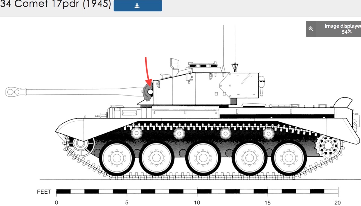

This is Christian's trunnion solution- the part that allows gun elevation and recoil (highlighted with the red arrow). Yes, it's simple and elegant; but unobtainable, and actually wrong in reality. Here, there's an idea of how the arms come though from the two parts of the mantlet. Also the arrows indicate where the two brass rods will enter the Mantlet sides, and act as a pivots for the arms.
Once the two brass arms a securely bonded to the mantlet/gun tube, I can round them off and drill holes for the pivot rods. Right now, I'm just getting an idea of the overall length needed. Length will, of course, dictate how much the gun can elevate; so, it's important to get that right before final assembly.
Here you can see that the brass arms follow the profile of the outer mantlet. I'm just about to fill the gaps with JB Weld, and thus to fix the arms in place. Time for a cuppa...
I'm using JB Weld (metal) to bond the brass arms into the outer mantlet. It takes a long time to cure, but really does have a lot of strength, when it does.
