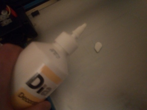

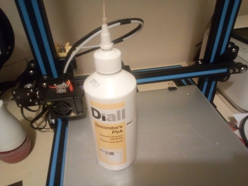

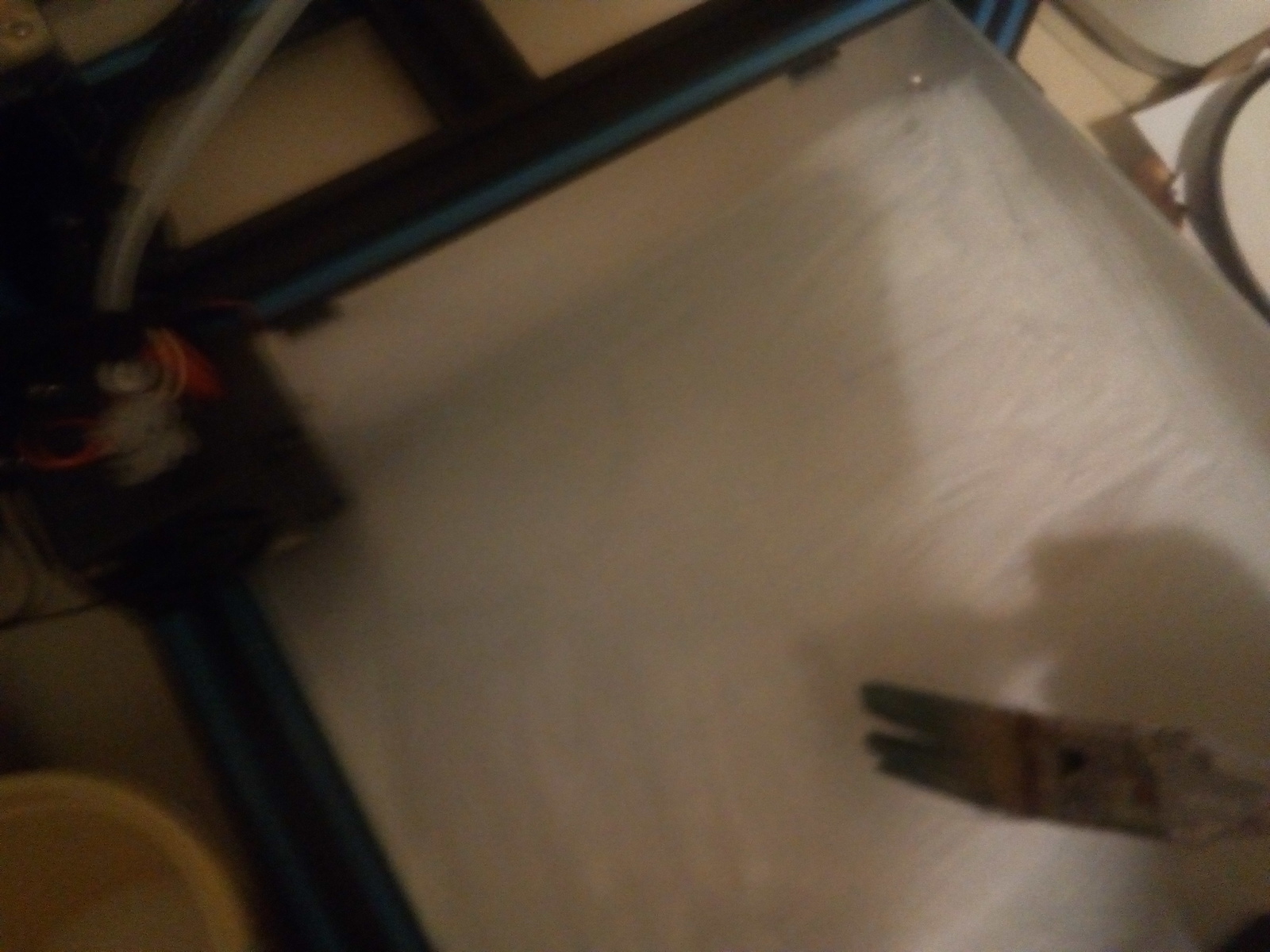

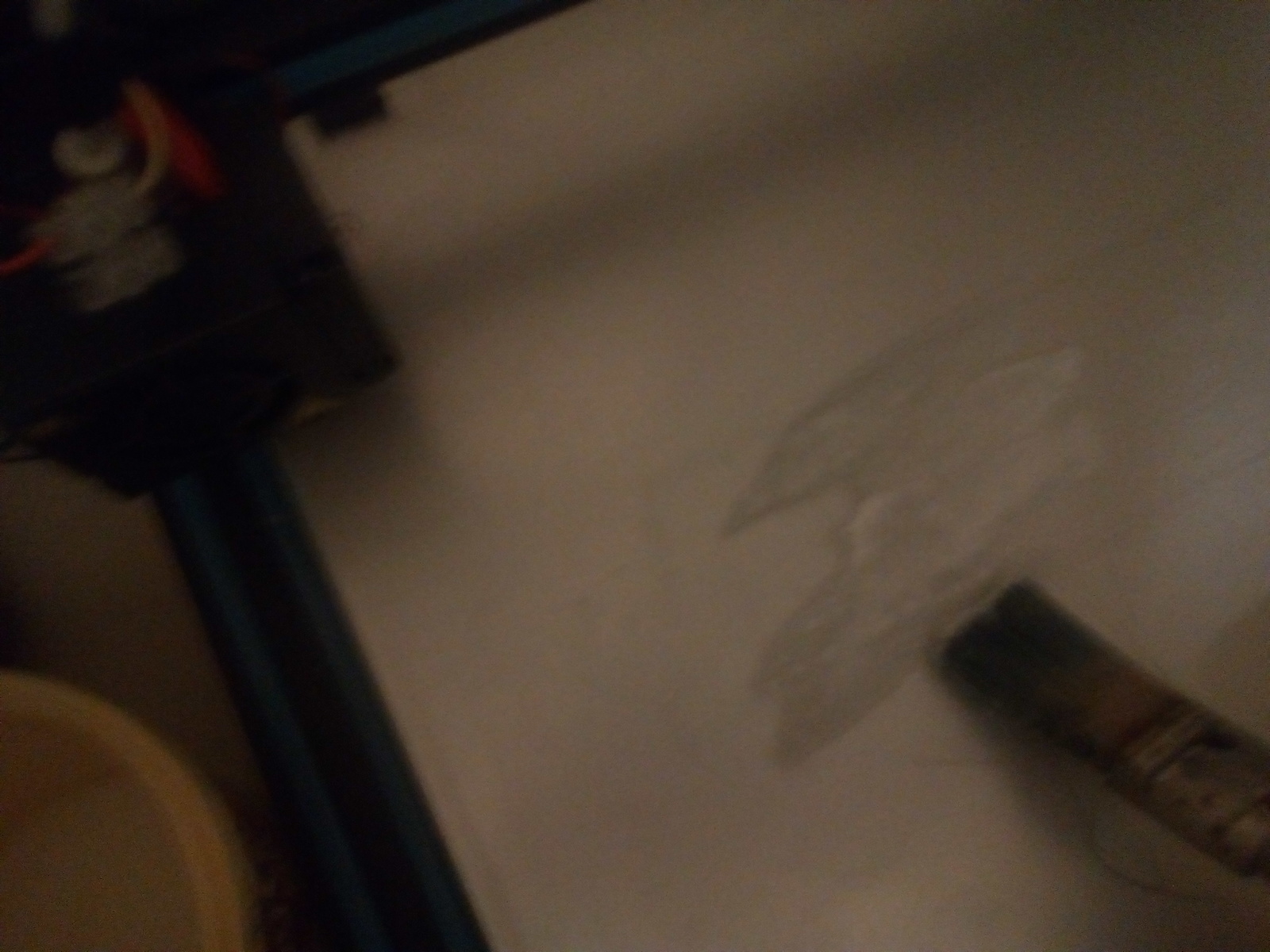

This how I get super adhesion. The brush is just kept in a tub of water next to the printer. One coat lasts many prints.
By the time the bed has reached 48c the glue is dry, the nozzle then heats up and it prints.
