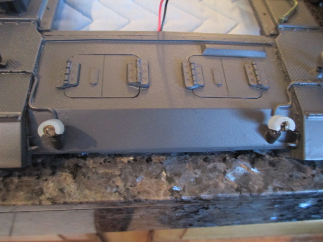

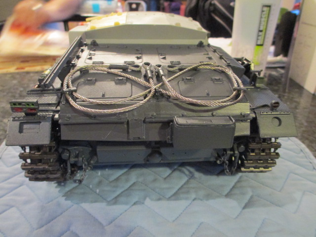

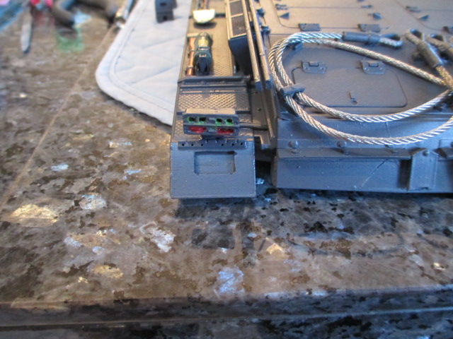

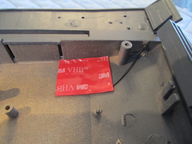

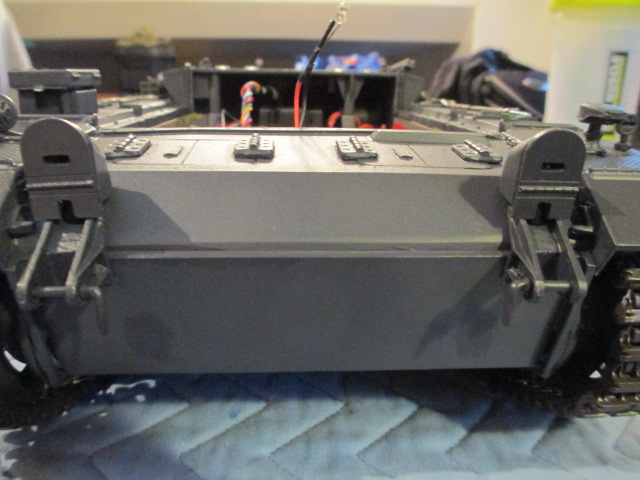

Back from a non tank weekend in Denver and ready to pick up the StuG again. Nothing in the Post yesterday so I took the evening to play around with the Notek and Convoy lighting again. I must have received bad bulbs since I cannot get these to illuminate at all using a known, good pair of pins on the board. The mounts are solid and painted so I am weighing the option of ordering a couple of Mato's inexpensive Notek lights and pulling the LEDs and wiring from those. I've coiled up the wiring on these and taped it down out of the way for now. I painted the rear Convoy light and will consider swapping it out as mentioned above. I'm leaning towards just leaving the whole mess alone and enjoying the working headlights. The MG circuit works so I have an idea on how to make that useful. The solid work of the evening involved deck paint touchup and figuring out a way to make the light buckets a solid mount but removable as well when needed. Pics:
Deck is complete except for weathering the tow cables and a 'possible' convoy light swap out for Mato components.  Next up, the Casemate.
Test fit.  They cannot be shaken or jarred loose so it works.
Working fix for the armored light buckets up front.  Silicone tubing split and glued so the buckets are held in place.
Rear convoy light touch painted to give some color to it.
Spidery convoy light wiring coiled up and taped down
