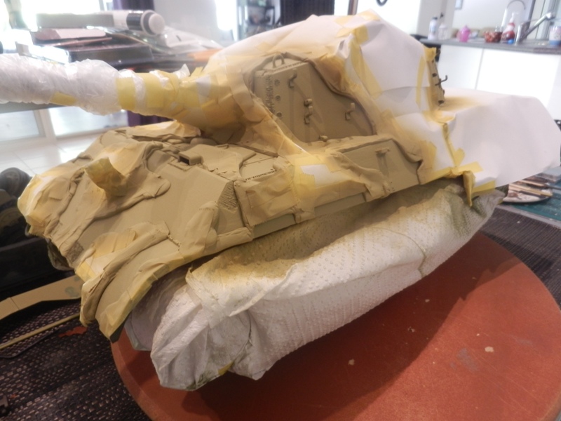

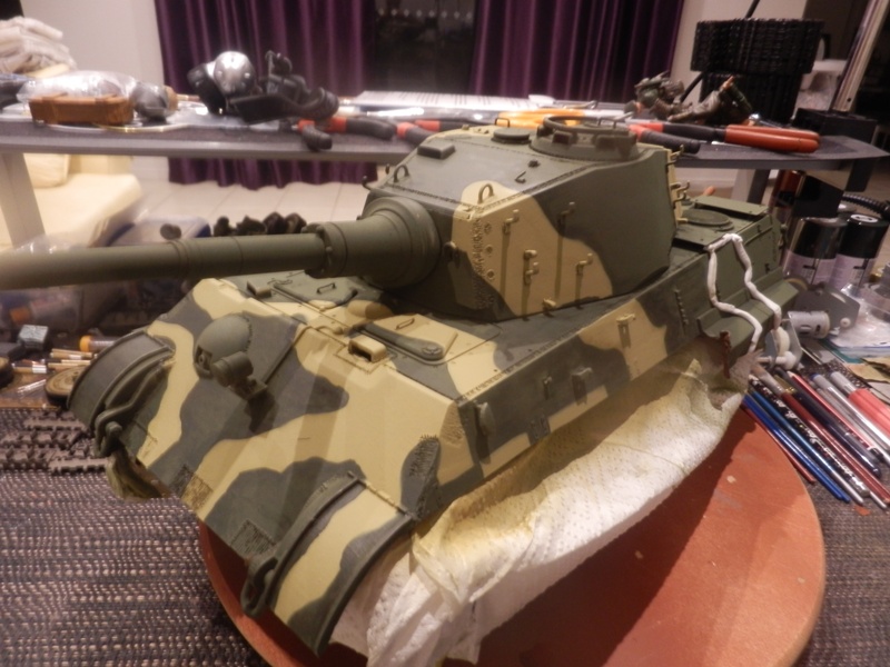

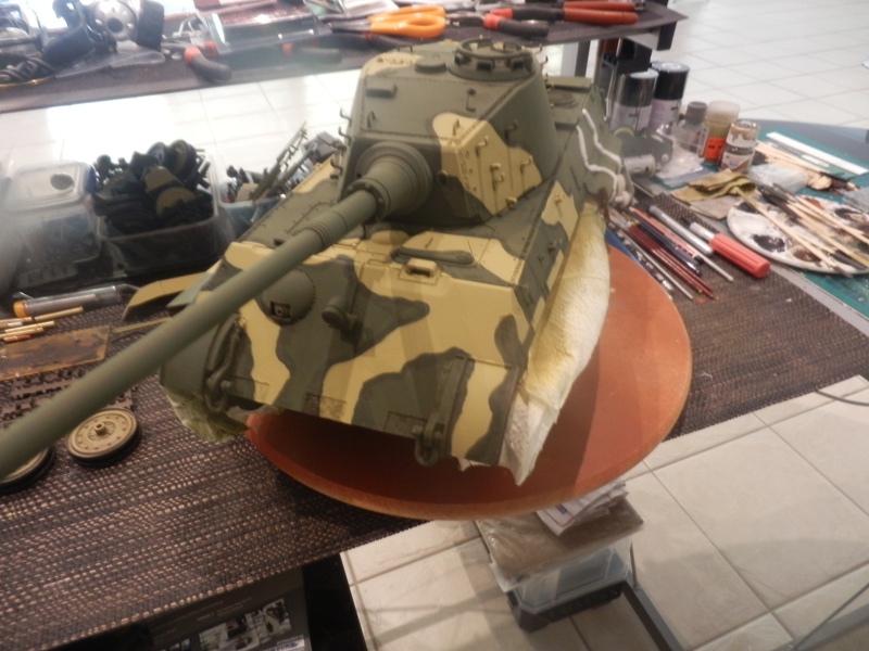

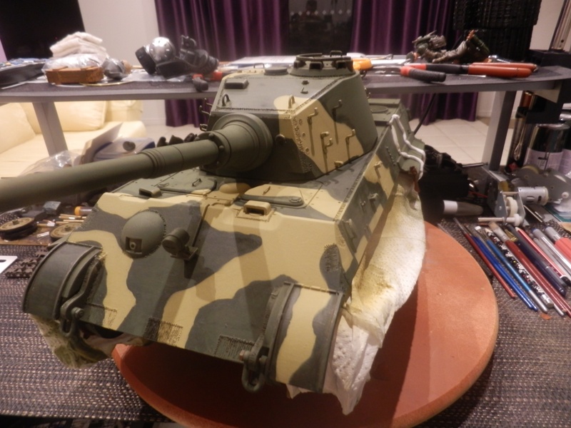

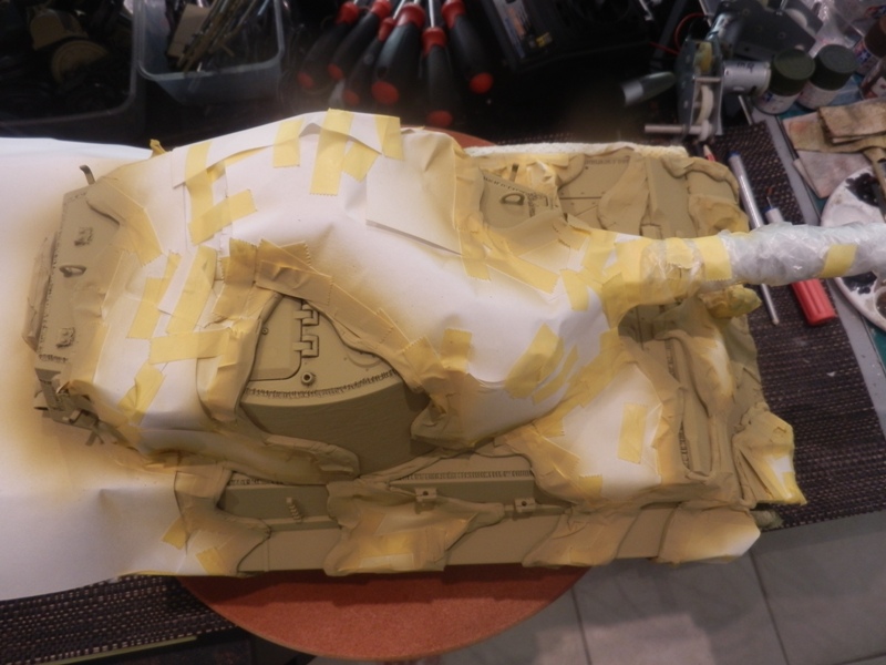

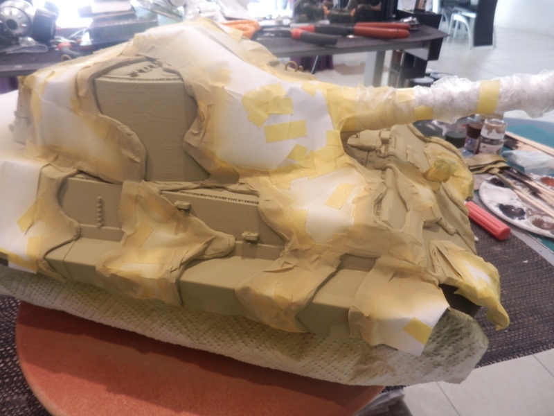

The blue tack did the trick of hard edge control, but it did leave a mark where it sat on the paint.
I really feel that it would have been fine if I had been able to get the paint done on the first day.
Rain etc meant I could not get paint on until today.
Or, perhaps doing one patch at a time would have worked.
The faint but visible damp patches should be invisible once sealer and weathering etc goes on, but it is still a bummer to see them at all after so much work.
I still have the last side Gelb patches to do, and I have decided to leave the engine deck and rear plate green only for now until I see how it looks with the Gelb completed on the rest of him.

Mrs 'B' reckons I should give the blue tack marks a go over with a cotton bud(tip) dipped in thinners & gentrly try to wipe the area & see if it comes good................The green has had a few days to go off, so perhaps this will work.
I will give it a go on a non intrusive spot & see.

I did the quick wipe over with a Q-tip ?/ cotton tip dipped in thinners & rolled nearly dry.
Seems to have worked.
At least the very dark lines around the Gelb have gone or atleast softened enough that they should not show once the Tamiya clear matt sealer goes over it.
I am not going to use the sealer I used on the other 3 as I really want to give the Tamiya stuff a go. Surely it would be the zenith of product to use over other Tamiya paint ?

I seem to remember blu-tack leaving "wet" marks on walls and posters alike. I think I would have tried a little neat washing up liquid on it and then a careful rinse off with clean cold water.

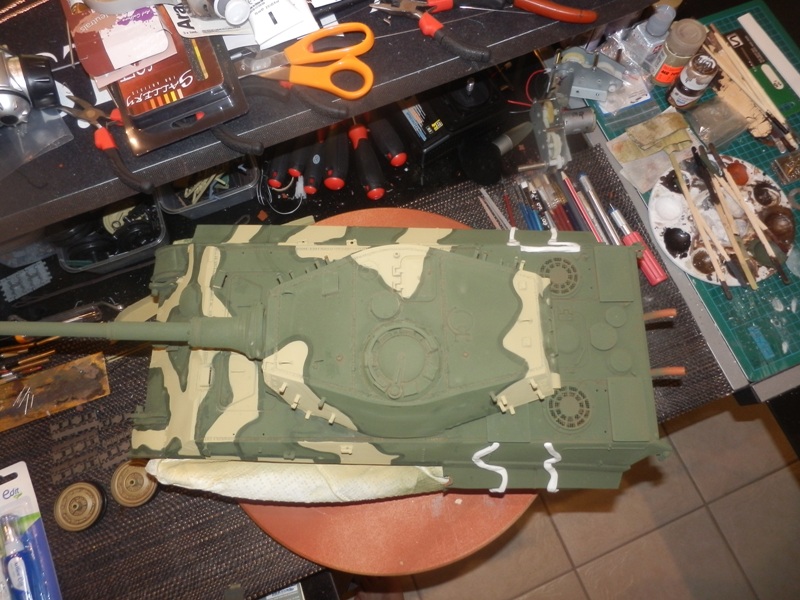

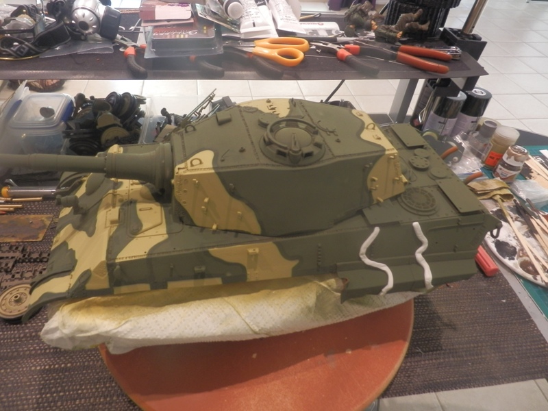

Got the last patches of Gelb masked off, leving the engine deck & rear plate green I think.
Just seems the right thing to do.

Steelhammer wrote:I seem to remember blu-tack leaving "wet" marks on walls and posters alike. I think I would have tried a little neat washing up liquid on it and then a careful rinse off with clean cold water.
She sure is looking magnificent so far!
Goodonya mate, much appreciated.
I used the thinners so as not to get dreaded H2O in any important little places uncontrolled. The green paint blend has shown pretty cool side effects of being wiped haphazardly with thinners...............it has taken on a patchy, sort of scale rushed spray job if you get me
Rather than uniformed spray coat I have now a varying finish which is accentuated by the texture on the plates.
accidental bonus
