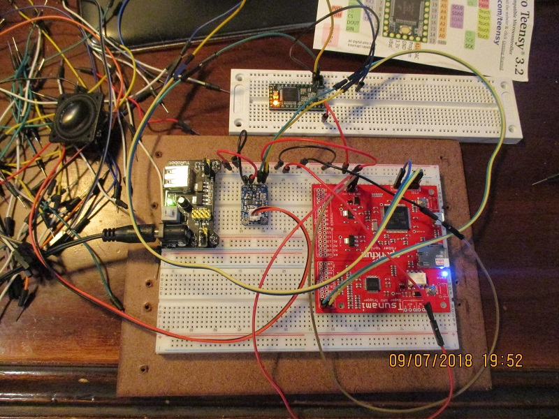

Just got the Tsunami Super wav board up and running with one wire serial control (Tx-Rx) . I am using Robertsonics demo arduino code and the Teensy 3.2 Super nice fades, and polyplay sounds. Should sound great once I add tank sounds and the serial code to my RC code...
I know it's not RC tank sounds, but you get the idea.....
https://www.youtube.com/watch?v=g0b_fDJZg80
Re: 1/16 Elefant Ludwig/Asiatam

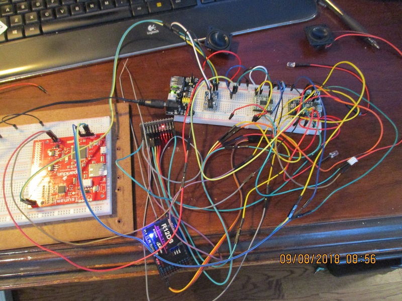

OK, so this am I merged the Tsunami wav board with the Teensy sbus RC controller both physically through the wiring, and in my code. It all works nicely. The Tsunami serial control is straightforward . It's messy breadboard wiring right now but really will be minimal when done.

Thx CRainford! Its been a bit of a day trying to get the serial control working. I have to create some kind of array or 'for' which does not let the tracks repeat. I am able to get MG sounds and Cannon sound and idle sound no problem. Also fades and loops work fine. It is just getting one engine sound to another fading and looping all at once....I am sure that someone with coding experience could get this done in a few hours..
Other issue was a bad RMILEC (died after 8 hours) which of course made for some horrible serial sound issues...and took a bit of time to find..hence the blue light 8 channel sbus converter..a back-up.
Here is basic idle with overlayed MG and Cannonfire, note: real MG34 and 88mm sounds
https://www.youtube.com/watch?v=BNNmEDc0YVE
