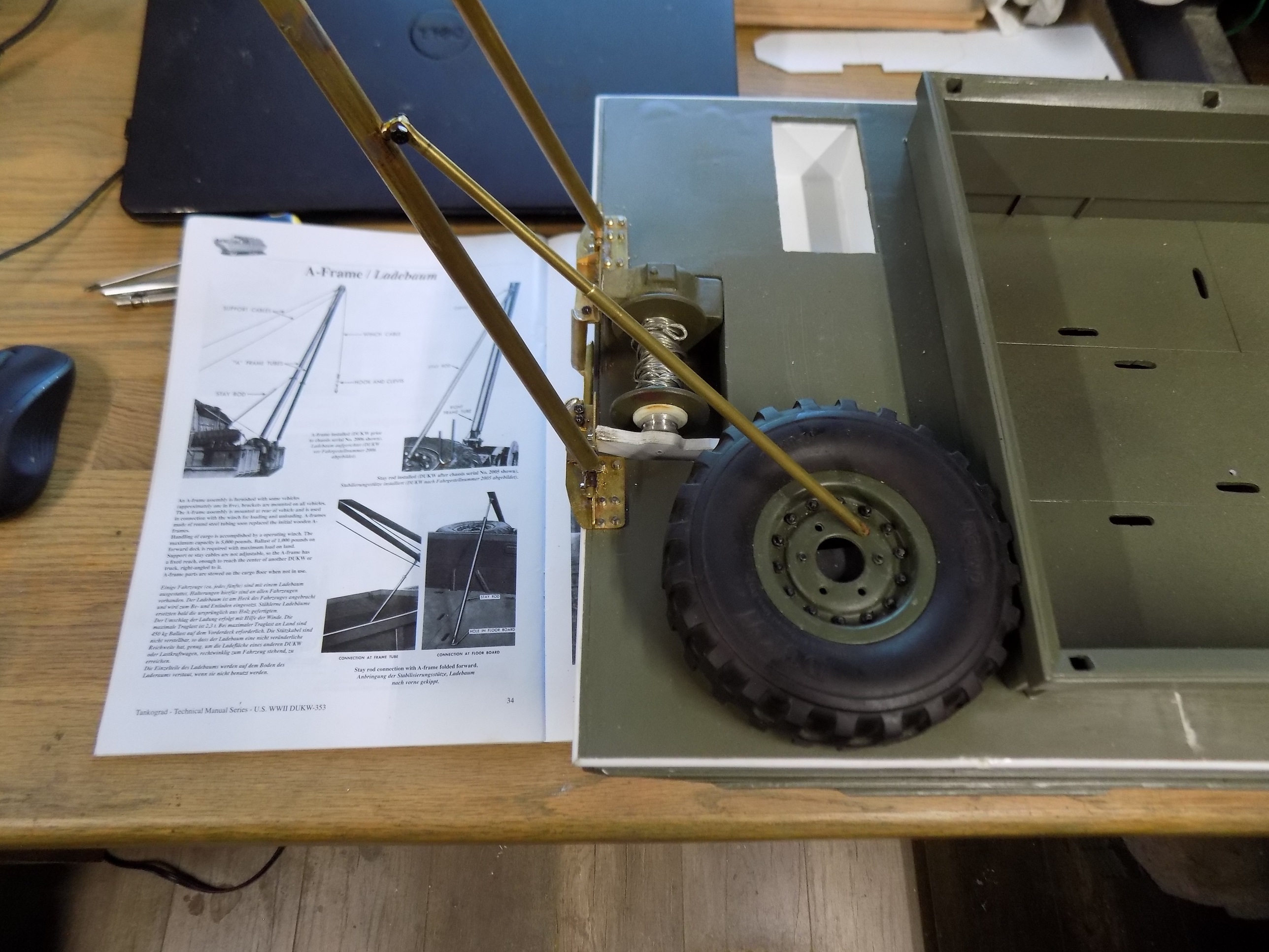

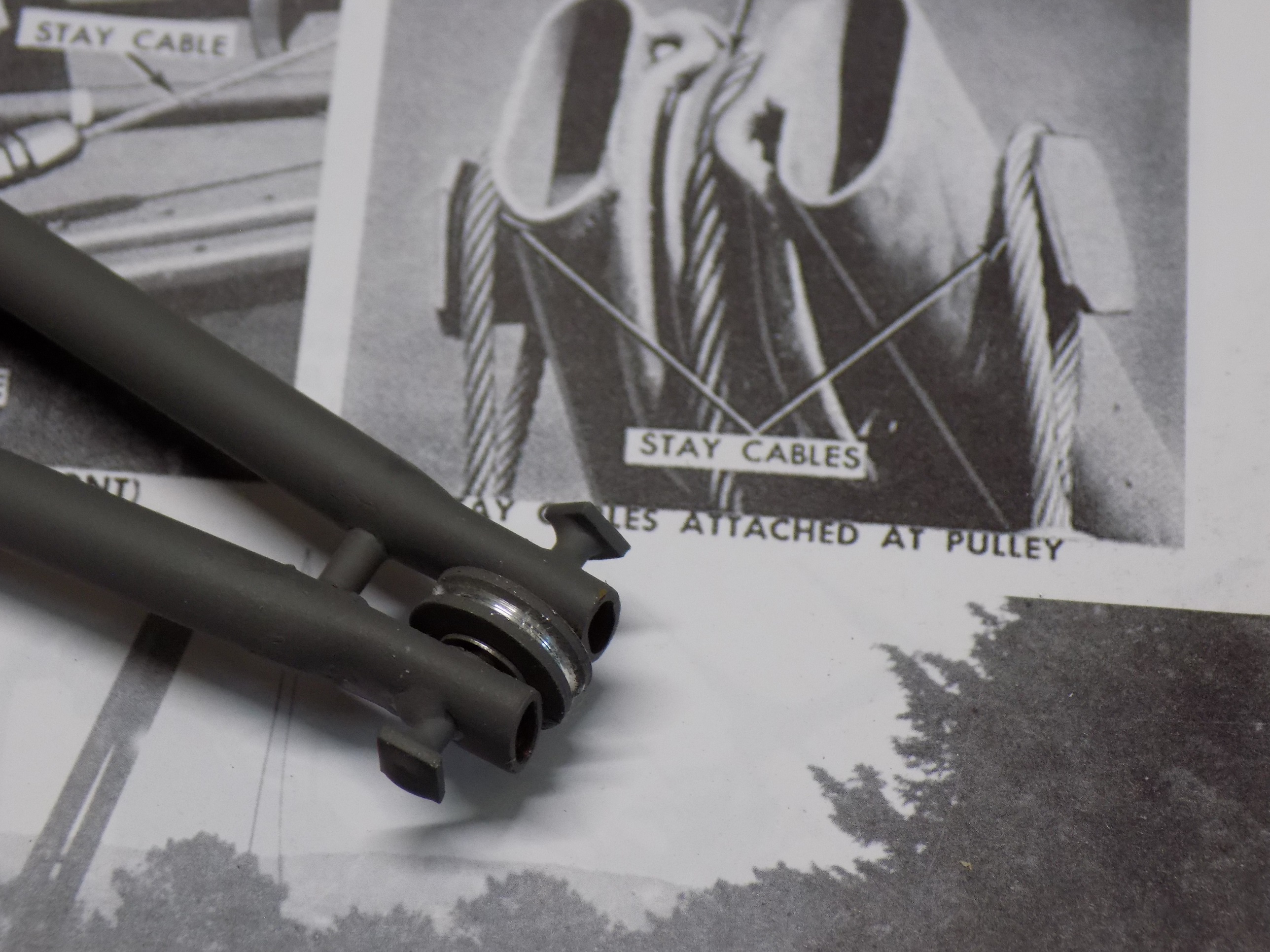

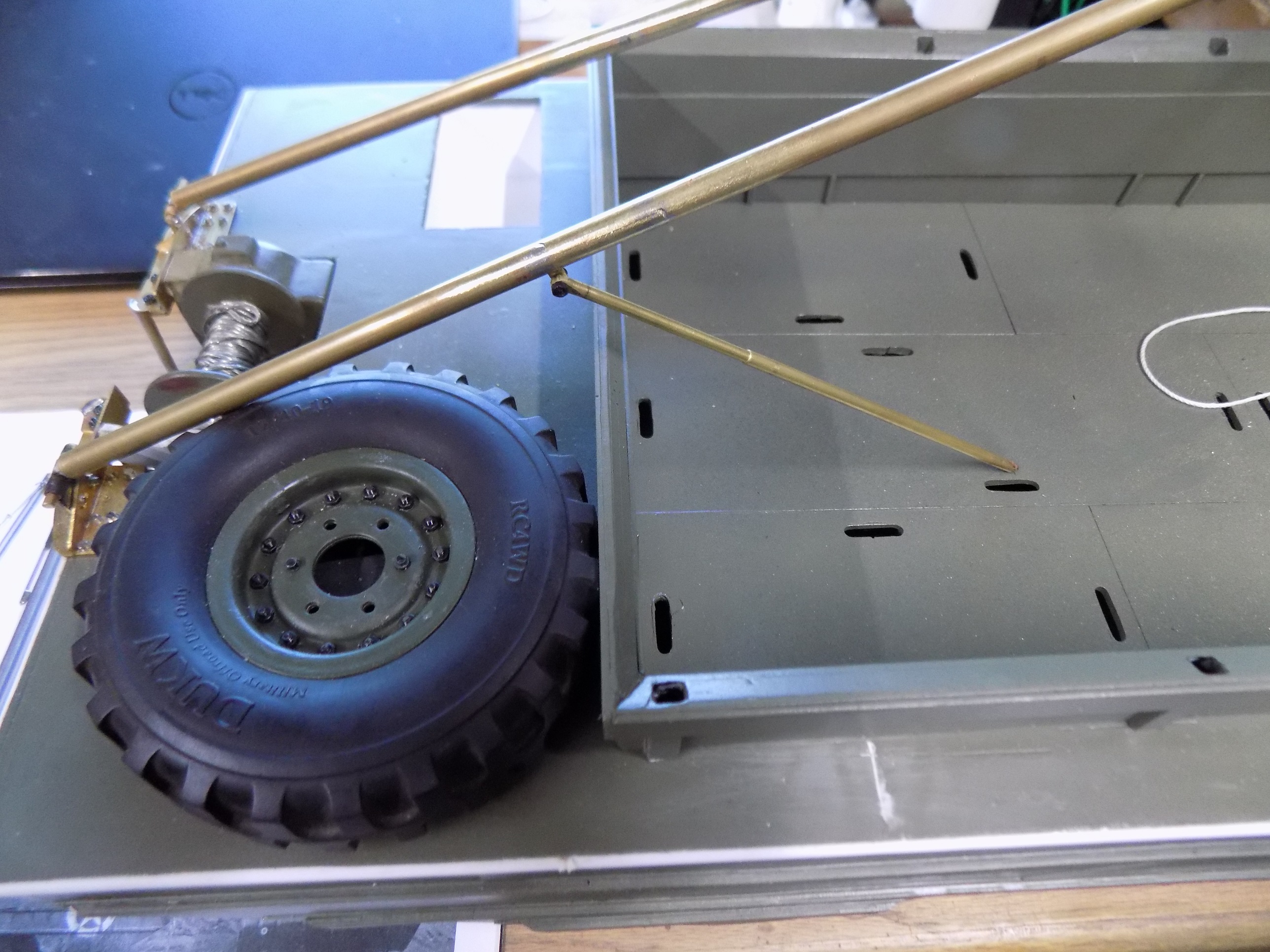

The booms could also be installed and folded down to travel. The stay (when the crane was up) simply held tension on the cables. The cables were attached to the forward lifting hooks (which I haven't built yet).

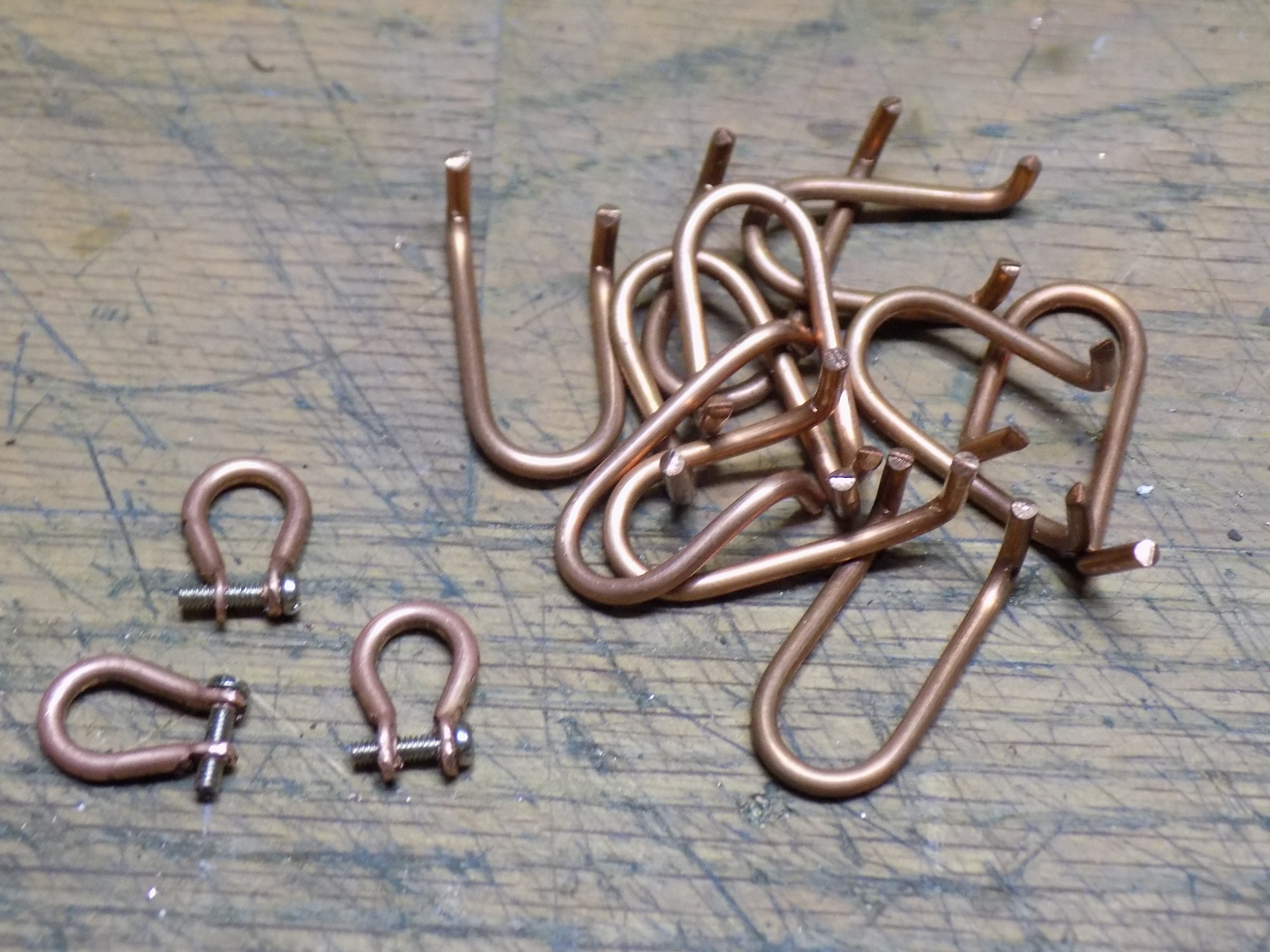

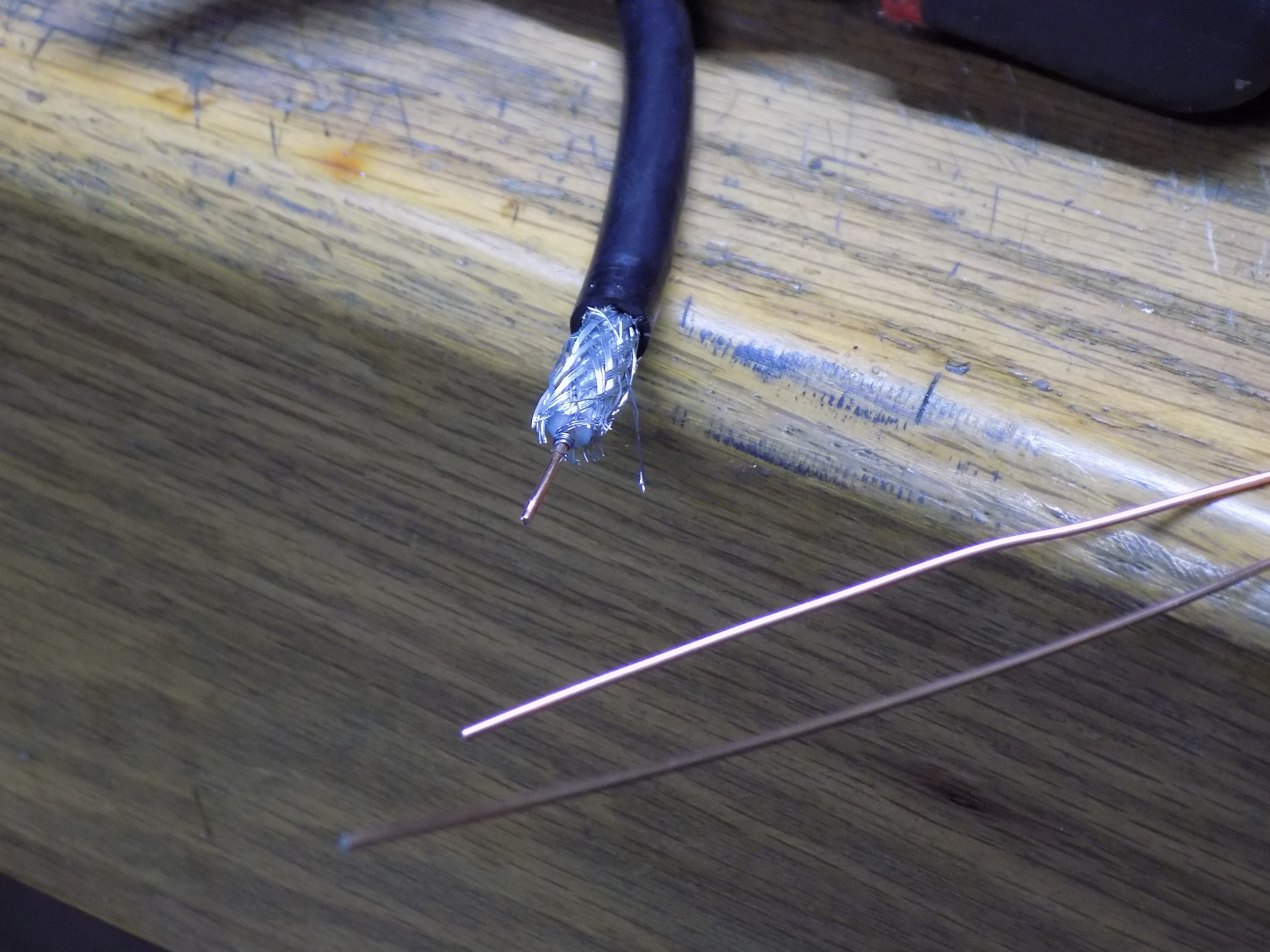

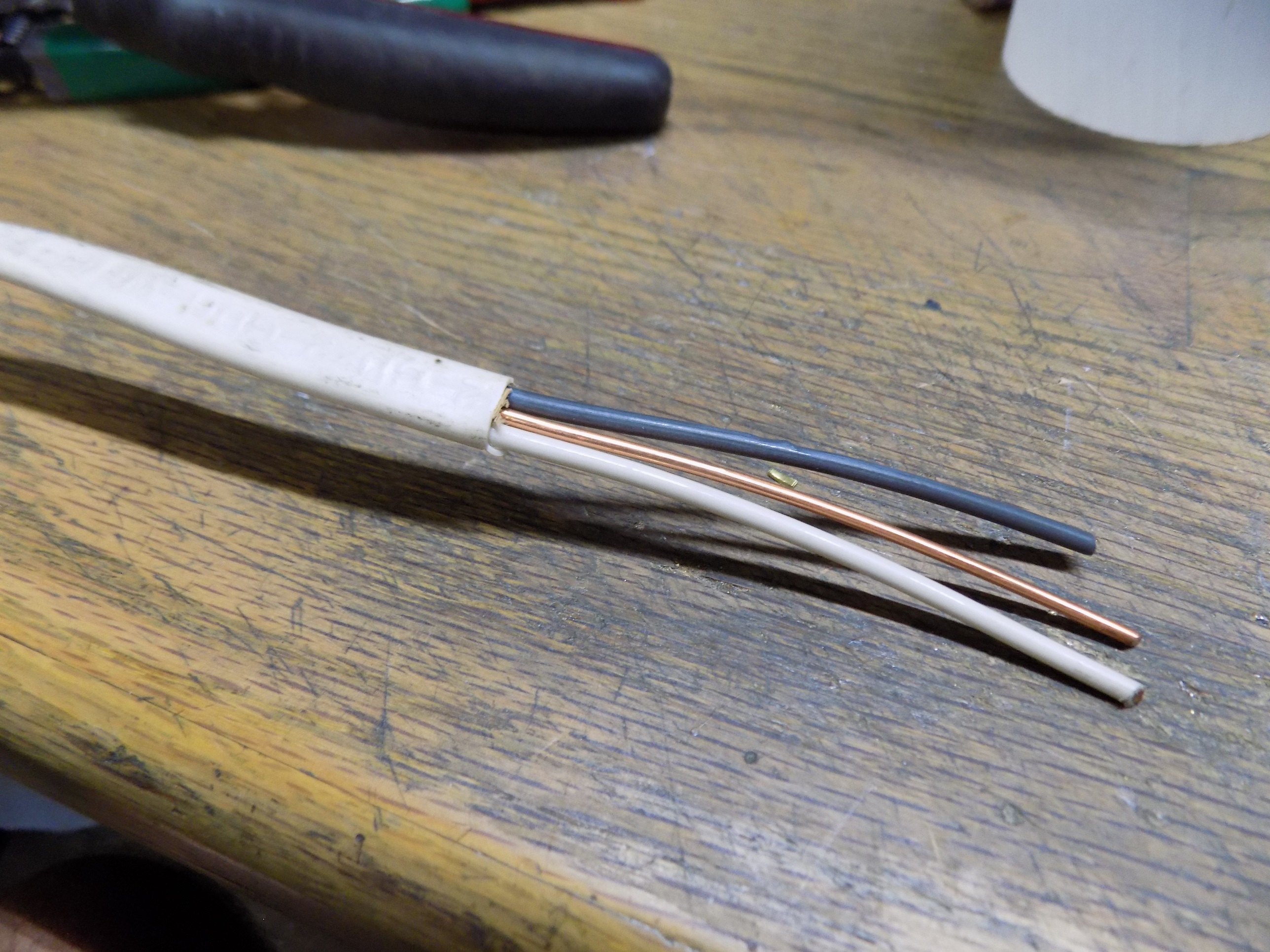

Here in the States, this is 12/2 Romex. Wire thickness varies, this is .080 (about 2mm). The wire in the black and white sheathing is the same just a bit harder to get to. I'm using this to make the six lifting hoops on the sides of the hull.
I know print them, print them... I have a printer but I still don't know how to make it run properly. So I will attempt to old school these clevises (hey, Mike still can't post a picture).

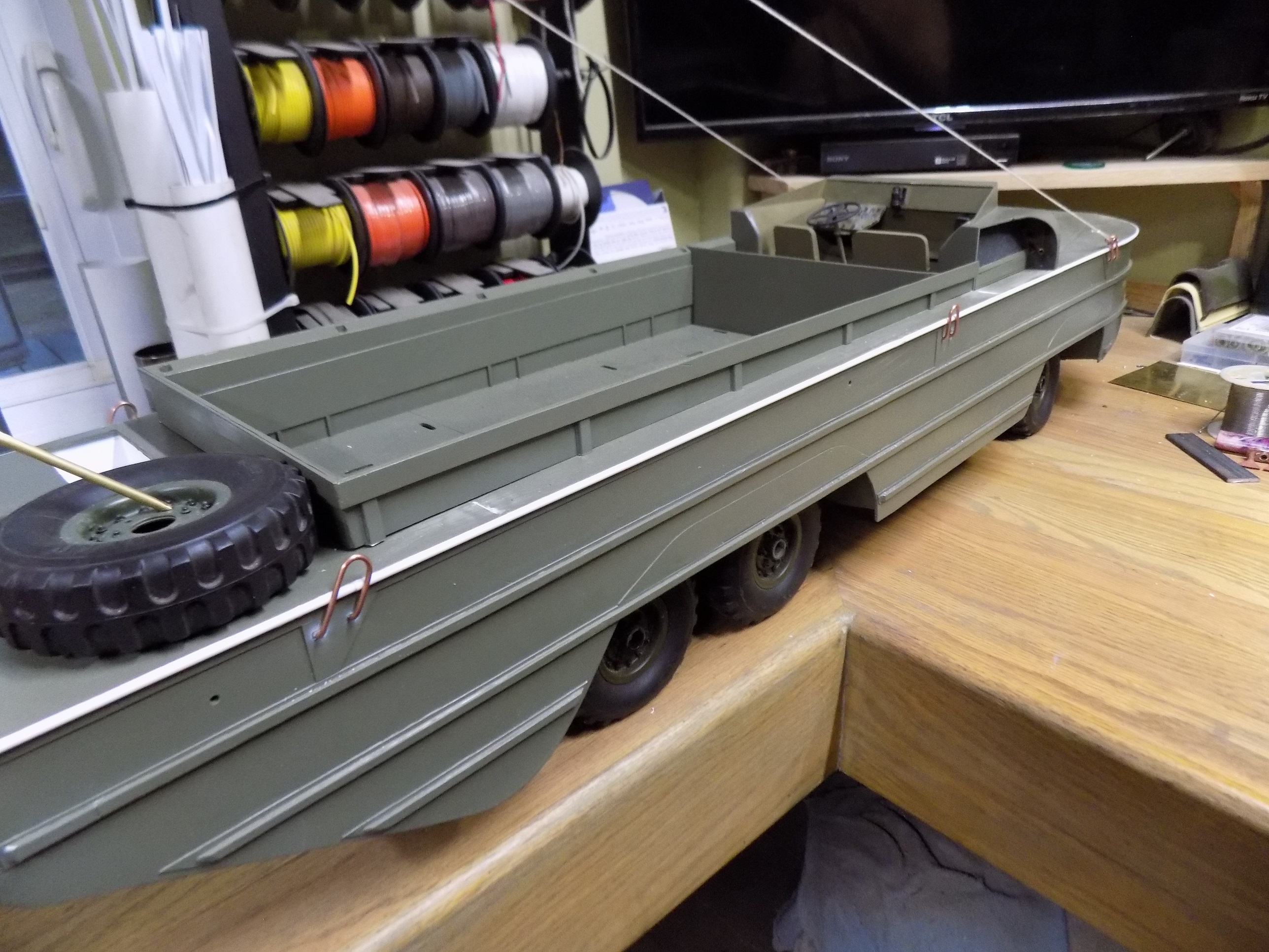

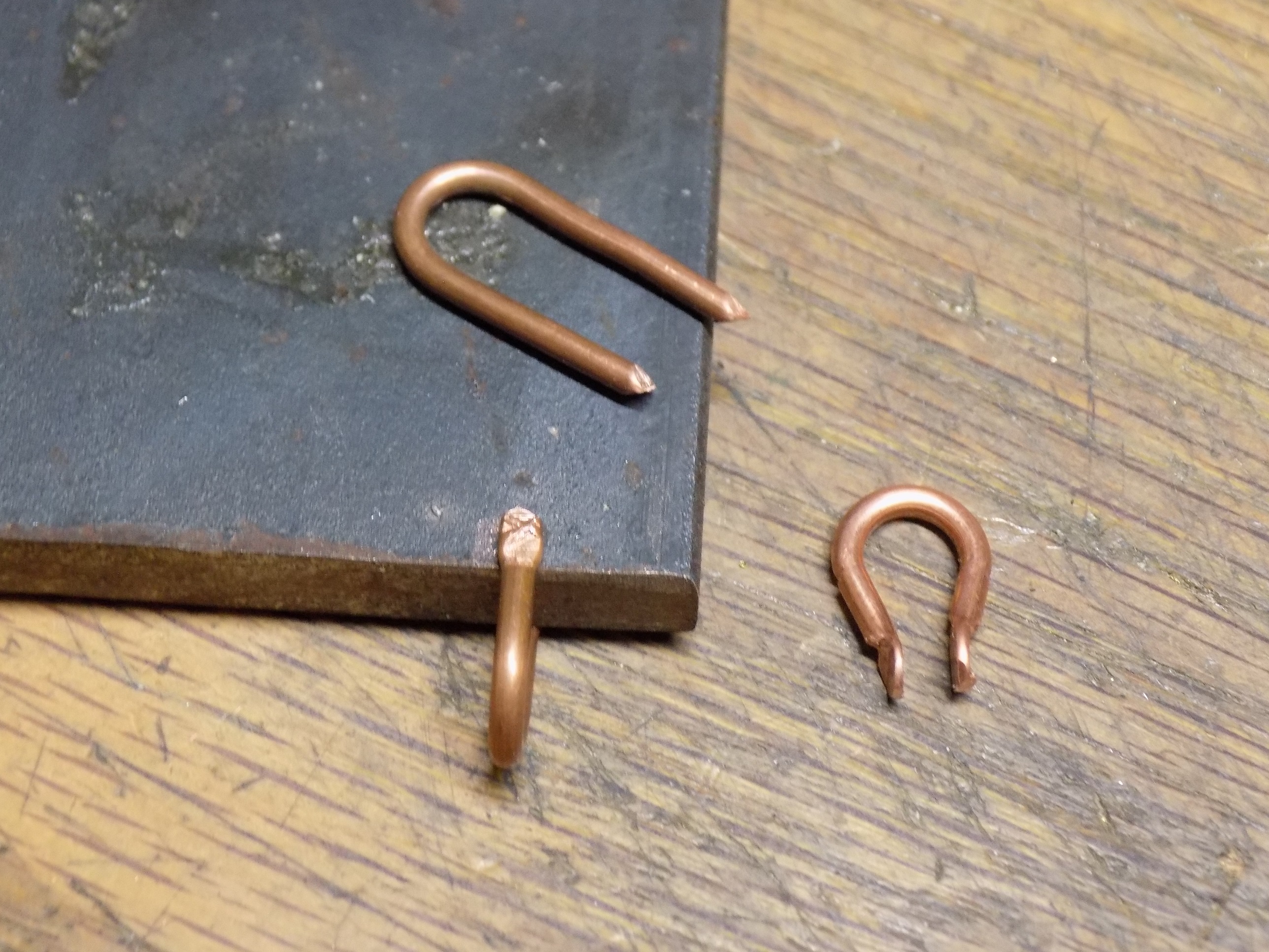

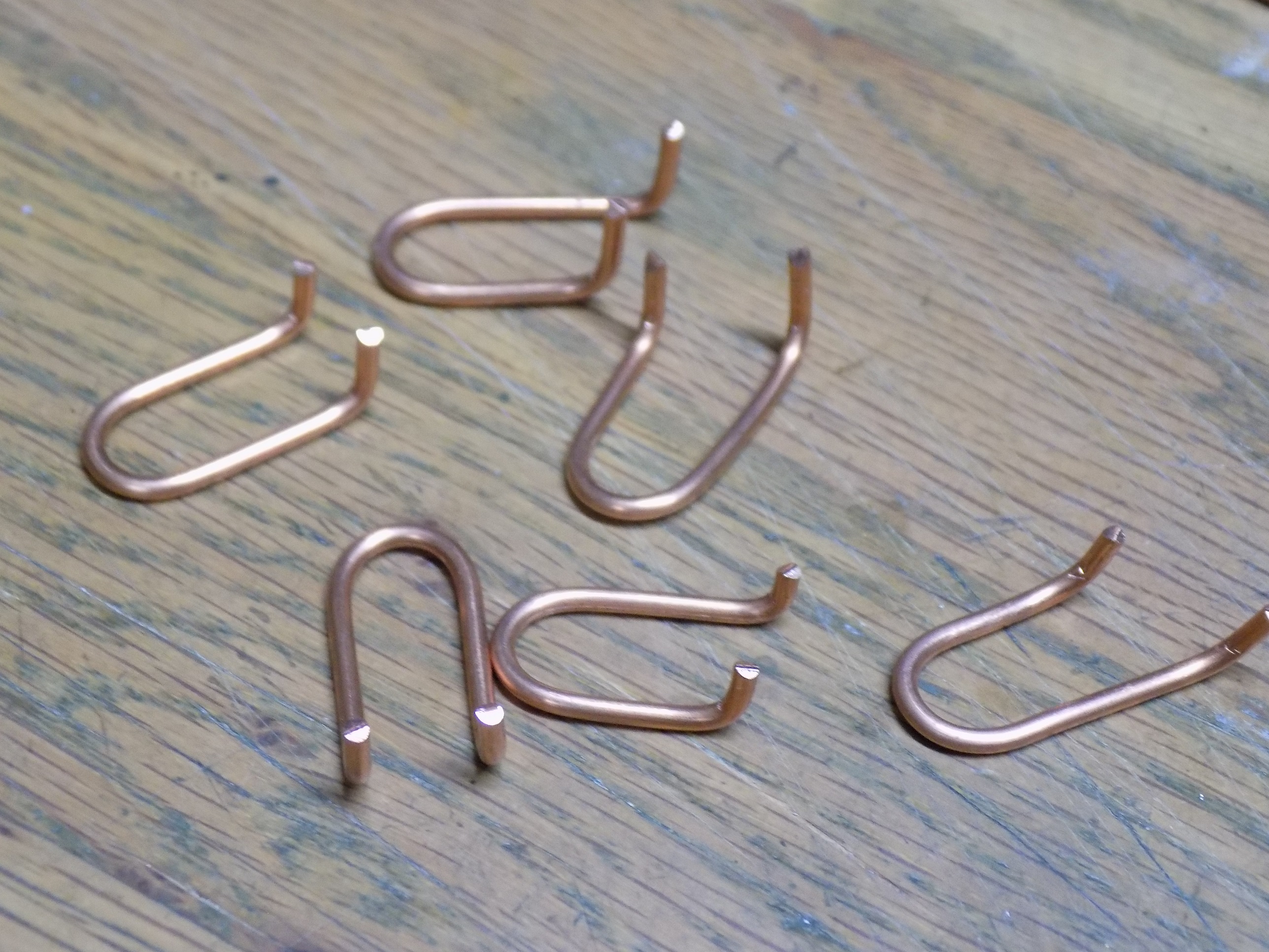

Didn't get a whole lot finished. Can't believe how many hooks and hoops are on these DUKWs! I built a jig after the first set of hoisting hooks didn't come out very even. Then I lengthened the jig by .120 to remake the hoops as the second set were too short. Also made a couple drilling templates to keep things even. Clevises are finished, in the second picture are the two sets that didn't work out. Now on to the little hooks and hoops.

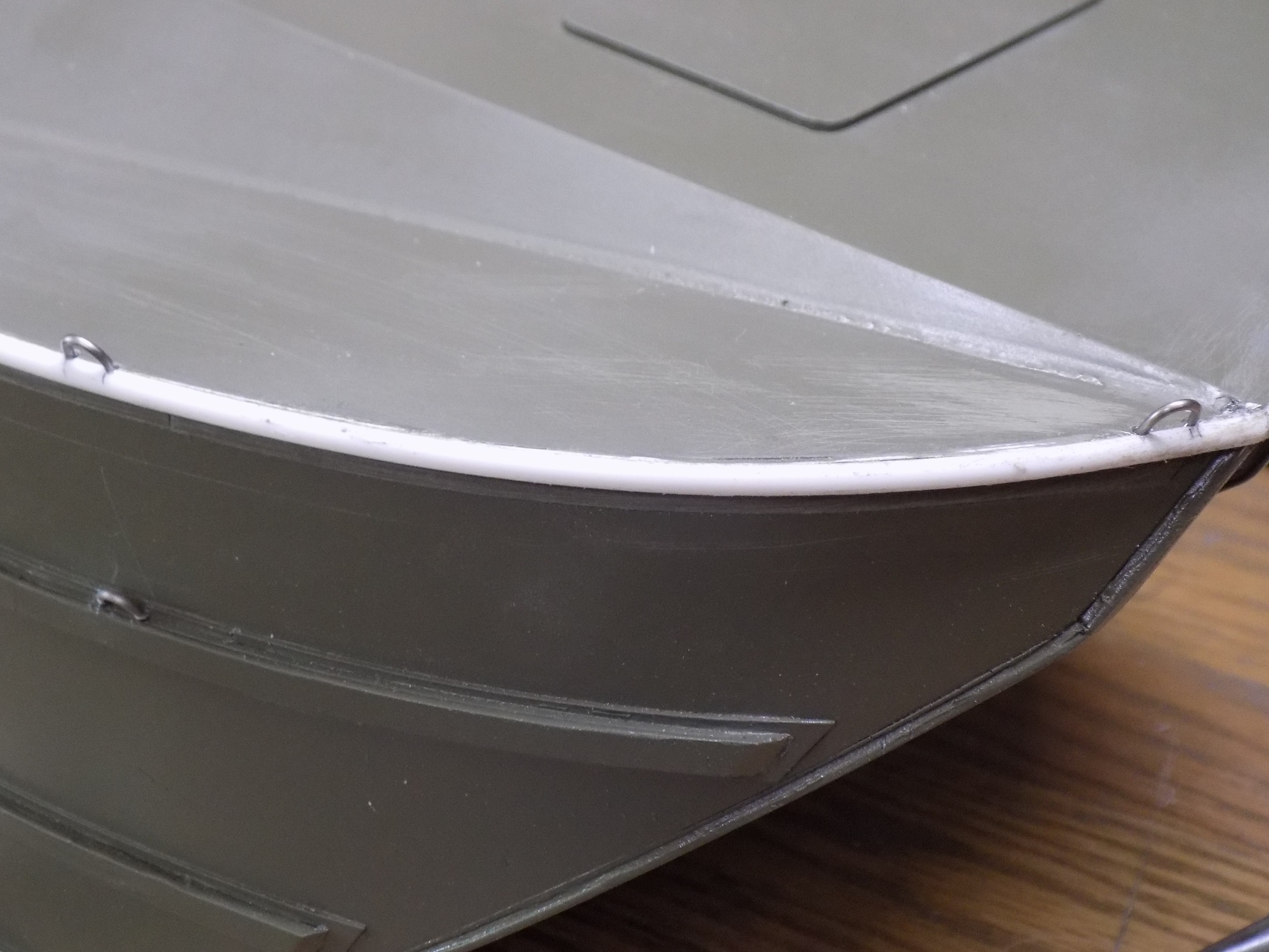

Spent about three hours last night going through the books and every picture I could find on the net for hooks and hoops. I learned there was a variety of arrangements. I chose to go with what was most common. I even found a picture of a DUKW with the same square side ribbing on the top rail. Could have been a shortage of supply when it was being built or a rebuild, restoration...
After testing, reworked the top of the boom to make it more accurate. Besides the six hoisting hoops there are 40 more hoops and hooks mostly for lashing cargo, bumpers, canvas top and tying off when it is a boat.

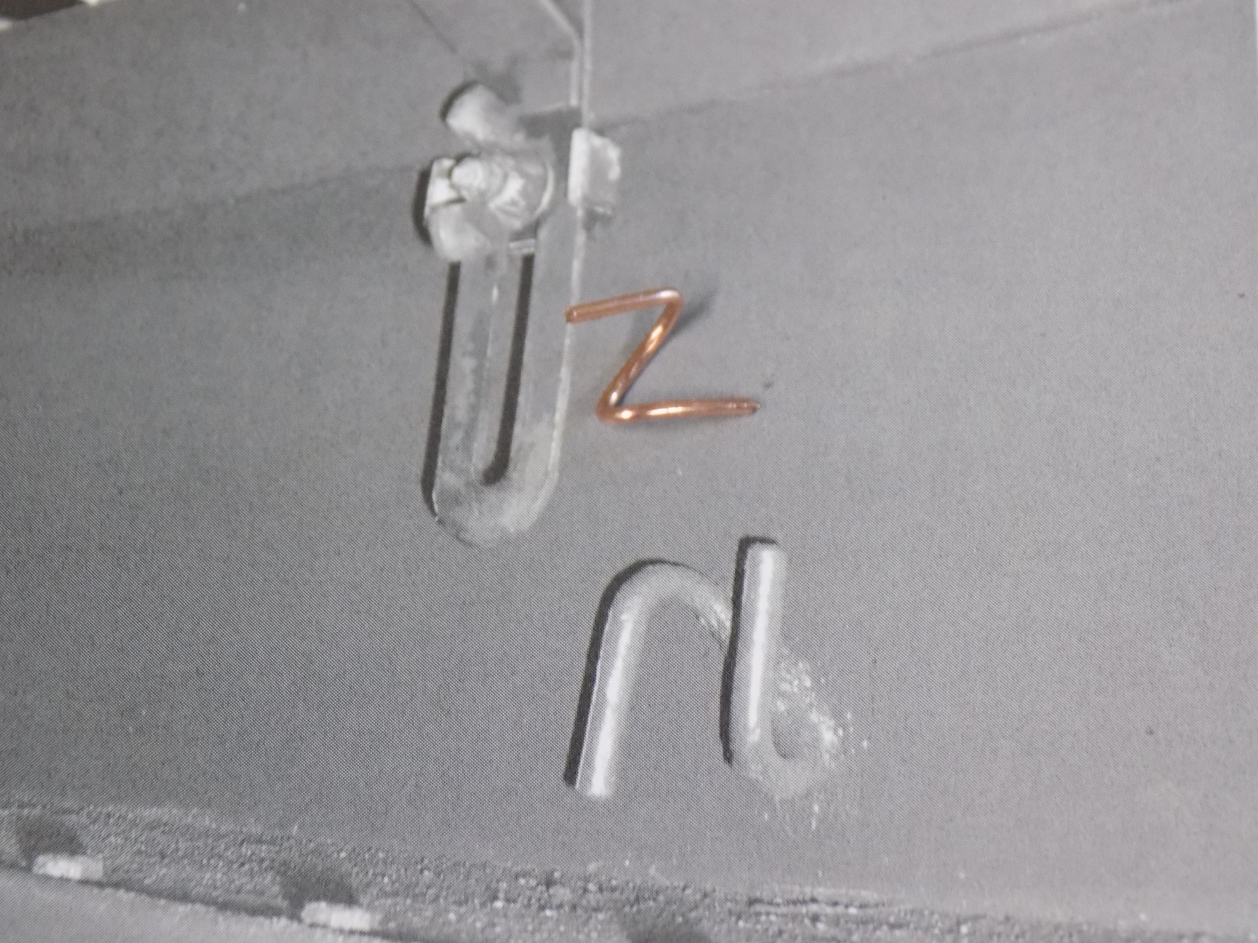

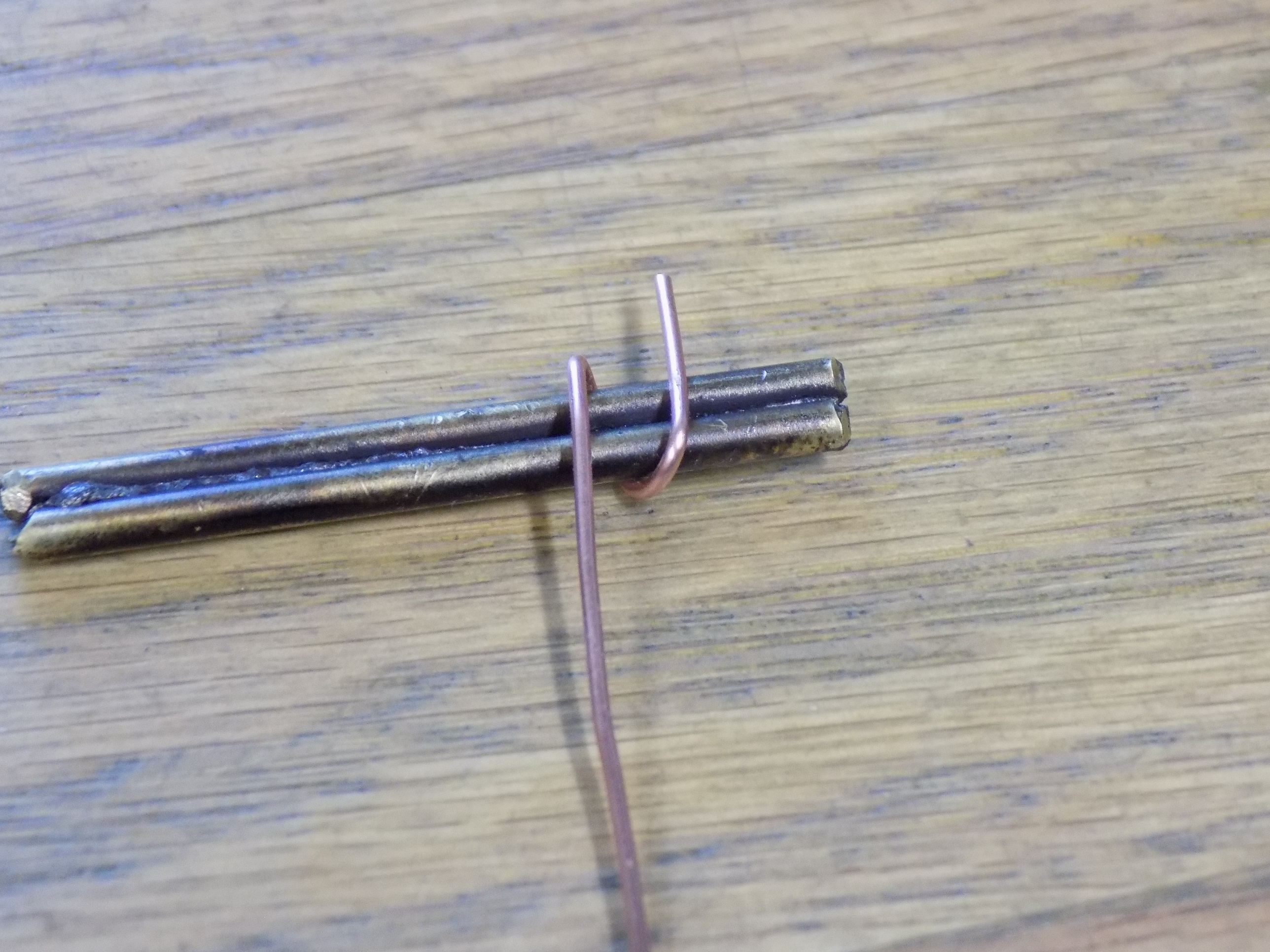

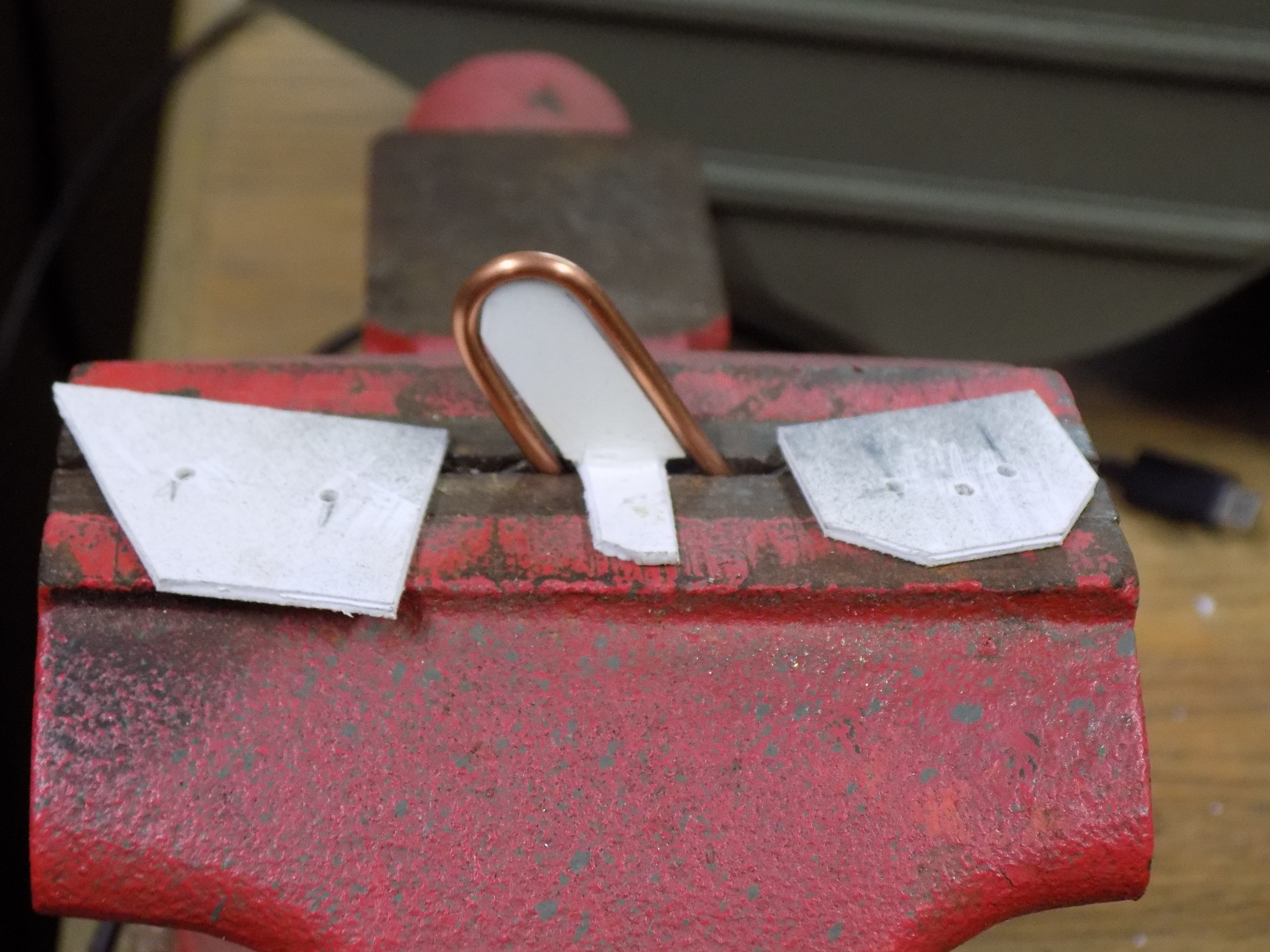

As some of you may have figured out by now, I tend to scrounge and use what is on hand to build things. This is TV/cable coax. I needed a small stiff wire to build the 10 canvas top hooks on the sides of the bed (5 per side).
The tool to help form them.
The only clear picture I could find of what they looked like.
