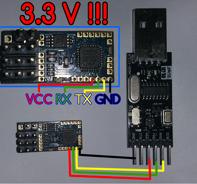

So, I have a benedini micro clone and never tested it until now. After hours trying to connect the board to the computer I have seen that the programmmer comes bad wired from factory, so I had to swap the wires... But the last problem is some peopel says it wont work in windows 10, and I have no other windows. Do you now if it works in windows 10?
And also last question, I have seen two kinds of benedini programmers. One has 3 wires and other 4. I have the 3 wires one. What is the difference?
Thank you for your help and sorry!
EDIT! FIXED
Well guys, ignore my previous post. The micro board clone works, and works very good. And also I can change the sounds and functions at will... I recommend you to stay away from the overpriced and faulty programmer (comes bad wired from factory) and to buy a 2 euros free shipping programmer at ebay and wire it as follows. The VCC wire is not needed. So now it works perfectly, tested in my windows 10.
EDIT! FIXED

I'm happy to answer questions when I know the answers, but in this case I probably don't. You might want to start a new thread on this topic so that others with more experience will see it and chime in. You can always post a link to other threads here if you want me to see it.
I don't actually own a Micro, either from Thomas or one of the clones, I've only tested the MIni. The Mini programming cable is 4-wire, so I'm assuming the 3-wire version must be for the Micro, though again I don't have direct experience with it.
I haven't tried TBS Flash in Windows 10 either, though I would be surprised if it didn't work. Since you have Windows 10 why don't you try it and see what happens?
EDIT: Just now saw your update! Glad you got it working.

Hi RadRad_Schuhart wrote:Hi Luke, I was going to send you a private message but then I saw you dont want them (and has total sense, lol)
I was going to open another thread but I guess you will see my question here sooner. But if you consider I am derrailing your thread I'll delete the post.
EDIT! FIXED
So it's safe to say the micro clone will work with my open Panzer boards and I just need to get the proper programmer and off I go? Thanks

Hi mate, Luke explained it in this thread better than I can.
The mikro clone will always work in wathever you have. You will have motor sounds and you can trigger the ton of extra functions, but it wont work with the open panzer in a satisfactory way. The motors will work perfectly but not the cannon sounds, machine guns and so on...
I am afraid for the open panzer you need the benedini mini, which has no clone so far and is expensive...
