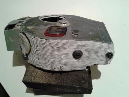

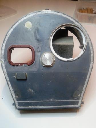

Now, after the distractions of the turret MG (which I will get back to shortly) I decided it was time to have some more fun with some of my 'silly putty'.
More turret zimmerit and roof weld beads
Zimmerit on the right side of the turet after a little battle damage has been added.jpg
Zimmerit on the right side of the turet after a little battle damage has been added.jpg (25.87 KiB) Viewed 5336 times

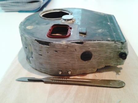

Well this was pretty much the same as the other side of the turret, although the escape hatch makes things a little more interesting (and I'll come back to the hatch itself next time).
Note that the left side of the turret usually had only two track hangers. Obviously the escape hatch takes up some of the room but there were originally three - until they found that the rear-most one got in the way of the engine hatch (this could only be opened by traversing the turret to three o'clock). You do see some pictures of Tigers with three however, and my set came with eight in all (five for the left side, three for the right).
Well that's the other side almost finished.jpg (25.58 KiB) Viewed 5336 times
The Hachette stowage bin is only temporarily pressed into place in these pictures to ensure that it sat flush against the zimmerit. Remember that the bin was attached after the zimmerit had been applied to the tank.

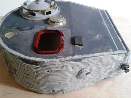

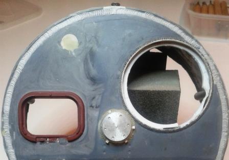

Next I got stuck into the weld beads around the turret roof. I had already ground down the original beads to leave a shallow groove around the gap between the turret sides and roof in he same way I did with the hull - although the horse-shoe shape around the back of the turret was a bit more of a challenge. Then I laid in thin sausages of Magic Sculp, pressed and smoothed them into place with my fingers and shaved off the excess with a sharp, flat-edged tool. For the thinner weld lines behind the mantlet and the other, parallel one behind it I simply pressed the putty into the gaps which were already there.

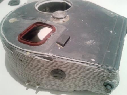

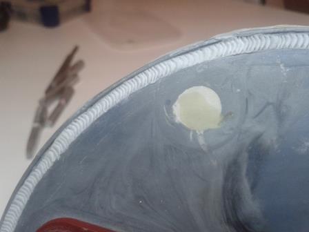

Then I went to work with my V-shaped tool, pressing it into the putty at a shallow angle at regular intervals to make the distinctive 'ripple' of the weld beads. It's a little rough right now, but some gentle sanding tomorrow should tidy everything up. Then I'm hoping the paint job (when I finally get around to it!) will bring everything together...
As with the hull roof thin sausages of putty were rolled out and laid into the groove.jpg
As with the hull roof thin sausages of putty were rolled out and laid into the groove.jpg (26.46 KiB) Viewed 5336 times
Weld beading was added using a V-shaped tool.jpg (26.5 KiB) Viewed 5336 times
Close-up of the weld beads around the rear of the turret roof.jpg (20.44 KiB) Viewed 5336 times
The completed turret roof weld beads.jpg (25.05 KiB) Viewed 5336 times
