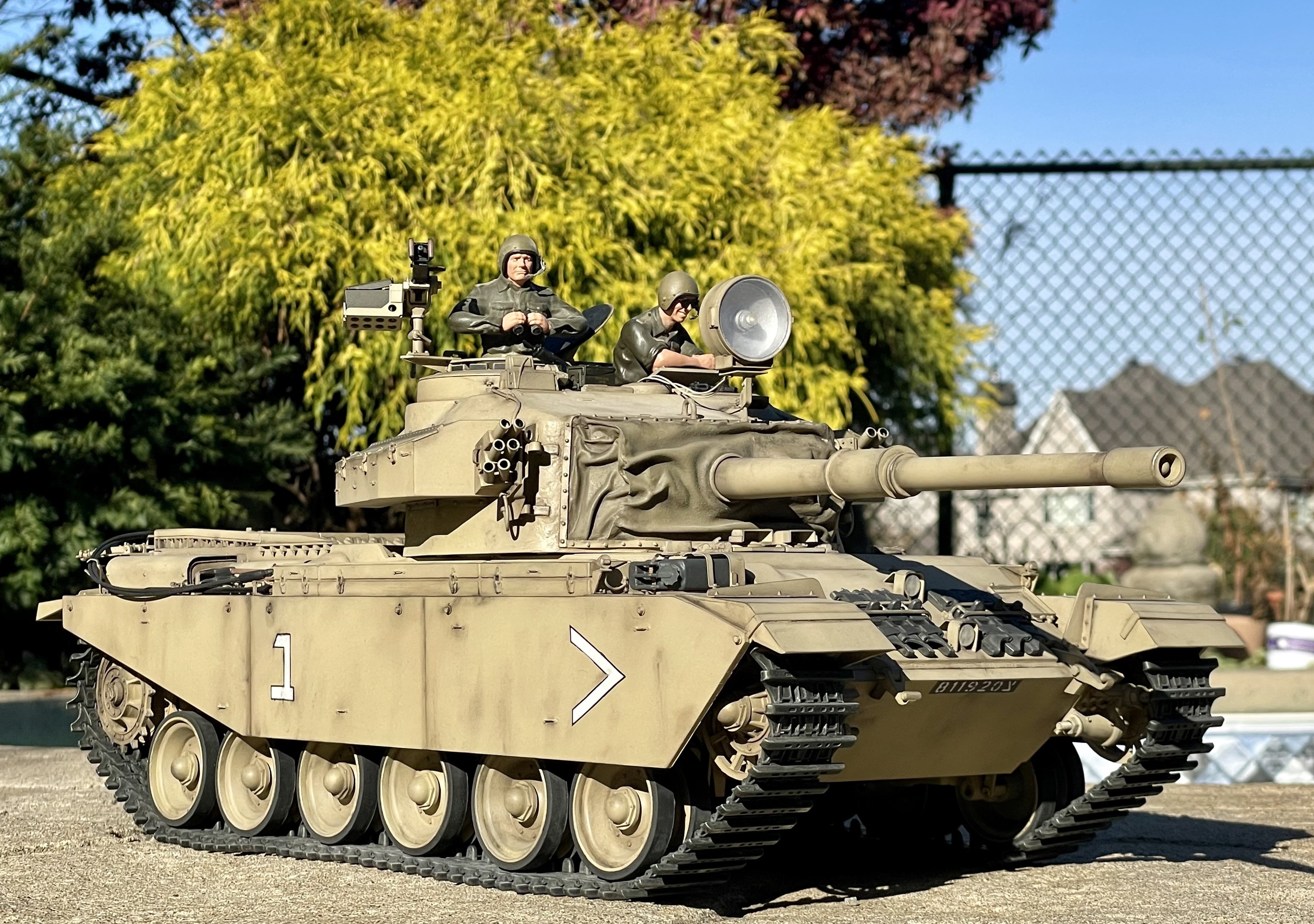

Next step is to install the electronics. I will likely provide a video of the tank in action.
Regards, Louis

I scanned 1/35 AFV-Club Sho't Kal decals, expanded to 1/16 and printed on white decal sheet. I takes a few trial and error phases to master the process but it provides good results.

Thank you, doing the research and interpreting old pictures was pleasant.

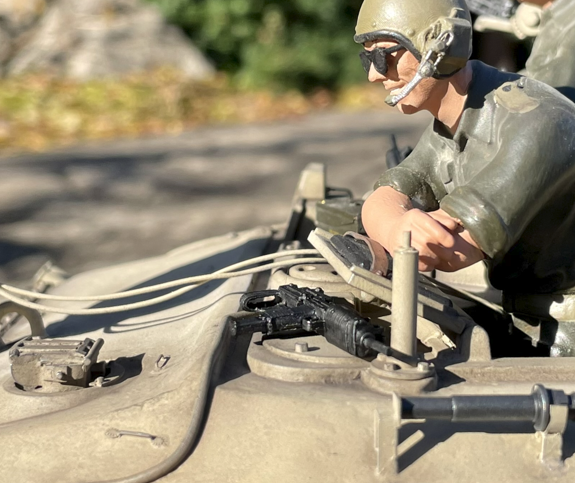

On the video, i removed the figures because they are extremely fragile, especially the helmet microphones and i did not want to take any chance of breaking them.
However, for static display, i gave the figures an UZI to deposit close by. The Sho't Meteor did not have a stand for the UZI of both sides like the Sho't Kal.
