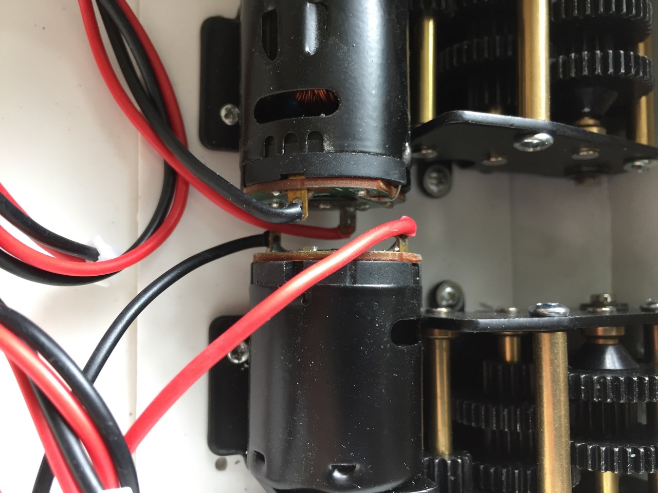

Here's a pic of the final motor positions. When you buy these nicely made Premium Taigen motors/gearboxes, the +ive and -ive terminals of the respective motors are adjacent to one another and- depending on the width of the model, can end up perilously close together. As I wrote earlier, there are screw holes at right angles to the default position here, and I moved one of the motors to that position. The layout is now much safer, as you can see.
Click to ENLARGE these images.
			-  Revised motor orientation-Comet gearboxes
Note too, that 3mm thick the base plate supplied with kit has predrilled holes for Heng Long StuG 111/Pz IV style motors. Here, it's necessary drill some new ones.

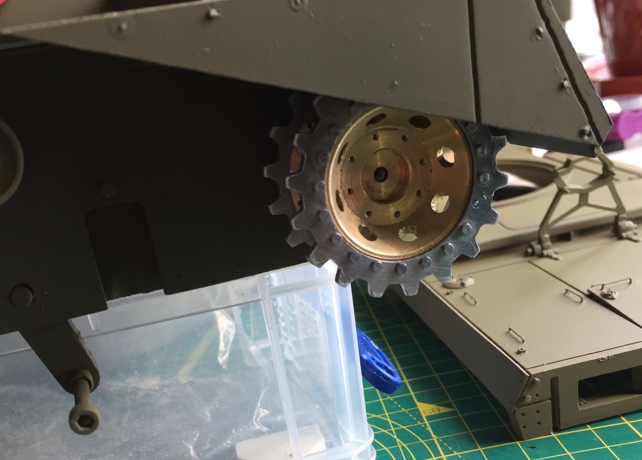

Now it's time for the sprockets. I sanded the burrs off them first of all, as the metal edges could possibly damage plastic, and even metal, tracks. Bedding the tracks in will be easier as a result.
			-  Comet sprockets
Note that these sprockets don't have a flat edge on the inside to correspond with the flats machines  on the output shafts. As with flatted sprockets, though, grub screws secure the sprocket to the shaft, and there's also a drilling in the centre to allow socket head screws to pass through into ends of the output shafts.
