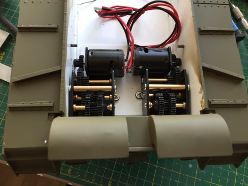

I've just installed the motors, for example, but forgot from the previous (and related) Cromwell build, that it's not possible to fit the sprockets when the motors are screwed into position. :/ Bummer. They'll have to come oot again.
Comet gearboxes
Comet gearboxes
These are the Taigen Premium type for the Jagdpanzer etc. Luckily, these are also a good fit for the Comet interior. The Heng Long units I tried wouldn't fit at all, and not even the most experienced contortionist would have levered them in there. That's part of the lesson-learning here: if you don't know what works (from guidance), you have to really on trial and error. The trick is not to make expensive errors.
That all said, because of the proximity of the electrical terminals on the motors (separated by only a couple of mms), I unscrewed the right-hand motor, and repositioned it at right angles to its original position. Luckily, there's more than one set of fixing positions on the casings of these gearboxes. :thumbup:

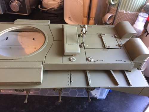

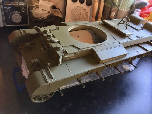

Comet upper hull and lower hull details

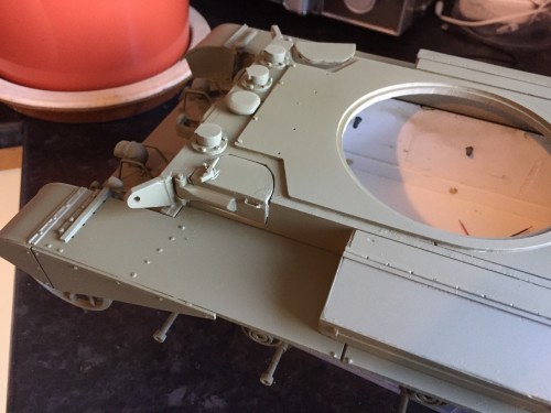

Comet rear hull details

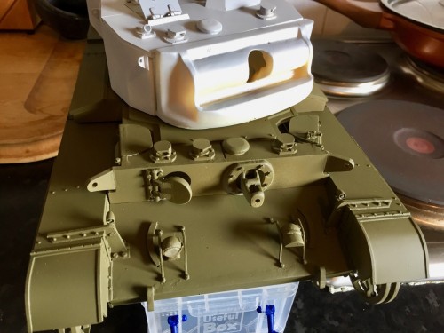

Comet front details- upper hull
A coat of Humbrol SCC155 Olive Drab (Matt) serves to highlight the Features. After trying the MIG Olive Drab with my airbrush, and not getting the mix right, it was a relief to use the Humbrol rattle cans. They work as smoothly as the Tamiya ones, and represent better value for money. It's just such a pity that nobody has put British Olive Drab in a rattle can. :|

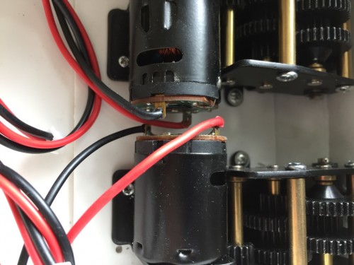

Here's a pic of the final motor positions. When you buy these nicely made Premium Taigen motors/gearboxes, the +ive and -ive terminals of the respective motors are adjacent to one another and- depending on the width of the model, can end up perilously close together. As I wrote earlier, there are screw holes at right angles to the default position here, and I moved one of the motors to that position. The layout is now much safer, as you can see.
Click to ENLARGE these images.
Revised motor orientation-Comet gearboxes
Note too, that 3mm thick the base plate supplied with kit has predrilled holes for Heng Long StuG 111/Pz IV style motors. Here, it's necessary drill some new ones.

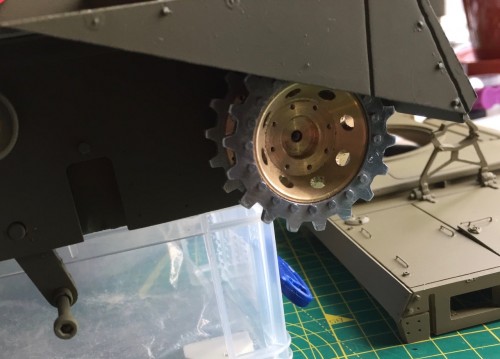

Now it's time for the sprockets. I sanded the burrs off them first of all, as the metal edges could possibly damage plastic, and even metal, tracks. Bedding the tracks in will be easier as a result.
Comet sprockets
Comet sprockets
Note that these sprockets don't have a flat edge on the inside to correspond with the flats machines on the output shafts. As with flatted sprockets, though, grub screws secure the sprocket to the shaft, and there's also a drilling in the centre to allow socket head screws to pass through into ends of the output shafts.

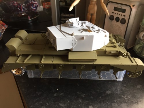

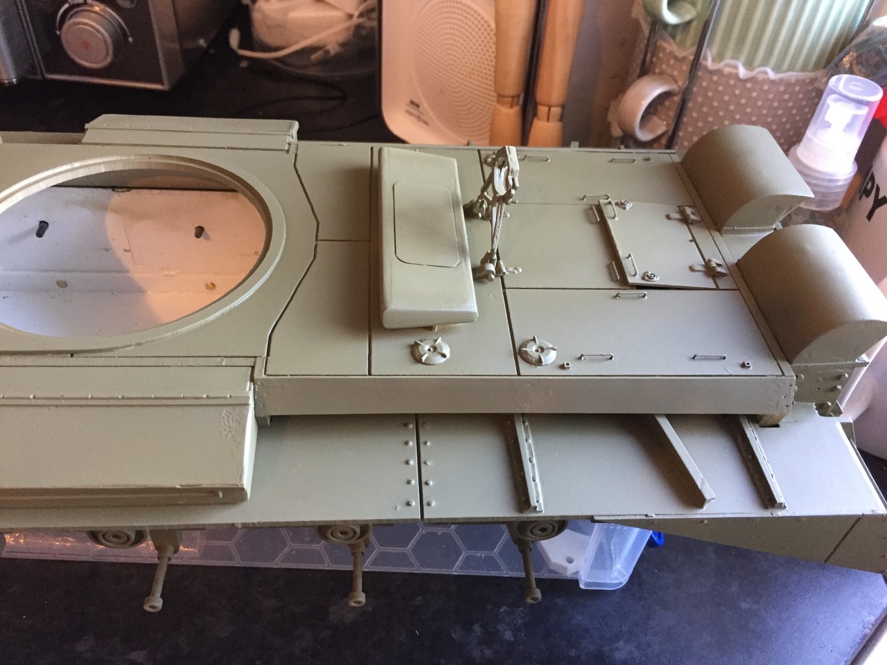

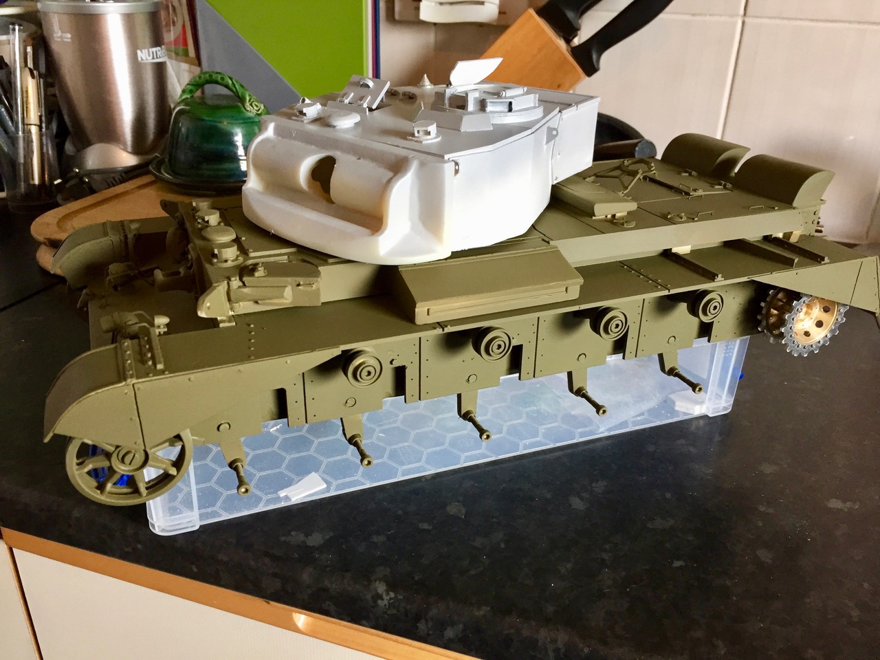

Just a few progress pics, to demonstate how much of the cosmetic work is complete. Fitting the wheels and aligning the rolling gear comes next. That can be a bit of a headache. Then I'll test the tracks in situ by putting 5Vdc though the motors to make sure both sides run unhindered. Doing that with an expensive MFU controller in place could, if the movement's too stiff, blow the unit. (Or a fuse, if it has one) :problem:
Comet progress-pic A
Comet progress-pic B
Comet progress-pic C
Comet progress-Pic D
When all the painting (and moderate weathering) is complete, I'll add some transparent glass-lookalike segments to the periscopes, to simulate the prisms in them. It would be pointless at this stage, as making them off would be a pain. :think: :D
