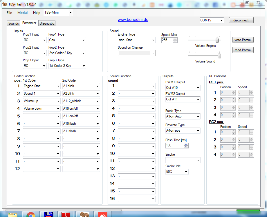

After a lot of tweaking and some more reading in this thread I´ve managed to start the flasher and board. After a first parameter read it seems to have something preloaded:
Now time to discover all this little thing is capable to do.
Thanks again
