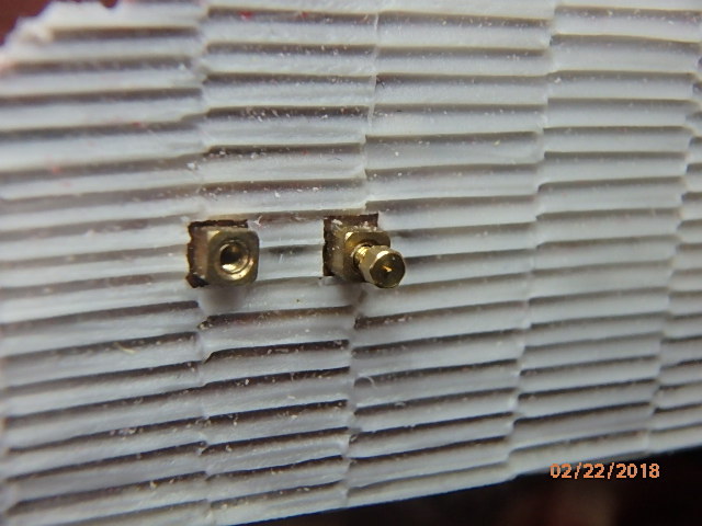

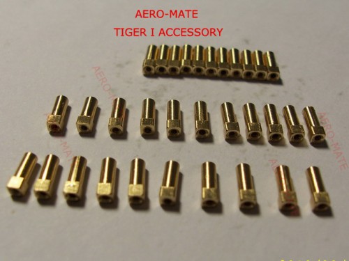

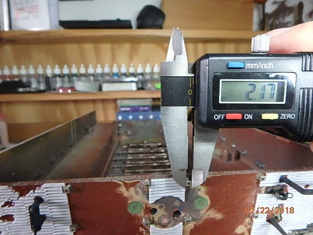

Soeren wrote:Dear Mr. Burger Patrol, ist the size of the blocks for the fenders similar to those for the exhaust covers?
Hey Soeren,

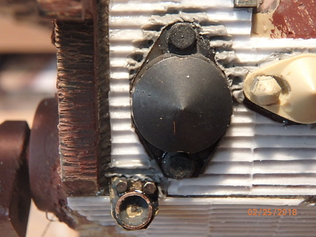

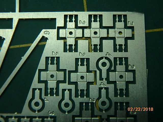

I'm not 100% sure on the real Tiger tank, although from photos they look very close in size. As far as the kits for the RC T1, these are from two separate kits. The Rear blocks are from Aber photo etch and needed to be bent into shape.
Photo Etch blocks before bending
Photo Etch block after bending for rear exhaust

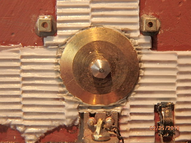

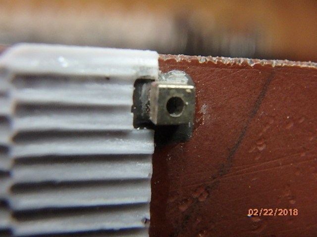

The side blocks are solid turn brass from Areo-mate, that actually take a miniature bolt to hold side mud guards on.
Aero-Mate solid brass mounting blocks
Mud Gaurd blocks.jpg (38.86 KiB) Viewed 3736 times
Aero-Mate mounting blocks with mini threaded bolt
I measured them both and they are very close in size.
Rear Exhaust shield PE blocks were 2.1mm
Hope this helps :thumbup:
Rear Exhaust PE Blocks 2.1mm
Aero-Mate solid brass side blocks were also 2.1mm
Aero-Mate solid brass side blocks were 2.1mm

:thumbup: Thank you very much. :)
That is what I was looking for. I have these aeromate pieces and thought I could use them for the exhaust covers as well to make em a little more detailed. As I didn't plan to buy the Aber set and maybe leave one off, as I like the look of the armored exhaust pod covers to, that would otherwise be completely hidden.

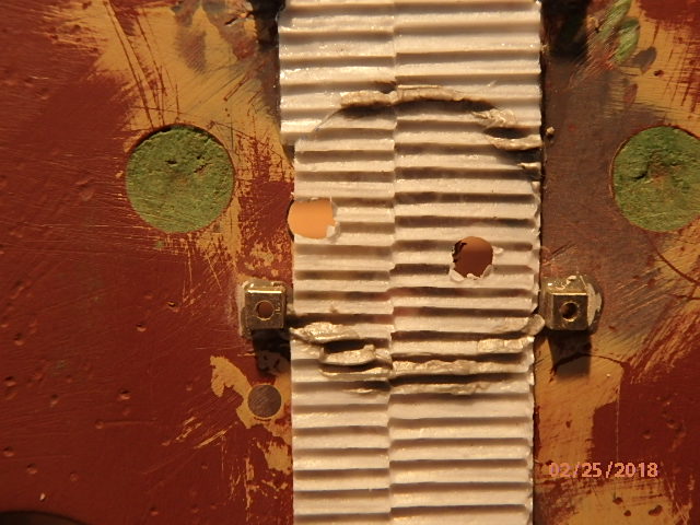

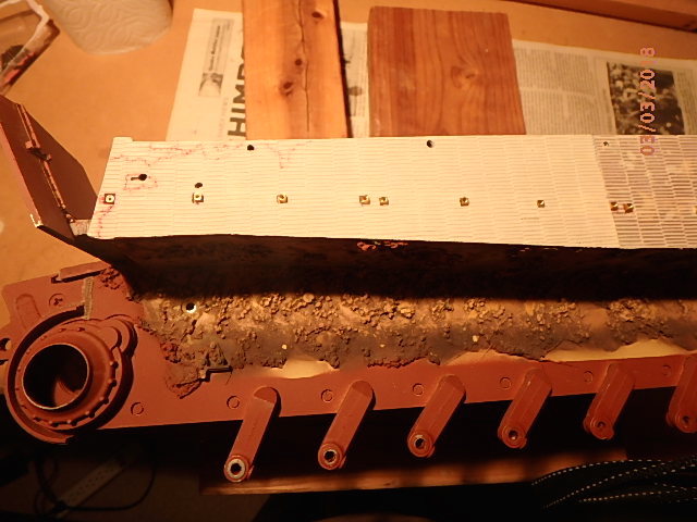

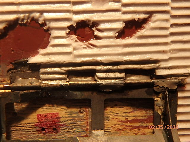

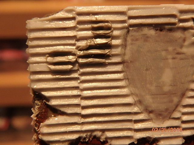

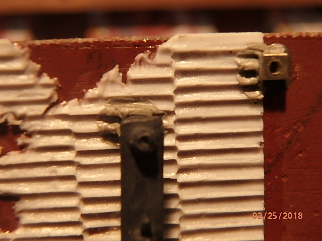

My plan was to finish up lower hull Zimmerit this week, and work on a little mechanical by installing the power plant, but I ran into an issue with the power plant install. For some reason the transmission and motors would not fit correctly. So I have to figure out what the issue is, but in the mean time I did some more detailing.

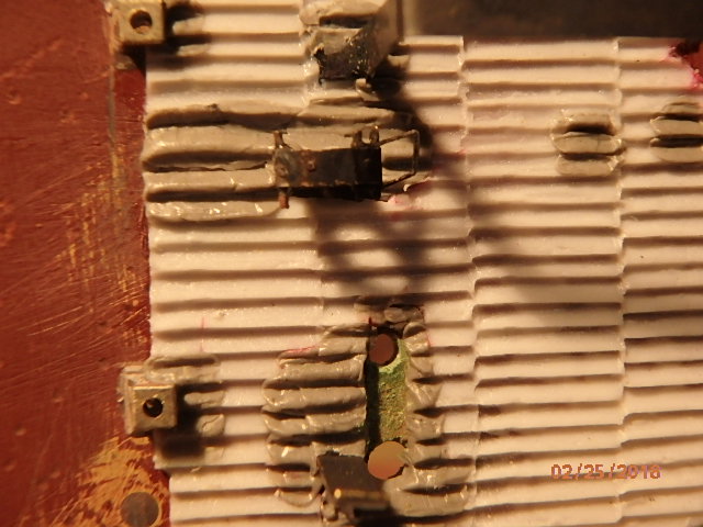

FILLING IN BARE SPOTS IN ZIMMERIT WITH PUTTY AND SHAPED.
FILLED IN AREAS AROUND MUDGUARDS
FILLED IN AROUND SOME OF THE MOUNTING BLOCKS
MADE ZIMMERIT CONNECT BEHIND WHERE STARTER ADAPTER WILL BE MOUNTED

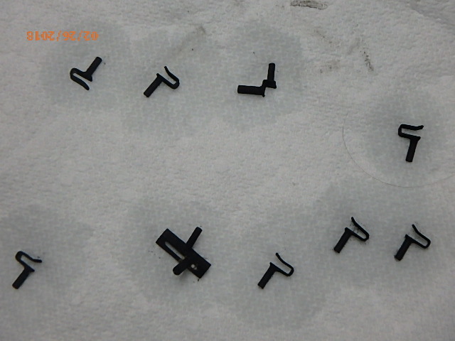

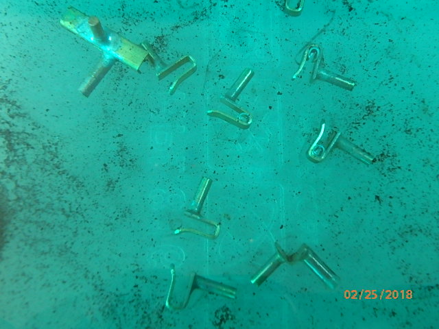

PUT MY TRACK RECOVERY CABLE MOUNTS IN THE BURNISHING FLUID

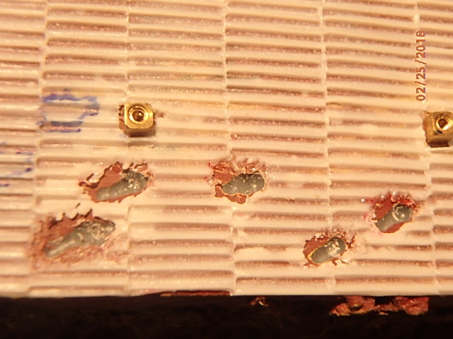

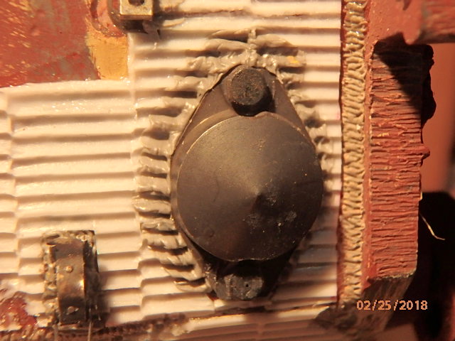

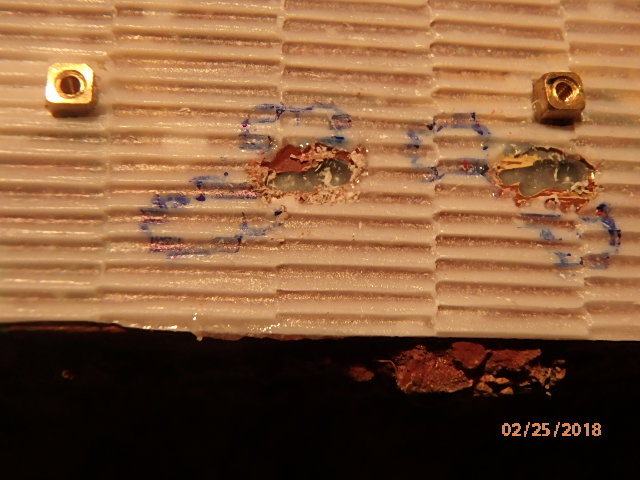

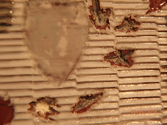

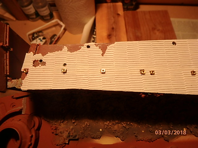

DREMEL TOOLED OUT SOME EMEMY FIRE DAMAGE
MORE ENEMY FIRE DAMAGE ON REAR PLATE
TRACK RECOVERY MOUNTS HAD OVER NIGHT SOAK IN BURNISHING FLUID

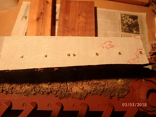

FITTING AND MARKING DAMGE ON STARBOARD SIDE ZIMMERIT
SAME THING ON PORT SIDE
DAMAGE APPLIED TO PORT SIDE ZIMMERIT
SAME ON STARBOARD SIDE

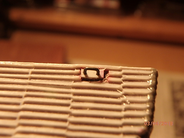

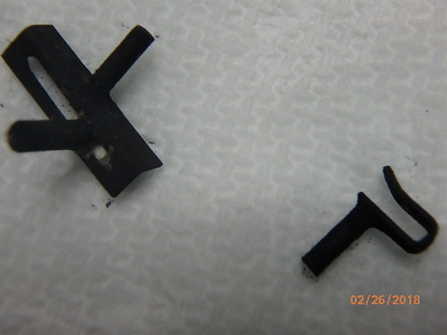

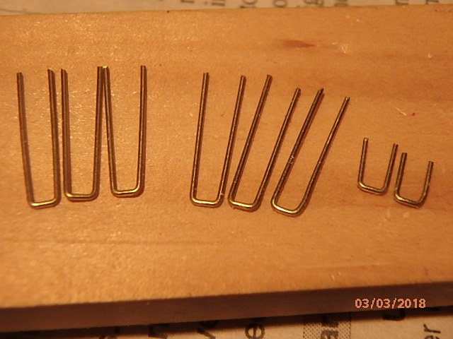

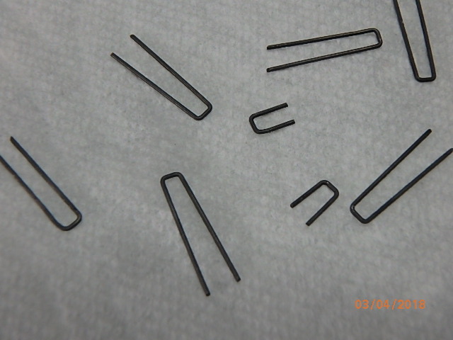

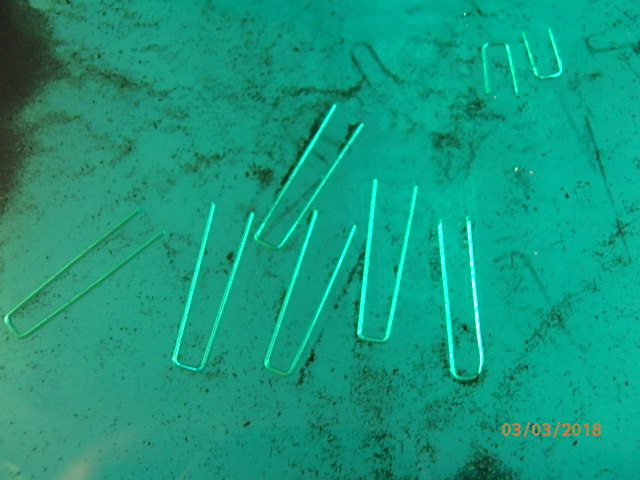

BENDING FIRST WIRE FOR REAR AND SIDE LASHING TIE DOWN POINTS
ALL LASHING TIE DOWNS FABBED AND READY FOR A DIP
AFTER BURNISHING
AFTER BURNISHING

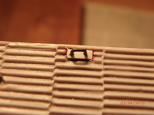

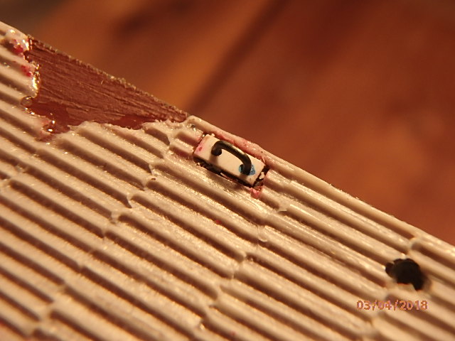

POPPING HOLES IN MOUNTING PLATES FOR WIRE LASHINGS TIE DOWN POINTS
FIRST ONE INSTALLED
FIRST ONE INSTALLED
EXCESS WIRE ON INTERIOR HULL WILL BE BENT DOWN LATER AFTER CA GLUE SETS UP GOOD

Great update :). What did you use for the Zim repair? And what wire size is it for the tie down loops?
