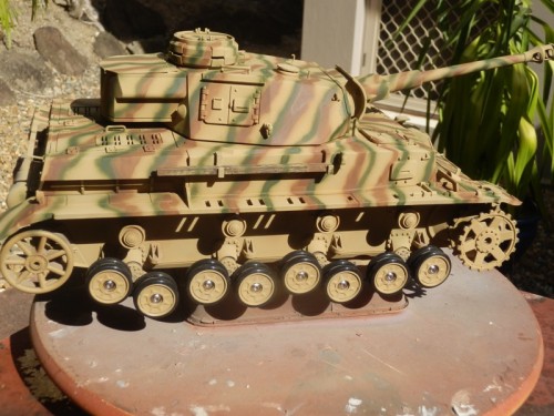

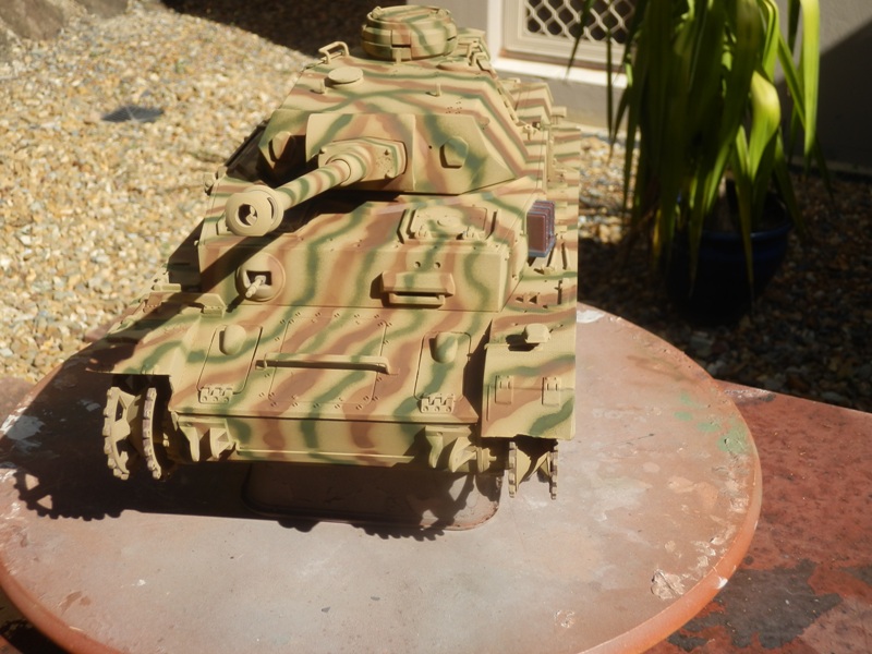

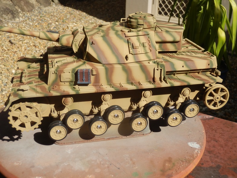

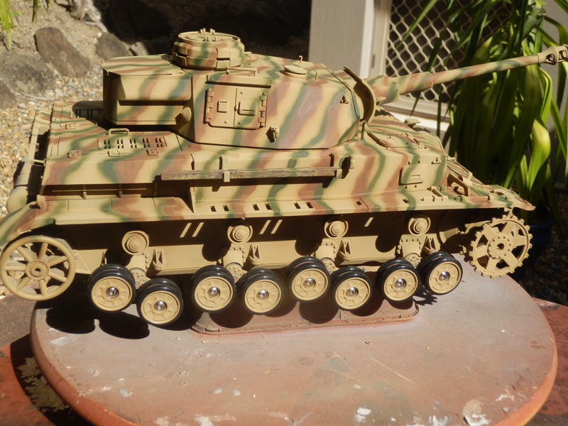

Found some pictures in the camera that I couldnt use without a modem.
A bit out of context now, but might be of use to folks so I will put them in.
