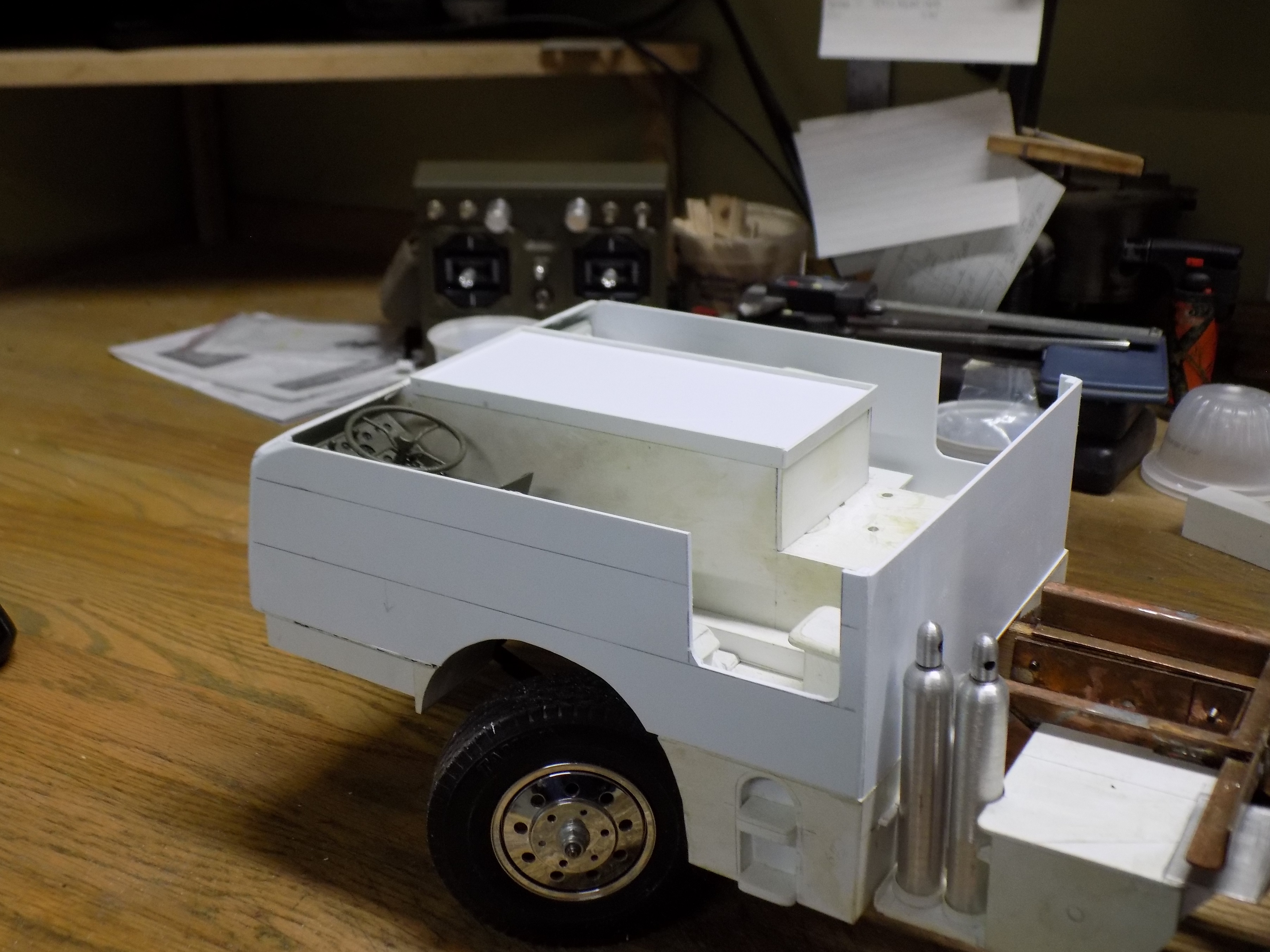

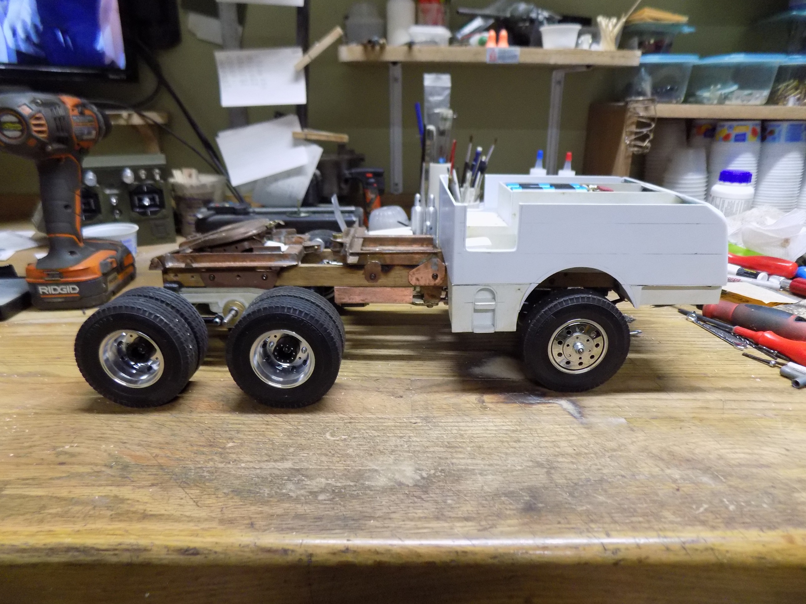

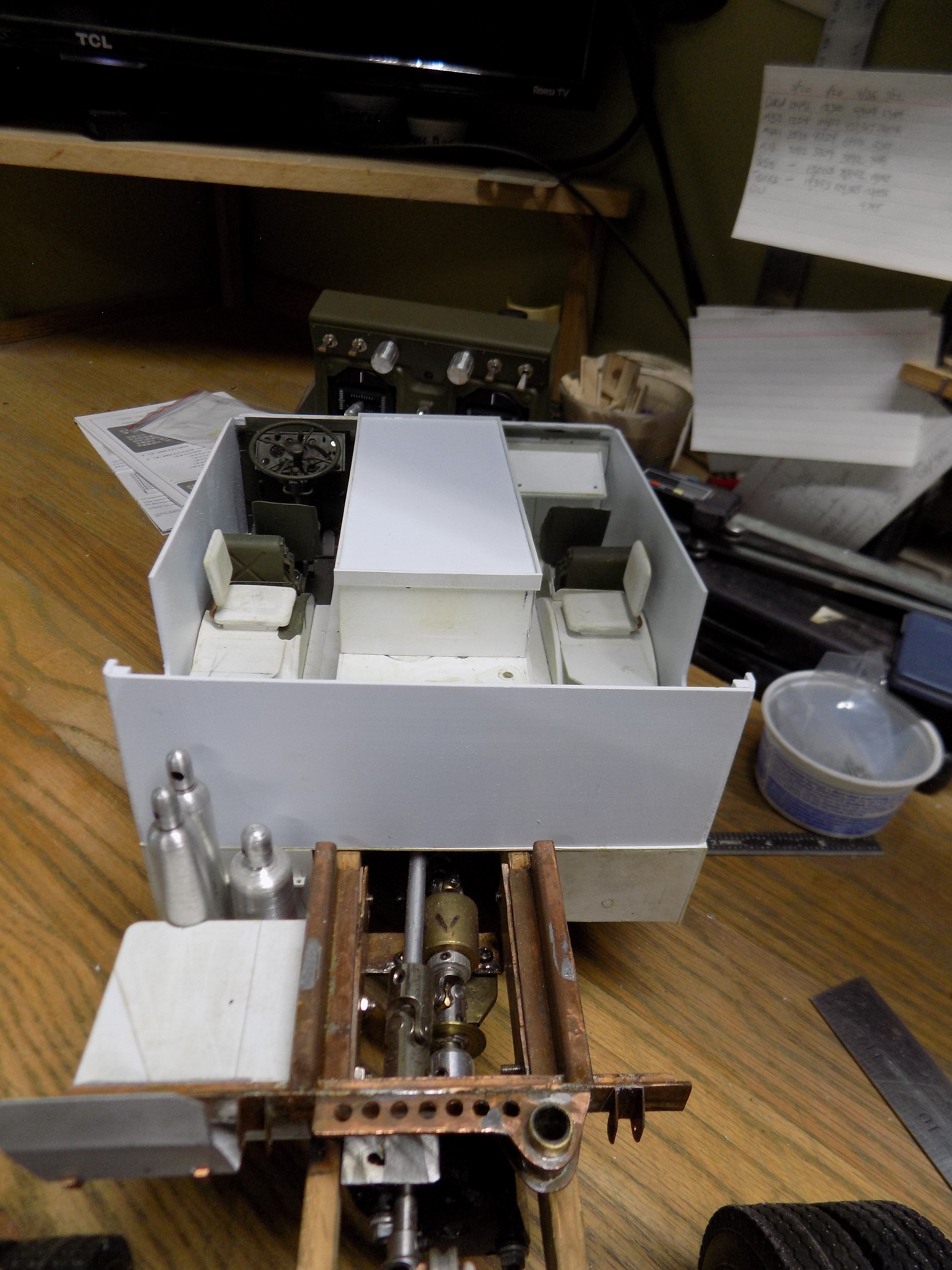

I know I said I was going to do some shaping yesterday, but when I pulled the upper cab off I found lots of voids that needed to be addressed before a trip to the belt sander. Still sneaking up on how many "curves" it needs...
101 rs.jpg (1.88 MiB) Viewed 798 times
102 rs.jpg (1.83 MiB) Viewed 798 times
103 rs.jpg (1.17 MiB) Viewed 798 times
Working without plans is trickier at times. Using a micrometer (or Vernier caliper) on pictures in a book or on a computer screen is a bit strange.

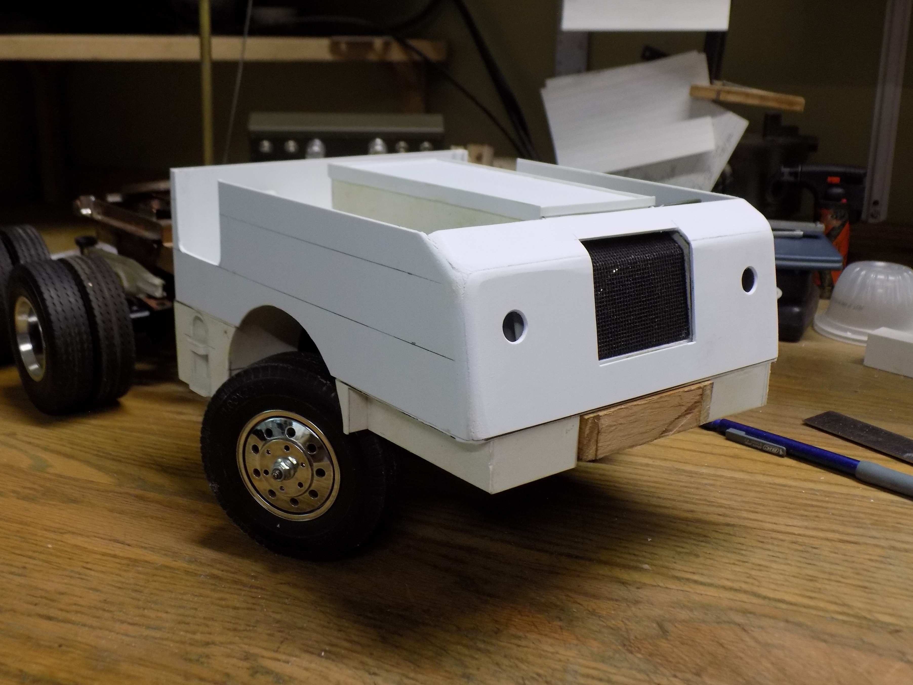

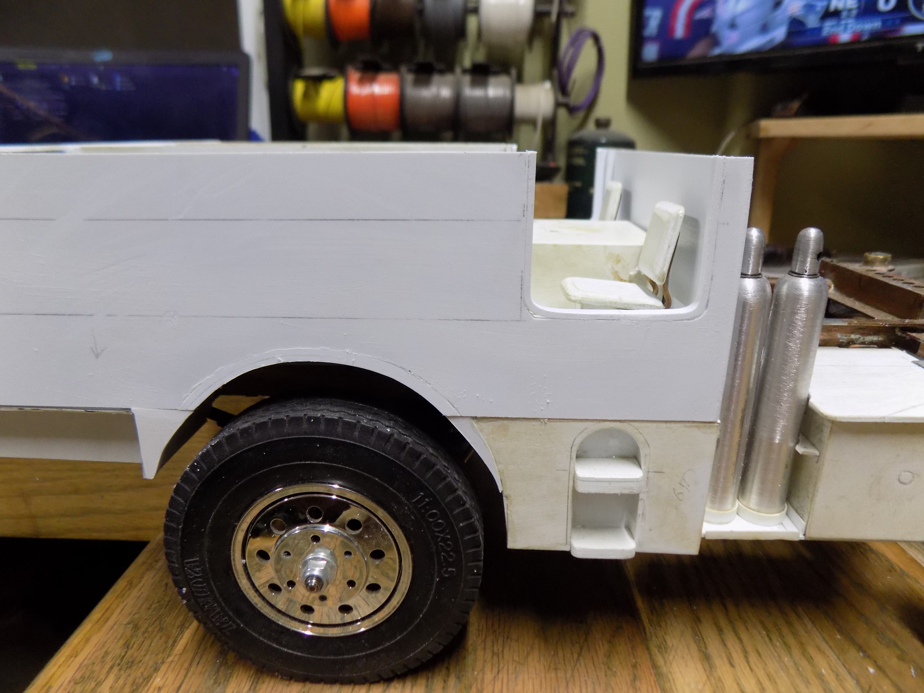

I started with the interior and inner fenders, so when building the outer skin the wheel arches started to bug me. Still have some manipulating to do and have to raise the front end a bit. Every picture has the front end a bit higher than this one even without a trailer. Then the fender to tire/tyre distance will be better again.
104 rs.jpg (1.44 MiB) Viewed 797 times

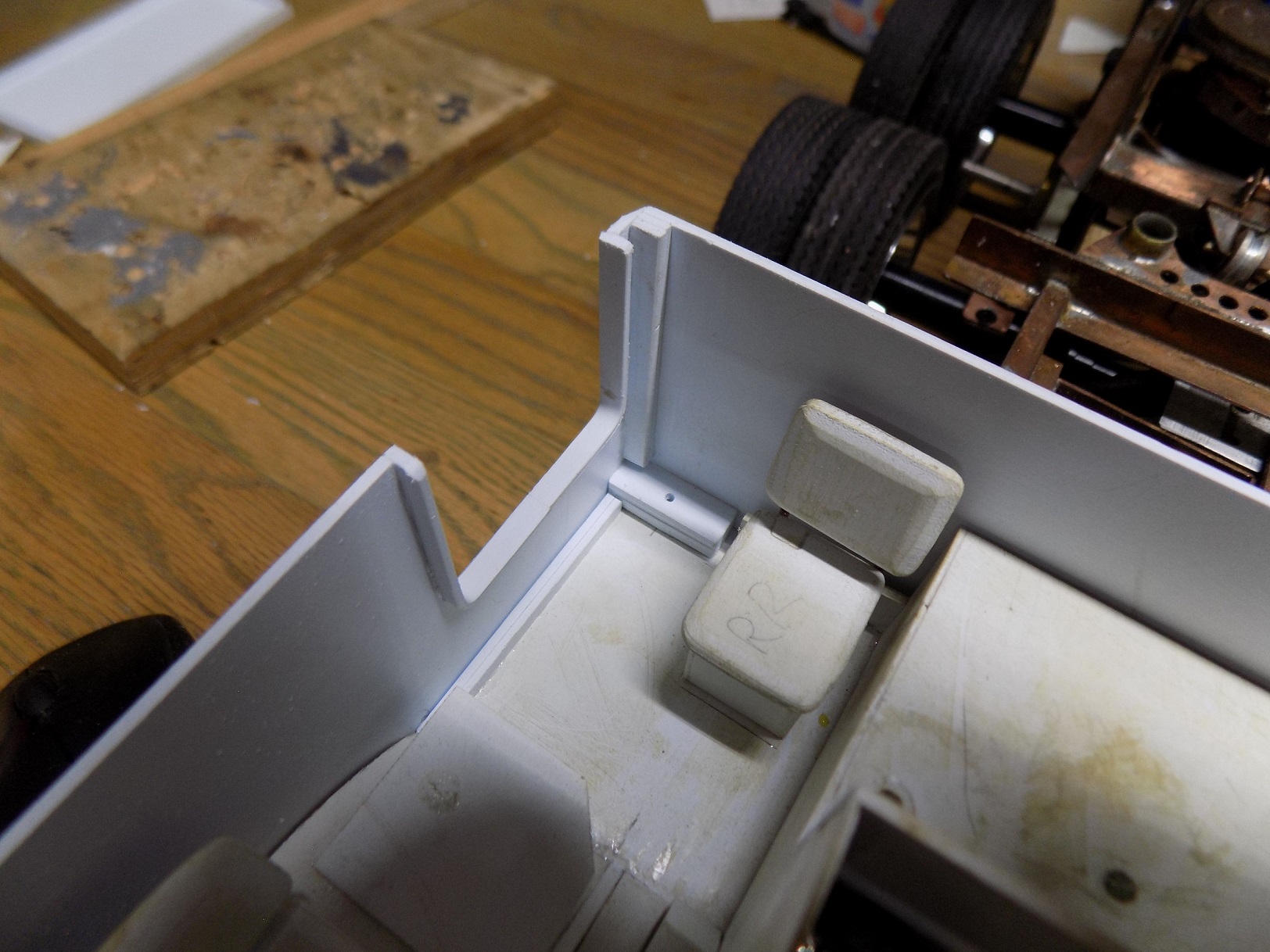

Also trimmed the door openings. In each corner is a box that accepts a screw from below.

Dropped the Tamiya semi spring hangers and shackle mounts to the bottom of the frame (about 6 mm). The unintended advantage is the motor mount shares the front spring mounting hardware lowering the motor/trans by the same amount, offering a little extra space. If more lift is needed some blocks/spacers may be added between spring and axle (not DOT approved).

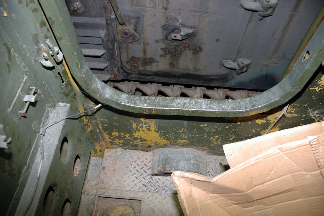

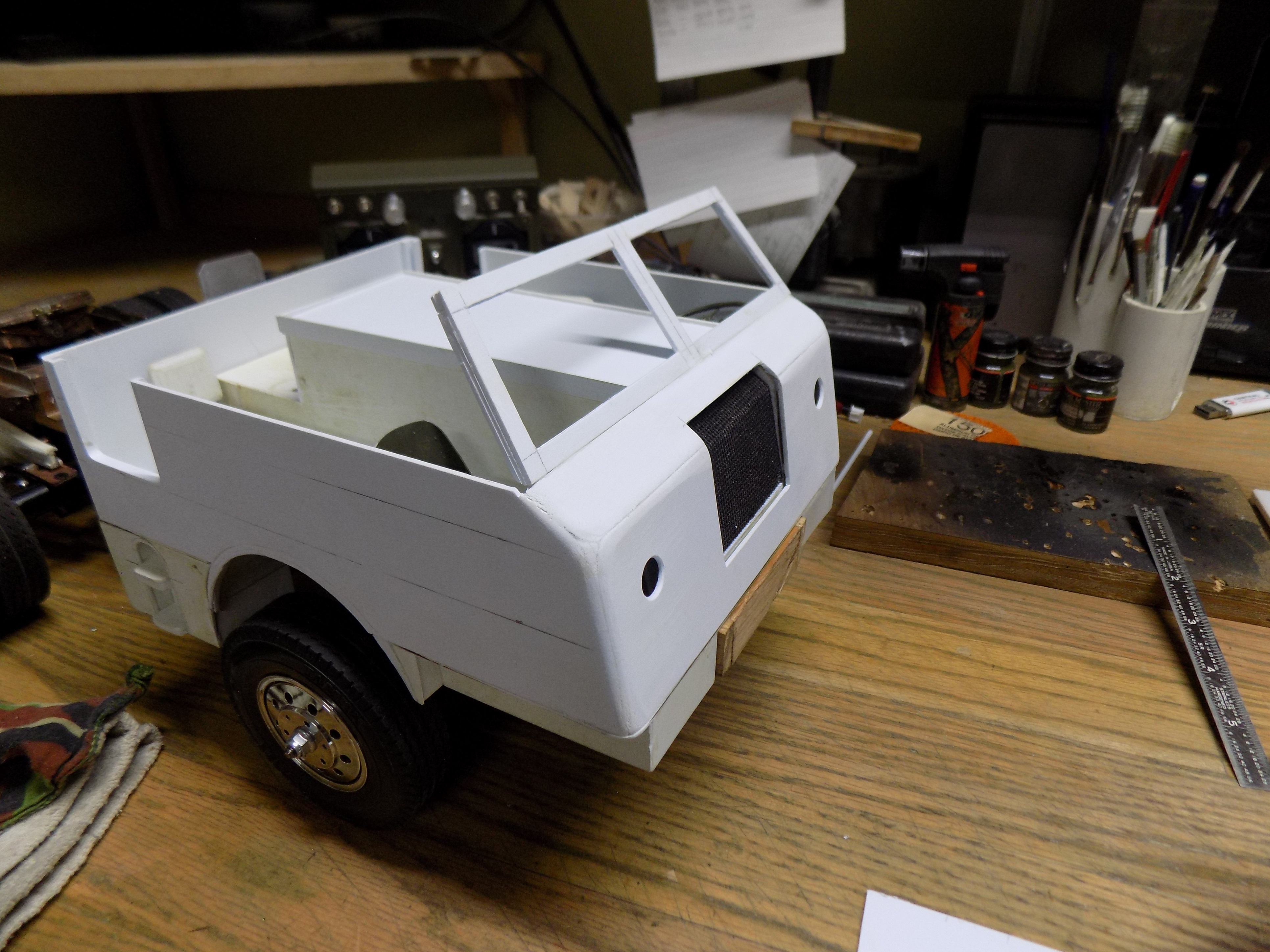

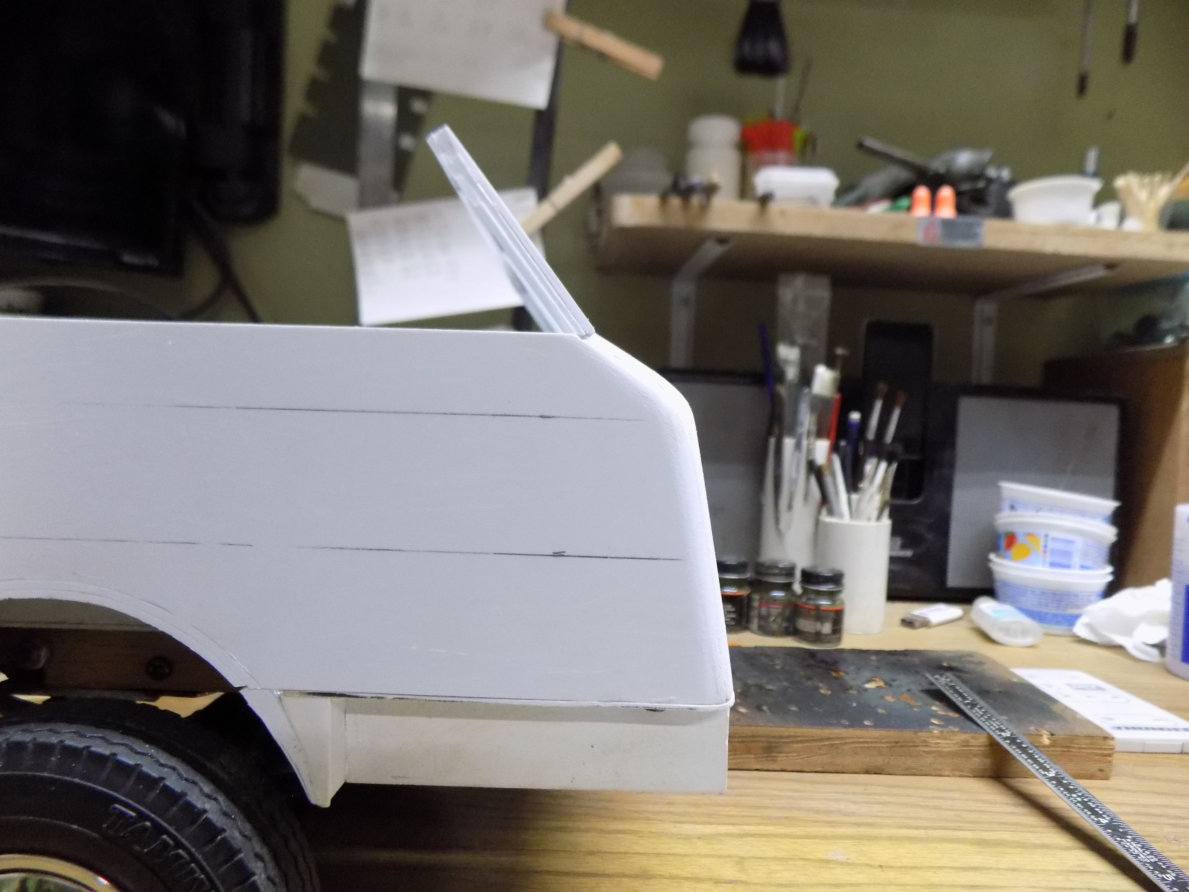

Need some honest input (that means Meter Rat and SoaG are out :D ). Yesterday I felt the slope in front of the windshield is off (too steep or too short). This morning looking through all the pictures I have I feel better about it. The third picture is the closest to a "profile" shot I have.

I think it looks pretty close to the slant on the real 1 mate and its coming on well :thumbup:

I'm looking at the angle the windshield runs coming off the front fender edge below it and it looks pretty close-ish...and by "ish" I mean +/- 1° !
You're a styrene sheet magician!
