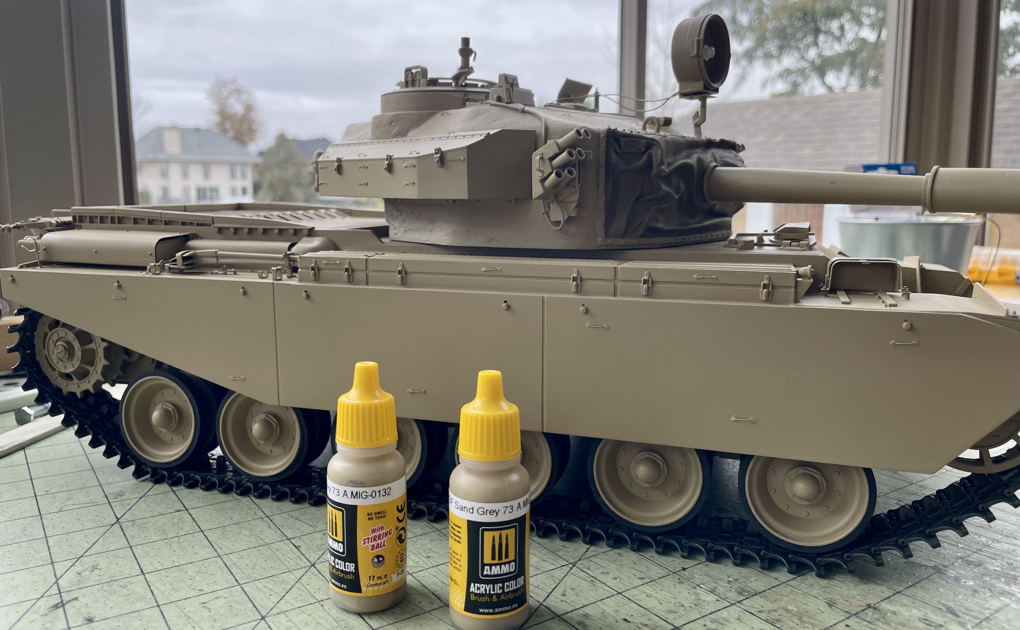

After the enamel primer coat, the model was given a coat of Mig Ammo "MIG-0132 Real IDF Sand Grey 73". This was a no brainer for me. My late sho't Meteor would have been used in the Yom Kippour war in 1973 alongside converted Sho't Kals. The conversion was a long process. I think the color is pretty good.
Modellers of IDF tanks have to be really careful because IDF Centurion tanks changed color many times between 1967, 1973 and the 80s. Its not because a bottle says IDF on it that it can be used on any tanks. I think the various "IDF Grey" are the worst color for paint makers. Their offerings are not all good. Careful if you do not want your model to end up in some kind of pink or purple sand brown.
The model after painting but before weathering.

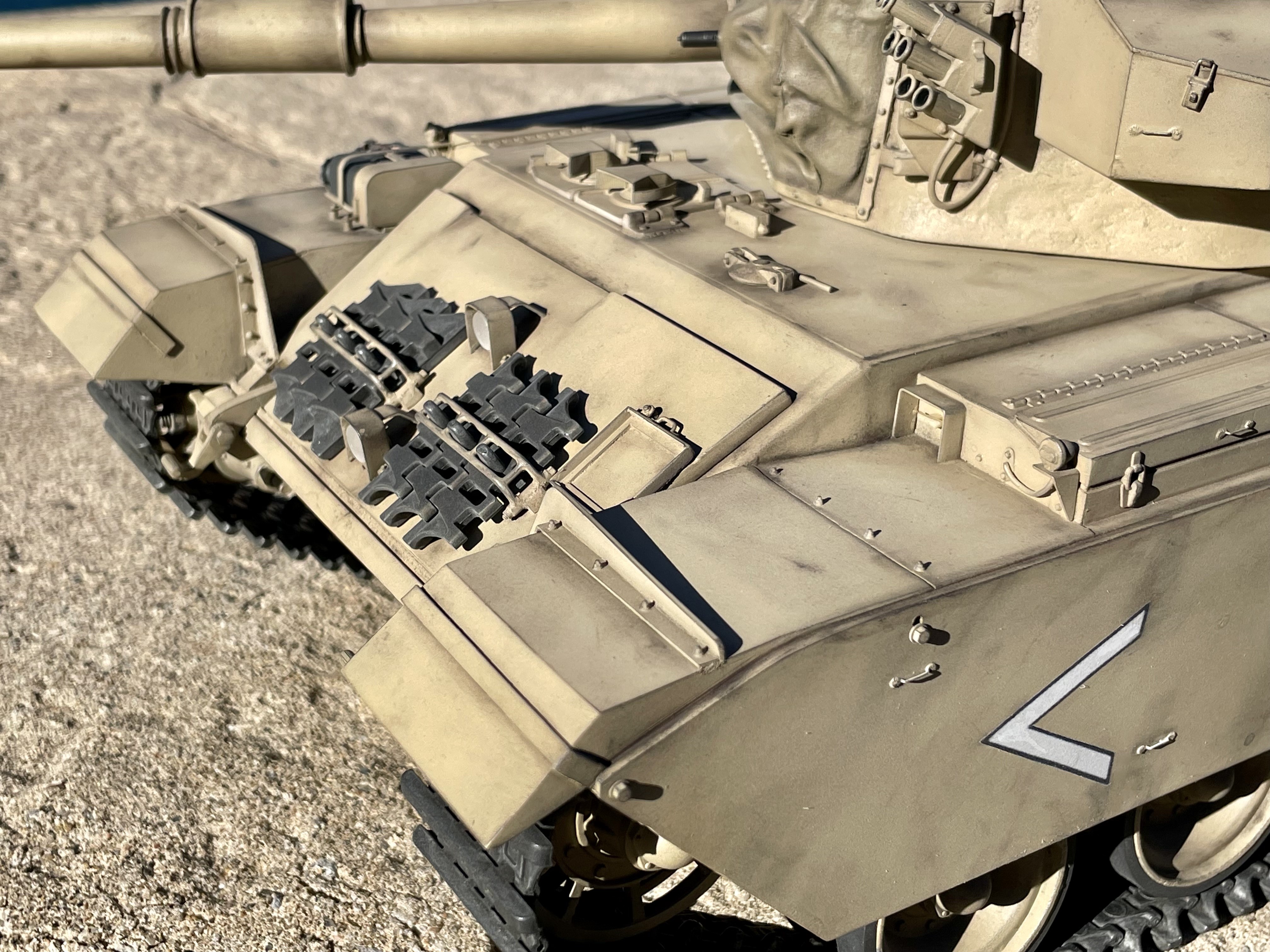

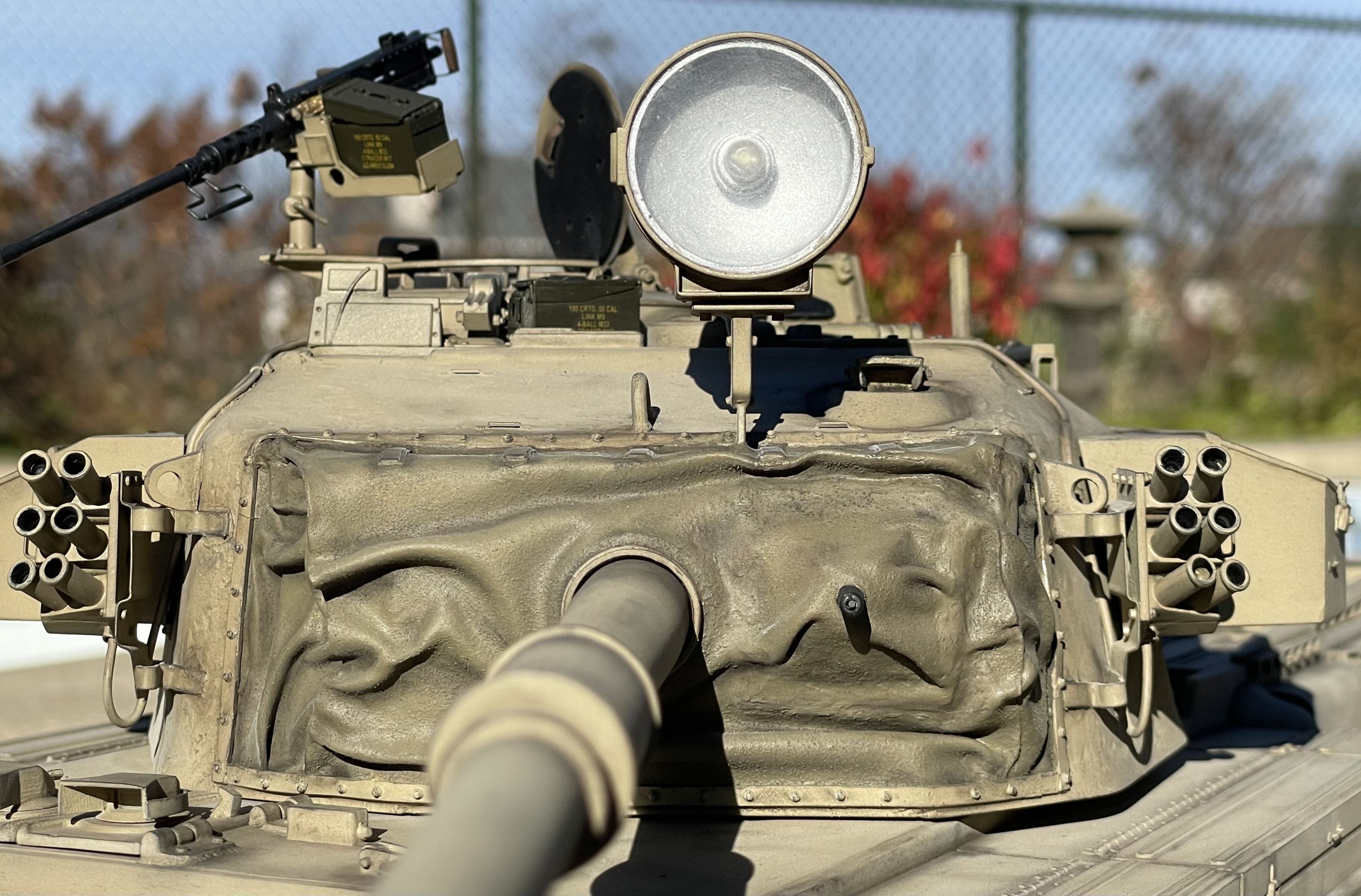

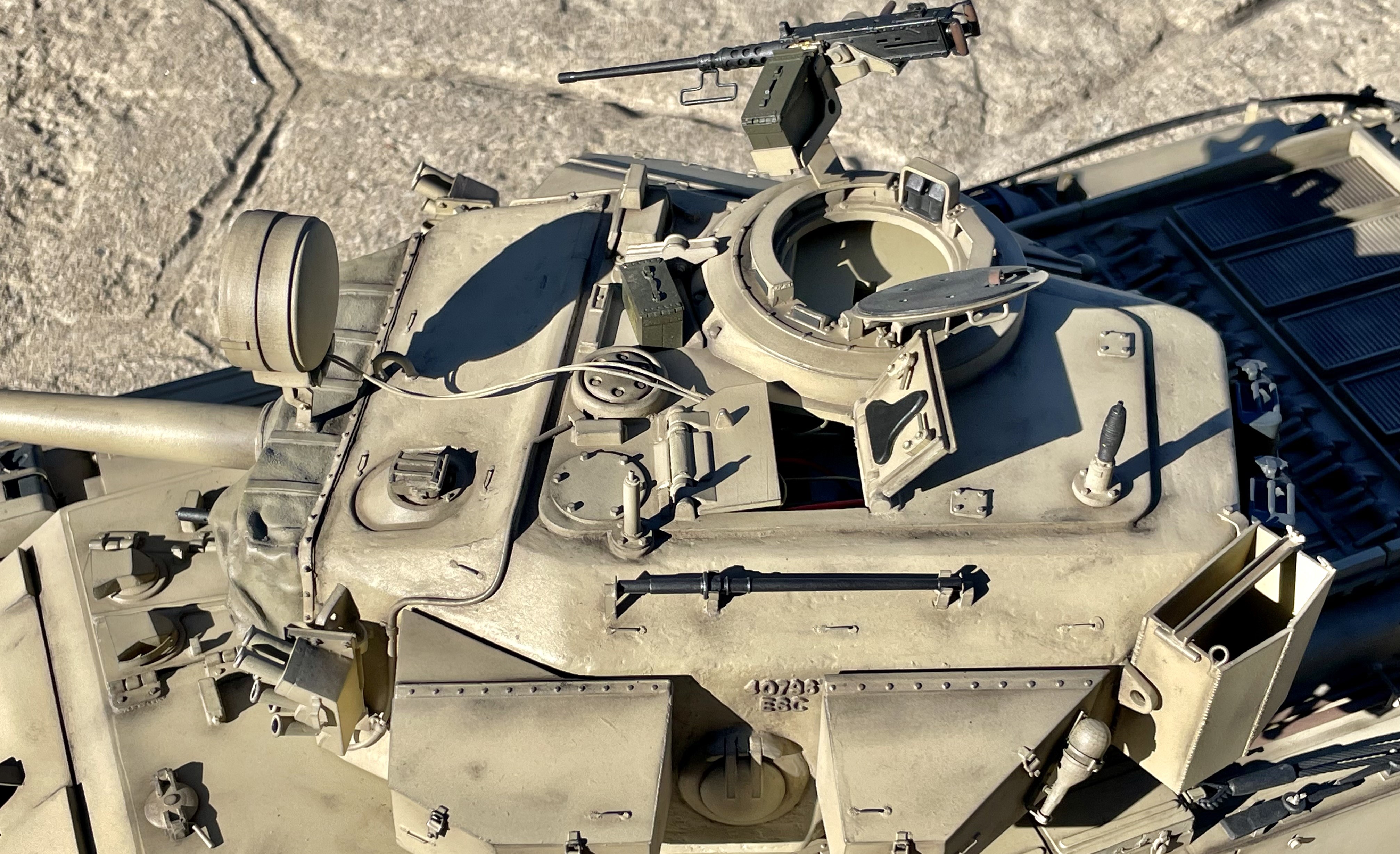

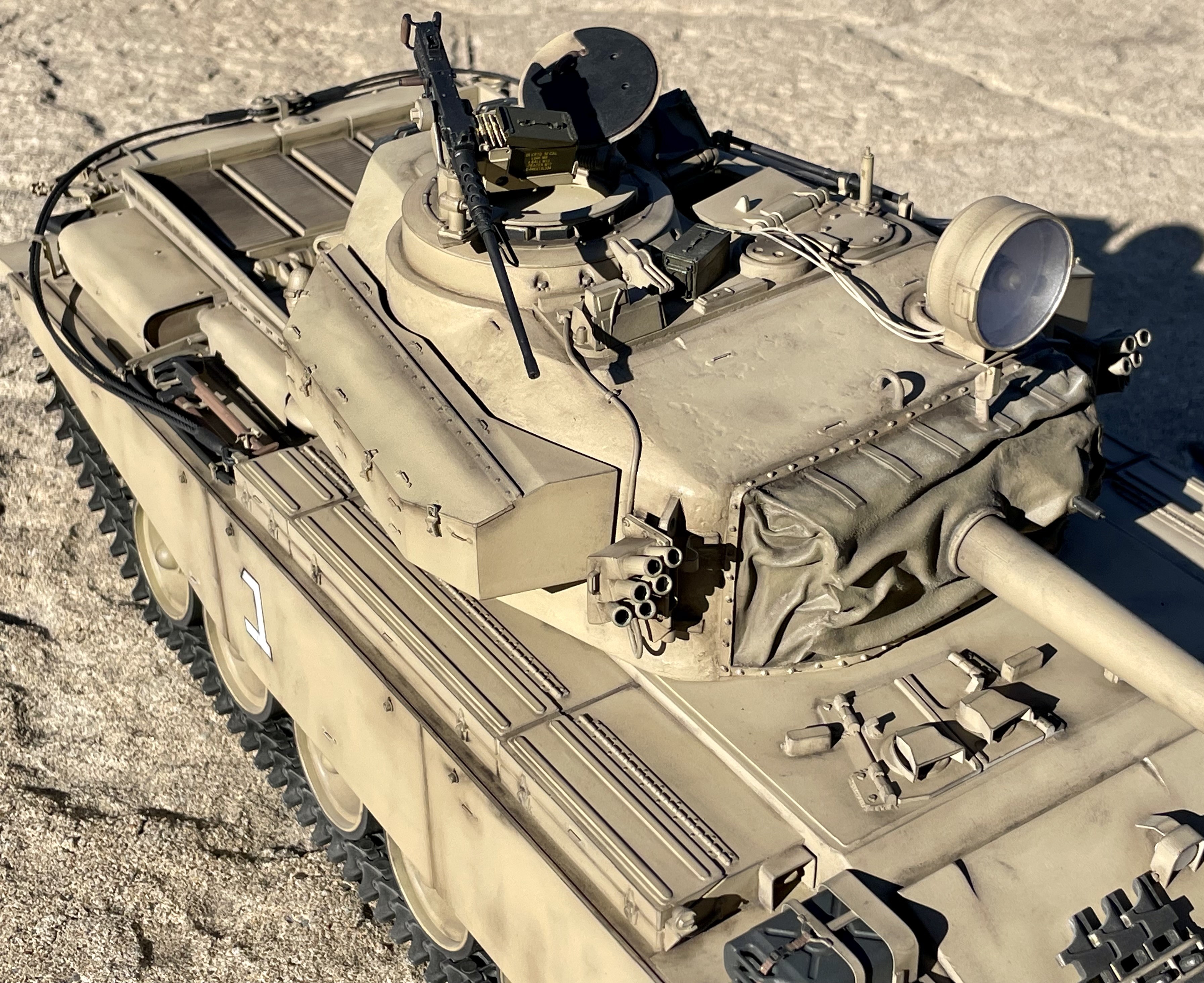

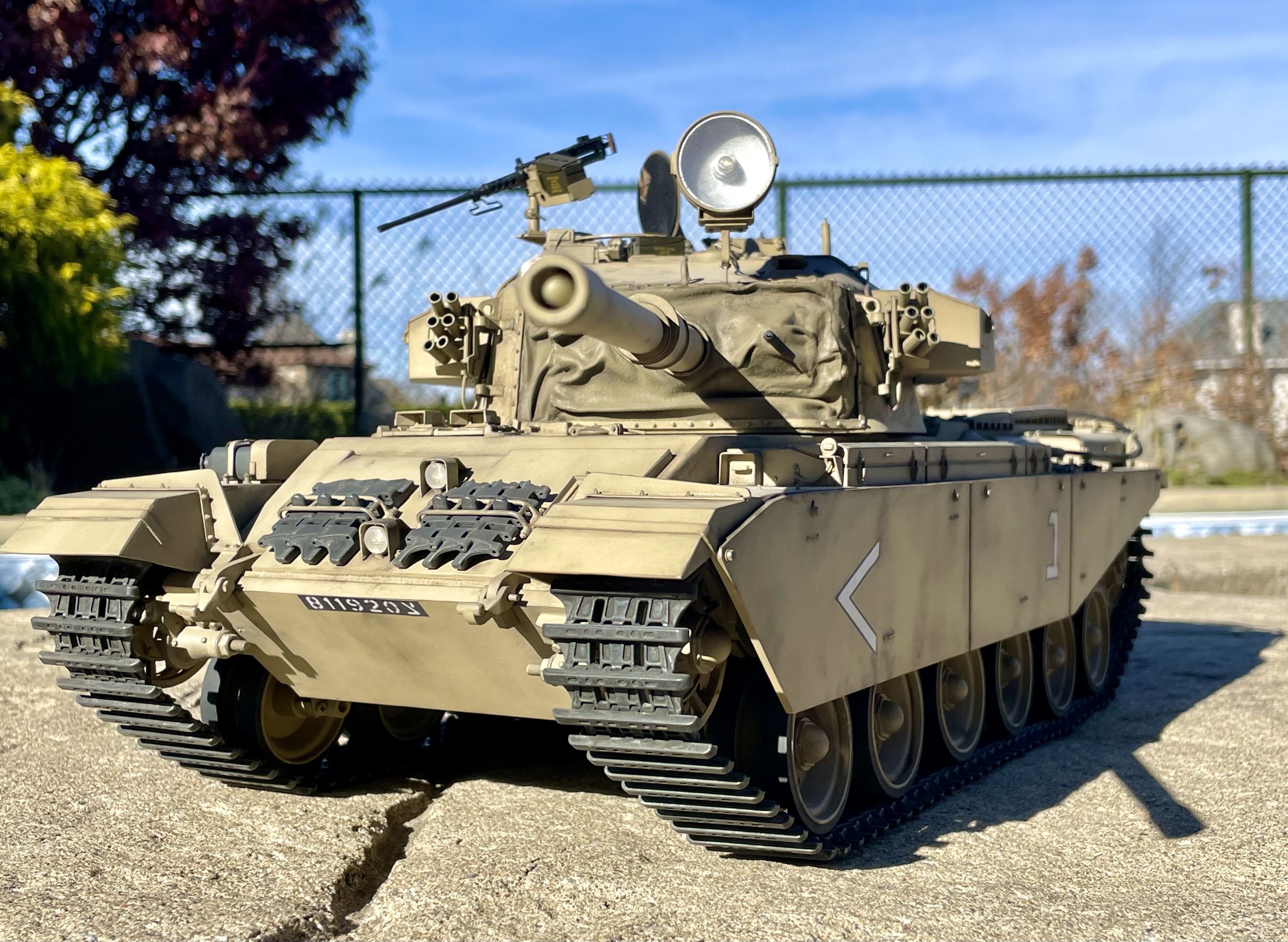

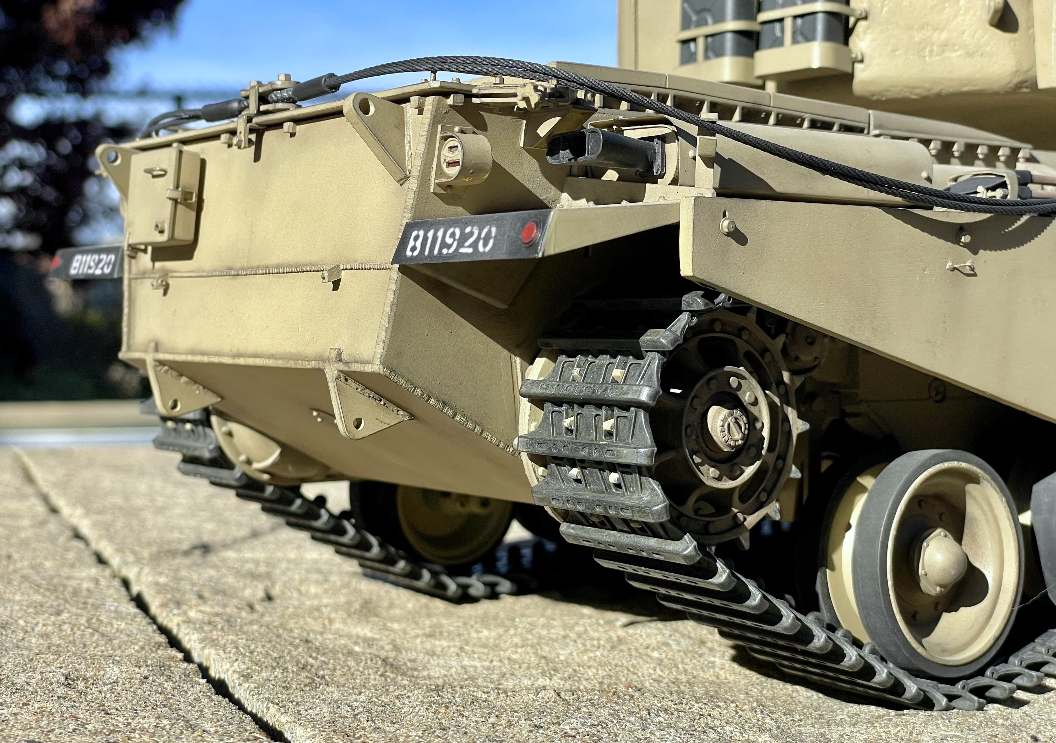

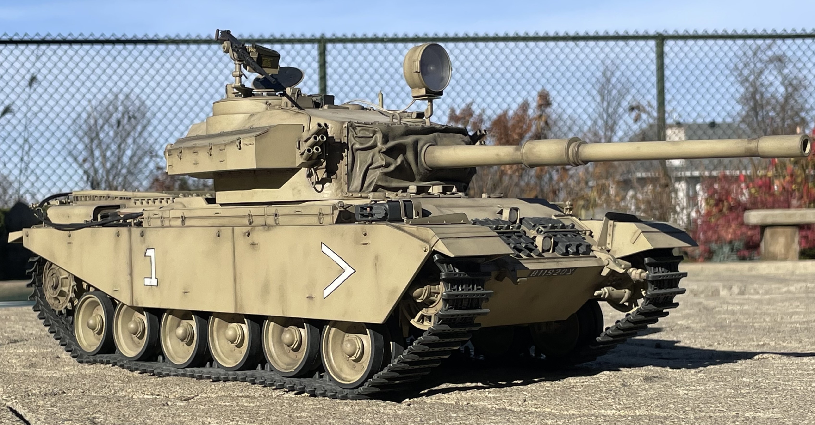

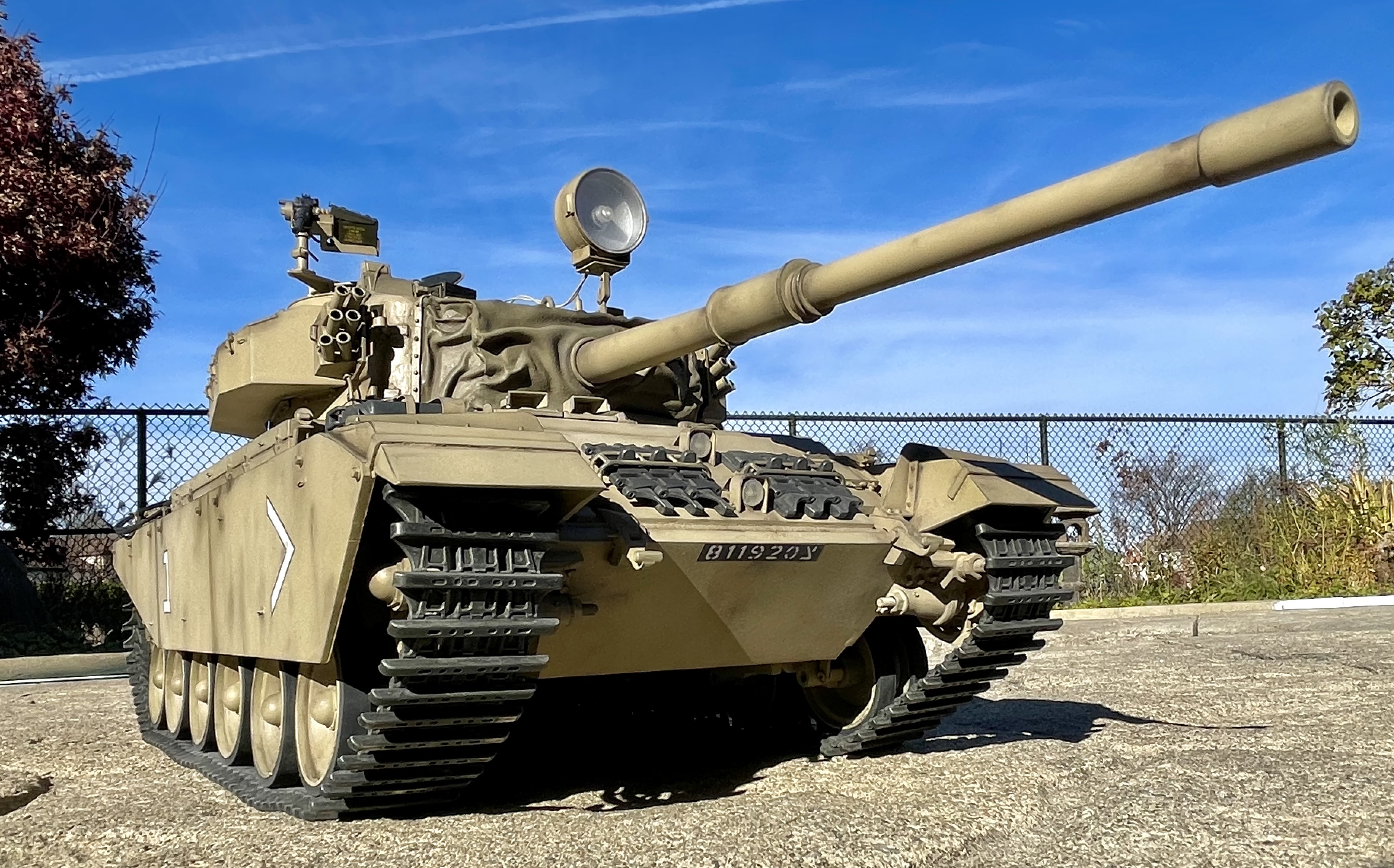

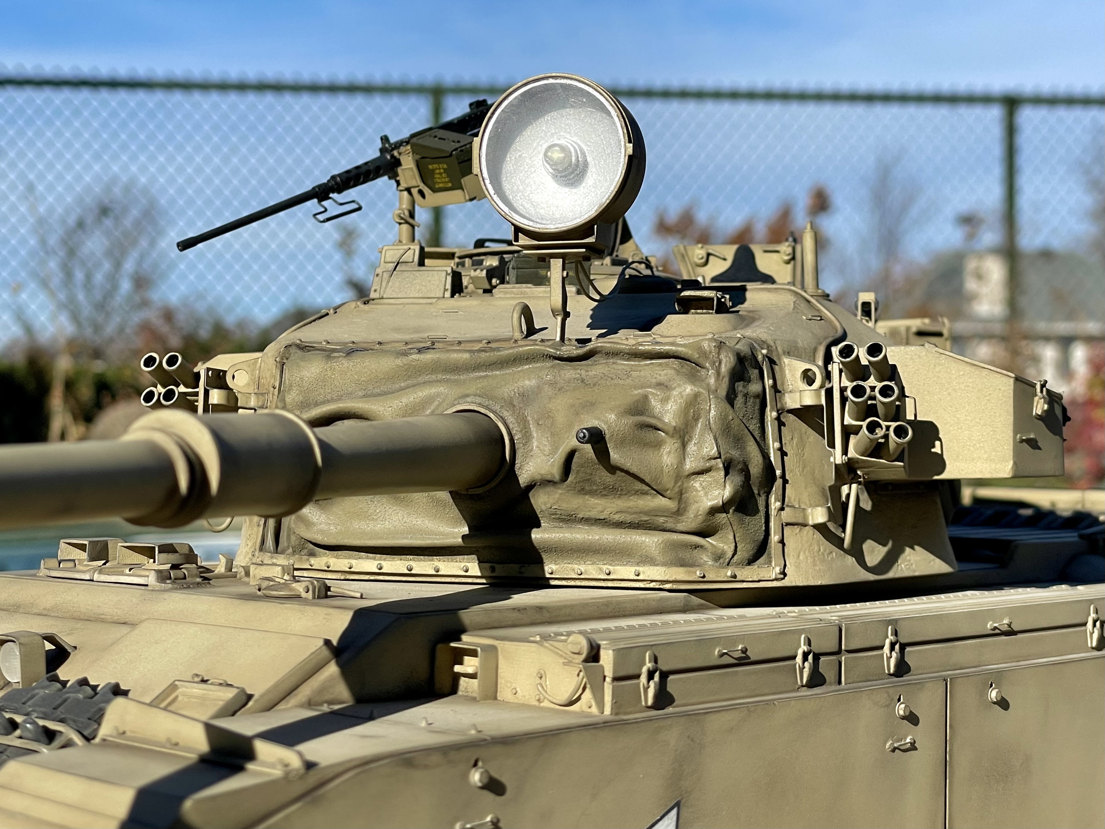

After the model was weathered with light applications of black and dark steel pigments in corners and raised areas, it was given a coat of Tamiya flat clear and brought outside in the sun for a photoshoot to check how things are.
Bringing the model in the sun for a close up photoshoot is totally unforgiving, it will highlight every problems, every little mistakes or imperfections but also show what is good. Small improvements can then be made. Keep in mind it also gives a more golden color depending on the weather and time of day.
Here is the model on its first photoshoot, highlights on details for inspection.
