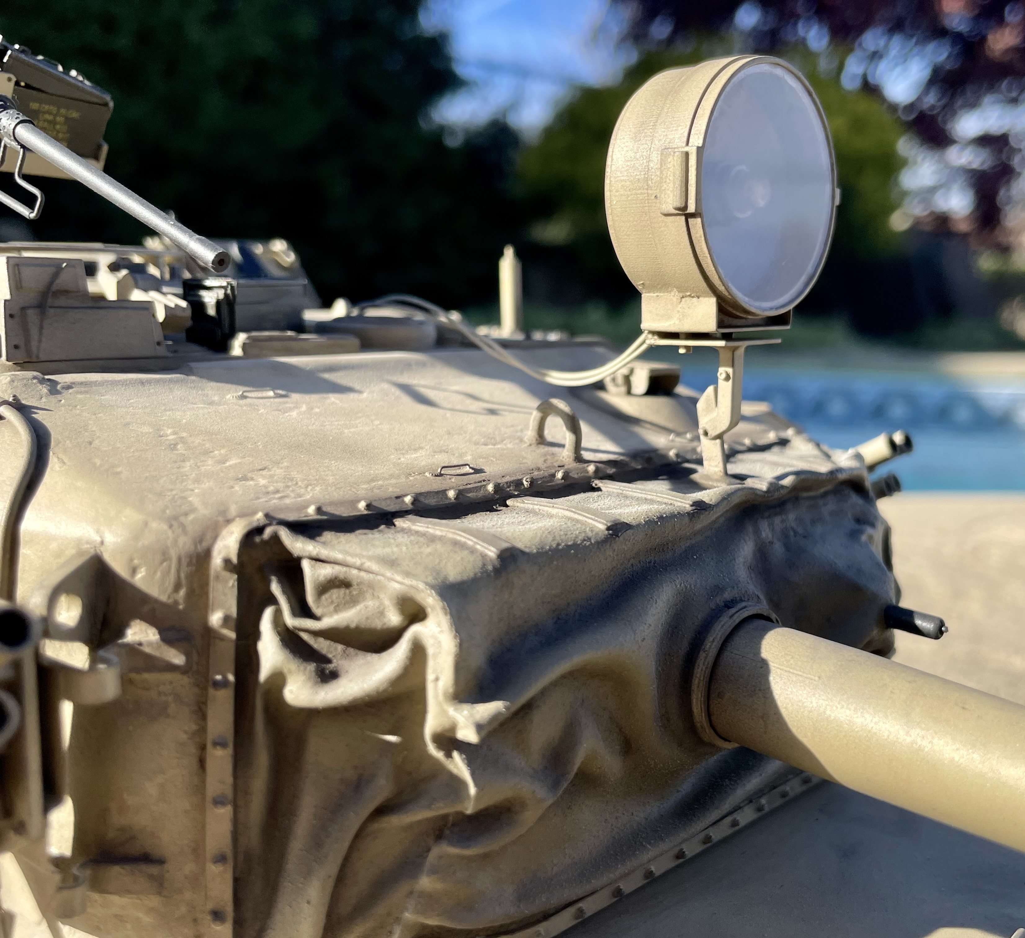

Ecam wrote: Thu Nov 09, 2023 9:52 pm I said it when you built the cover originally, but your canvas work is an art itself. The repair looks great now, if you are going to improve it more.....wow!
Thank you. Creating a mantlet cover is a risky task, being right in front of the vehicle and that's usually the first thing people look at to see how the builder has managed the job. It's far from perfect but it does not look too bad.

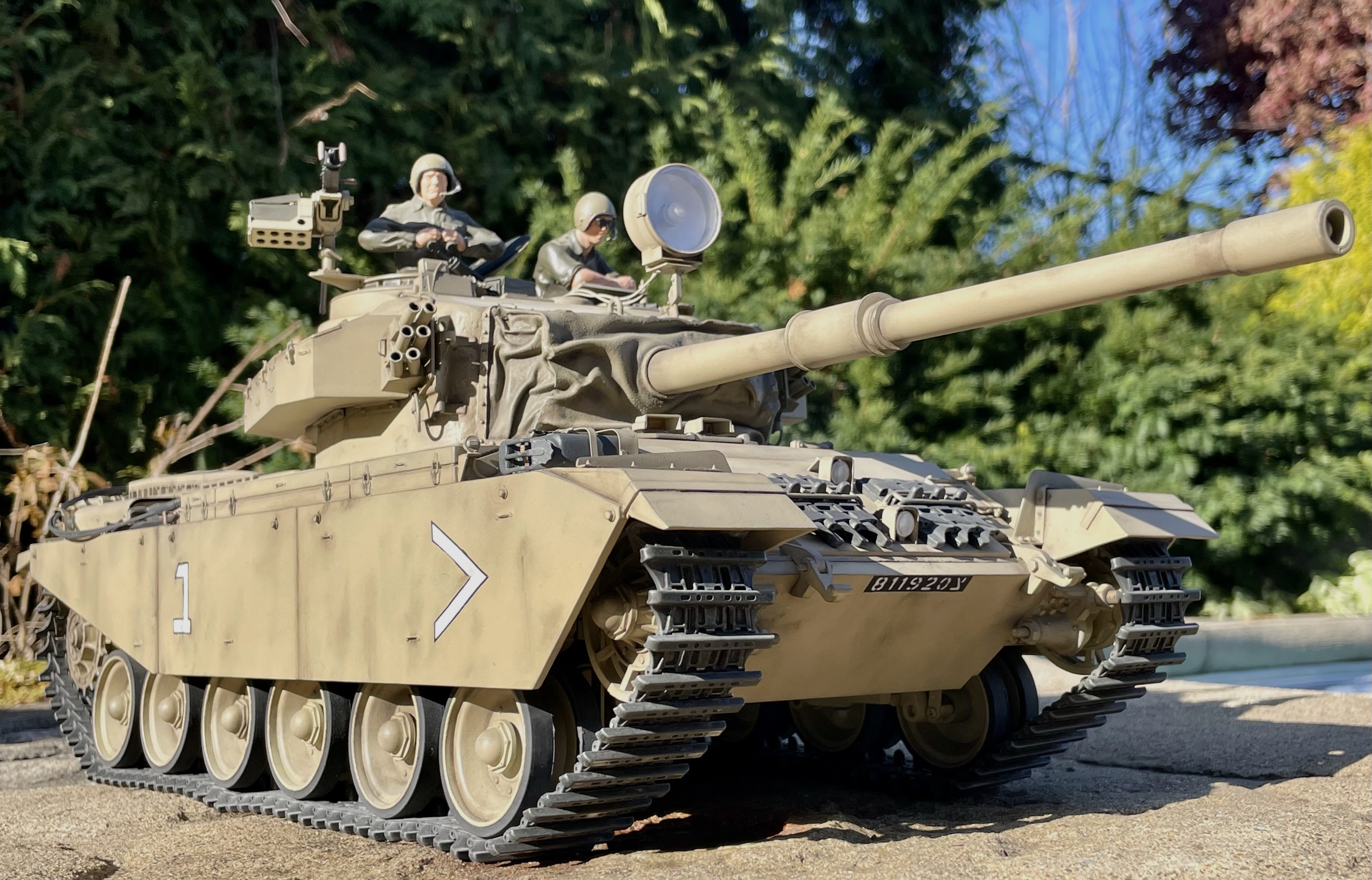

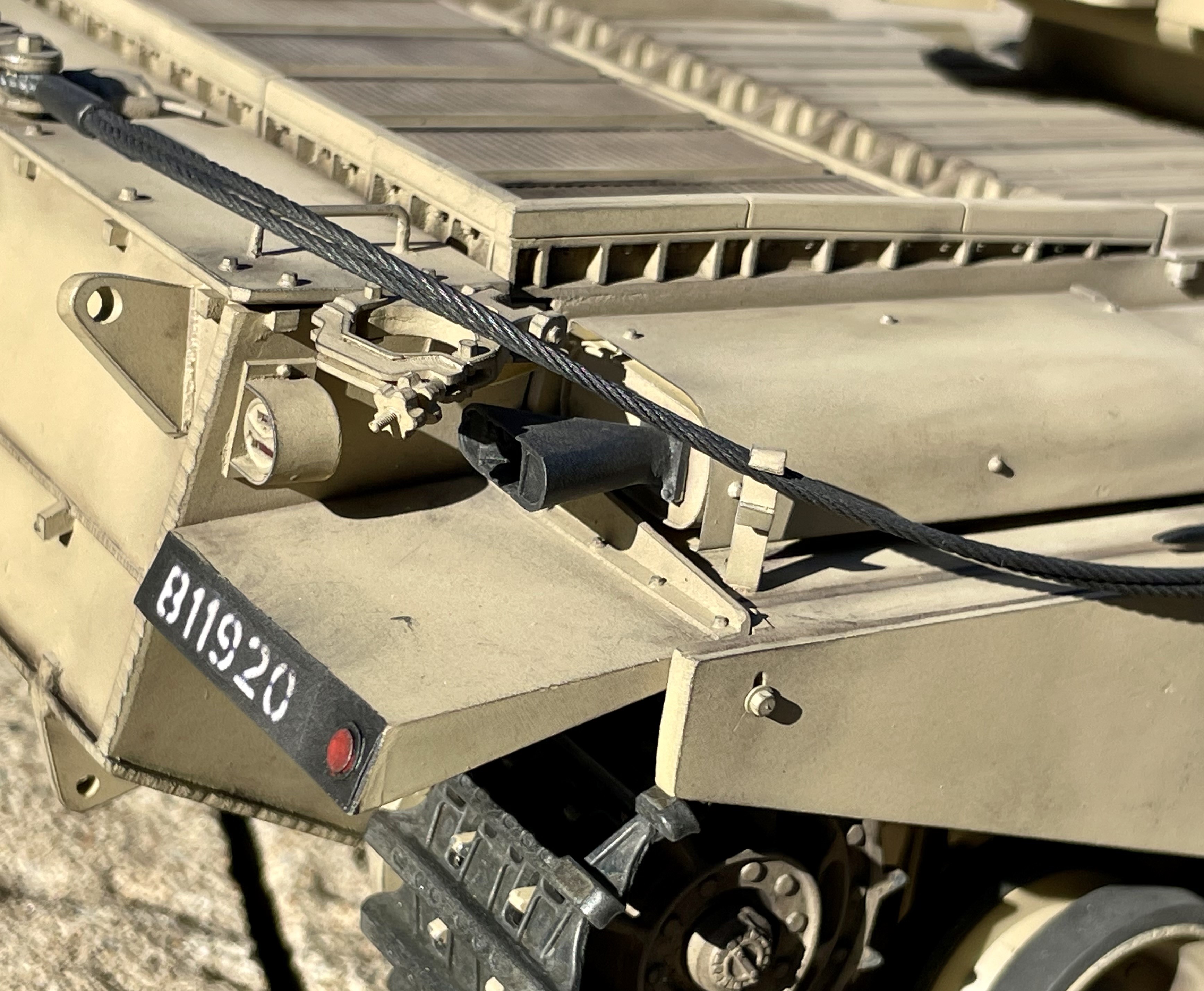

Continuing with the build.
The painting.

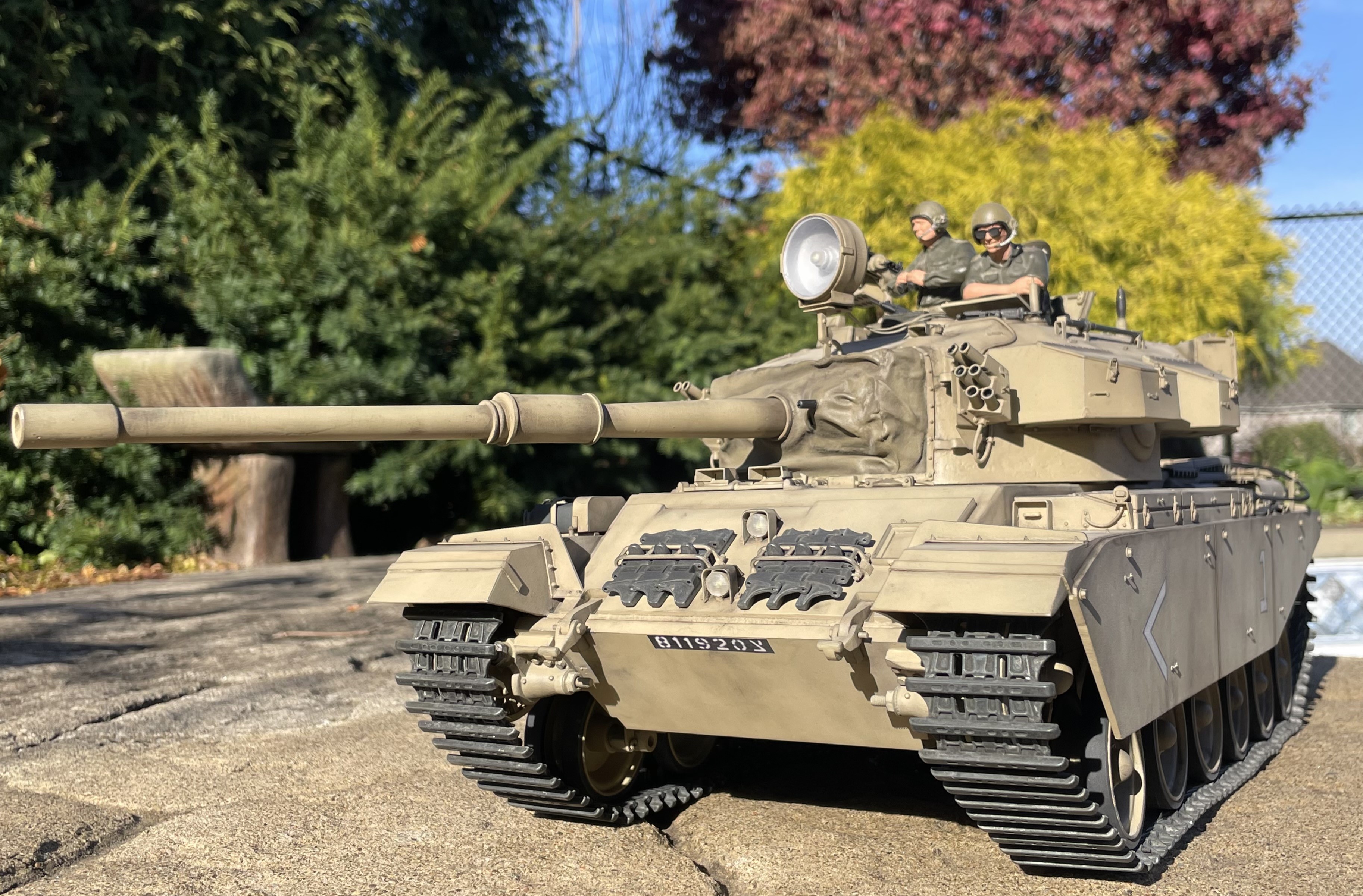

After the enamel primer coat, the model was given a coat of Mig Ammo "MIG-0132 Real IDF Sand Grey 73". This was a no brainer for me. My late sho't Meteor would have been used in the Yom Kippour war in 1973 alongside converted Sho't Kals. The conversion was a long process. I think the color is pretty good.
Modellers of IDF tanks have to be really careful because IDF Centurion tanks changed color many times between 1967, 1973 and the 80s. Its not because a bottle says IDF on it that it can be used on any tanks. I think the various "IDF Grey" are the worst color for paint makers. Their offerings are not all good. Careful if you do not want your model to end up in some kind of pink or purple sand brown.
The model after painting but before weathering.
1/16 RC IDF Late Sho't Meteor Centurion with 105mm - build

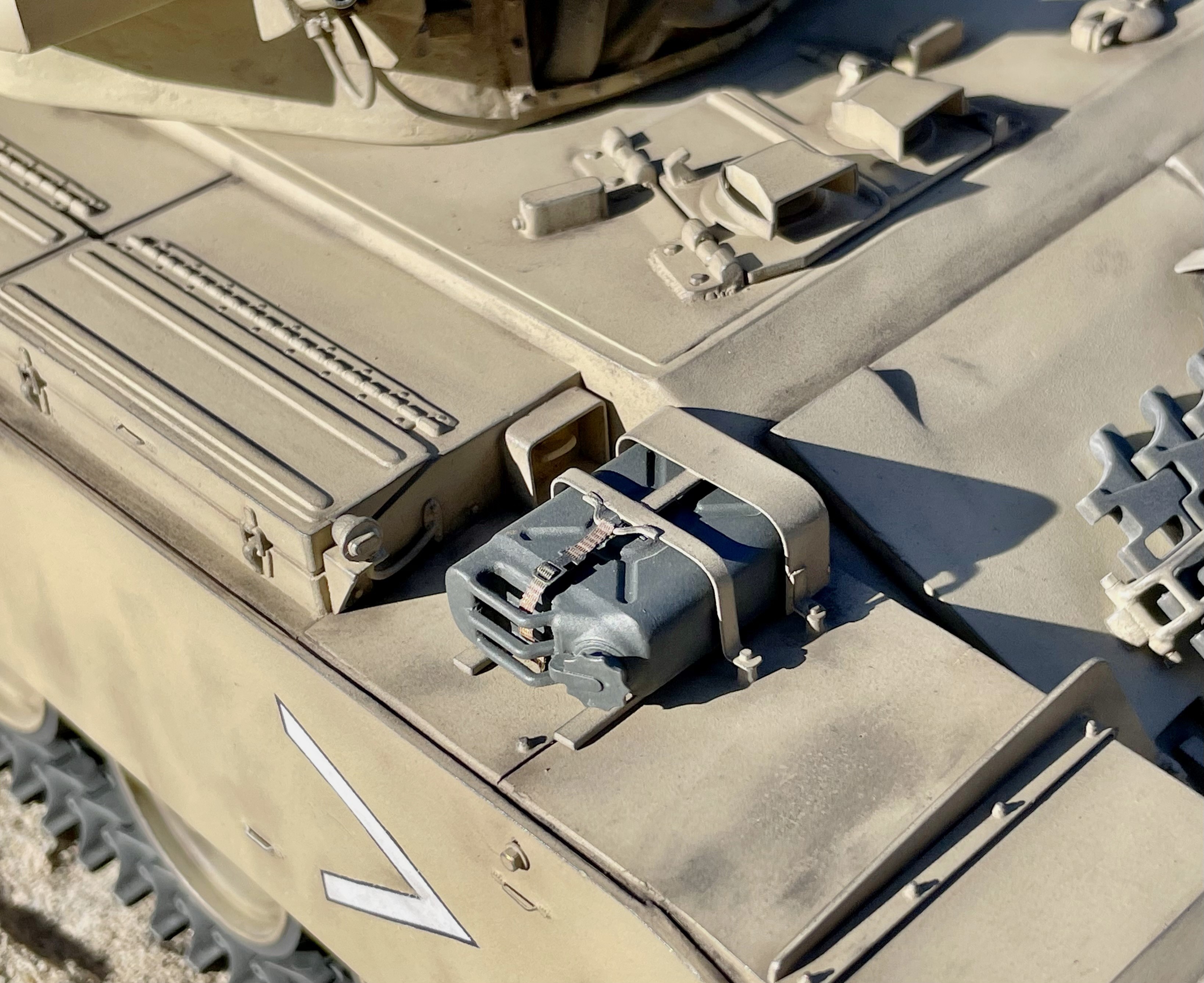

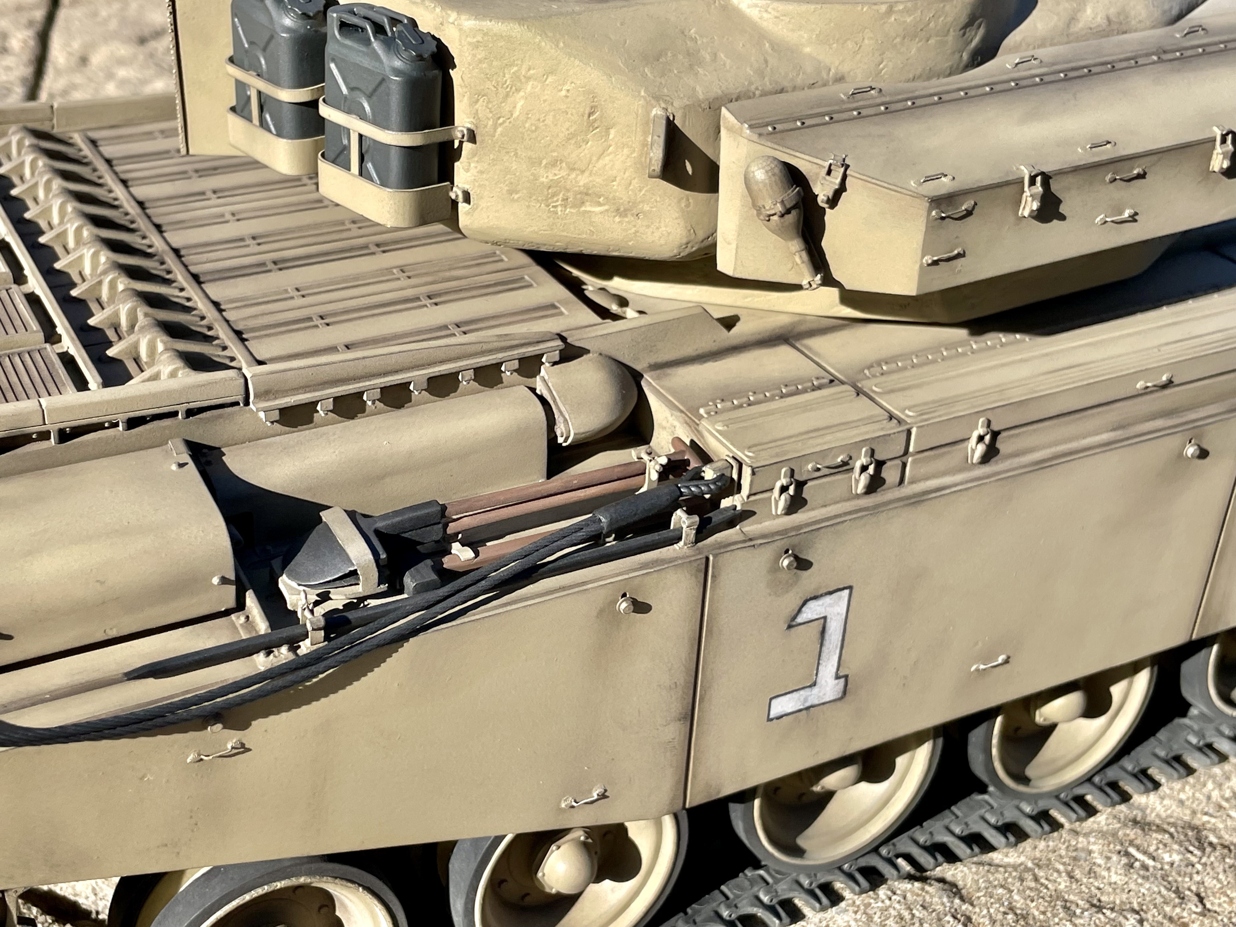

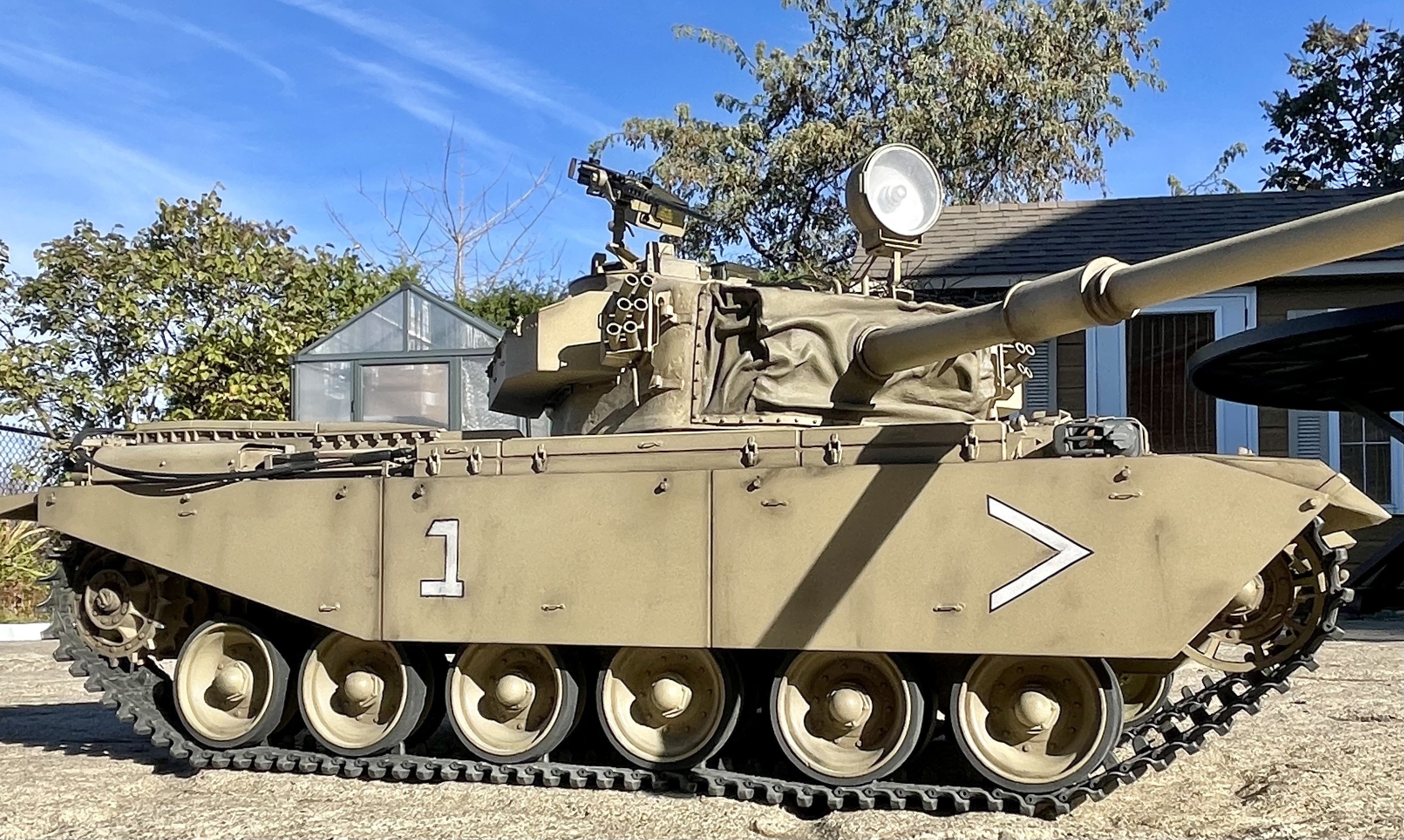

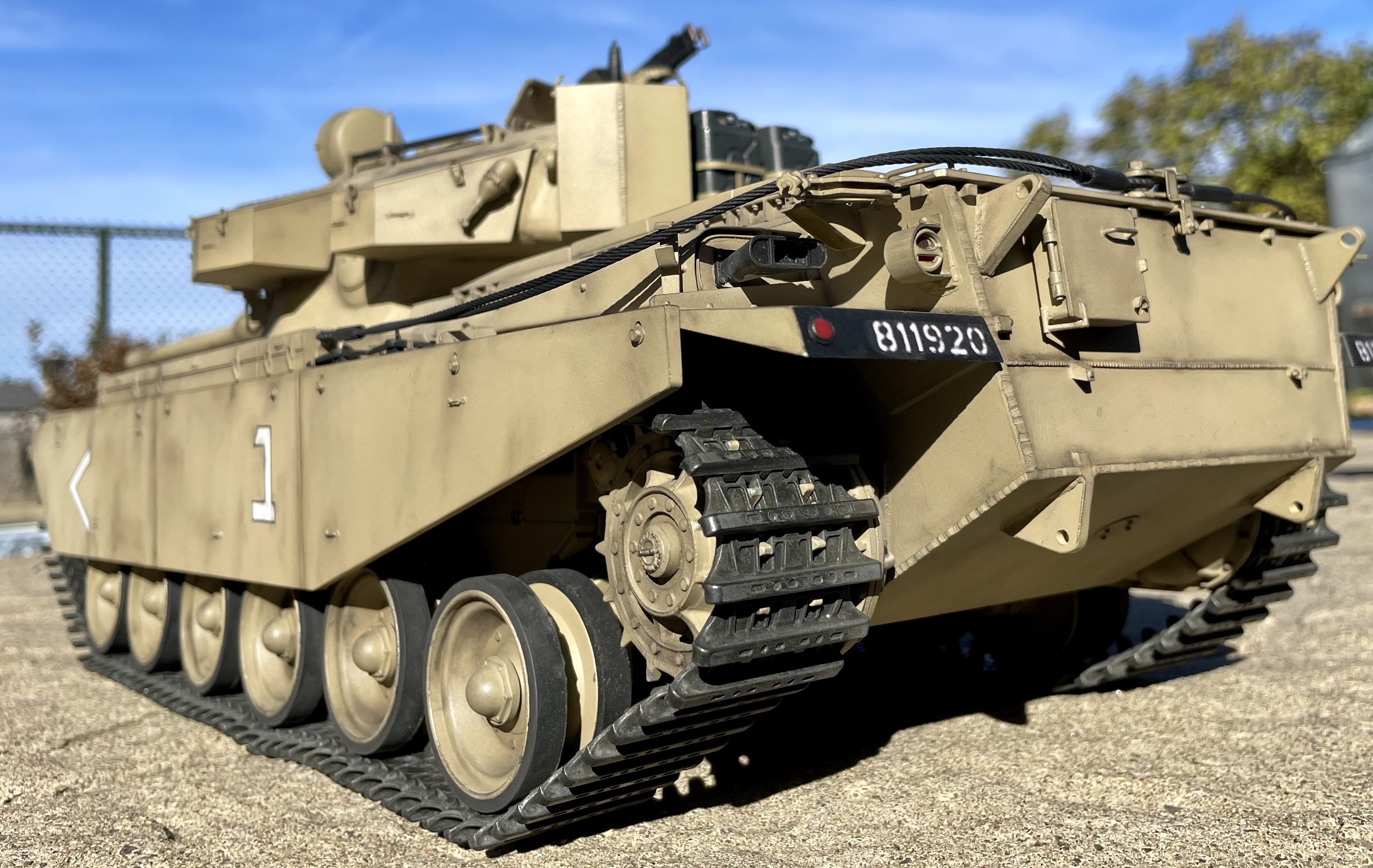

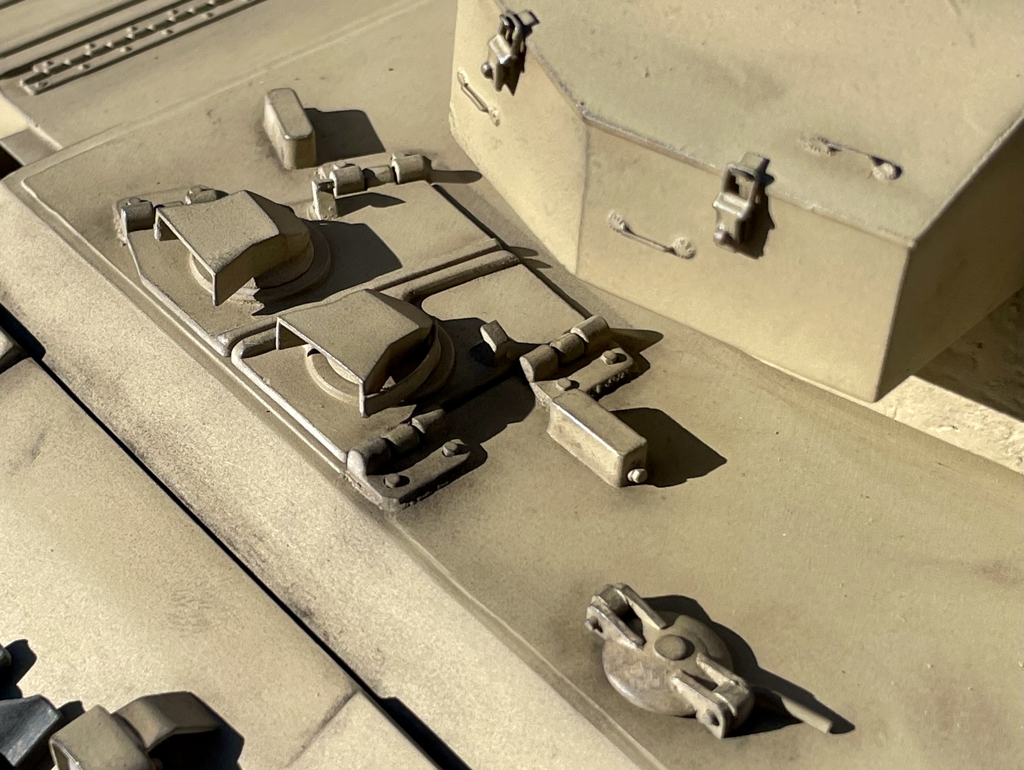

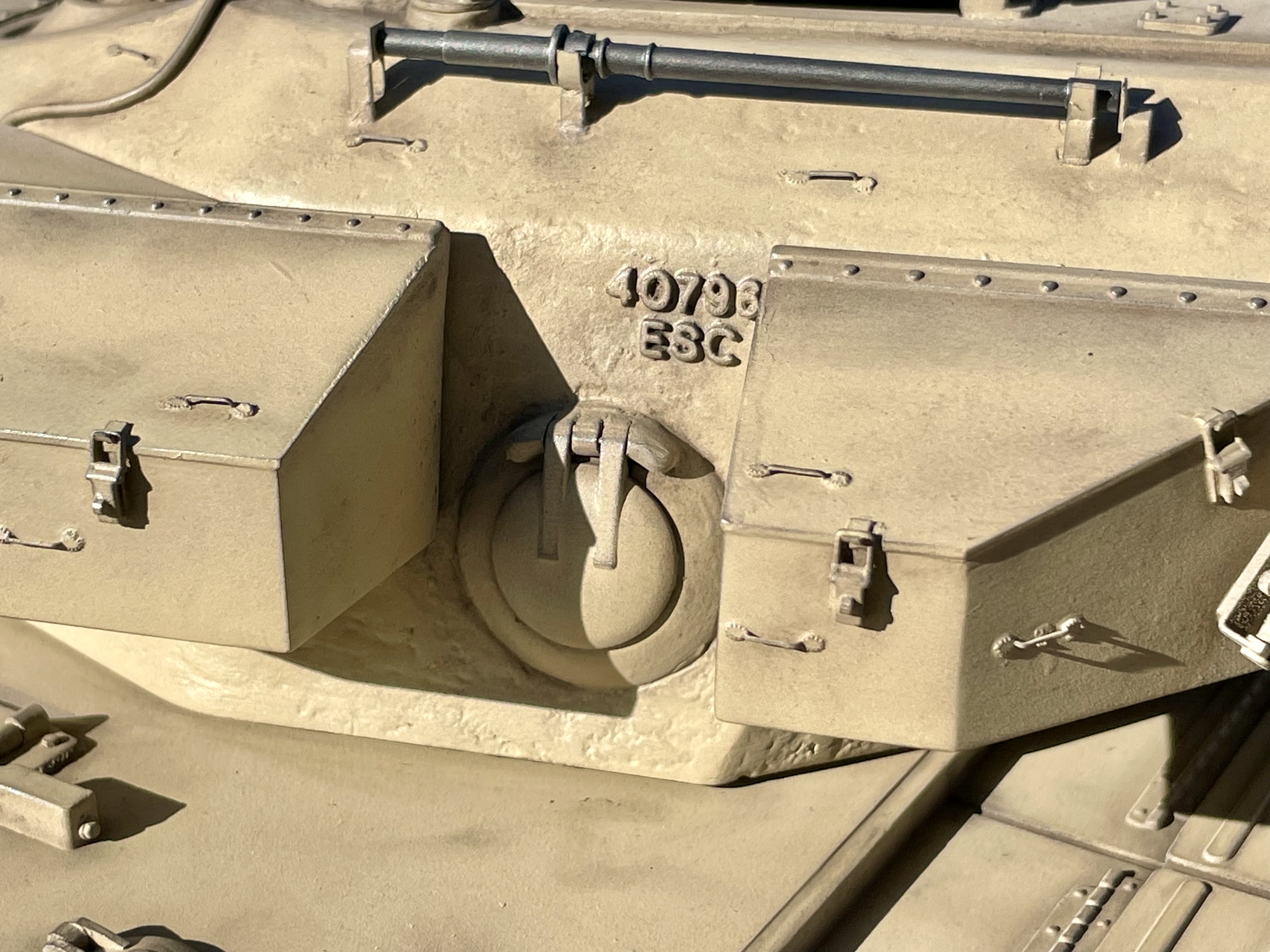

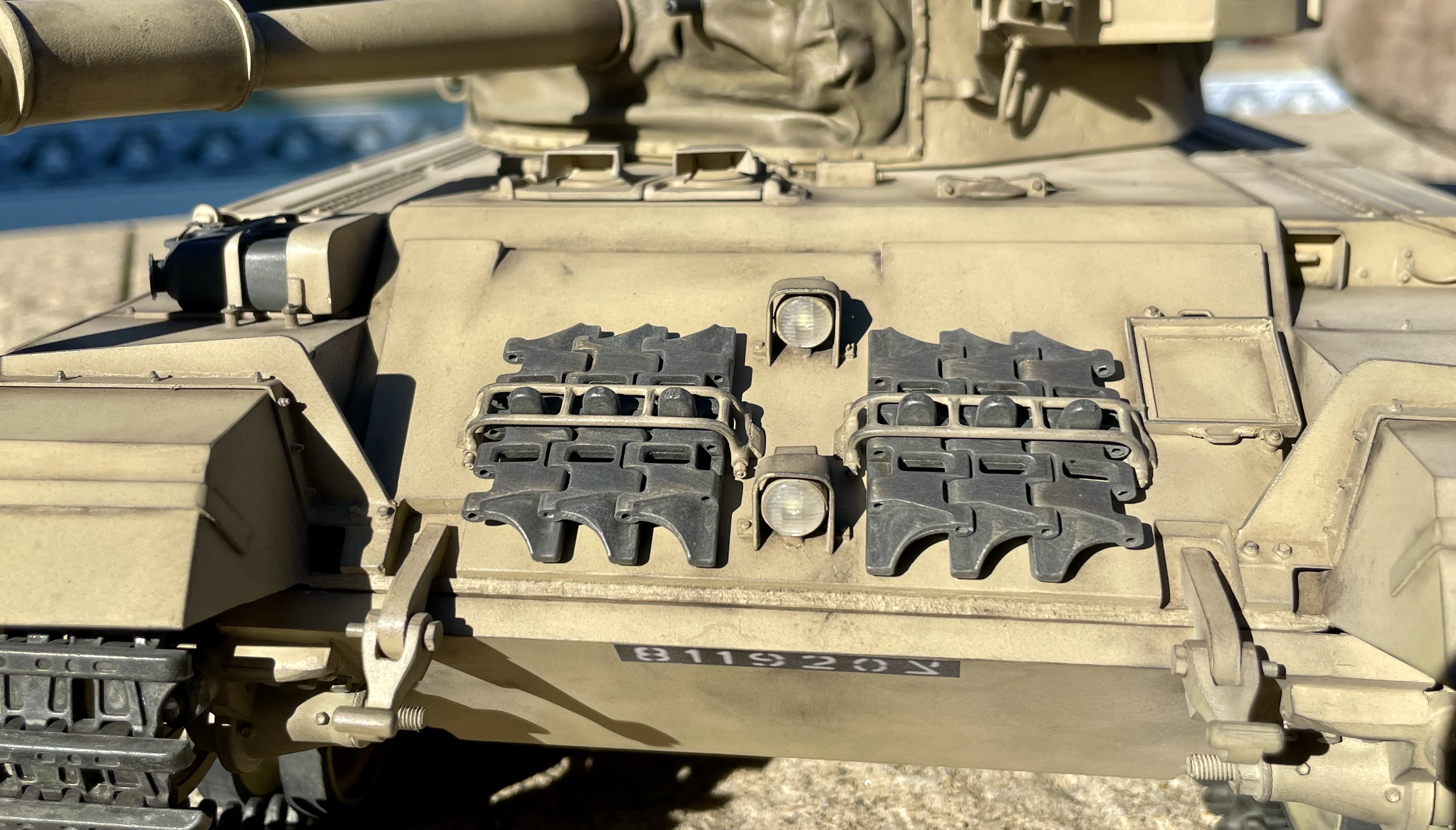

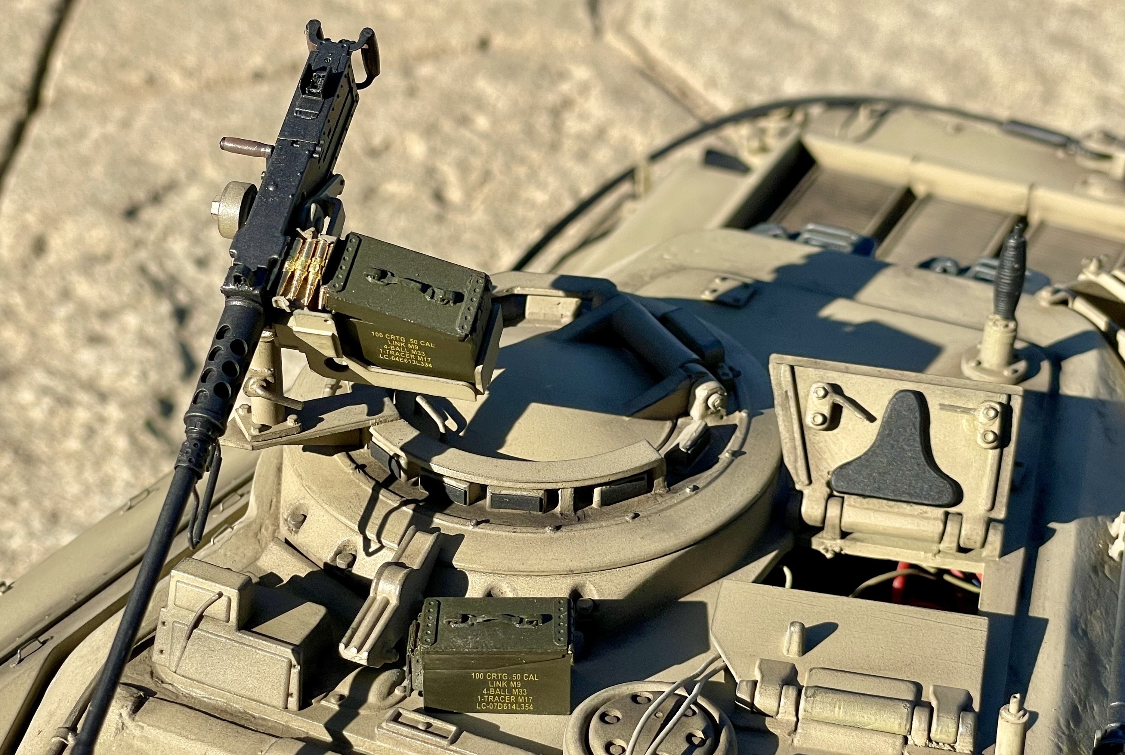

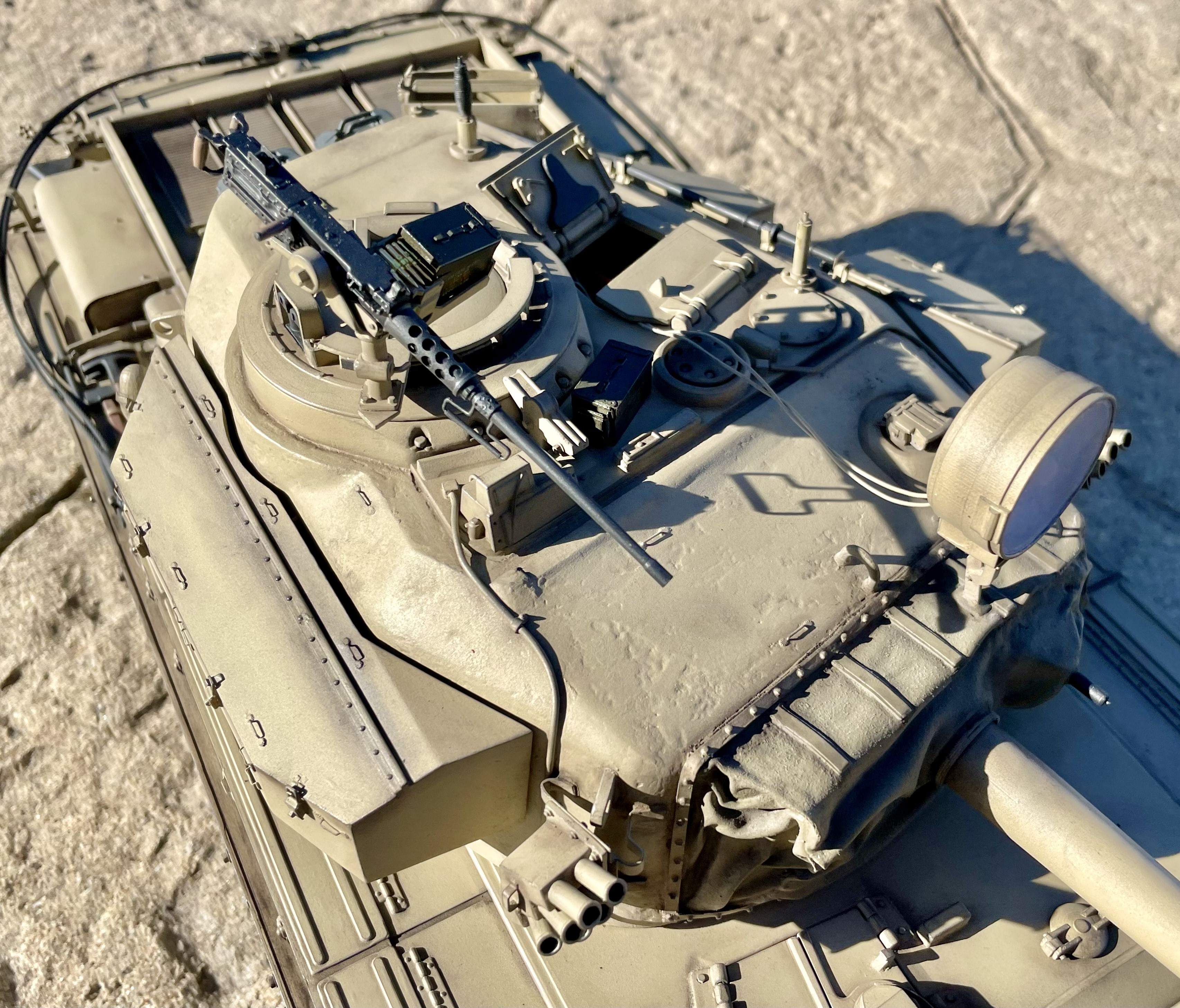

After the model was weathered with light applications of black and dark steel pigments in corners and raised areas, it was given a coat of Tamiya flat clear and brought outside in the sun for a photoshoot to check how things are.
Bringing the model in the sun for a close up photoshoot is totally unforgiving, it will highlight every problems, every little mistakes or imperfections but also show what is good. Small improvements can then be made. Keep in mind it also gives a more golden color depending on the weather and time of day.

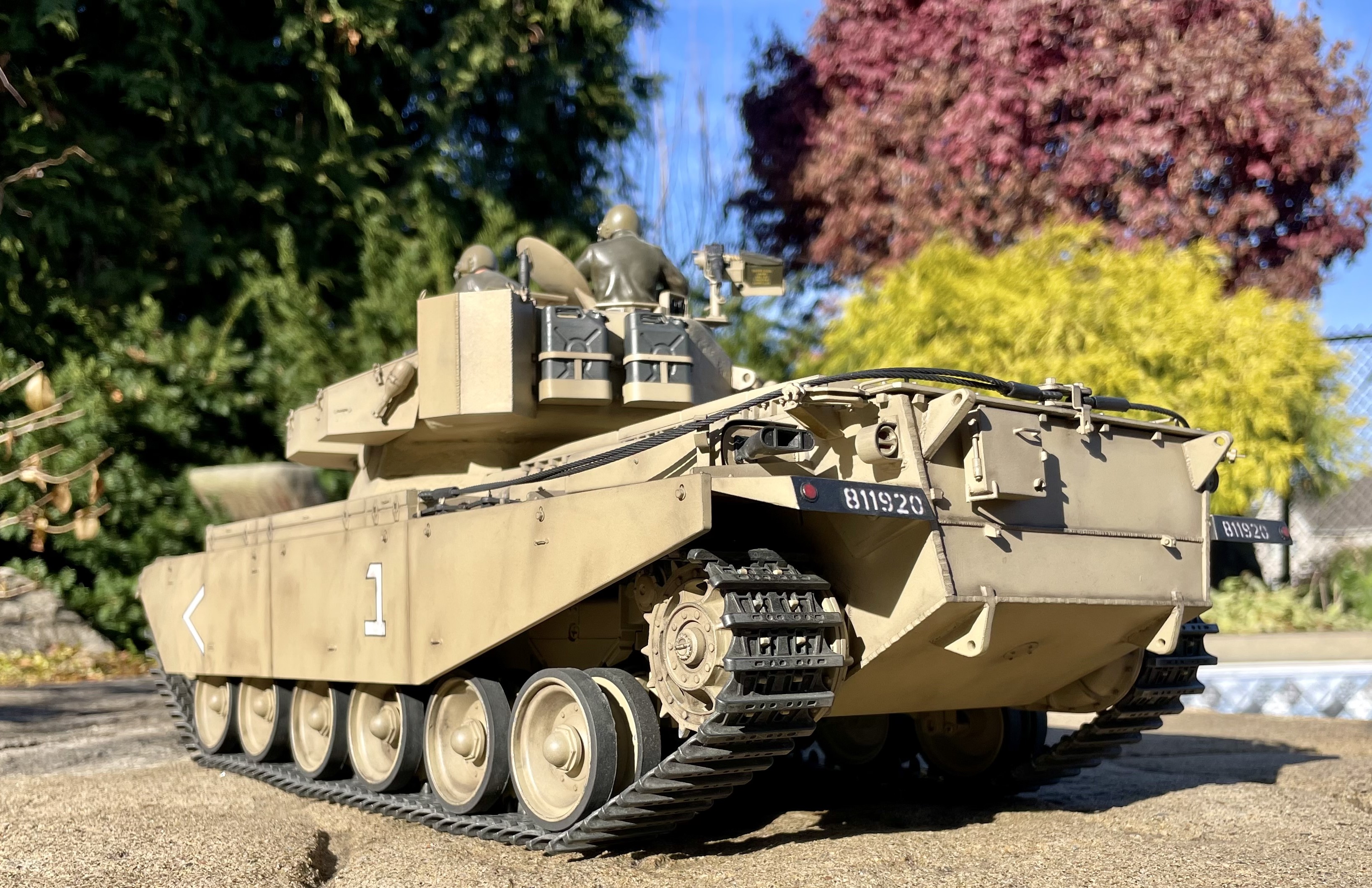

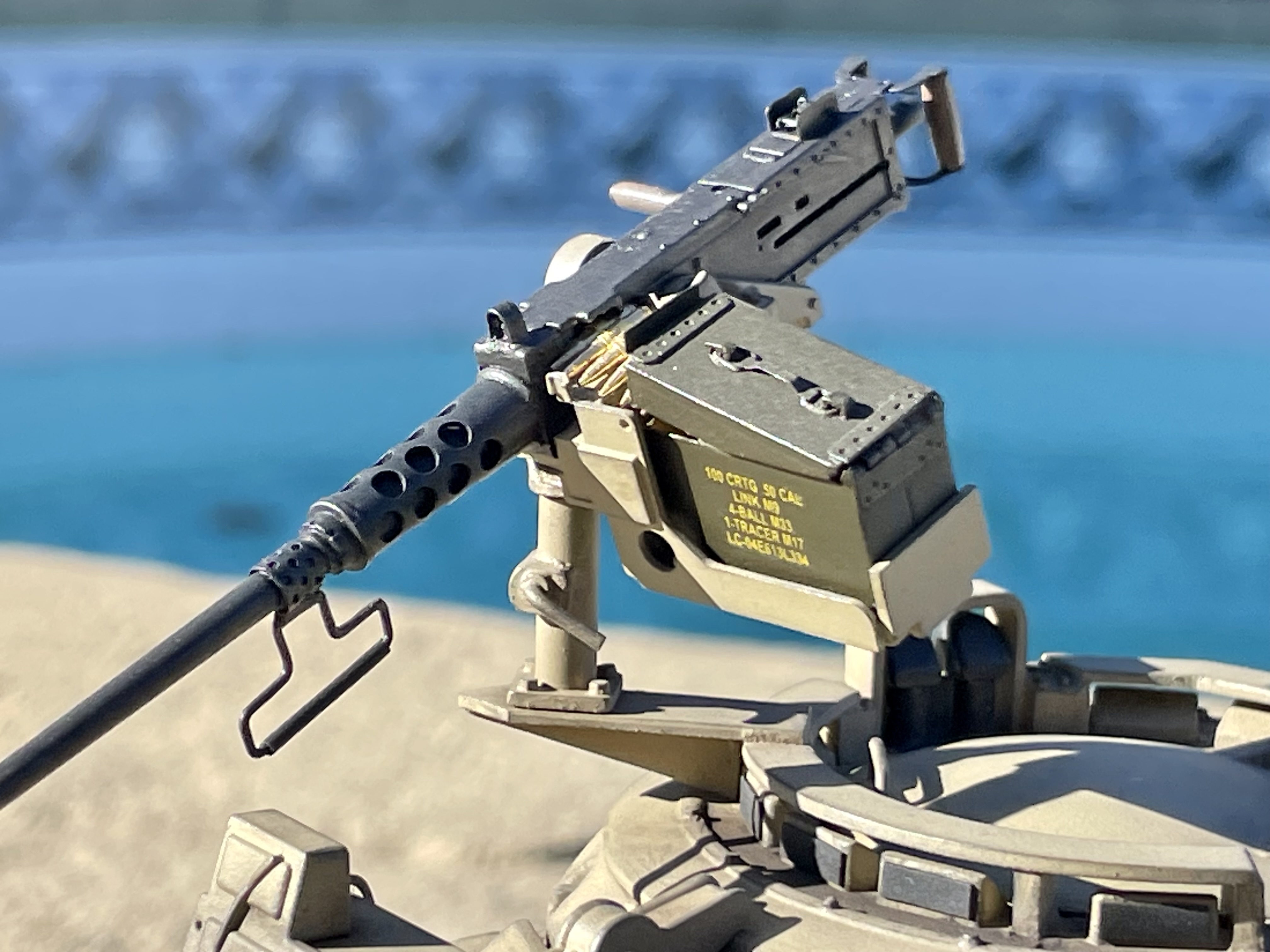

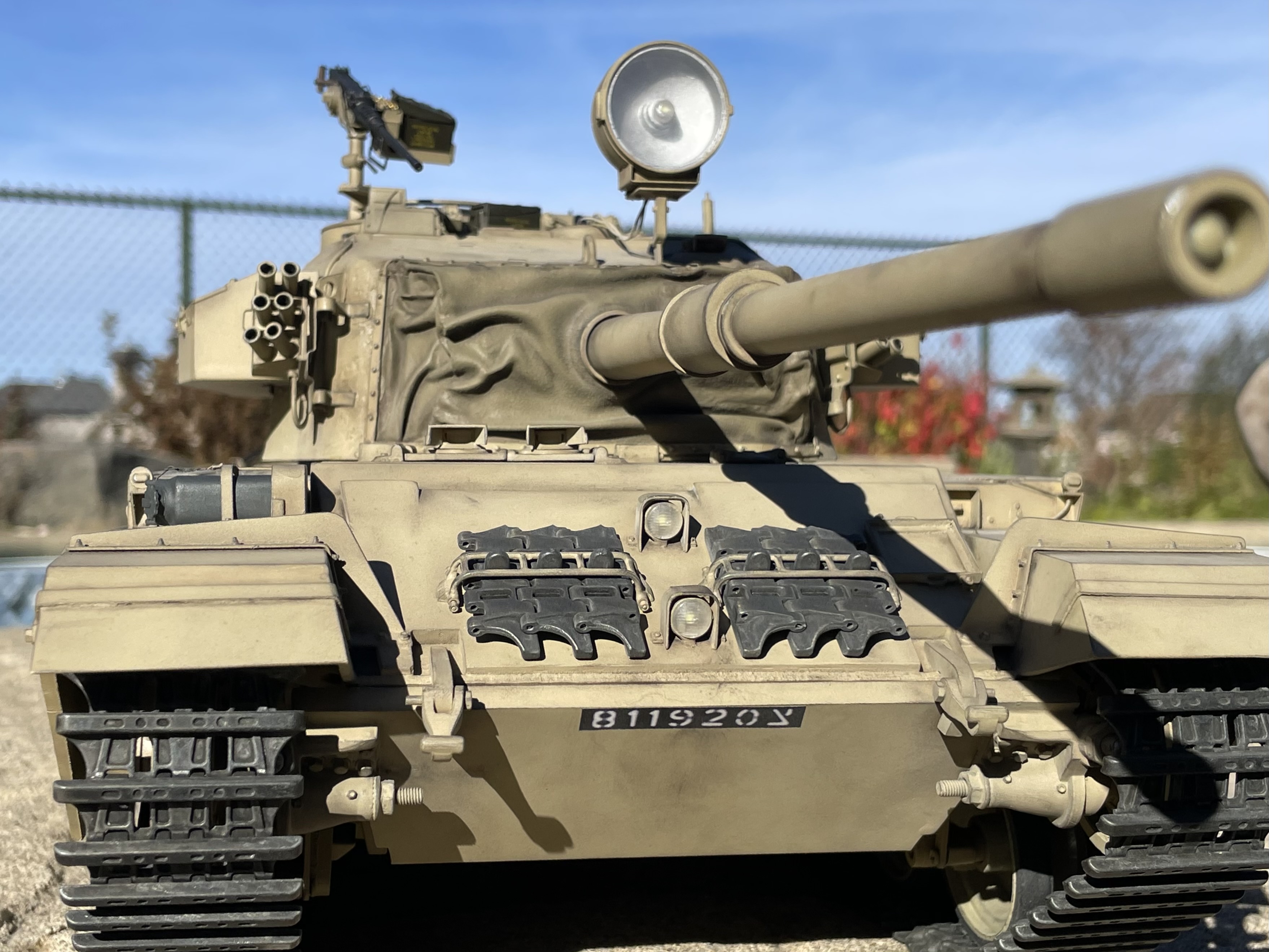

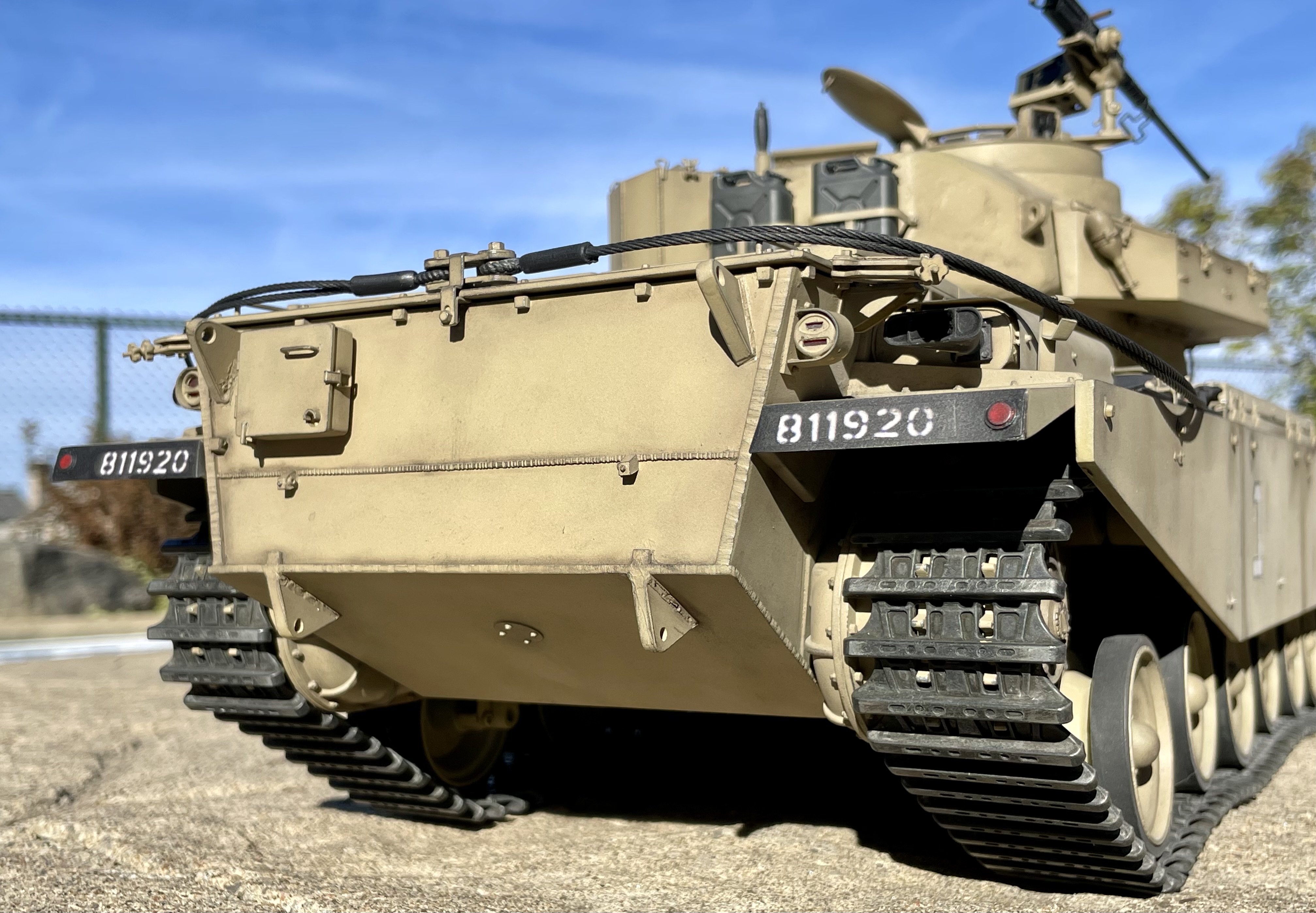

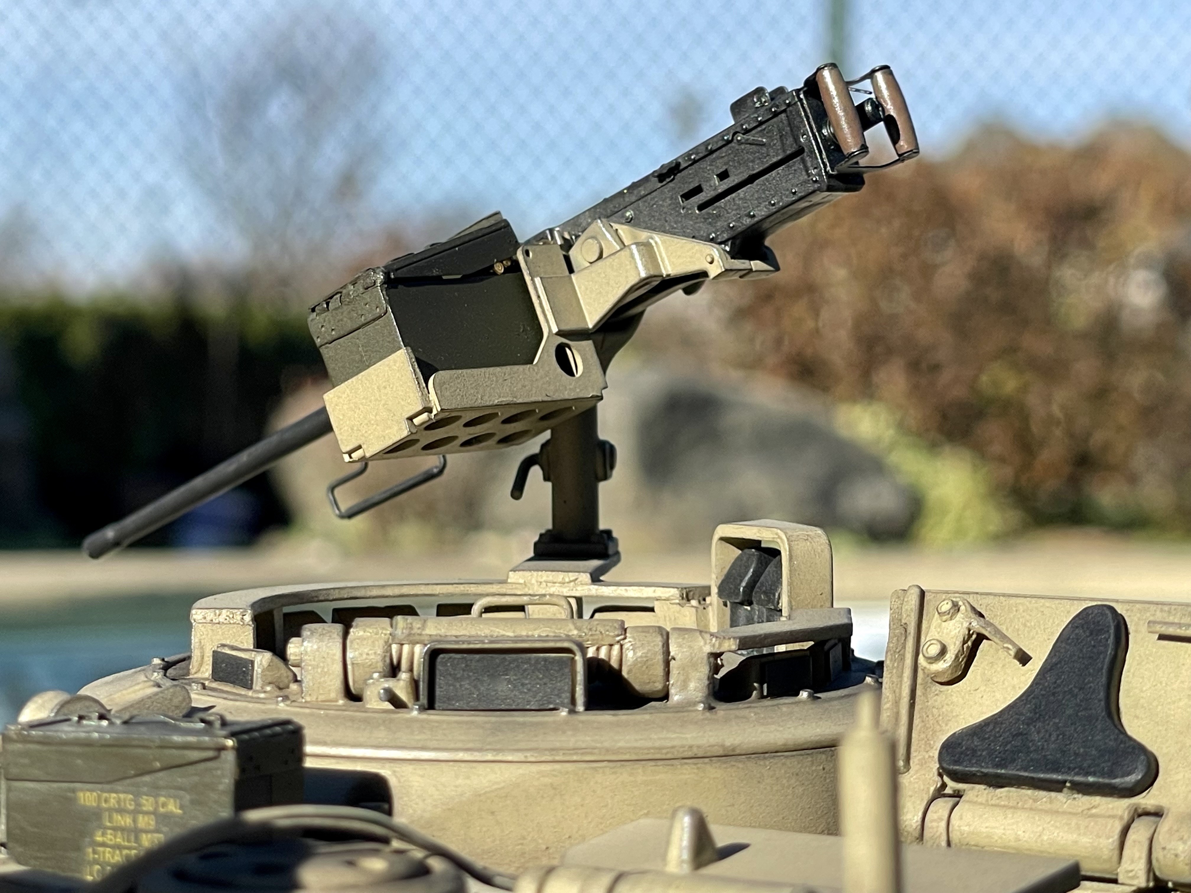

Here is the model on its first photoshoot, highlights on details for inspection.

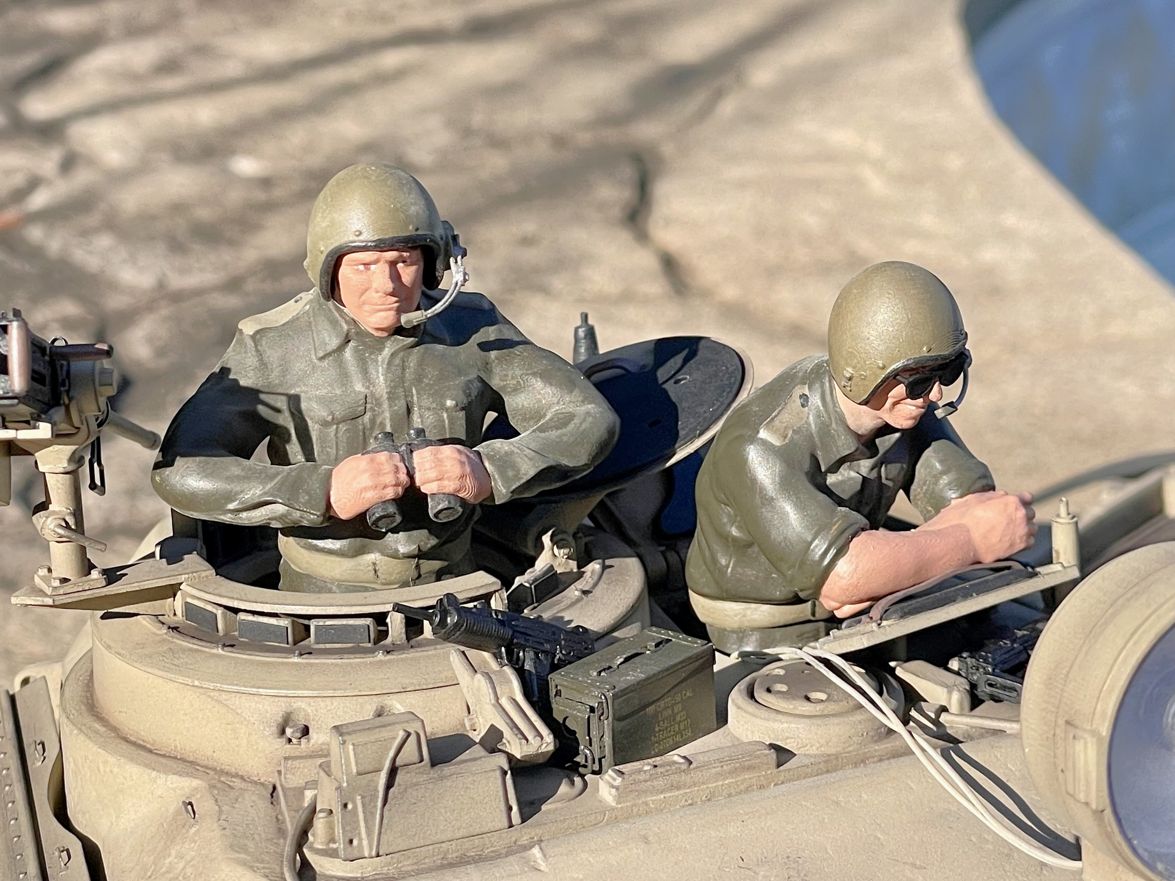

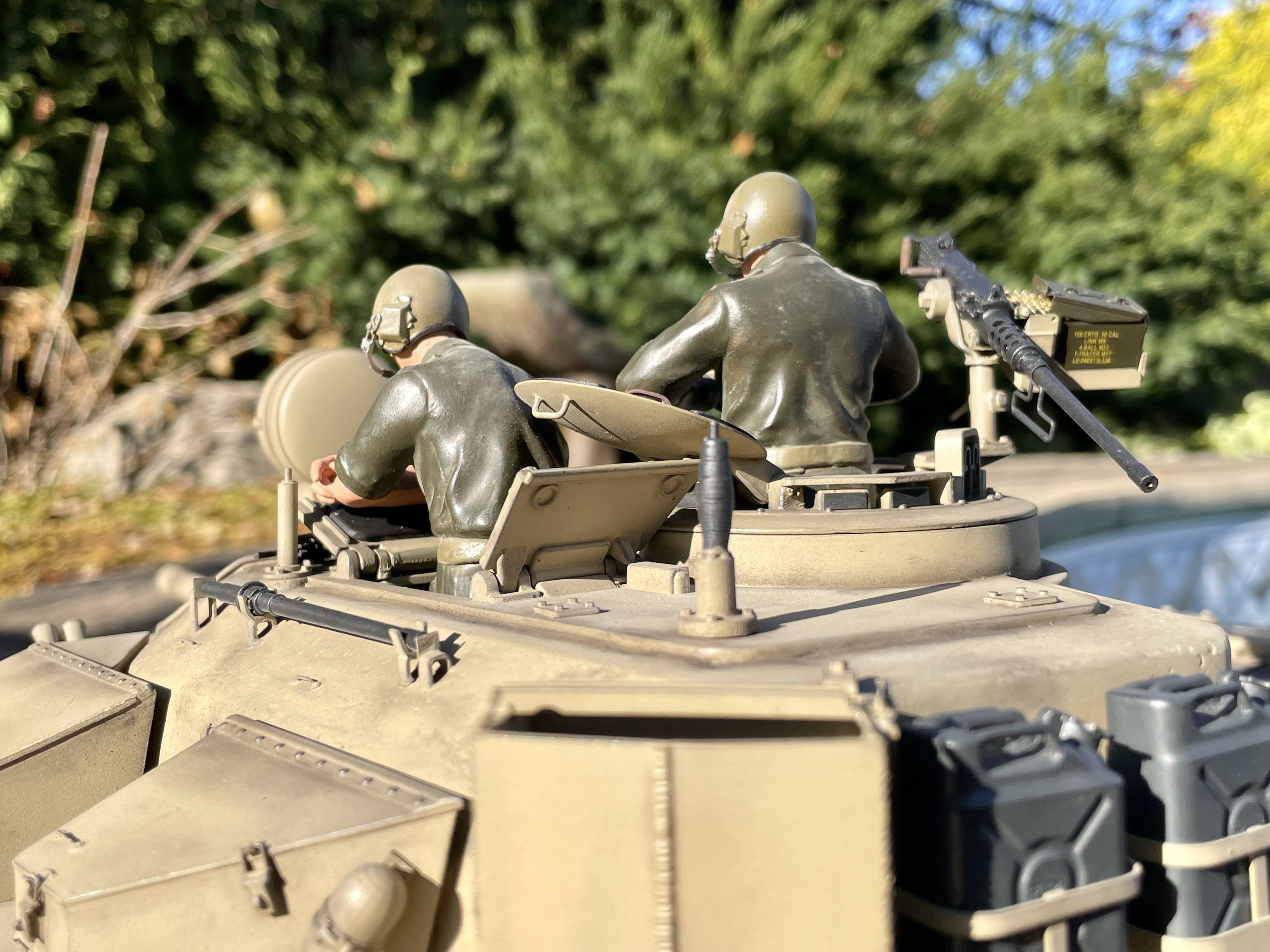

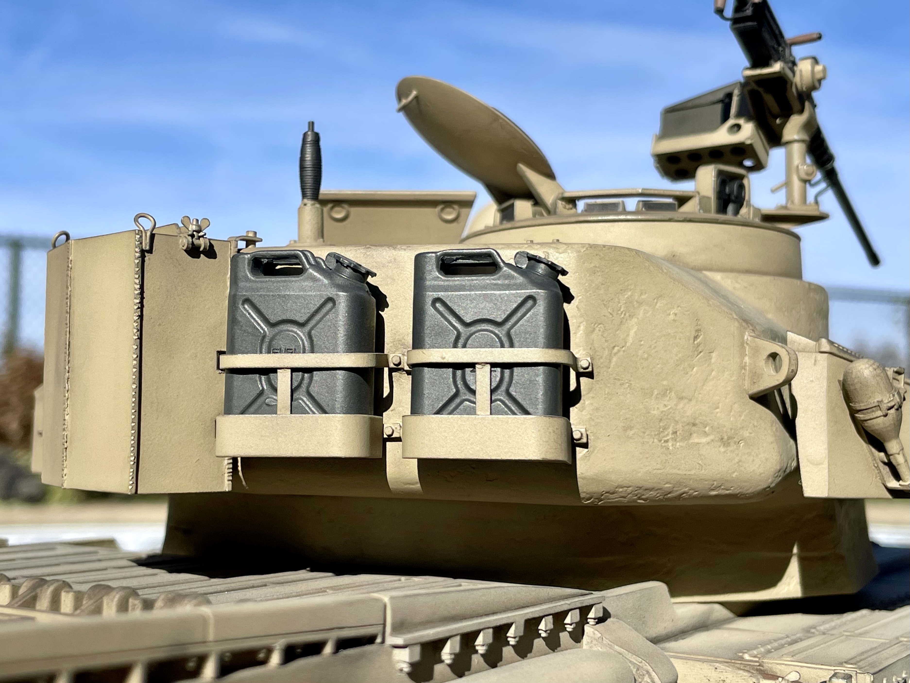

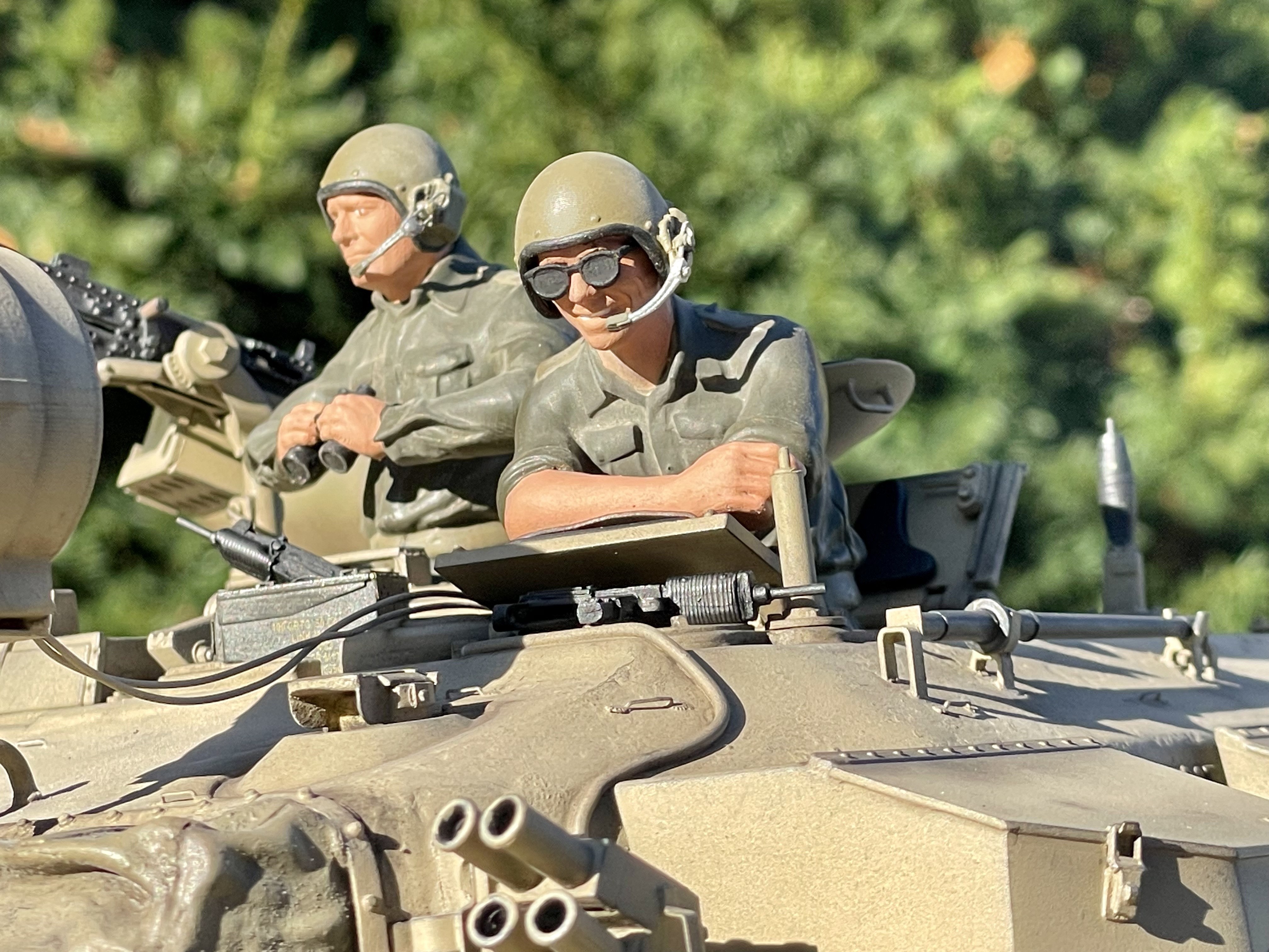

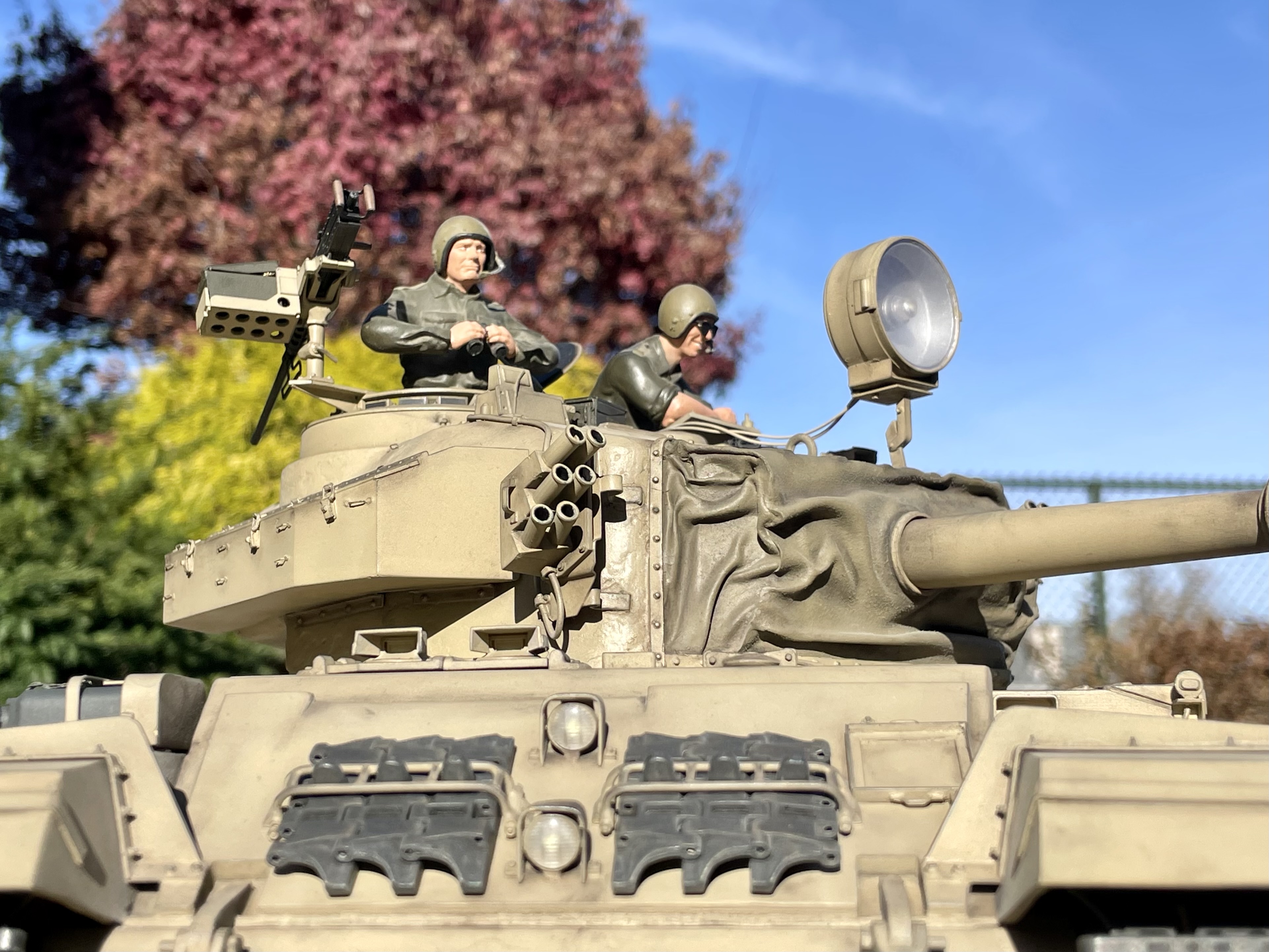

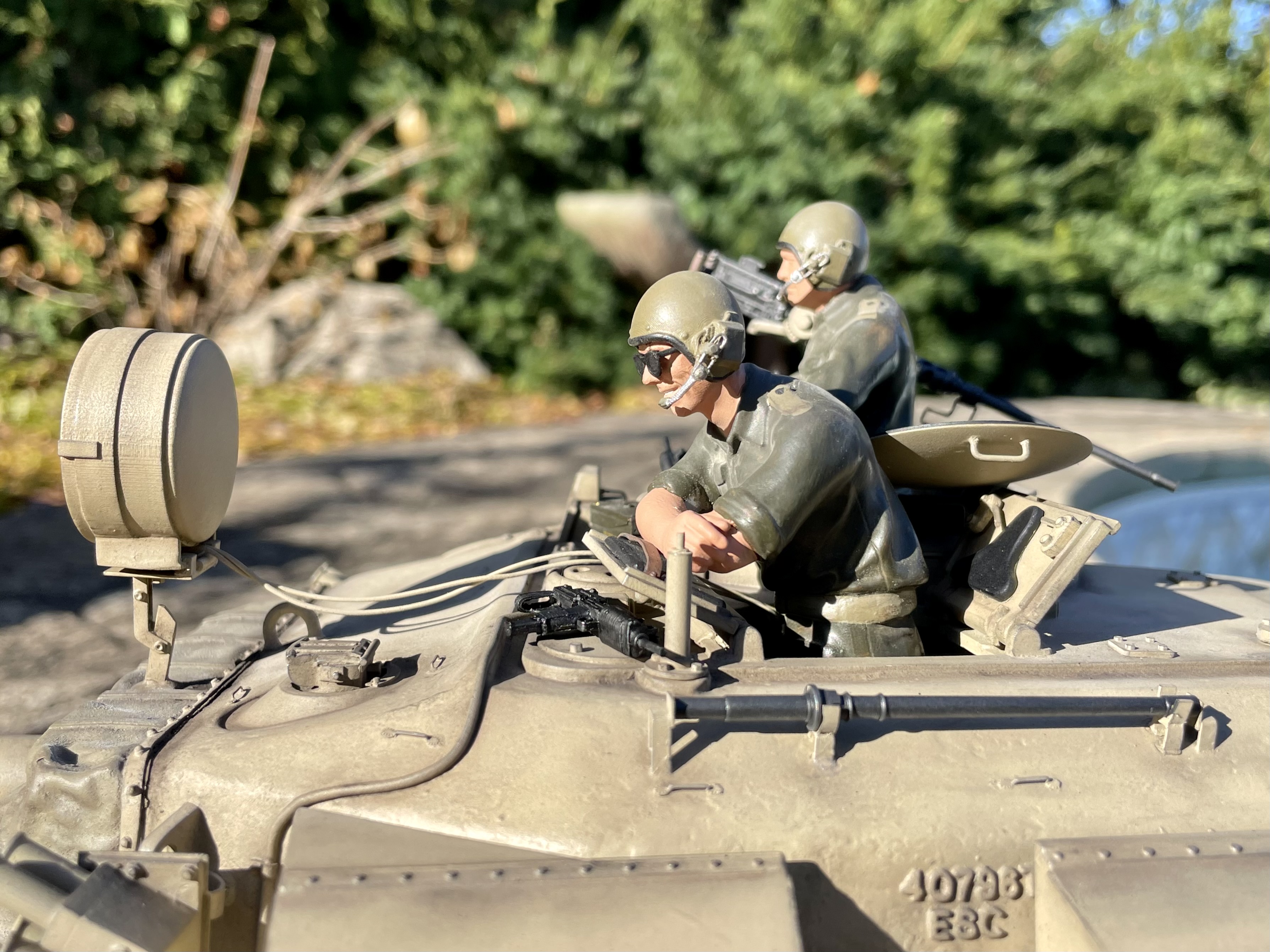

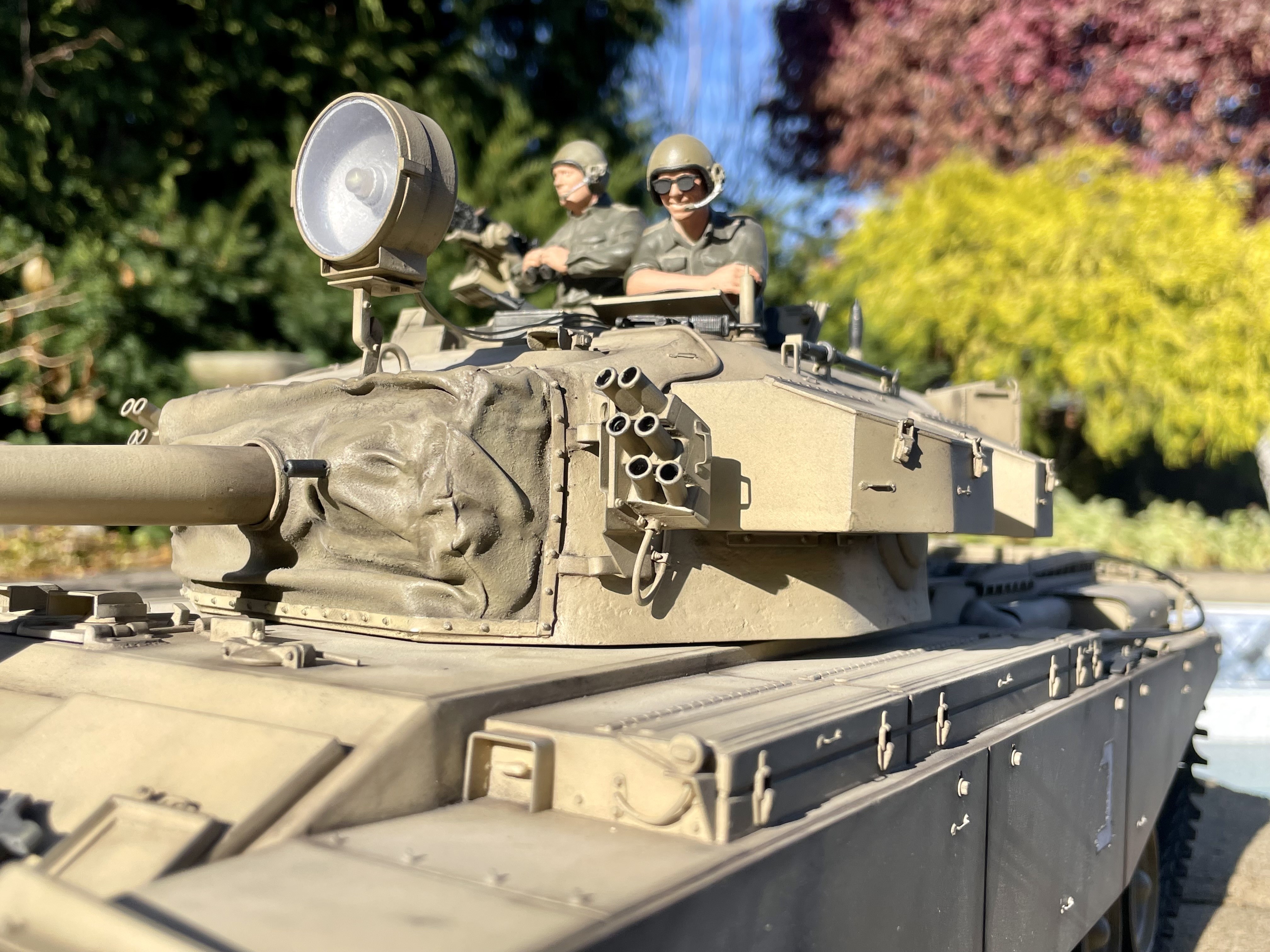

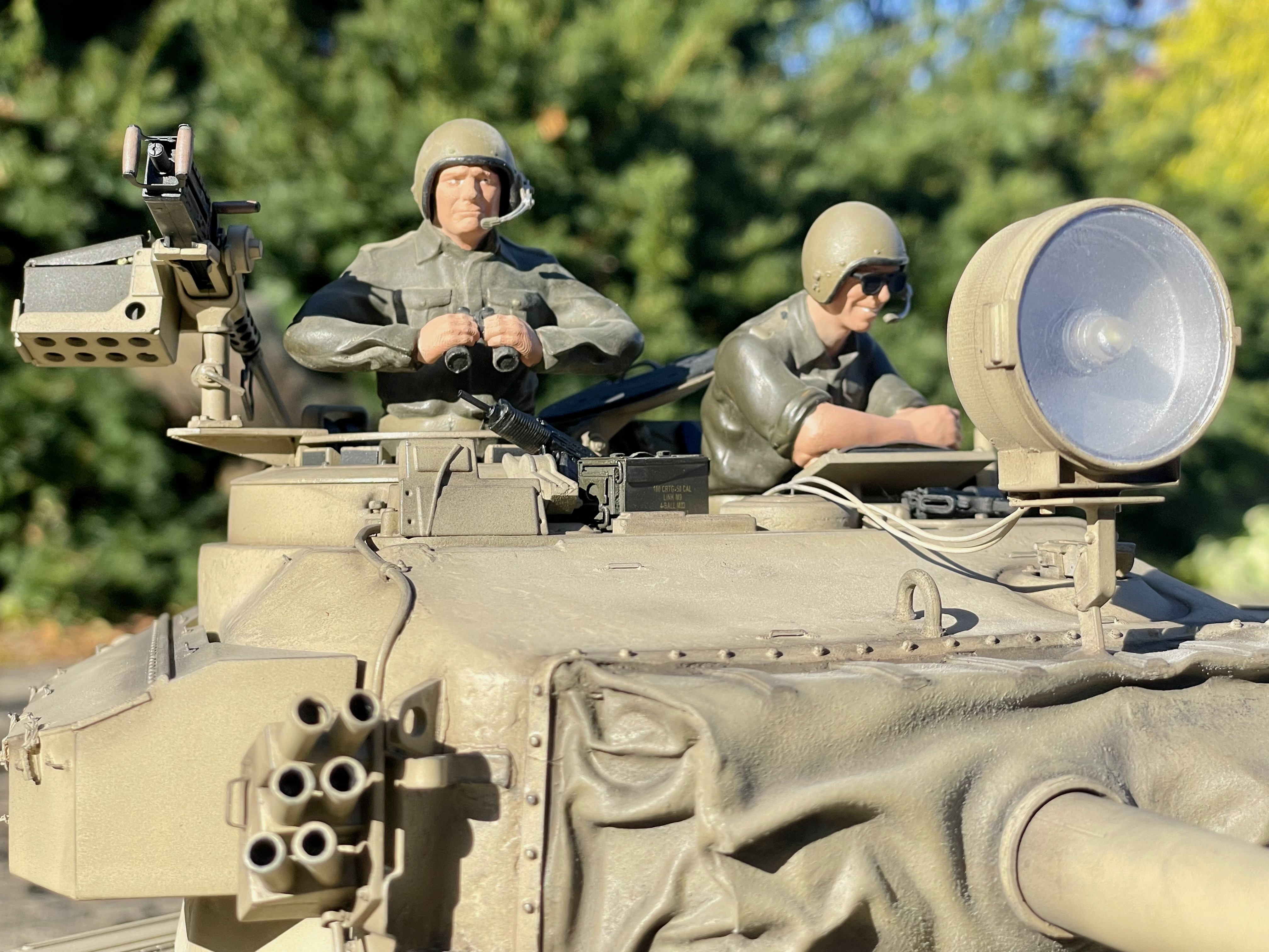

The crew is painted, here is a final photoshoot with the crew. As mentioned in the build, these are FC Modeltrend Spanish civil war tank crews in very plain uniform with their heads modified to fit the US T-56 tank helmets.
3D printed figures are still not as good as resin, the level of detail is low, and they lack finesse. Printed lines are difficult to remove and small parts are hard but fragile. I am not a figure painted so this is a best effort with the time i was willing to put on. Still, they do the job of adding life to the model.
IDF uniforms had various colors over the years. After some research. it seems that IDF tank crews had olive drab uniforms in 1973, with the Khaki US T-56 tank helmets. Pictures of the time are mostly black and white so i had a hard time confirming anything. Probably because the IDF is calling reservists during war time, looks like anything from olive drab to light brown is realistic within the same tank crew. I gave the guys a couple of UZIs for close defence.
