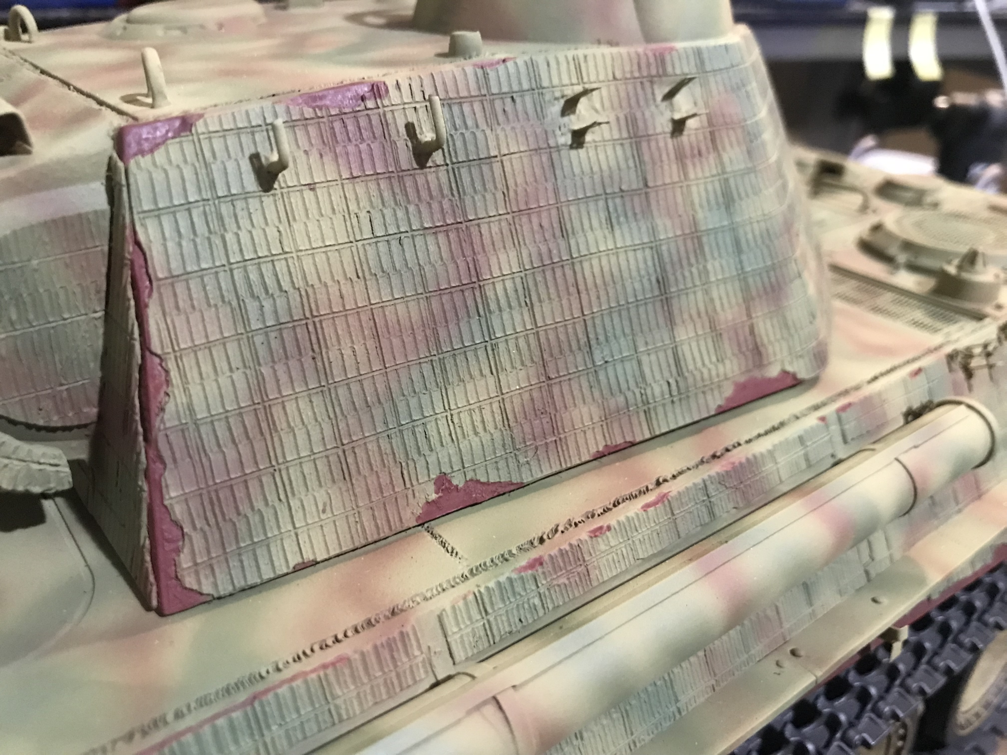

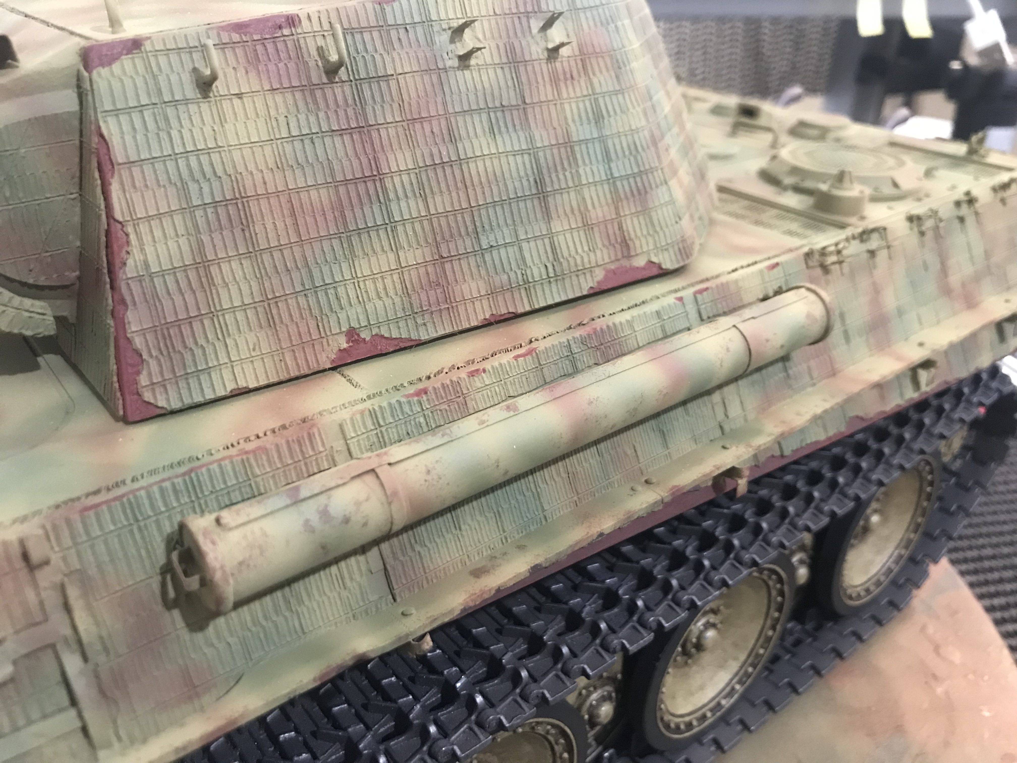

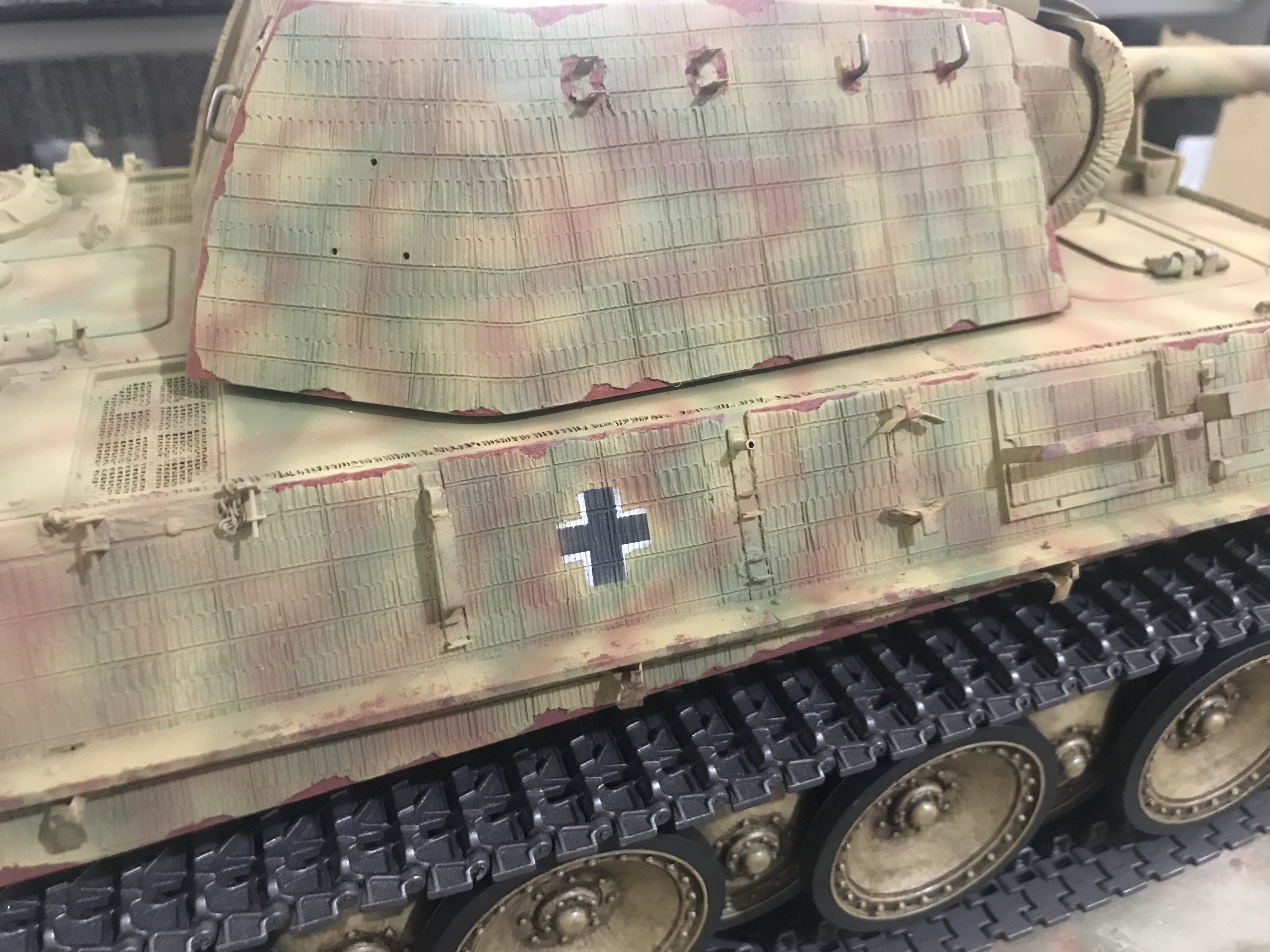

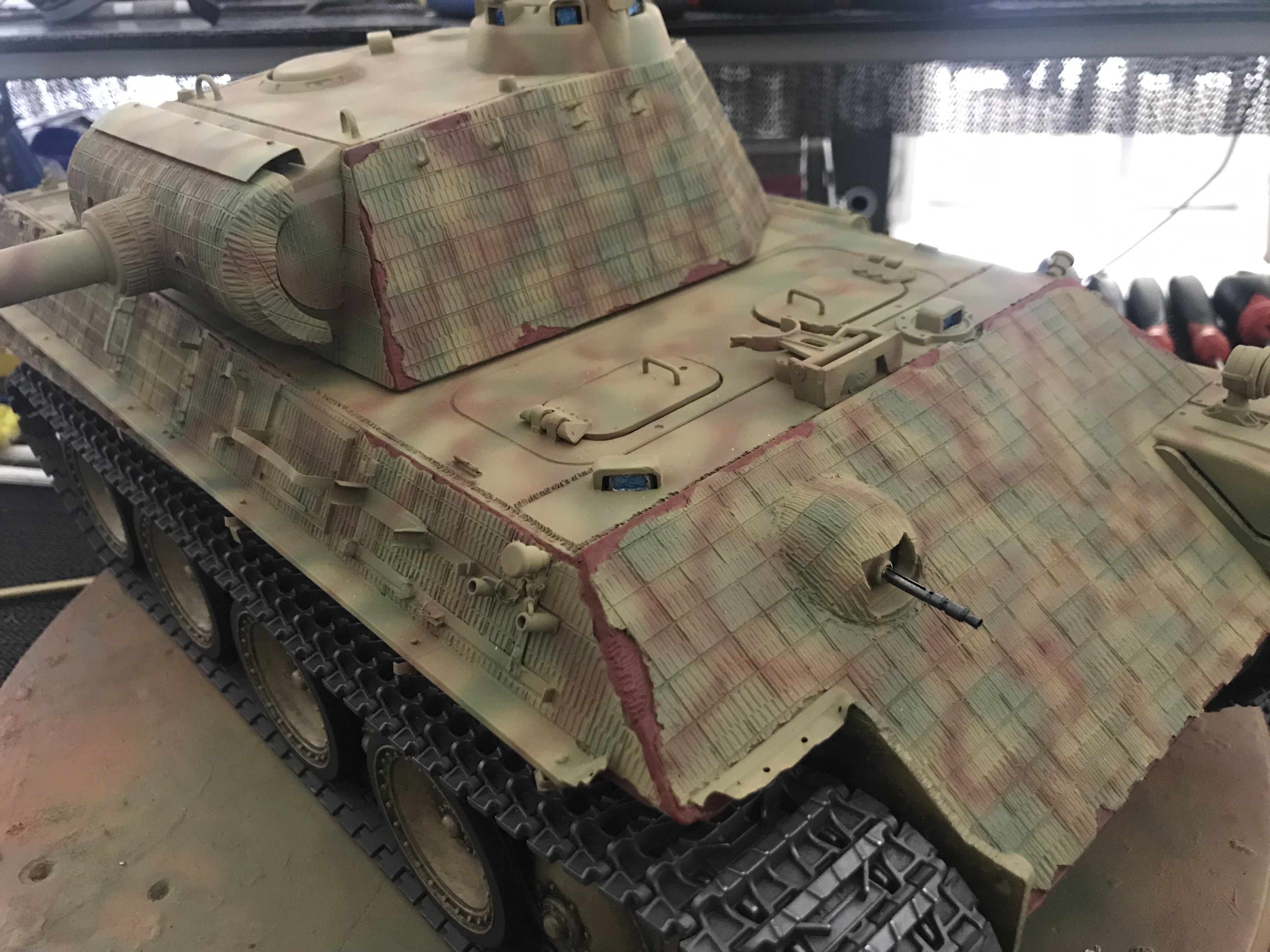

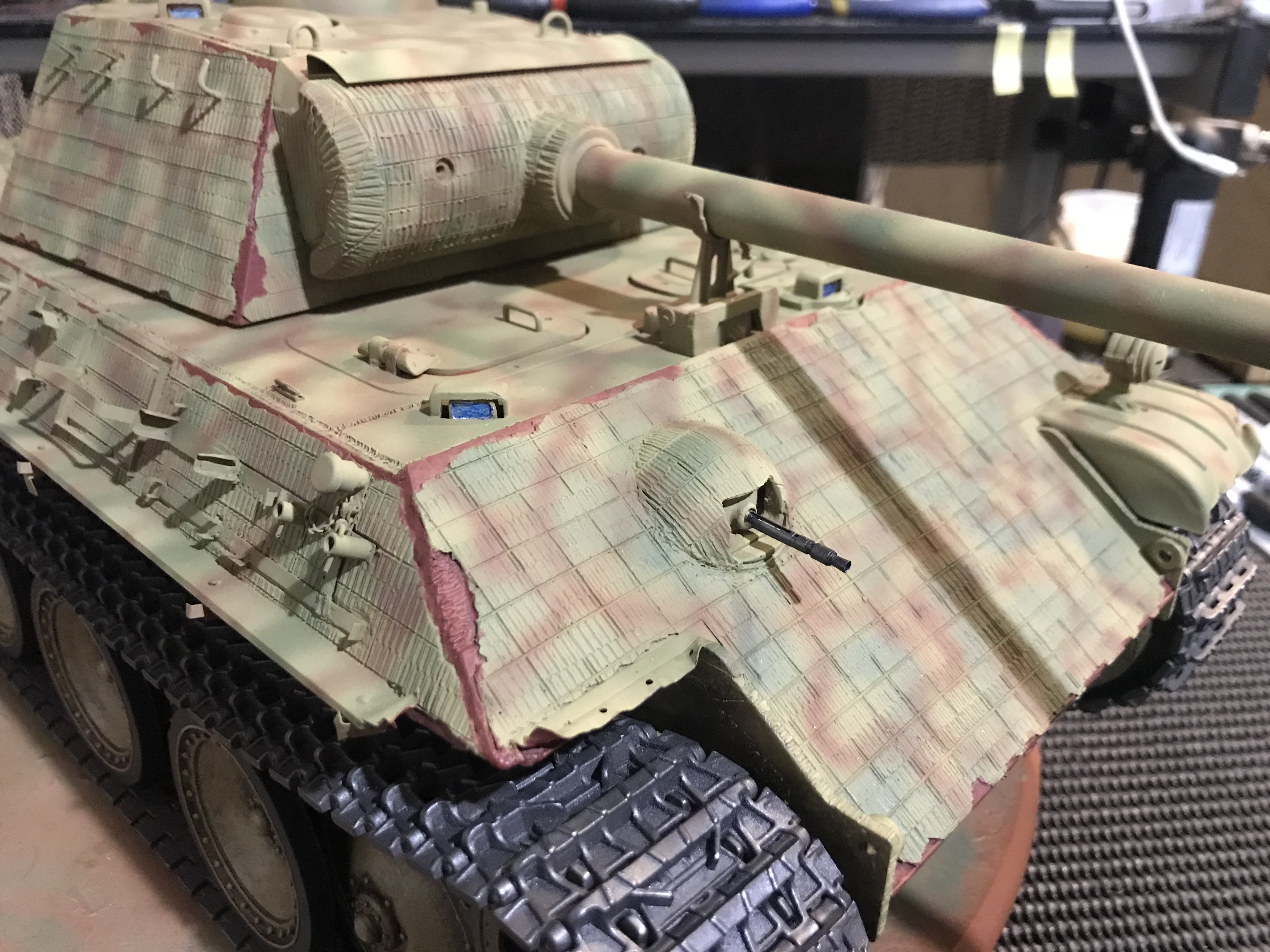

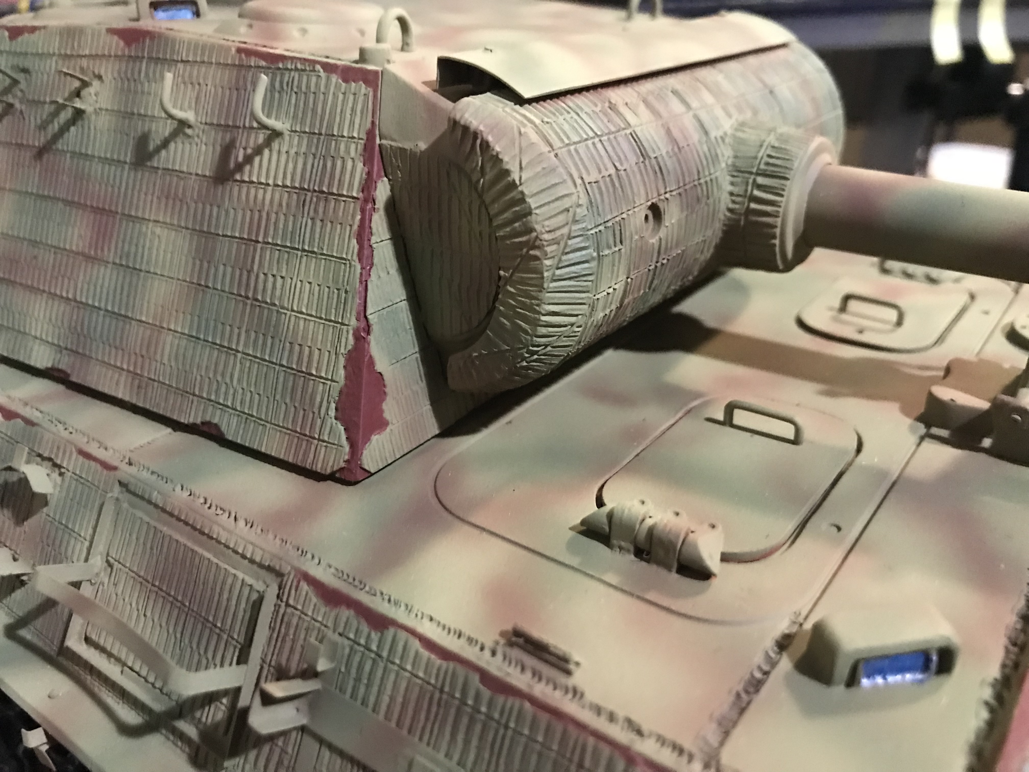

A wee bit more done.
Blended my own version of what the alleged shade of red oxide primer looked like so I could colour the missing Zimmerit patches.
I got the colour from a friend that sent me a picture of a real section of original oxide that was under a hatch from a German tank & not tampered with.
It’s a lot redder than the usual XF -9 Hull red, but a deeper shade than the primer I use.
So, adding XF-7 Flat red to hull red , the look is close to the photo he sent me.
Now the trade off for not putting panzer putty mask on was that I had to brush( yep, the olde fashioned hairy stick) the colour into the Zimmerit chips,
As there is a lot of missing bits, there is a lot of red. 8O
I’m confident it will tone down once grimed/washed.
Any bits that I went 'outside the lines on' ! can be touched up with the relevant shade before it gets sealed.

I am liking the way its turning out.
Its a bit of a shame Im not able to get the crosses and turret numbers on it, as I cant drive to get it to where I need it to be to get done.
I reckon once the 111 goes on, it will hit home that this is what the real tank might have looked like that tragic day.
All the tools are ready to fit, but due to the bizarre positioning of the crosses, only one set can be fitted.
Once the turret numbers and crosses are done, then it will be sealed, THEN the tools can be secured so the upper weathering can go ahead.

I think the red oxide is already pretty complementary with the camo job, it's not too dissimilar from the rotbraun. A wash will certainly tie it all together, and maybe some raw steel coming through in places will take the edge off. I'm looking forward to it!

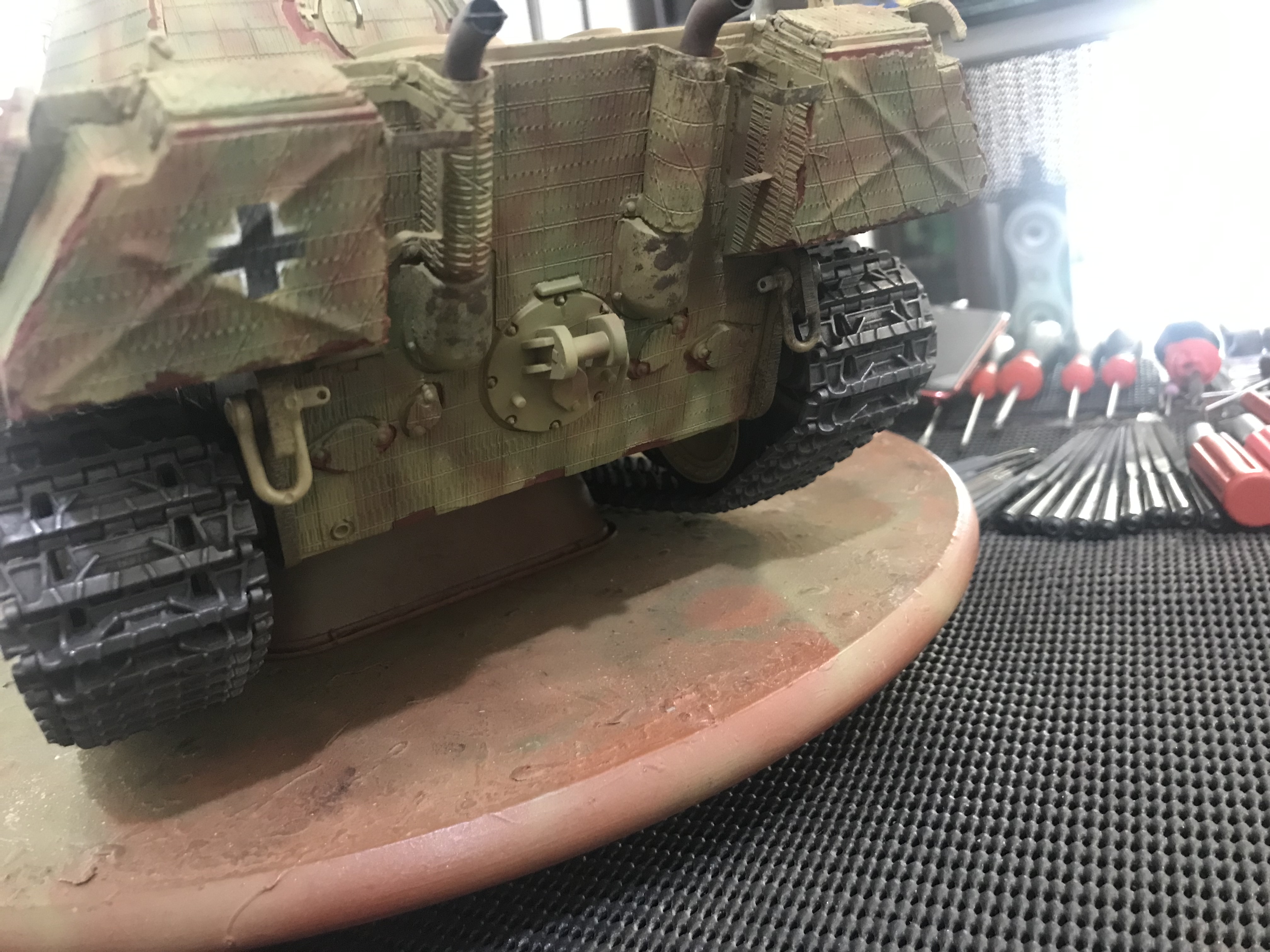

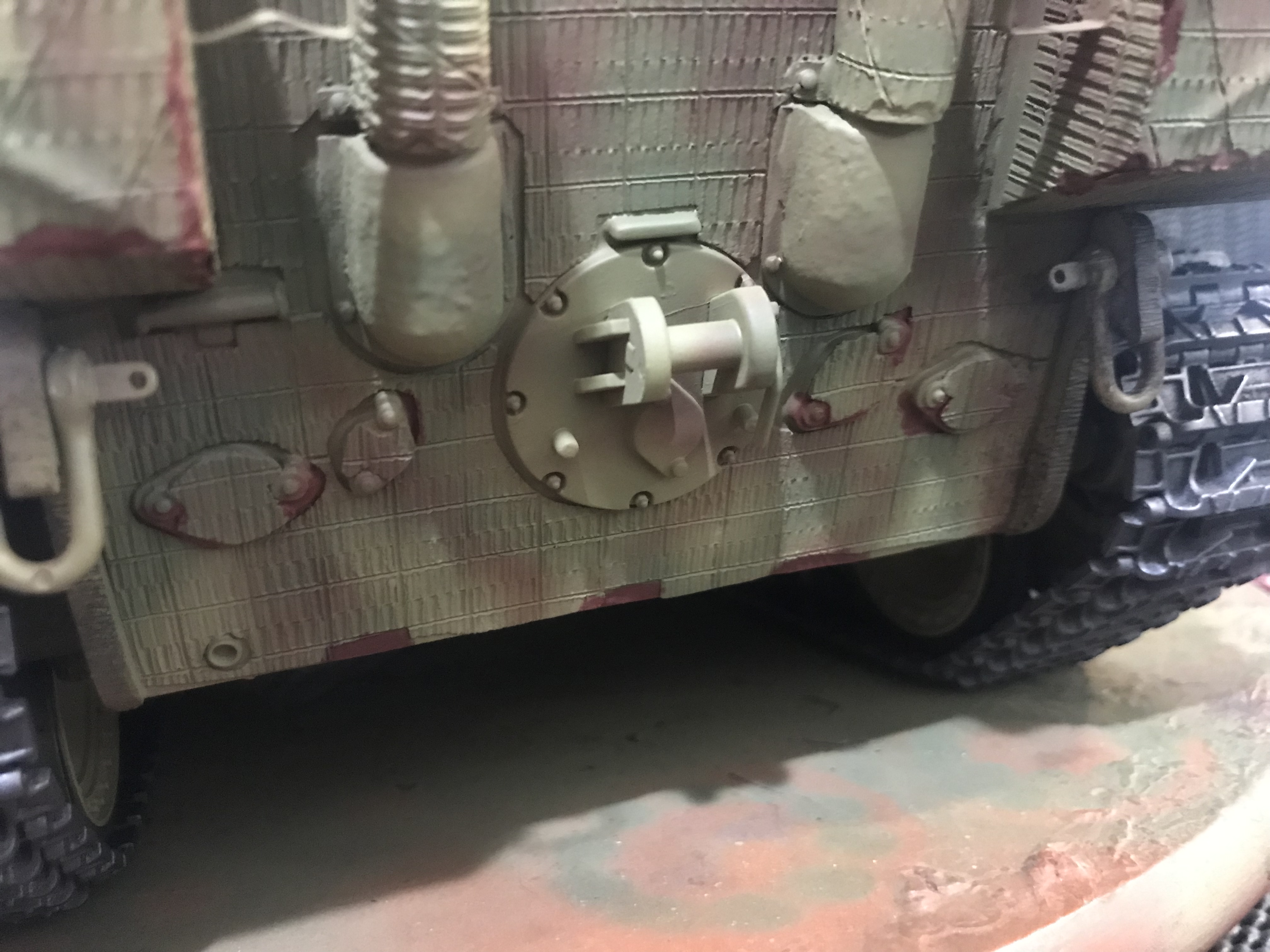

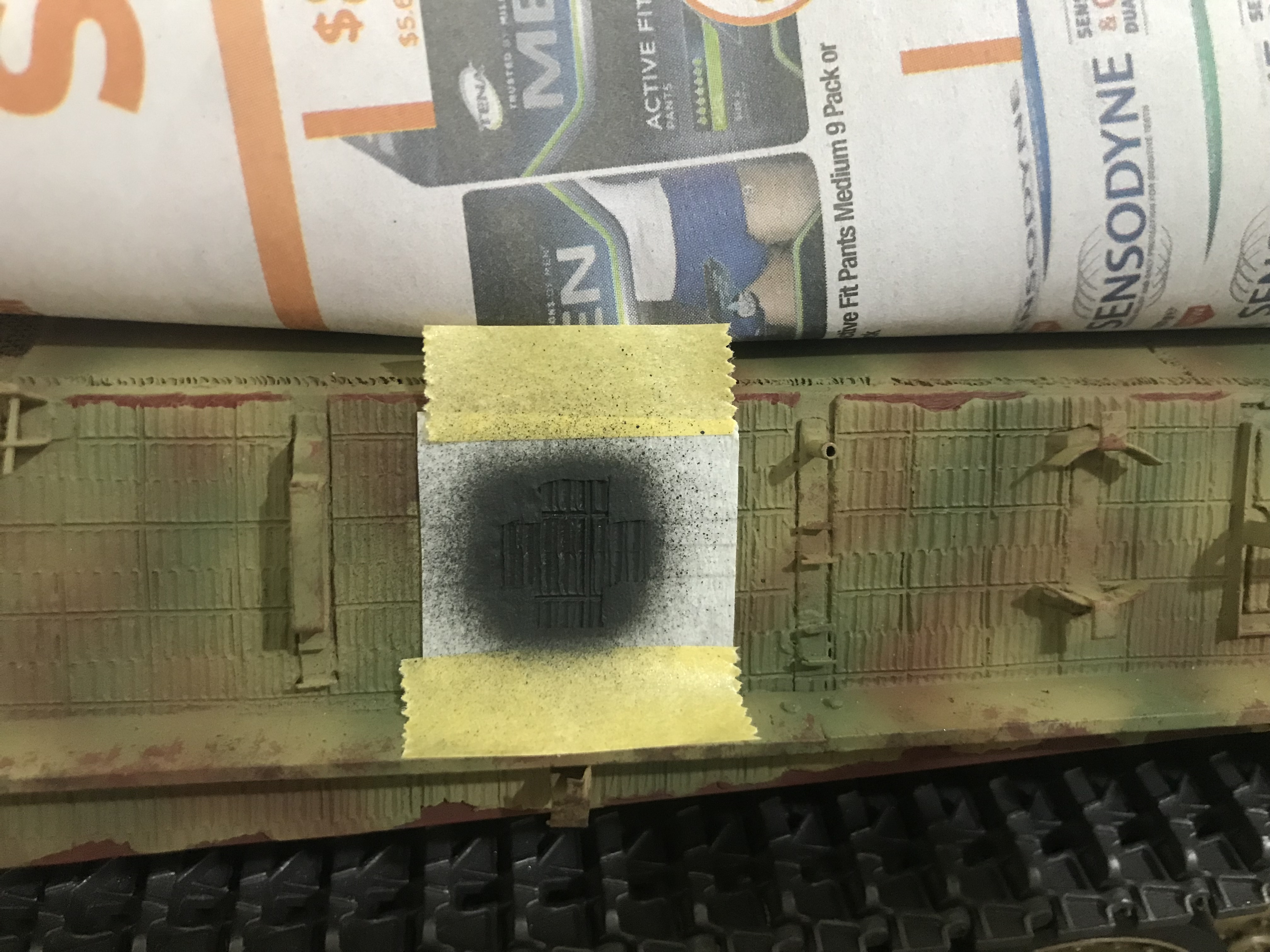

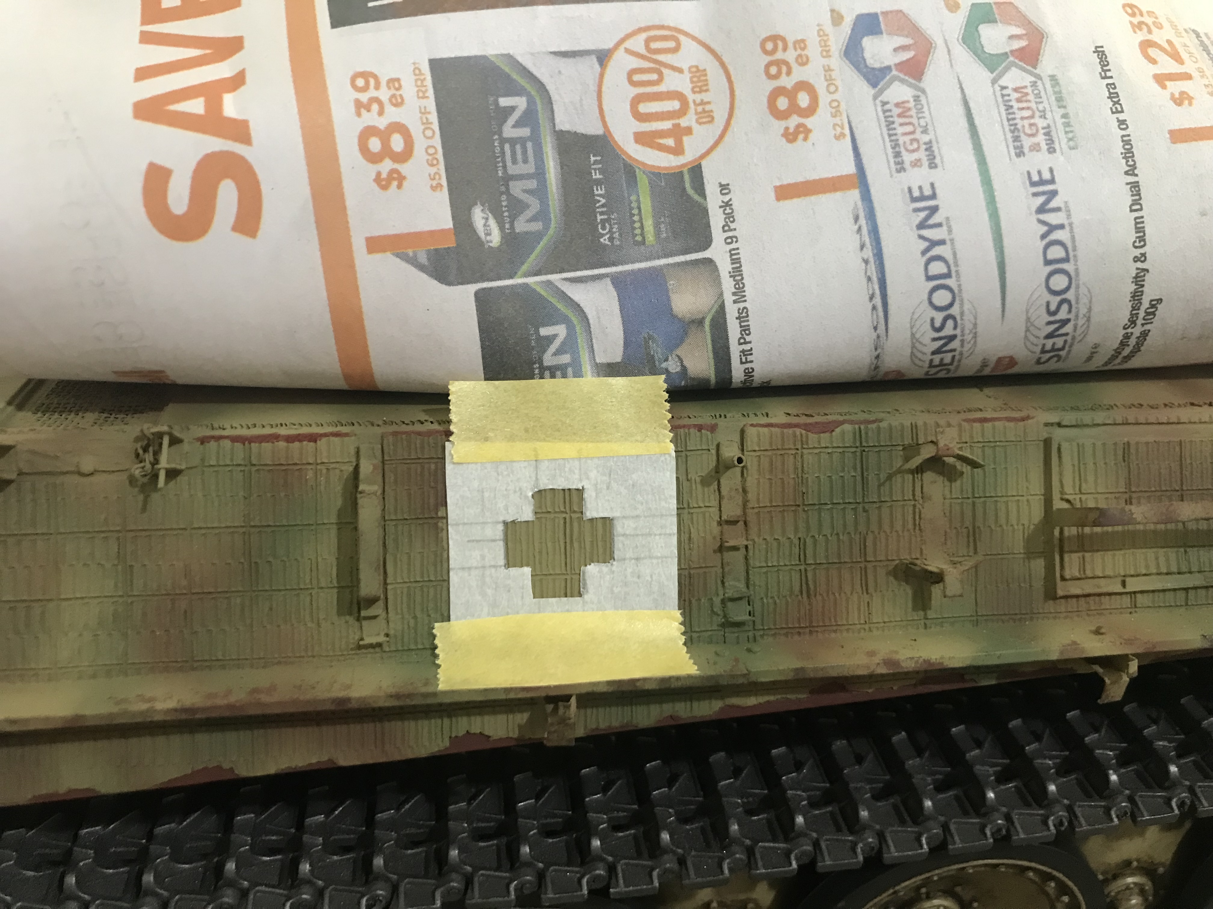

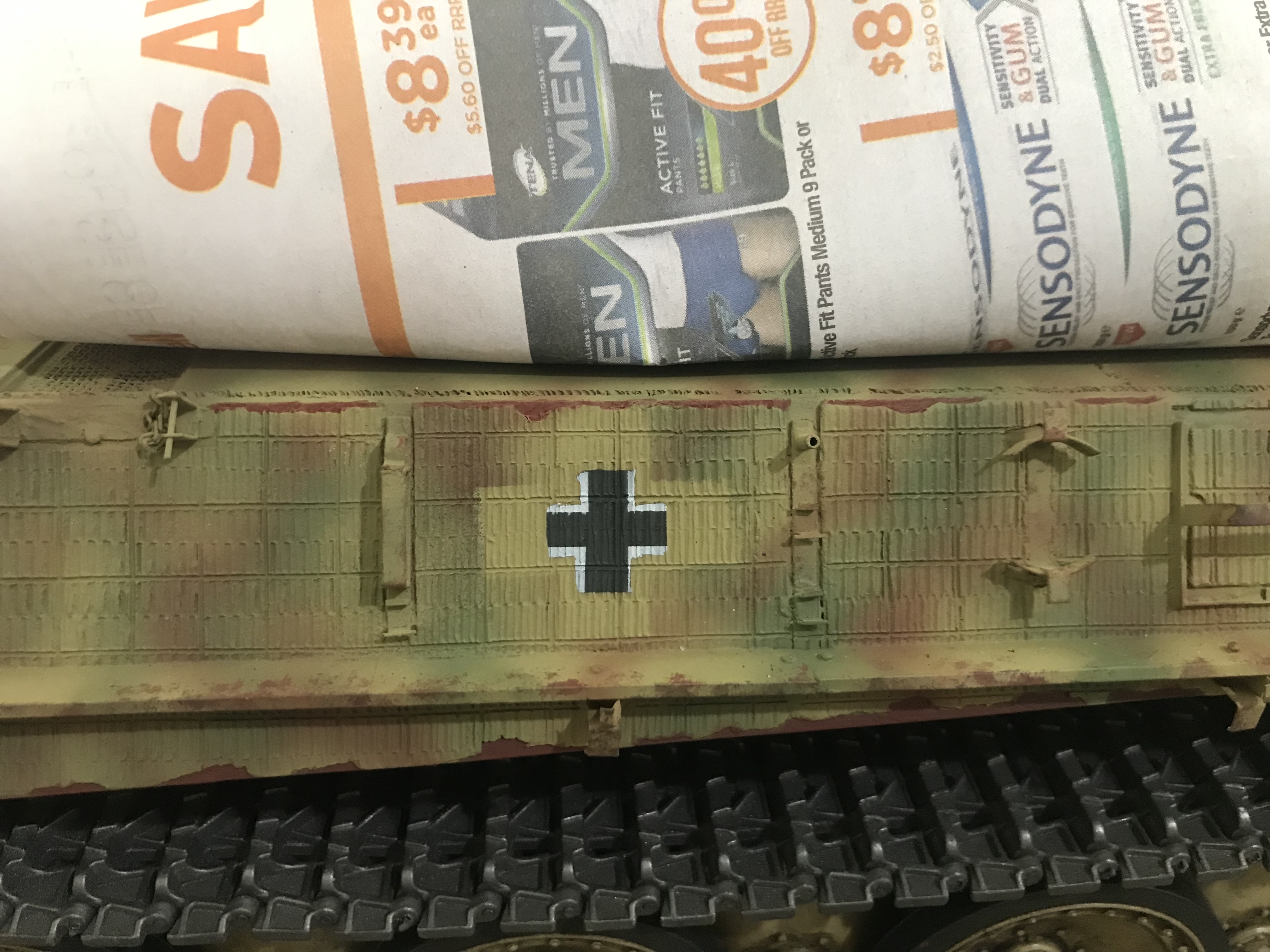

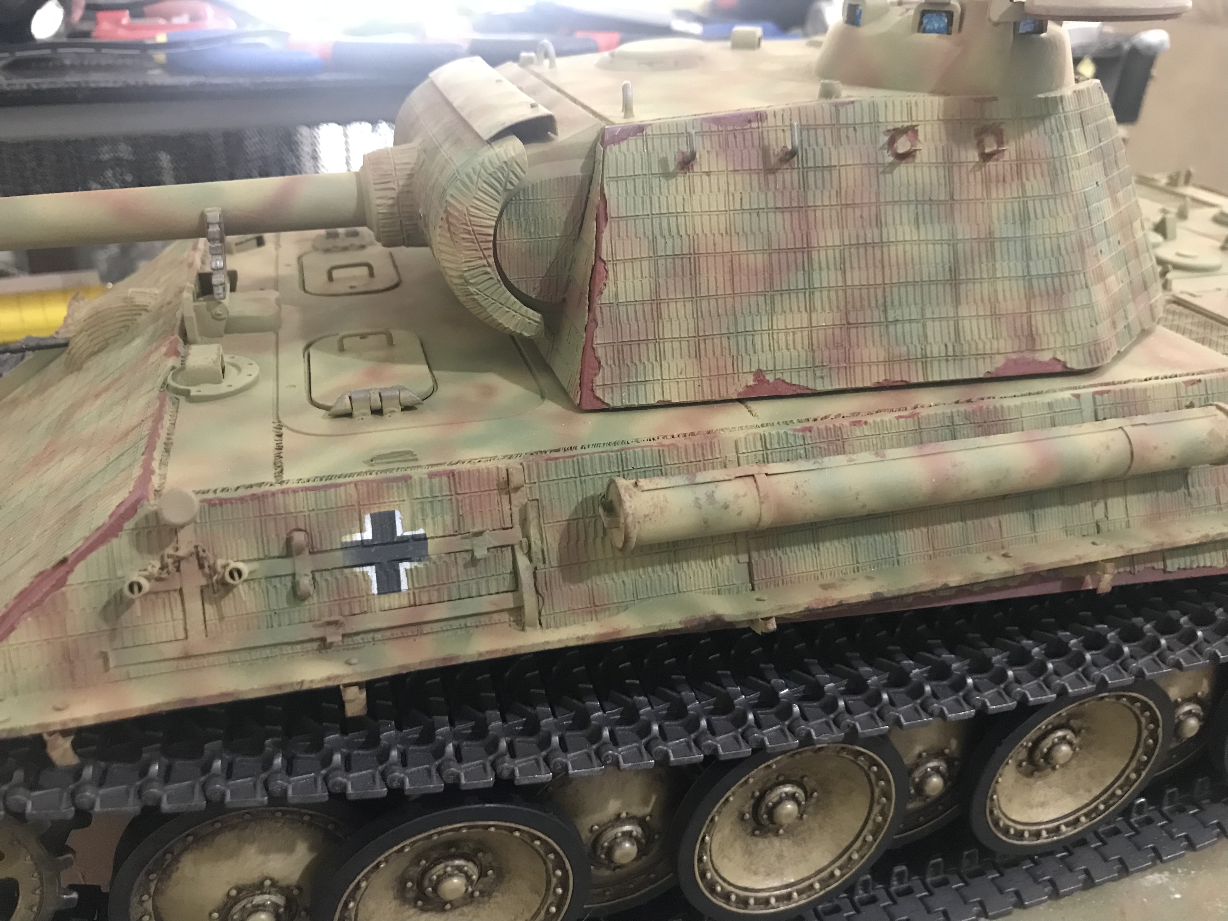

I backed myself to succeed and did the crosses myself.
Now it’s nowhere near a Mr Rad’s stencil outcome, but it’s at least enabled me to progress to only needing the turret numbers to be on, then I can seal it and do the weathering.
Good thing about these crosses is that they will mostly be obscured by tools apart from the rear stowage box.
I took advice from one who knows and used TAMIYA NATO Black XF-69 as it’s not as black as XF-1.
I have to say the black looks good colour wise if a little wide .
Oh well, my first go at it :eh:
Hooray for weathering products!!!!!

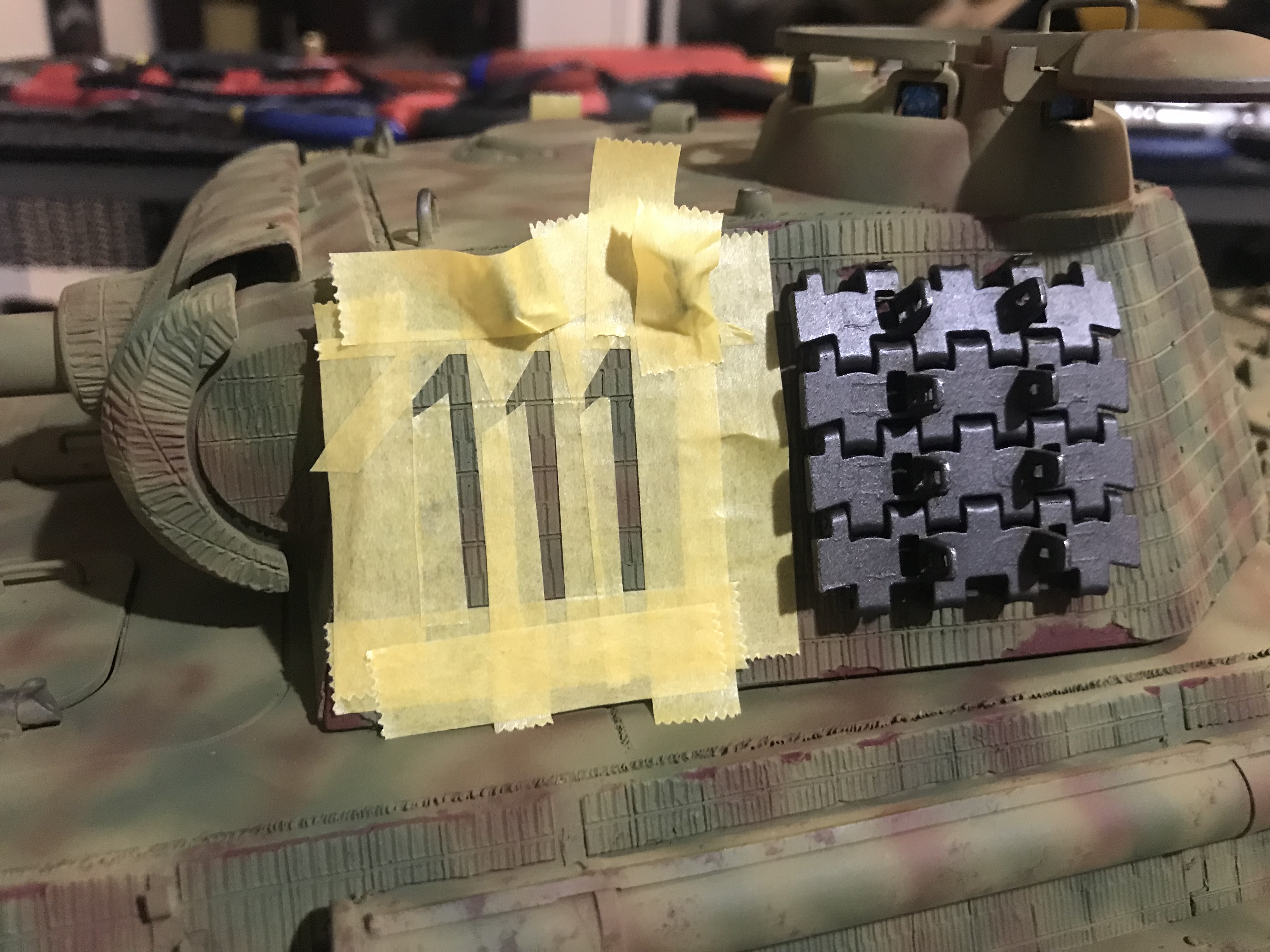

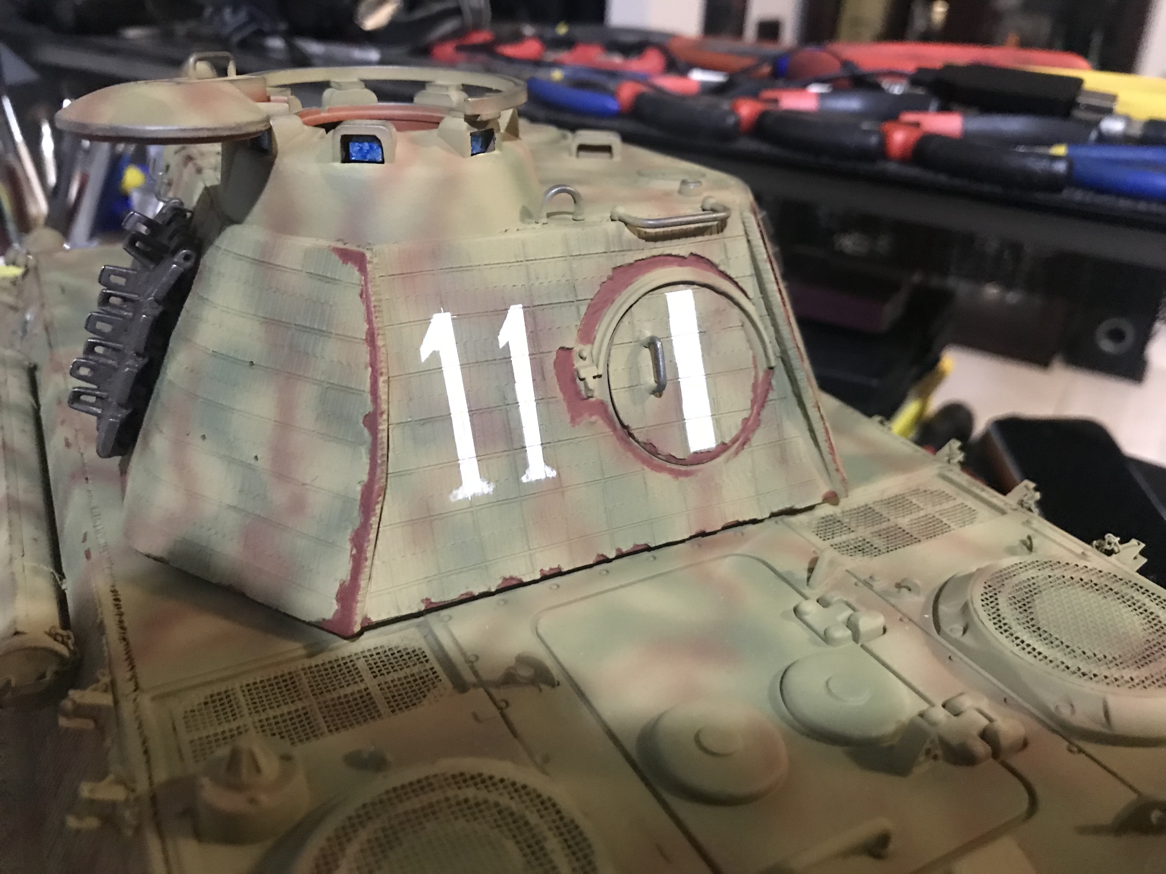

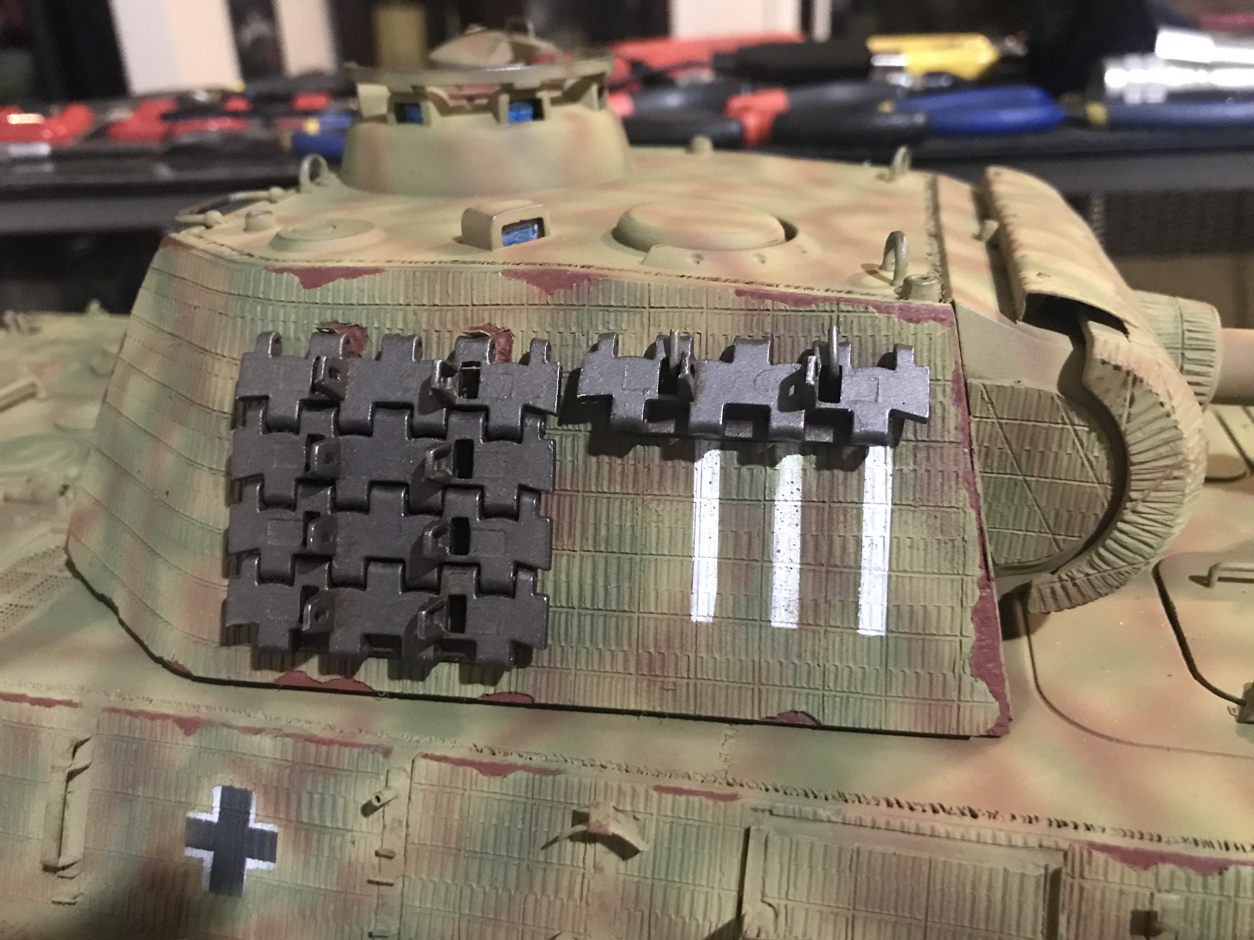

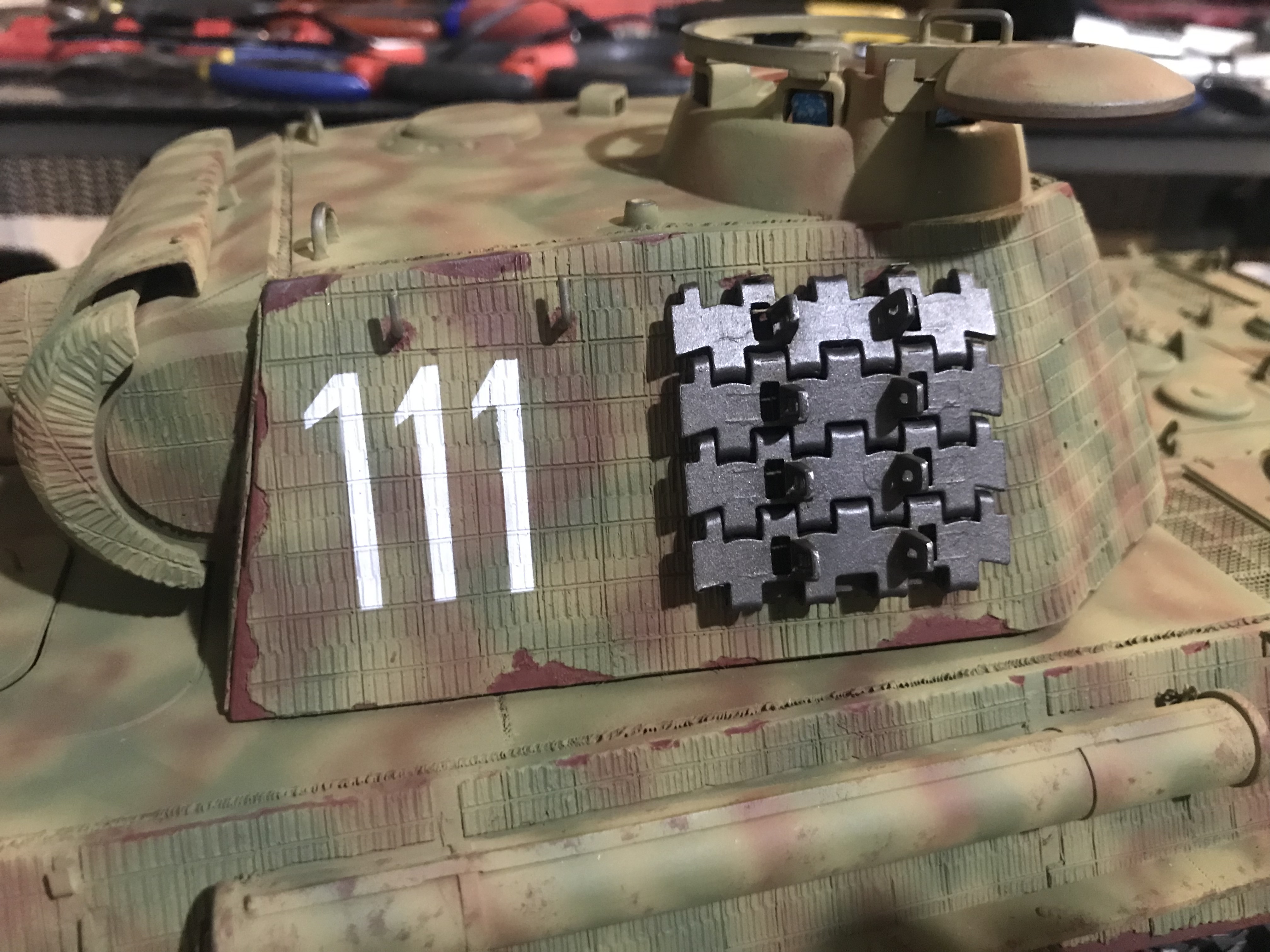

Now while I reckon I can hear Mr Rad giggling, I’ve put the prospect of shame to the side and pushed on with the turret numbers.
Again, not as good as they could be , but near enough for this kid.
Besides, the washing process can hide a few evils !
I had a bit of seeping on the front right set, so it was touched up a bit by brush & I will hang a single track link to hide most of the inconsistency.
Hey I tell myself, Tank not A Cathedral ceiling !!
She’ll be right ;)
The post war pics on the first page of this thread show only 2 visible numbers on the rear plate with a wider line on the hatch, who knows why, but that’s what I did.
If anyone has another photo that can clarify more, that would be great.

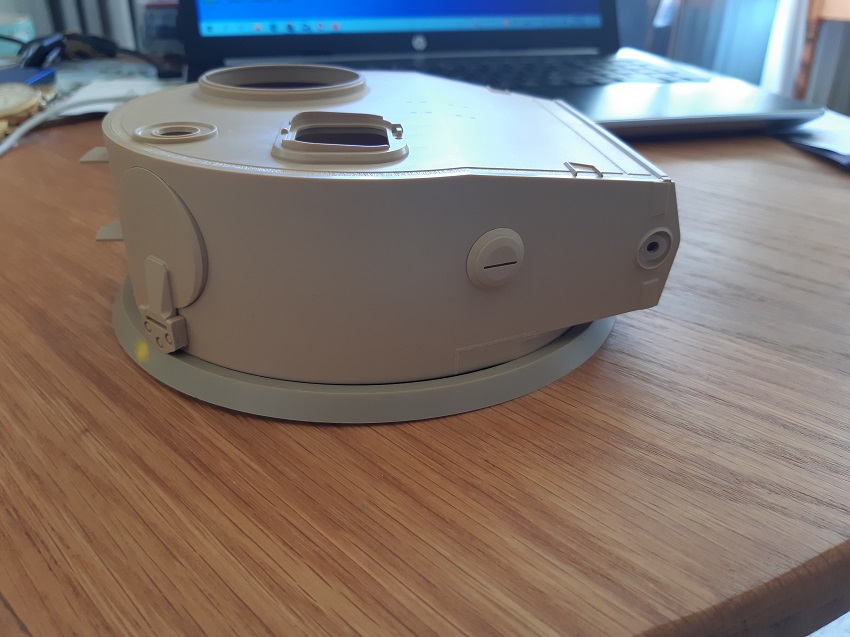

Hi Herman.
Attached is a photo of a Tamiya Porsche Turret Ring, any interest or to big?
Regards
John Glover
