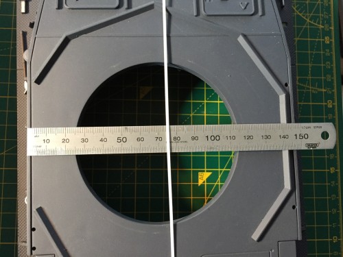

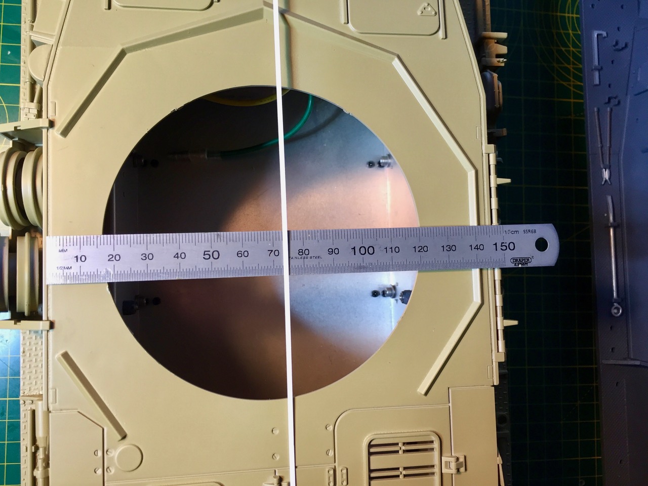

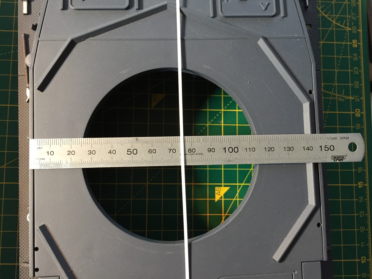

Gary raised the subject of Tamiya accuracy. Well, we've covered the obvious details they get right that other brands don't (return rollers etc.,). I just though of another potential inaccuracy. It has to do with the turret's offset.
Made on the cheap, you'd expect the turret's actual midpoint (L-R) to be located plumb centre in the upper hull deck. In reality, the Pz IV's turret was offset to the left (looking forward down the barrel) by as much as 2.62 in (
66.5 mm), with the engine offset to the right to allow the prop shaft (torque shaft) to turn unhindered.
Out of curiosity I though I'd check the Tamiya and Heng Long/Taigen decks to see who'd noted, and included, this feature...or not :think:
Well, this is what I found:
Tamiya Pz IV turret offset
HL and Taigen turret offset
The white line in both instances rests on the exact midpoint between their right and left sides. As you can see, (even though the turret ring aperture is smaller on the HL version), there is an offset present in both pictures...and also the midpoint falls at roughly 74mm from each side for both models. In other words, both models use the same offset. In a way, I'm surprised - given the lack of accuracy Heng Long Pz IVs display when compared with their illustrious counterpart, I fully expected to find another casual error here. I didn't :thumbup:

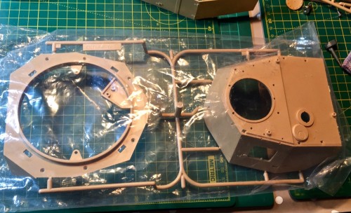

Much to my relief, and delight this arrived in the post after lunch:
Tamiya Pz IV Turret sprue..
I say 'delight' because this arrived well packaged, and fairly promptly (considering it came from Germany :P ) and only a few days after I clicked 'buy' it- on Ebay. Axel didn't have this sprue in stock, and so I looked further afield, and found
minigrandprix.de. ....and then they supplied it. This outlet, though it specialises in Rc models (boats, cars, helicopters..etc) and slot cars in particular, Tamiya tanks and spares are still well represented:
https://www.minigrandprix.de/rc-modelle/panzer/
Anyway, it looks like a useful alternative to the big boys in the Tamiya biz.
Now I have probably more than 90% os the Pz IV outer shell now.(just need gun, Storage locker, and turret doors). All good. :thumbup:

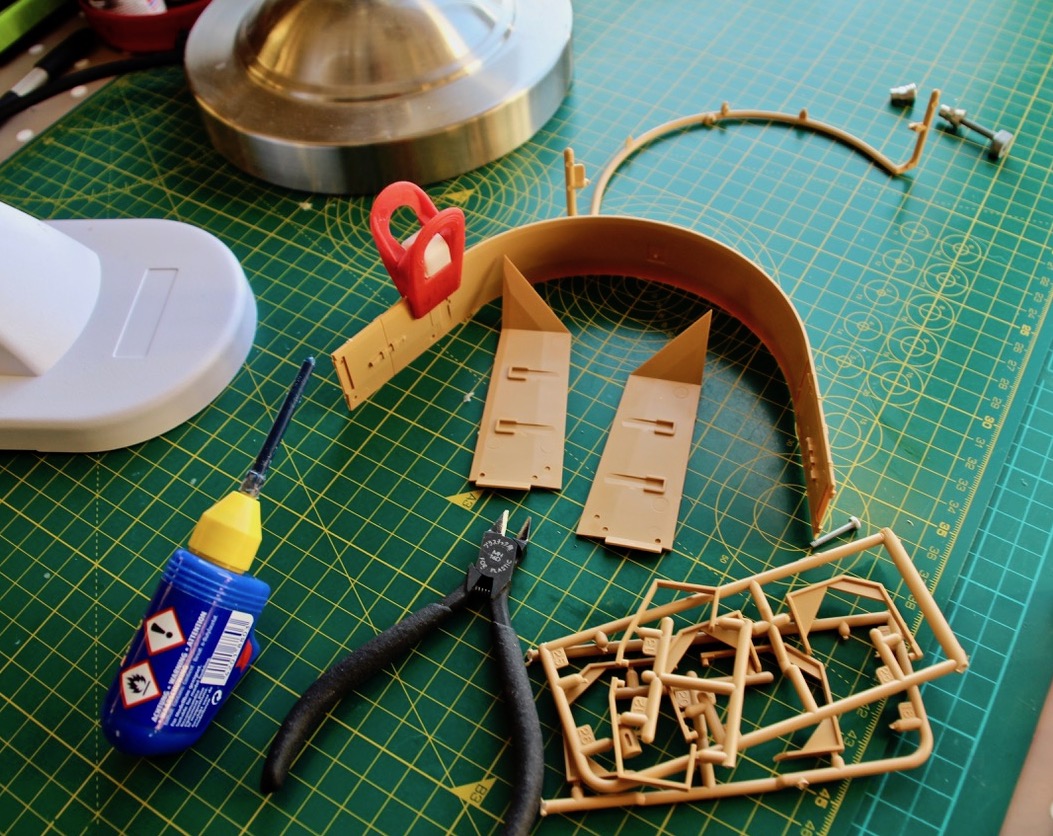

Just starting on the Turret Schurzen...more updates tomorrow, maybe...
Tamiya Pz IV Turret Schurzen...
The Ausf J, thought the final iteration of the Pz IV line, was less well equipped in some respects than the preceding 'G/H' version...but time was pressing, and the borders of the Reich were also shrinking rapidly. So it was 'simplified'. It only merited extra protection around the turret, and was sent into action without the side schurzen fitted to some earlier versions.
