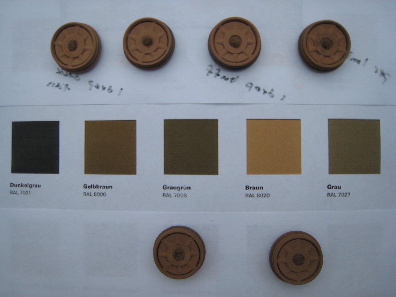

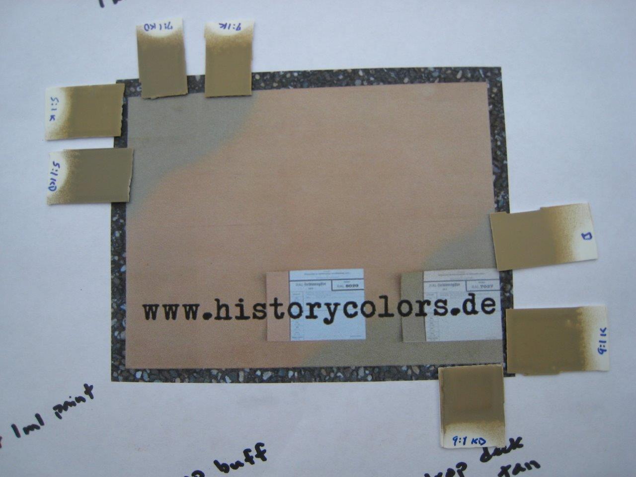

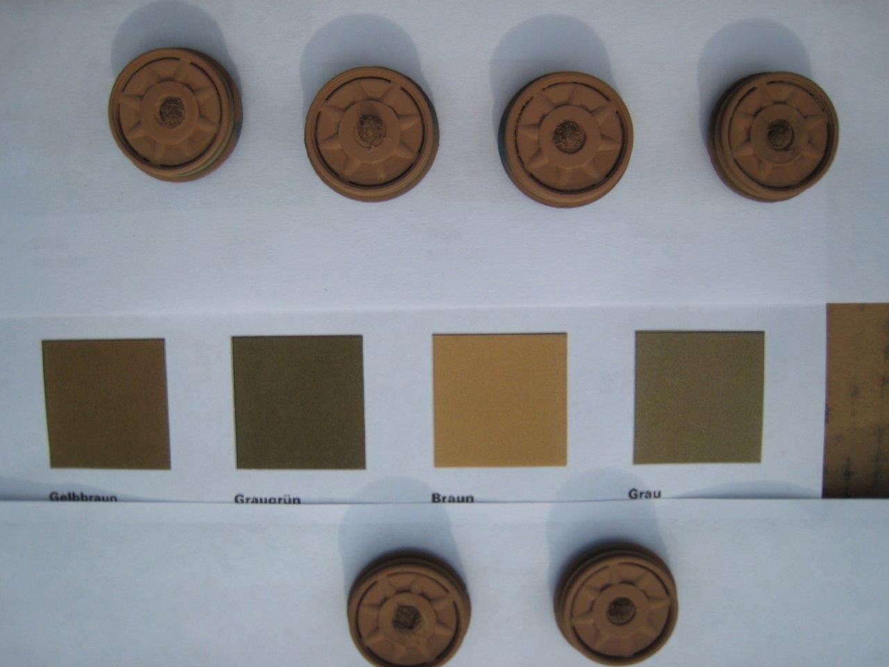

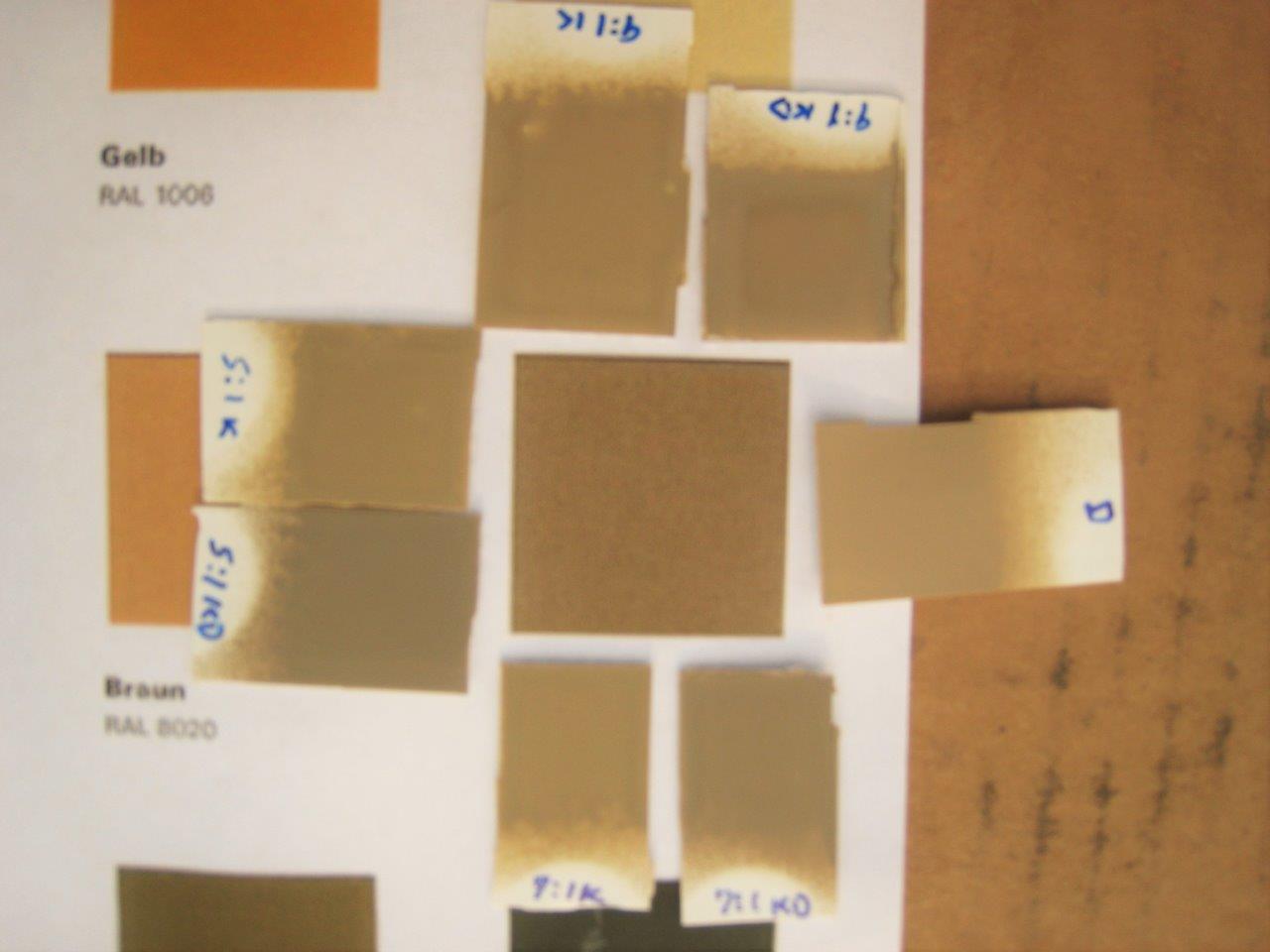

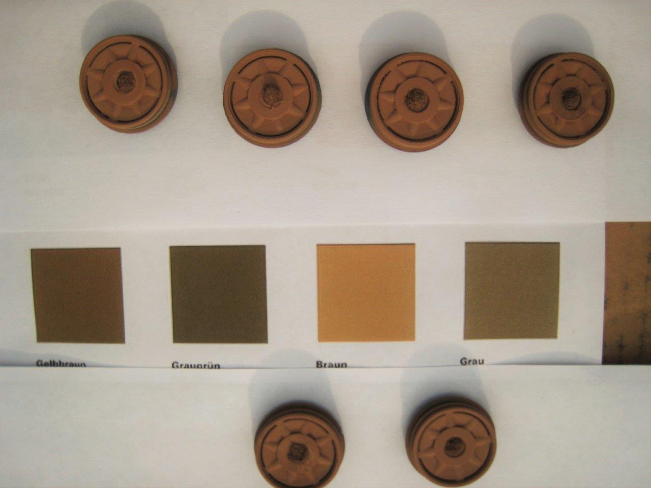

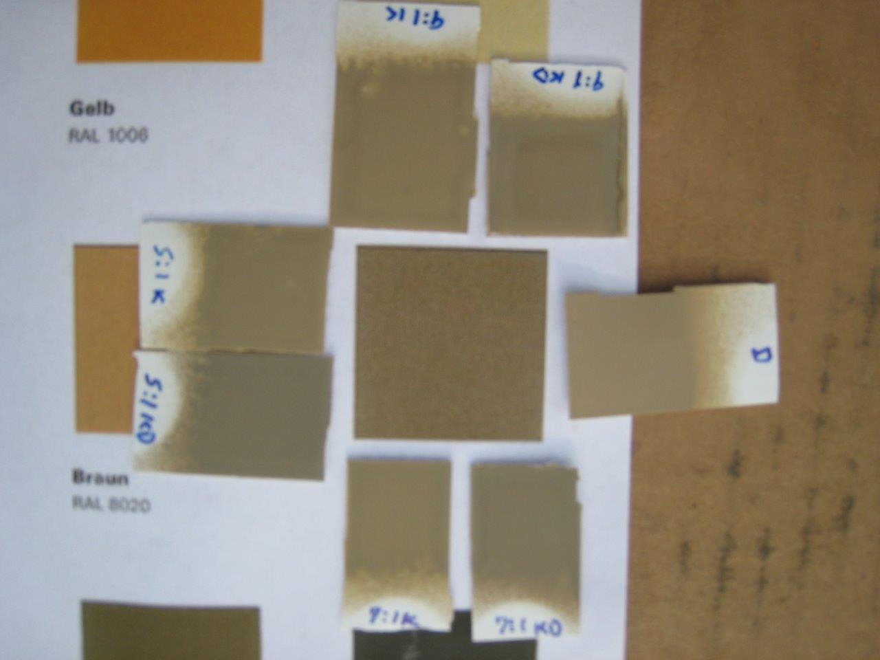

I’ve also been playing with the shades and hues of Tamiya’s recommended mixture for RAL 8020. Looking at the various references that I’ve compiled, there doesn’t seem to be a lot of consensus regarding the shade of the color. Some indicate that it is a very light tan with a reddish or pinkish hue. Others indicate a darker brown that still has the reddish hue. Looking at some of the B&W photos that would seem to represent freshly arrived tanks, I think it should be a little bit on the darker side. My tests have used the Tamiya mix (5:2... Flat Flesh:Red Brown or XF-15:5 + XF-64:2). Then, I’ve experimented with adding a drop of either Flat White to different amounts of mixed paint (1 ml, 2 ml and 3 ml) or a drop of Buff (XF-57) or a drop of Deck Tan (XF-55) to 1 ml of mixed paint. I think that I like the straight mixture (no white) for the lower hull and shaded areas of the tank and the 2 drop of white per 1 ml for the upper hull and turret. Although admittedly, I’m not sure that I can see a difference except if I look really close and maybe in bright sunlight.
There also seems to be some disagreement on the hues in RAL 7027. It’s generally a greyish color. But, some think it should have a brown hue and others a slight greenish tint. So, I’ve added different amounts of either Khaki (XF-49) or Khaki Drab (XF-51) to Buff (Tamiya calls for straight Buff) to see how they look with the grey color, but slight greenish tint. I think the Khaki Drab is best, but I haven’t tried this over the base color yet.
I’ve taken pictures in different lights. Cloudy day, sun pushing through the clouds, under flourescent lights...can’t seem to get a good sunny day with good mid-day sun. Under these lights, they all seem very much the same. There are only slight differences. Anyway here are some of my photos. I’ve taken them using printed copies of my reference colors for comparison as a backdrop. I also did some color temperature corrections. My camera seems to leave everything very cool (blue) looking.
It occurs to me that I might be over thinking this whole thing. Thoughts?
Anyhow, here we go...
One reference (no photo retouching):
IMG_0003 (2).jpg (83.82 KiB) Viewed 5055 times
IMG_0004 (3).jpg (65.83 KiB) Viewed 5055 times
IMG_0010 (2)-1.jpg (86.08 KiB) Viewed 5055 times

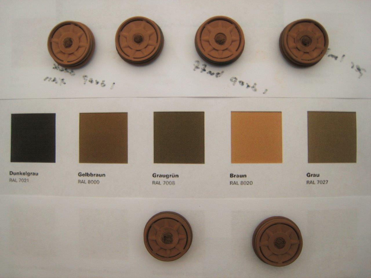

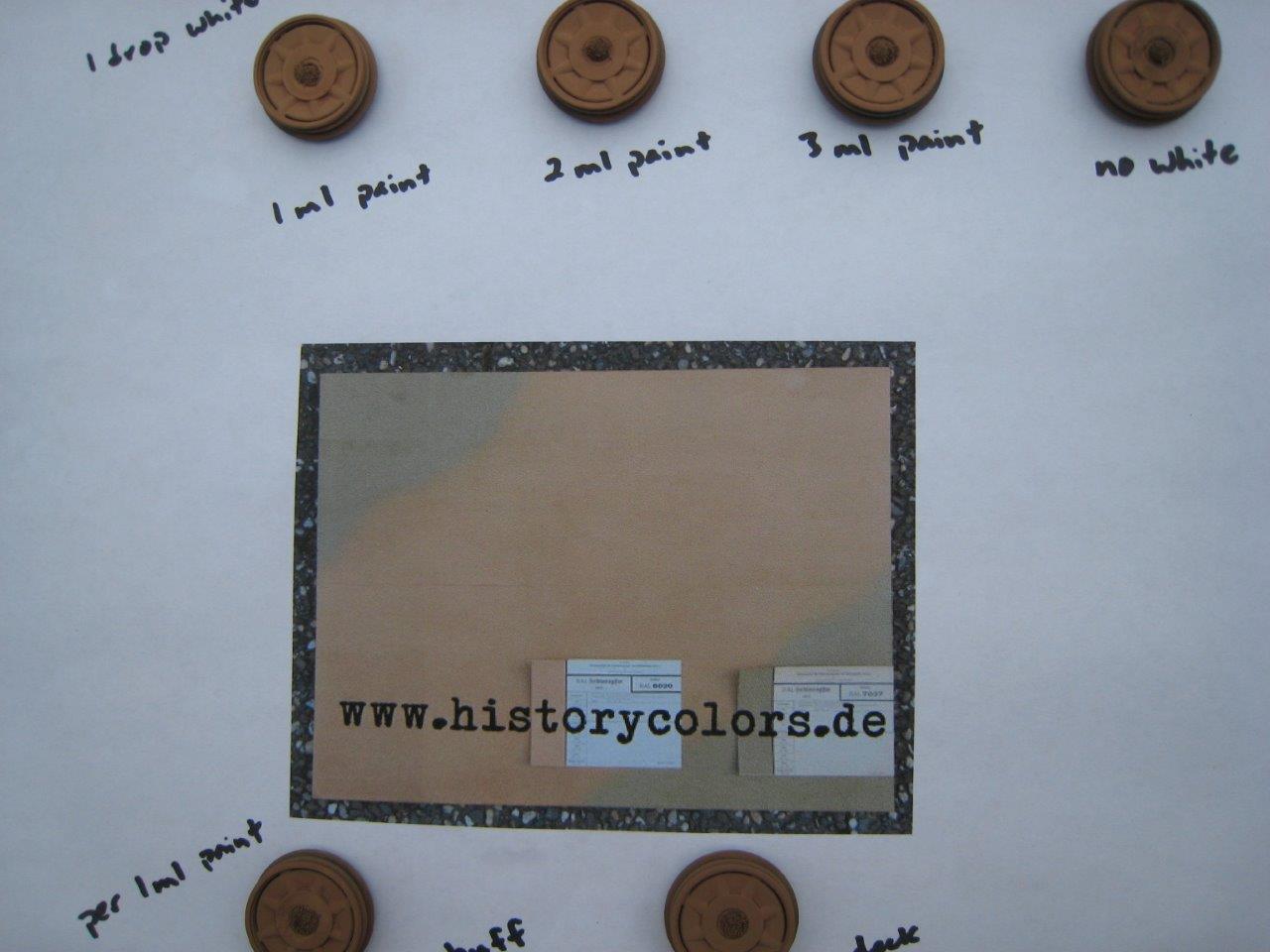

With photo “warming” to make the white paper whiter and less blue...
IMG_0003 (2) (temp change).jpg (86.84 KiB) Viewed 5055 times
IMG_0004 (3) (temp change).jpg (69.28 KiB) Viewed 5055 times
IMG_0010 (2) (temp change).jpg (90.57 KiB) Viewed 5055 times
First two in the set were taken outdoors on a partly cloudy day with late afternoon sun trying to force through the clouds (no camera flash). The second two were taken outdoors on a cloudy day (no camera flash).

More photos and another reference...
Second reference (no photo retouching):
IMG_0011 (2)-1.jpg (99.1 KiB) Viewed 5055 times
The first two were taken outdoors on a cloudy day (no camera flash). The third photo was taken outdoors on a partly cloudy day with late afternoon sun trying to push through the clouds (no camera flash).
Re: DAK Pz IV Ausf G Build
Posted: Wed Oct 12, 2016 7:58 am
by HERMAN BIX
Im going to say...............over thinking it !!!
Posted: Wed Oct 12, 2016 7:41 pm
by philipat
Yep...probably over thinking it. Think I'll go with the straight paint under the hull and fenders and then lighten it slightly for the exposed upper surfaces.
I think it was supposed to change shade and hue depending on light and angle. Pretty cool effect actually. :)
