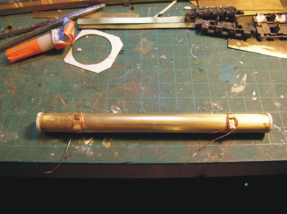

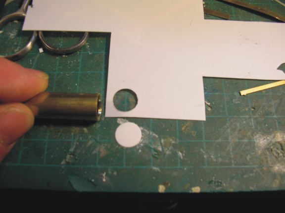

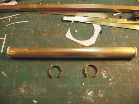

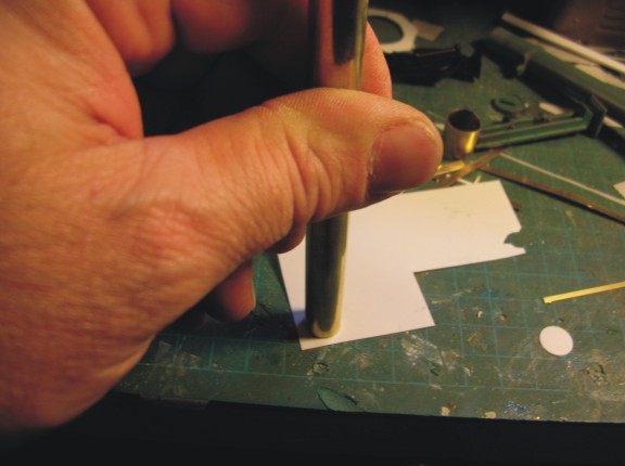

Measured out the cleaning rod and antenna storage tube and began to build the covers. I scraped one opening to make the edging sharp and punched out 2 styrene ends. did a few to make sure I had 2 that would work.
Panther A 241.jpg (47.56 KiB) Viewed 5112 times
Panther A 242.jpg (40.85 KiB) Viewed 5112 times
Panther A 243.jpg (36.87 KiB) Viewed 5112 times

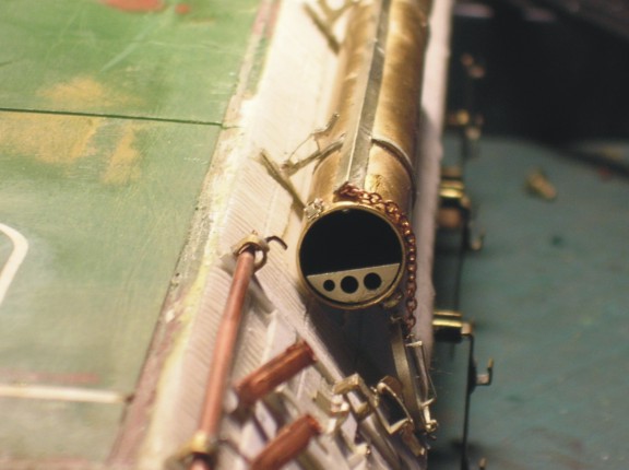

I then wrapped thin styrene around the ends and made the ring mounts exactly the way they are on the real thing
Panther A 244.jpg (66.69 KiB) Viewed 5112 times

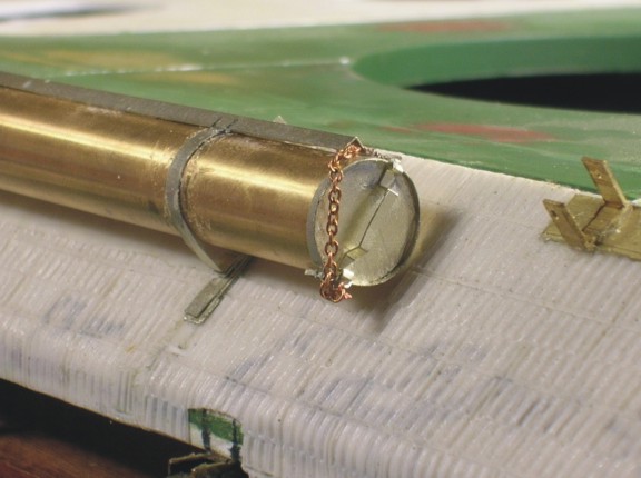

Used crazy glue and glued them on in the right position and then used thin wire to draw them in tight to the body of the tube.

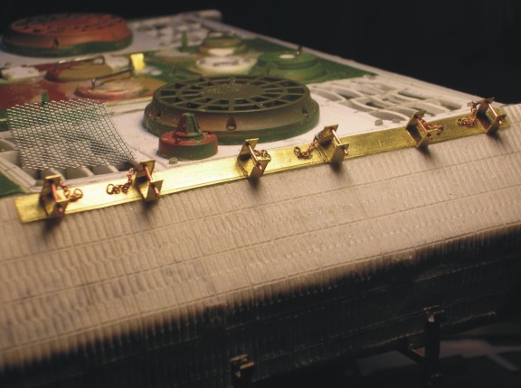

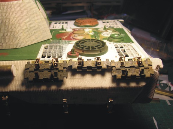

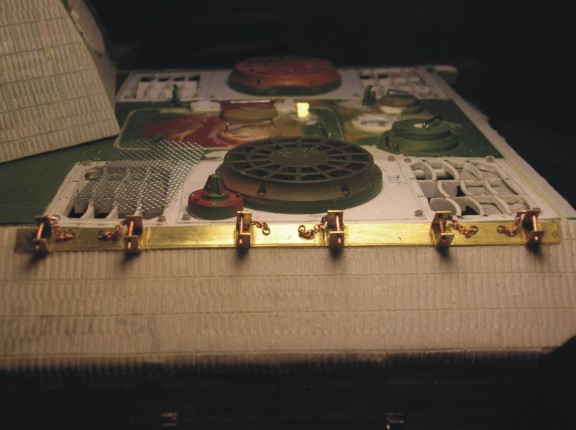

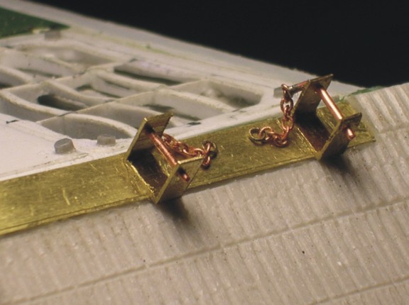

Next moved on to the spare track holders. These actually went quicker and easier than I thought! Measured out a strip for width and length then took a piece of brass rectangle tubbing and removed one side with a dremel to make a hollow square. I then cut using the dremel each independent section and smoothed them off to make uniform and drilled the holes for the locking pins. I then used my diagrams, pictures, and the spare track I am going to use to measure the spacing between each section. Made the locking pins out the appropriate size of copper wire, bent the ends and soldered small chain with a larger ring on the end.
Panther A 247.jpg (46.74 KiB) Viewed 5111 times
Panther A 248.jpg (53.46 KiB) Viewed 5111 times
Panther A 249.jpg (49.35 KiB) Viewed 5111 times
this is alook with the main parts mounted:
Panther A 250.jpg (54.85 KiB) Viewed 5111 times

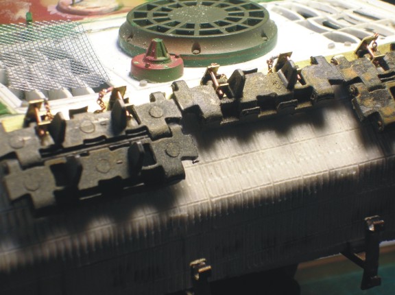

I have decided since these mounts look so cool I am only going to put the spare tracks on one side and leave the other empty so here is what the one side will look like with them mounted. I should mention too that the spare track needs some detailing to make it look better and more realistic. The "teeth" need to be hollowed out and some little styrene strips added to represent the small ridges on the teeth. You can see I started on a couple of the teeth ...

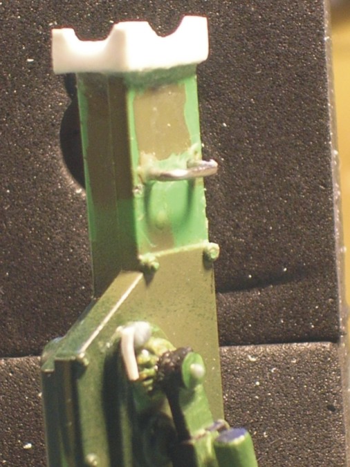

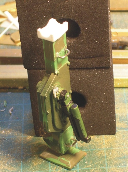

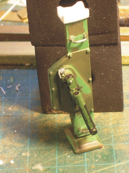

Next I wanted to finish up the jack detailing. I decided to make the early version as the jack that comes with the HL Panther most closely resembles it. Added handles, trimmed the handle to look better, added a little ratchet at the head and remade the jack crown out of styrene. I also sanded/carved/thinned different parts to look more realiatic. If the jack was to be down at the bottom of the rear hull I might not have done so much detail but it is going to be mounted between the exhausts up high and very visable to wanted to make it look better...

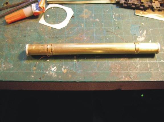

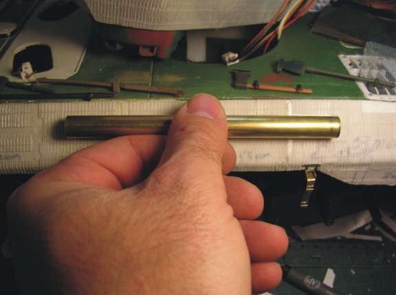

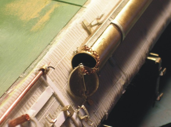

WOW! 8 months since I last worked on my Panther A project! Was very busy with other builds but now I am determined to finish this up before the snow flies! I broke down and bought some Aber stuff. My god I don't know how anyone solders this stuff! :crazy: :crazy: :crazy:
I have a hard enough time making it look 1/2 assed presentable. My hats off to the real pros out there who make it look really good. I was O.K. with the scratch built antenna/cleaning rod tube but figured why not upgrade it. So here is about 4 or 5 hours worth of work to make it just a bit fancier. . It didn't turn out too bad me thinks. I am going to leave the one end open for display but tack the cover down so that doesn't get lost running around! Still some clean up to do and a little zim fill but I like it...

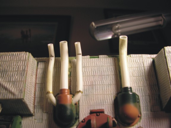

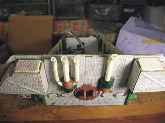

Well, since you mentioned it. I have the complete Aber kit to do an early Panther G with zim too! That will be winter project. Not nearly as much conversion required as the "A"

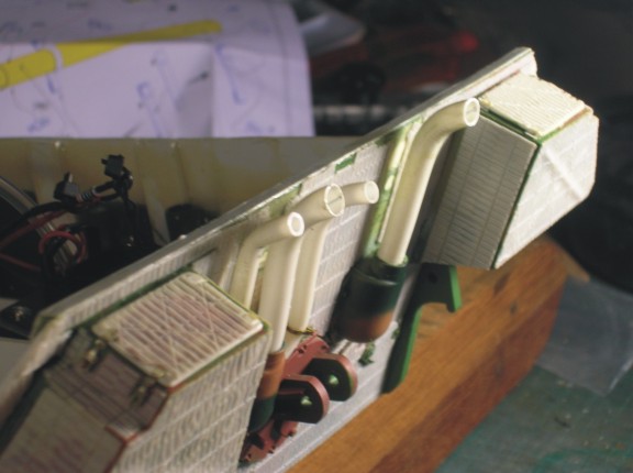

Here is the exhaust mounted. I will be putting my favourite TARR 1 smoker with mega-steam in it of course! By the way, if anyone has some tricks for bending this tubing let me know! I did a hair dryer, hot water, I tried brass with a bender. Nothing really worked well. These were the best of an entire package of styrene tubing!!! The good part is if you look at the real thing they were actually pretty crude and rarely straight very long! Brass frame over the next few days...

Just wondering Dgsselkirk...how come you didn't use brass for those exhausts....it's way easier to bend and thinner too
Also ...have you ever tried these things
KD tubing benders...sold in most hobby shops
use them for years...works well once you get the technique down ;)
